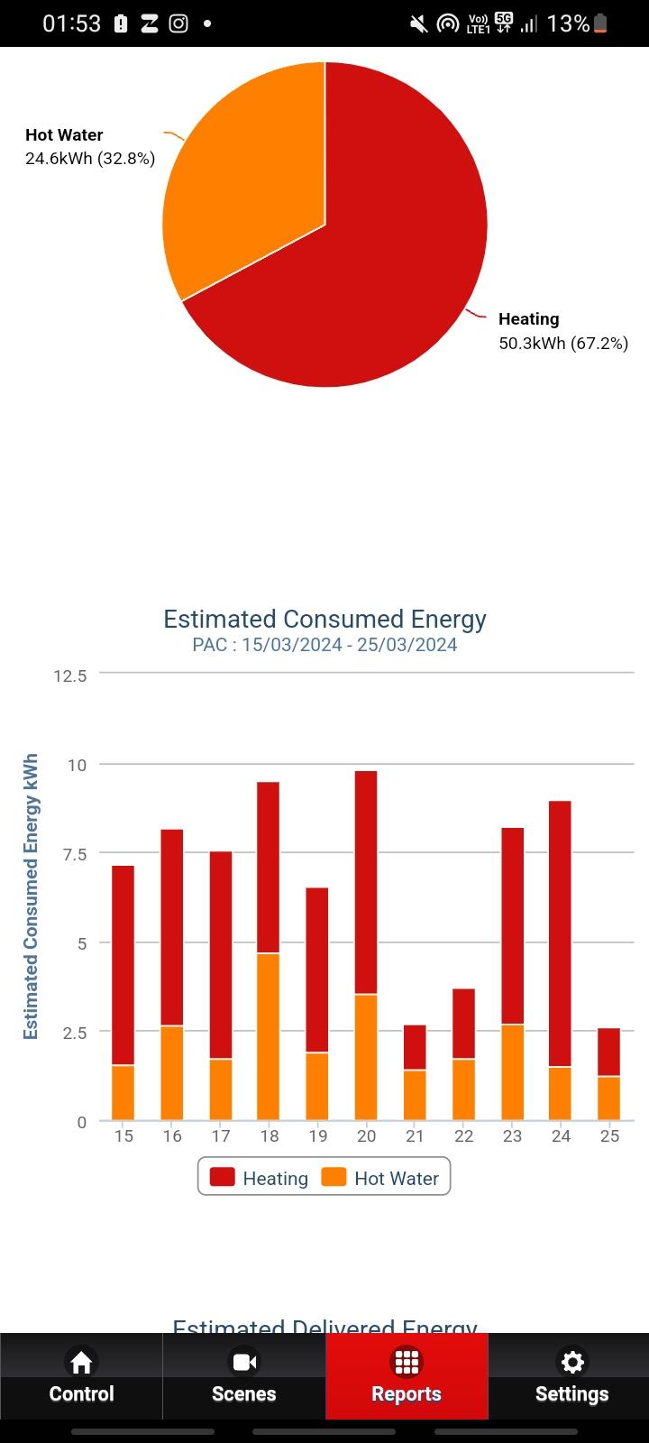

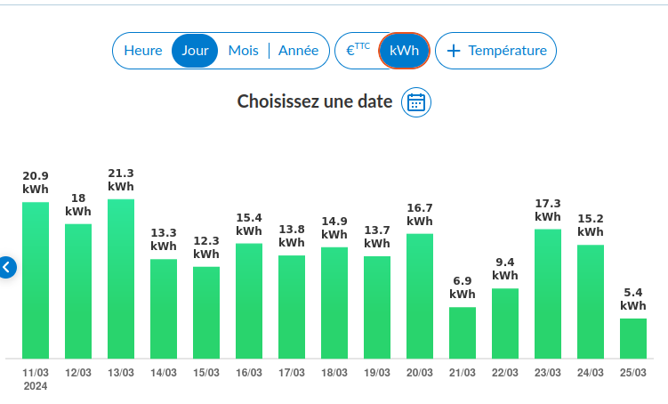

Garald Posted March 29, 2024 Posted March 29, 2024 (edited) I am spending much more on electricity that I had expected. The heat pump (which should be the main consumer of electricity) is operating at reasonable temperatures - and it claims a good COP and reasonable consumption. However, notice how closely total energy usage tracks the energy the heat pump claims it is consuming - except that it's off by a factor of about 2. The world according to the heat pump: The world according to the energy company: I have been away at a conference since the 24th; all lights (which are LED anyhow) are turned off. What is going on here? Possible hypothesis: - Some device (other than the heat pump) in the house is misbehaving grossly. Argument against: why would total energy usage mimic heat pump usage? I'll get a new fridge (the current has been having issues) but I doubt that's it. - The energy company is lying. Somewhat unlikely, one would hope. - The heat-pump applying to me about how much energy; for whatever reason, it has a terrible COP, and it lies about it. I would hope that's also not the case. Could it be the case? Notice how the heat pump's statistics are only 'estimated': OTOH the figures for January and February obtainable in the machine itself (as opposed to the app) the ratio between power allegedly consumed by the heat pump and the total amount consumed in the house was similar. - Maybe there's some sort of faulty wiring that makes me spend 2kWh for every 1kWh used by the heat-pump. How would this work? Any more possibilities? How do I test these hypotheses? Edited March 29, 2024 by Garald
Alan Ambrose Posted March 29, 2024 Posted March 29, 2024 Taking a quick look, I’m not sure anything much is out of the ordinary. Take the 25th - total consumption was 5.4, HP was 2.5, so rest of house (fridge etc) was 2.9. Our little place uses 4.4 when we’re not here and the heating and hot water is off. So your standby/background number looks good. But the HP was still used for both heating and hot water on the 25th - so presumably it was cold enough that the ‘frost’ setting kicked in and presumably you didn’t turn off the hot water while you were away. Why not btw? I don’t think a high of 21.3 on the 13th is so bad either. Our little place isn’t well insulated and we do a lot of heating with our log fire, but we still had 39.3 max one day. But that was £6.41 so not the end of the world - total for March will be about £90 which I can live with. Your HP app will show CoP?

PhilT Posted March 29, 2024 Posted March 29, 2024 (edited) Like Chuck McGill in "Better Call Saul" I went mad trying to find the hidden electricity! I acquired an energy meter and tested all the "always on" appliances in my house, and the intermittent appliance usage, before I came to the inevitable conclusion that they add up to much more than expected. My non HP usage is around 6kWh per day with only 2 of us in the house. Yours looks to be around 5kWh per day so I don't think you have anything to be concerned about. Edited March 29, 2024 by PhilT

Garald Posted March 29, 2024 Author Posted March 29, 2024 1 hour ago, Alan Ambrose said: But the HP was still used for both heating and hot water on the 25th - so presumably it was cold enough that the ‘frost’ setting kicked in and presumably you didn’t turn off the hot water while you were away. Why not btw? Because I thought I had done so (from the wifi controller and the controller on the heat-pump itself, by switching to 'travel' mode) but I really succeeded in doing so only from the MelCloud app, after noticing what you just noticed!

Garald Posted March 29, 2024 Author Posted March 29, 2024 The problem is not so much the excess right now (2.5kWh to 5 kWh is not a huge lot for someone with an old, malfunctioning fridge (will replace), as well as a VMC fan I didn't ask for that is always on and that I'm thinking of having uninstalled) as the fact that the excess is much larger when heat-pump consumption is really high. I don't have day-by-day resolution for the most striking period (I had wifi installed on the heat-pump just a couple of weeks ago) but here is some monthly data. Heat pump (according to itself): energy consumed energy produced December 583 kWh 2122 kWh January 883 kWh 2698 kWh Yes, the settings were suboptimal (45C fixed temperature) and the COP improved in February, after I let the heat-pump choose its own temperature (of course temperatures also became milder). That's not the point, however. The point: (data from the energy company) total energy consumed December 709kWh January 1783kWh February 871hWh You can see the issue: non-heat-pump consumption was reasonable in December (709-583 = 126 kWh, i.e., about 4kWh per day) but non-heat-pump consumption was absolutely nasty (and very expensive to me): 1783-883 = 900 kWh, i.e., about 30kWh per day. So, in January, either (a) the heat-pump was lying and lies about its energy consumption, (b) some problem in the electrical installation leads to some sort of huge energy sink at times, perhaps especially when the heat-pump is particularly hungry (c) the malfunctioning fridge is guilty (but what kind of fridge, even an old, large fridge, could ever use that much energy? Is that even the right order of magnitude? What is more, I defrosted it at the end of November, not in January) (d) the clowns from the electricity-delivery monopoly who came in early January to change the maximal voltage from 6kW to 12kW messed something up temporarily that caused a huge January energy bill (no idea what that would have been) (e) some other possibility? My January bill was 516 eur; that's not funny.

Alan Ambrose Posted March 29, 2024 Posted March 29, 2024 (edited) Just to give us an idea of context - what kind of place is this - rough size, kind of insulation, format (flat, town house, country cottage etc)? Also, is this a new HP install, what happened before? Was there anything else re January that was odd or unusual? Are there other high load items e.g. car charging, other electrical heating? What geographical area are you in? e.g. this is not your rooftop snow melt system kicking in? BTW I don't think (a) to (d) are very likely, given that the HP consumption could not very accurate, but I would expect maybe within +- 5-15% of actual. CoP 3.6 in Dec, 3.1 in Jan. Sounds about right given I expect Jan was colder there too? I see your app gives you consumption by hour - it might be interesting to look at that and see whether there are any odd spikes in use - particularly on a high usage day. I've debugged a couple of things that way. My guess - either some other high load item was on at some point or there's something odd in the HP defrost cycle. Also, maybe look out Jan data by day to see if it adds up to 1,783? March looks like, say, 12 on average for a total of maybe 370? Edited March 29, 2024 by Alan Ambrose

Alan Ambrose Posted March 29, 2024 Posted March 29, 2024 Ah, I assumed from the green screenshot that the overall consumption was smart meter data, no?
Garald Posted March 29, 2024 Author Posted March 29, 2024 2 minutes ago, Alan Ambrose said: Ah, I assumed from the green screenshot that the overall consumption was smart meter data, no? Semi-smart maybe? I'm paying a bit extra for it to be as smart as possible (after the January surprise) - for the period before that, daily data seems accessible for some days and not others.
