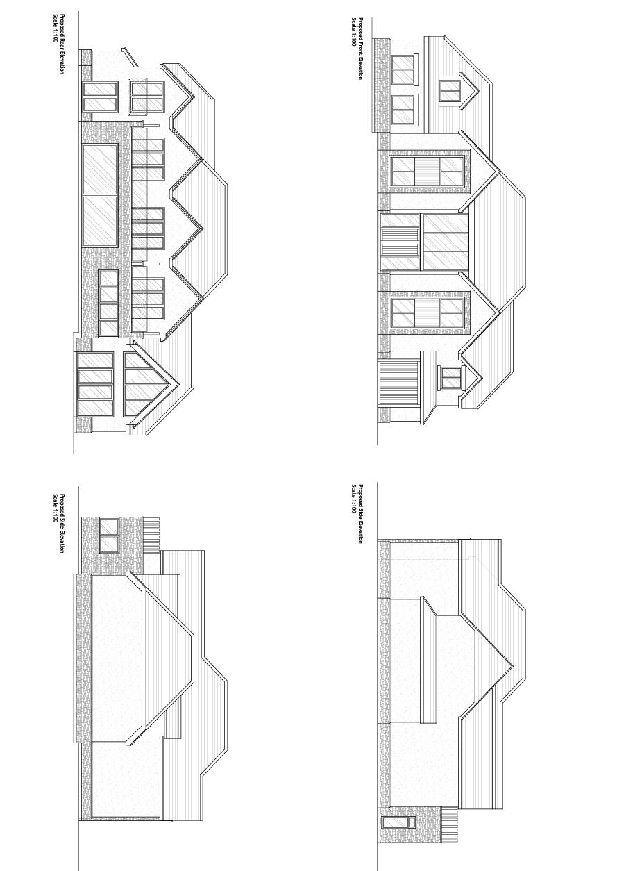

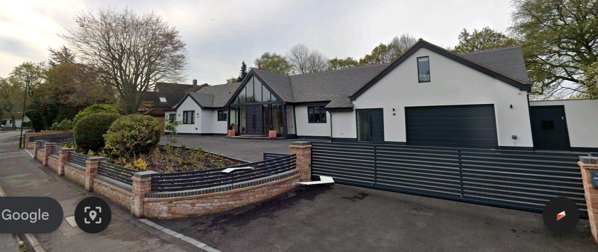

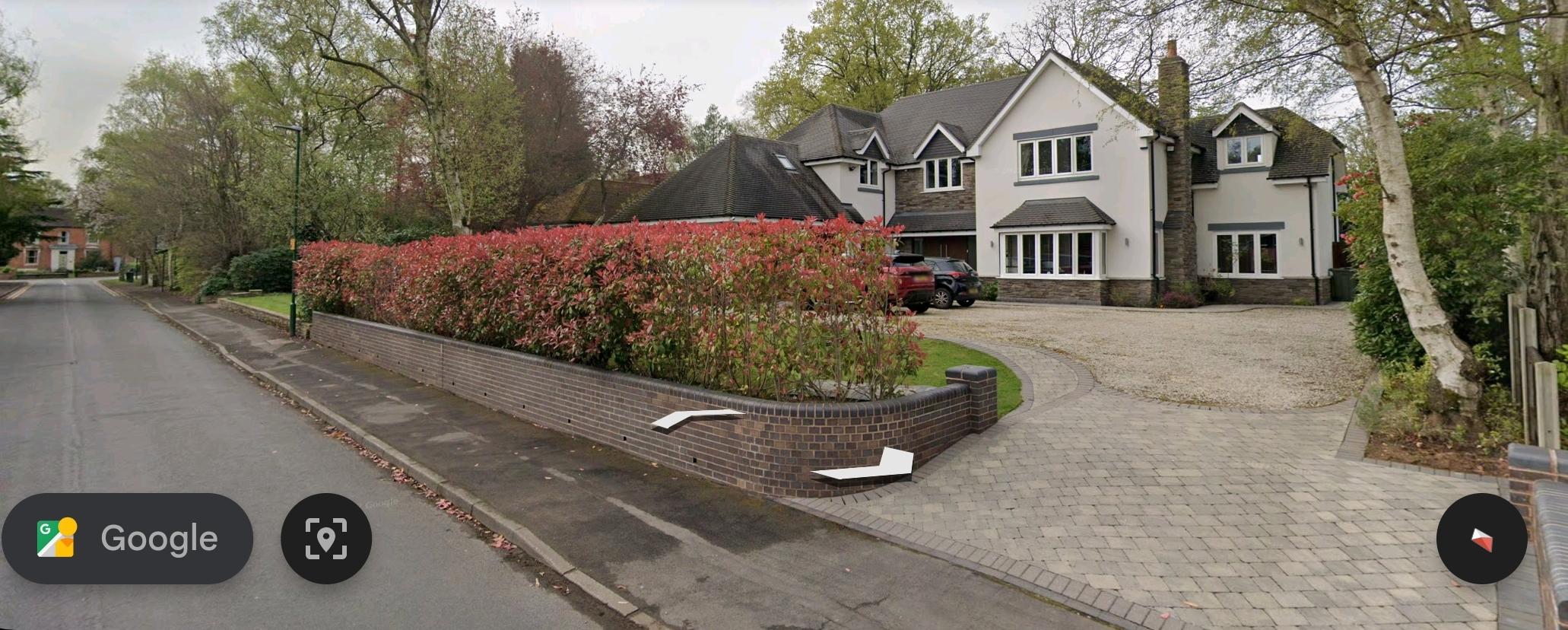

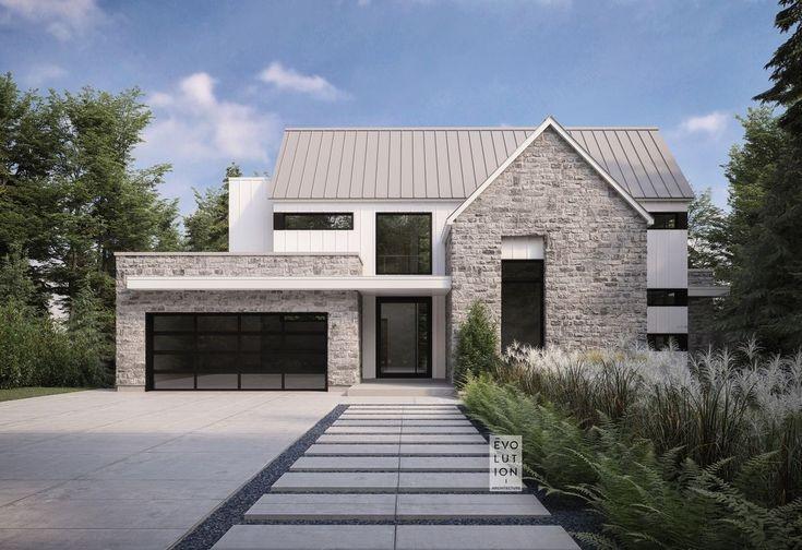

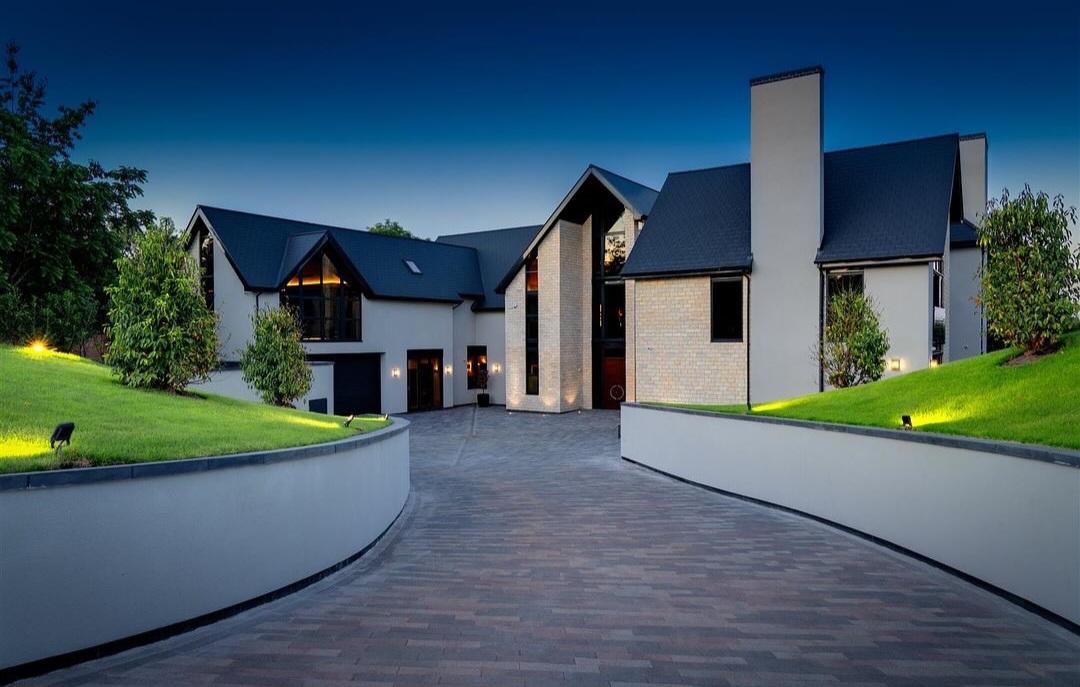

Zak S Posted March 27, 2024 Author Posted March 27, 2024 (edited) @Russell griffithsother comparable on the block are as follows. My design uses charred timber, aluminium shingle cladding but design is constrained by existing foot print of the banglow. Edited March 27, 2024 by Zak S

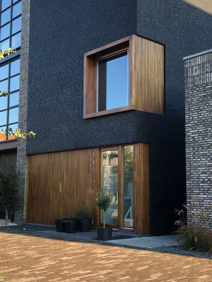

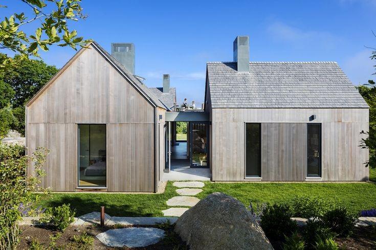

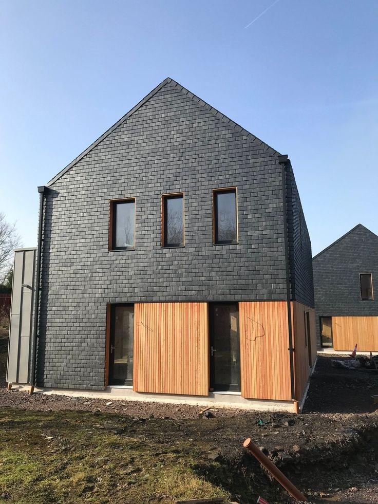

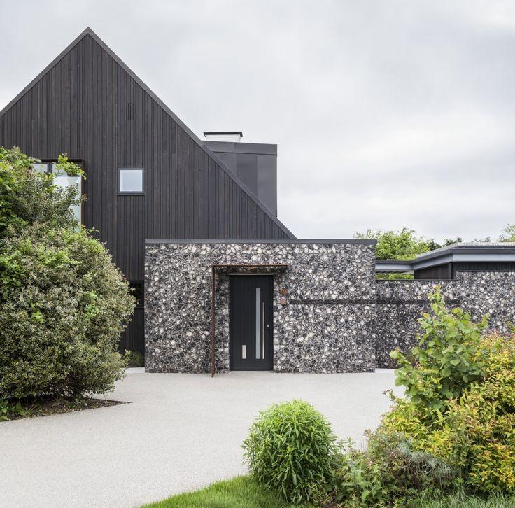

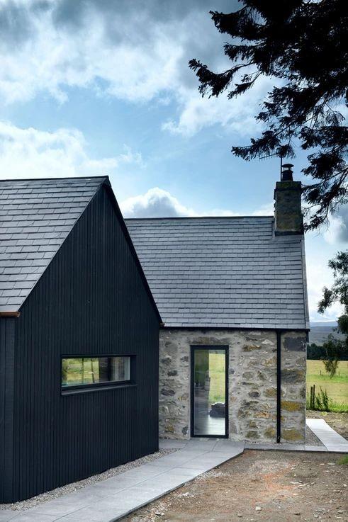

Zak S Posted March 27, 2024 Author Posted March 27, 2024 (edited) Real life images for chared timber combined with brown timber and grey bricks to bring the design proposal to life. The other options was grey weathered larch timber which is more subtle to the extent of being boring (images per below). The architect has advised that I could use render on the side elevation rather than wrap around cladding. Edited March 27, 2024 by Zak S
Russell griffiths Posted March 27, 2024 Posted March 27, 2024 Talk to an estate agent and find out how much all those neighbours houses are worth, then show him the pics of your ideas, try to get a feel for the finished value. then go from there.

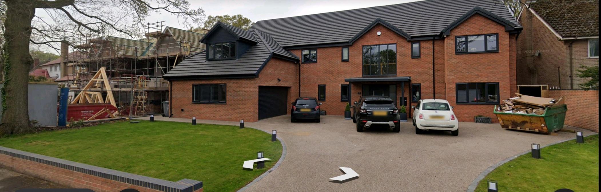

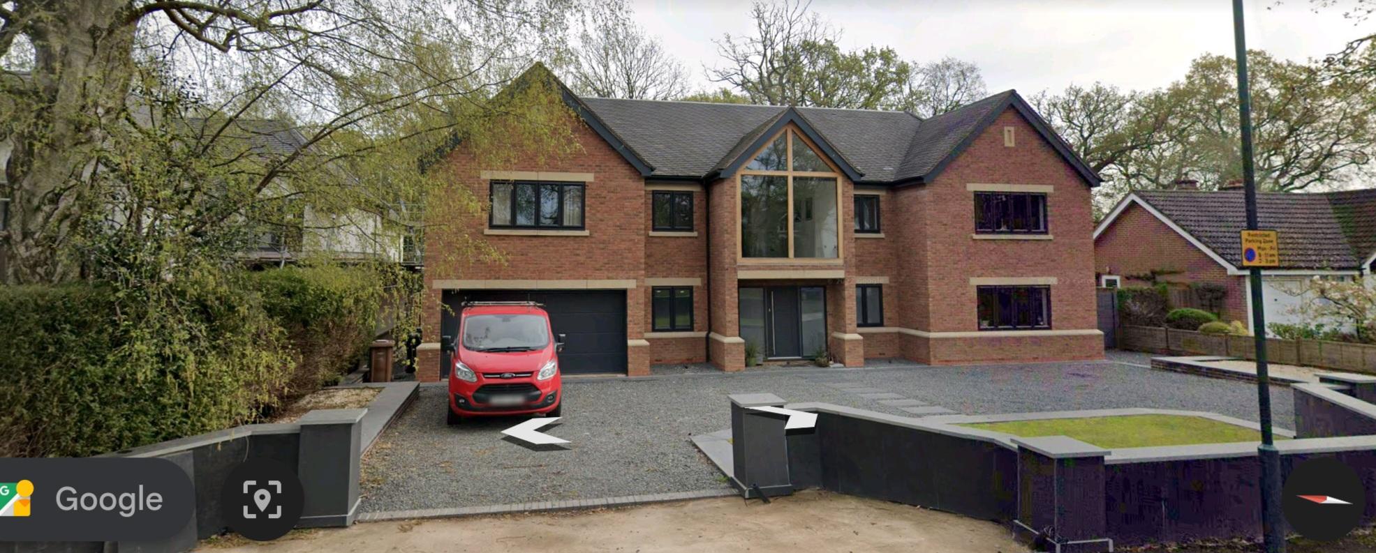

Zak S Posted March 27, 2024 Author Posted March 27, 2024 (edited) 54 minutes ago, Russell griffiths said: Talk to an estate agent and find out how much all those neighbours houses are worth, then show him the pics of your ideas, try to get a feel for the finished value. then go from there. Yes that has been done. Estate agent was quite keen and they currently marketing one in the image somewhere in Engalnd. House with red van was sold a bit unfinished for 2.3m in 2022 and new owner spent around 200k finishing off. The traditional new built houses are over £2.5m in today market. But I think value of the house is relevant if I want to sell. I don't want to sell but minimise the spend for highest value in return (yeah that million dollar question). In simple terms I can recover what I spend plus may be a bit more depending on how good the cost control and project management is. https://theagents.properties/properties/sale/edwalton/nottingham/nottingham/ Edited March 27, 2024 by Zak S
