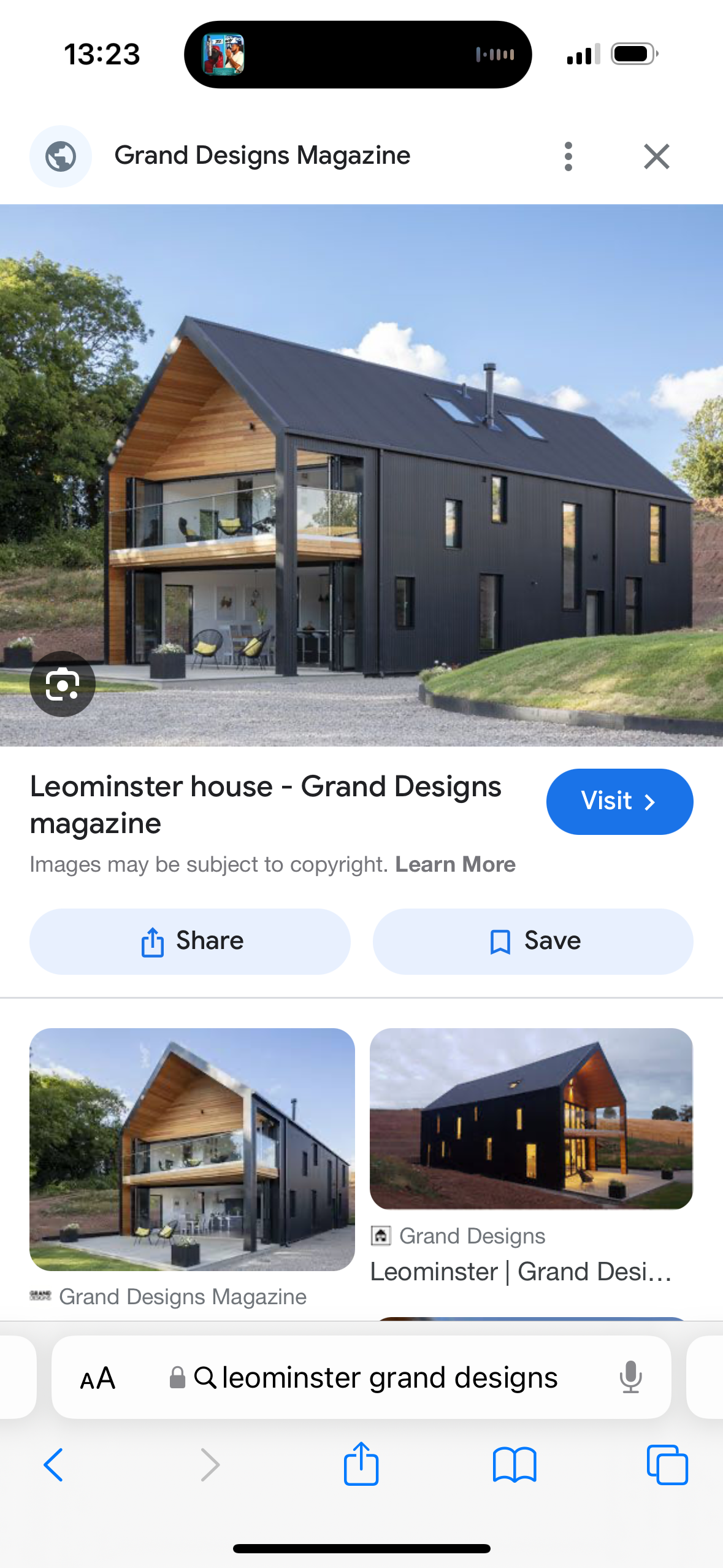

NJLJ2024 Posted March 25, 2024 Share Posted March 25, 2024 Hi all, My partner and I are in our early 30s. We have recently been gifted a modest plot of land (100sqm in total) and we are looking at a self build project. We're quickly realising the many things that need to be considered so I'm sure I'll be leaning on the forum's expertise in the coming months! The first thing we are trying to get clear on is finances... I've provided a brief summary of our situation below: Two story, two bed house - 66 sqm in total (images attached) Timber frame, timber clad eco house (though the more we research the more we are getting nervous with the 100% timber approach due to lenders classing this as non-standard construction) Partner works for a commercial construction company so there are certain things we will be able to source through them at a cheaper rate e.g foundations. He is also an ex plasterer and has good access to other tradies e.g electrians so should be able to get the costs down here Total costings have so far been calculated by us, and we are estimating around £160k - £180k. There is movement on this figure as there are certain elements we may choose to retain or strip out depending on how the deposit requirements look. We have submitted for planning permission with the council and they are in the early stages of reviewing our application We have been advised we should be able to borrow in the region of £450k and realistically we are looking to borrow a maximum of £200k. Mortgage affordability isn't an issue, but depost may be (currently have around £21k saved, but should be able to increase this to around £36k in the next 6 months as we tighten up on budgets). We were exploring the 5% help to build scheme as this looked attractive based on the low deposit requirements, however reading into this more it seems like this may not be the best route due to the interest rates being applied to the end value of the house once built. I also have a mortgaged flat with around £80k equity in it but in an ideal world I would like to keep the flat and rent it out to give us a nest egg for the future. Would be keen to get others thoughts on this - do you think this is the right approach or will we need to be 'cash rich' to be taking on a self build project? The norm for deposits seems to be 20-25% but I did come across Chorley Building Society who have a 15% option available. I've made a long list of self build lenders to work through and see if I can find any others - if you're aware of any please let me know as this would be a huge help to us considering our cash position at the moment! There is still a big question mark over whether or not a timber frame and timber clad house is the right route? I've seen one other post on here with varying opinions and I spoke with Build Store who said their lenders require at least 50% to be another material. However I spoke with Ecology at the Home Show this weekend and they don't seem to think this is would be an issue. My concern is that we limit ourselves to one or two lenders and therefore have access to worse rates/higher deposit requirements which we're keen to avoid! Does anyone have any thoughts or advice on this please? Apologies in advance if any of this is a stupid question, we're new to this so just finding out feet! Thank you Visuals.pdf Link to comment Share on other sites More sharing options...
LiamJones Posted March 25, 2024 Share Posted March 25, 2024 Hi, welcome to the forum! I can’t answer your original questions, but can provide some observation of your designs. open plan kitchen onto stairs complicates building regs means of fire escape. Certainly the back? Bedroom, the one without a window, will not meet regs. Possibly only the rooms with sliders/bifolds will meet the requirement. best of luck with your project! my one piece of advice is download Sketchup and have a play with design yourself, become familiar with he regs. you’ll learn loads and begin to think further ahead. Every job impacts a job a couple of steps down the line! If you trust trades to plan, they’ll only plan their step. Link to comment Share on other sites More sharing options...
Iceverge Posted March 25, 2024 Share Posted March 25, 2024 Welcome. A nice project. I'm a fan of small houses. I like the metal over wood aesthetic but be conscious of how you plan to weather the wood in our damp climate. It might go rather green rather quickly if you don't have a plan. I would be careful of roof lights in the bedroom. It's ok of you can reach the blinds but invariably they're too high and you'll wake at 5am in summer to a very bright room. I'm not familiar with your local planning restrictions but at the moment it looks rather more "shed like" than "house like". It might be a factor for consideration and the temperaments of planners. Over all good luck, nice to see a project kicking off. Link to comment Share on other sites More sharing options...

NJLJ2024 Posted March 25, 2024 Author Share Posted March 25, 2024 (edited) 1 hour ago, LiamJones said: Hi, welcome to the forum! I can’t answer your original questions, but can provide some observation of your designs. open plan kitchen onto stairs complicates building regs means of fire escape. Certainly the back? Bedroom, the one without a window, will not meet regs. Possibly only the rooms with sliders/bifolds will meet the requirement. best of luck with your project! my one piece of advice is download Sketchup and have a play with design yourself, become familiar with he regs. you’ll learn loads and begin to think further ahead. Every job impacts a job a couple of steps down the line! If you trust trades to plan, they’ll only plan their step. Thank you for the useful tips! We are yet to experience the fun of building regs part of this! 😆 Good point on bedroom without window - will mention this to my partner as he actually did the drawings and will be able to incorporate some changes as we liaise with the council re planning permission. Think we need to have a read up on all the regs to know what to look out for! Edited March 25, 2024 by NJLJ2024 Link to comment Share on other sites More sharing options...
NJLJ2024 Posted March 25, 2024 Author Share Posted March 25, 2024 53 minutes ago, Iceverge said: Welcome. A nice project. I'm a fan of small houses. I like the metal over wood aesthetic but be conscious of how you plan to weather the wood in our damp climate. It might go rather green rather quickly if you don't have a plan. I would be careful of roof lights in the bedroom. It's ok of you can reach the blinds but invariably they're too high and you'll wake at 5am in summer to a very bright room. I'm not familiar with your local planning restrictions but at the moment it looks rather more "shed like" than "house like". It might be a factor for consideration and the temperaments of planners. Over all good luck, nice to see a project kicking off. Yes this is a fair point! I need to do my research on what type of cladding would be most resistant to our very cold and wet climate! We are really keen on the aesthetics of the wood finish but equally need to think about the longevity of it - we saw a grand designs that had a very similar look to what we are planning and they used corrugated steel cladding, they did still have a wood like finish on the front of the house - not sure if this was timber or a different material! Good point on the roof lights also thank you! Link to comment Share on other sites More sharing options...

Bozza Posted March 30, 2024 Share Posted March 30, 2024 On 27/03/2024 at 22:38, NJLJ2024 said: With it being a rural area our thought process guided us to 100% timber at least one member here has incorporated steel cladding, to great effect. Barn style. Very cost effective. I built a barn part timber and part steel cladding and it has turned out quite nice. FYI for building regs you may require to treat timber cladding with a fire resistant coat, if near to a boundary. If that applies to use test first, as we had to replace an entire elevation because it went wrong. pinterest is great source for you for ideas. Link to comment Share on other sites More sharing options...
NJLJ2024 Posted March 31, 2024 Author Share Posted March 31, 2024 On 30/03/2024 at 09:37, Bozza said: at least one member here has incorporated steel cladding, to great effect. Barn style. Very cost effective. I built a barn part timber and part steel cladding and it has turned out quite nice. FYI for building regs you may require to treat timber cladding with a fire resistant coat, if near to a boundary. If that applies to use test first, as we had to replace an entire elevation because it went wrong. pinterest is great source for you for ideas. That’s useful to know on building regs thank you, I am hoping the timber companies that have quoted will have done this but definitely one for us to check! We saw an episode of grand designs last week and their house shape and design looks very similar to ours. They used corrugated steel cladding with timber at front and it turned out beautifully - image attached. Link to comment Share on other sites More sharing options...
