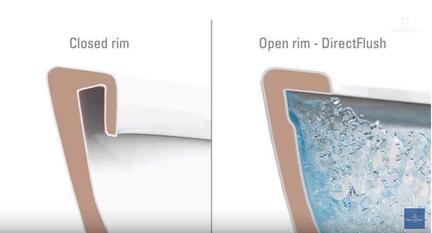

le-cerveau Posted October 6, 2017 Posted October 6, 2017 As we move towards the point of selection of sanitary ware I have been looking for the ideal toilet bowl. These will be mounted on Gebrit Sigma frames/cisterns so wall hung and I will need 6 of them! I like the concept of Rimless but worry about the splashing! However I have come across the following: Villeroy & Boch direct Flush: And the Ideal Standard Aquablade: The direct flush as the open rim to reduce/eliminate splashing, the Aquablade is a new concept, basically the next generation of the rim for better flushing. Does anybody have any experience, comments or other options?

ragg987 Posted October 6, 2017 Posted October 6, 2017 I went with the Villeroy & Boch Subway 2.0 Directflush. Looks good and flushes well with Geberit dual-flush, there is no direct splashing from the open rim. No experience of the Aquablade.

AliG Posted October 6, 2017 Posted October 6, 2017 I looked at the Starck rimless on Megabad when I was ordering my WCs. In the end I didn't go that way as I thought they looked a bit odd, it looks like they have a rim at the back but not the front. The Villeroy and Boch ones look exactly the same. They promote that they are easier to clean. I really don't think that toilets needs cleaned right up under the rim. I am not aware of toilet rims ever causing a problem in the long history of their existence. So I think it really just comes down to personal preference. Maybe they flush better by swirling the water around faster. Again I don't find any issues with current toilets so went with what I thought looked better. 1
PeterW Posted October 6, 2017 Posted October 6, 2017 Twyford and Geberit do a rimless range now as do most of the major brands. They seem more expensive but they do state that you have a max 6 litre flush on most as otherwise you can get a wet foot.....

le-cerveau Posted October 11, 2017 Author Posted October 11, 2017 I am going with the Villeroy & Boch Subway 2.0 Direct Flush, as I managed to find a bad review of the Aquablade (in German) but no real praise. SO I will stick with the fairly safe option. It will be the same setup as @ragg987, so I will wait to see how the builder/plumber manages. Thanks all for the comments.
