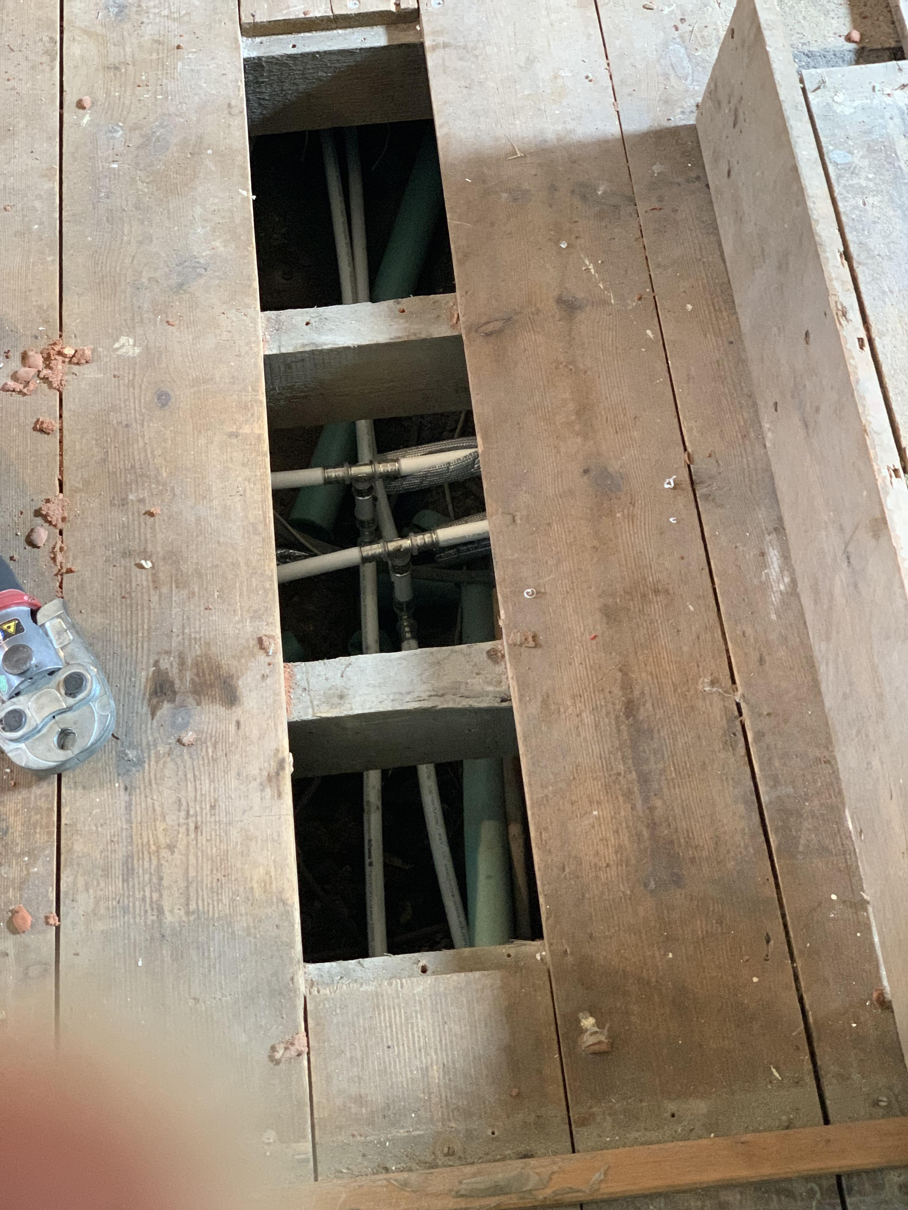

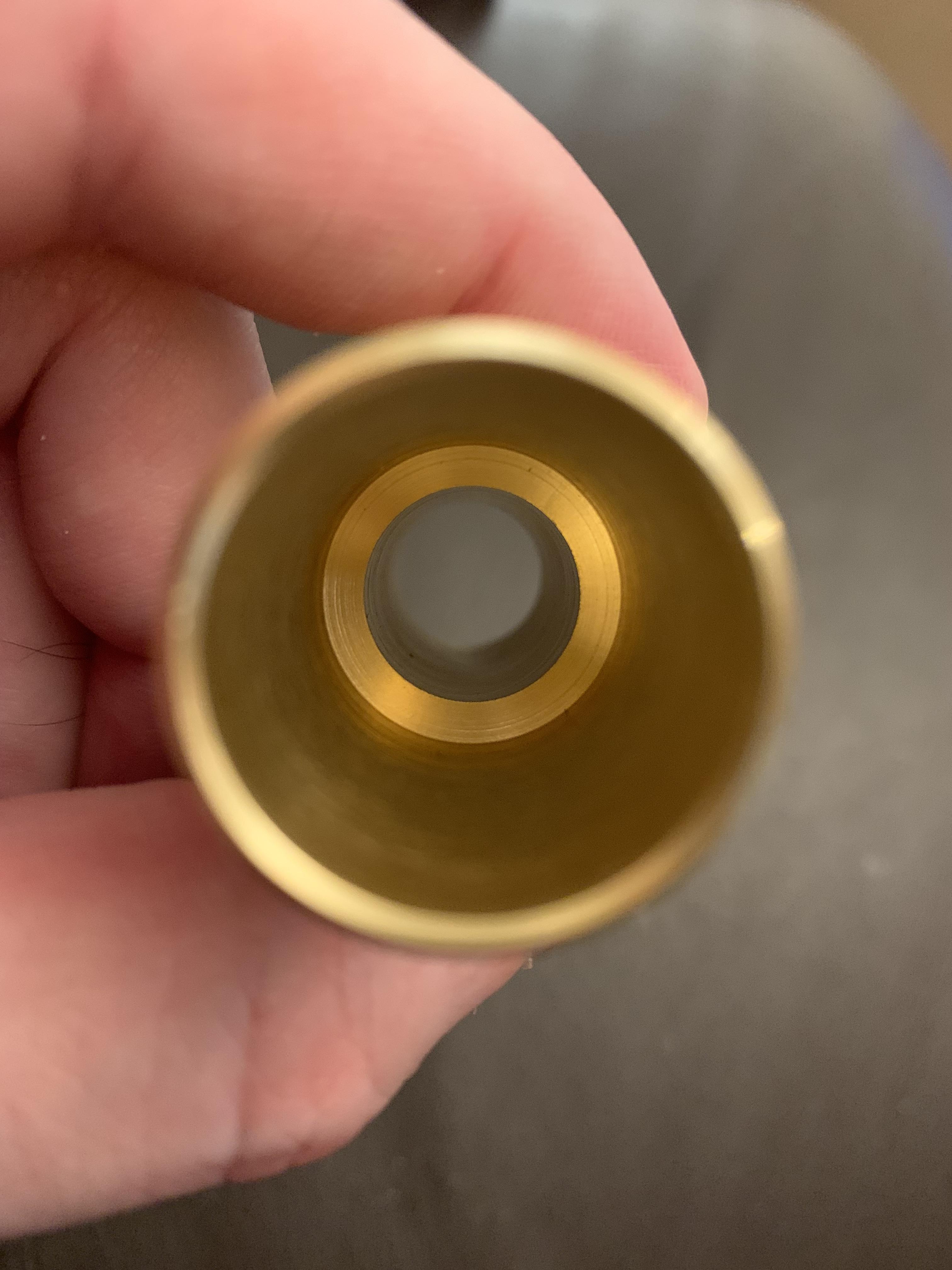

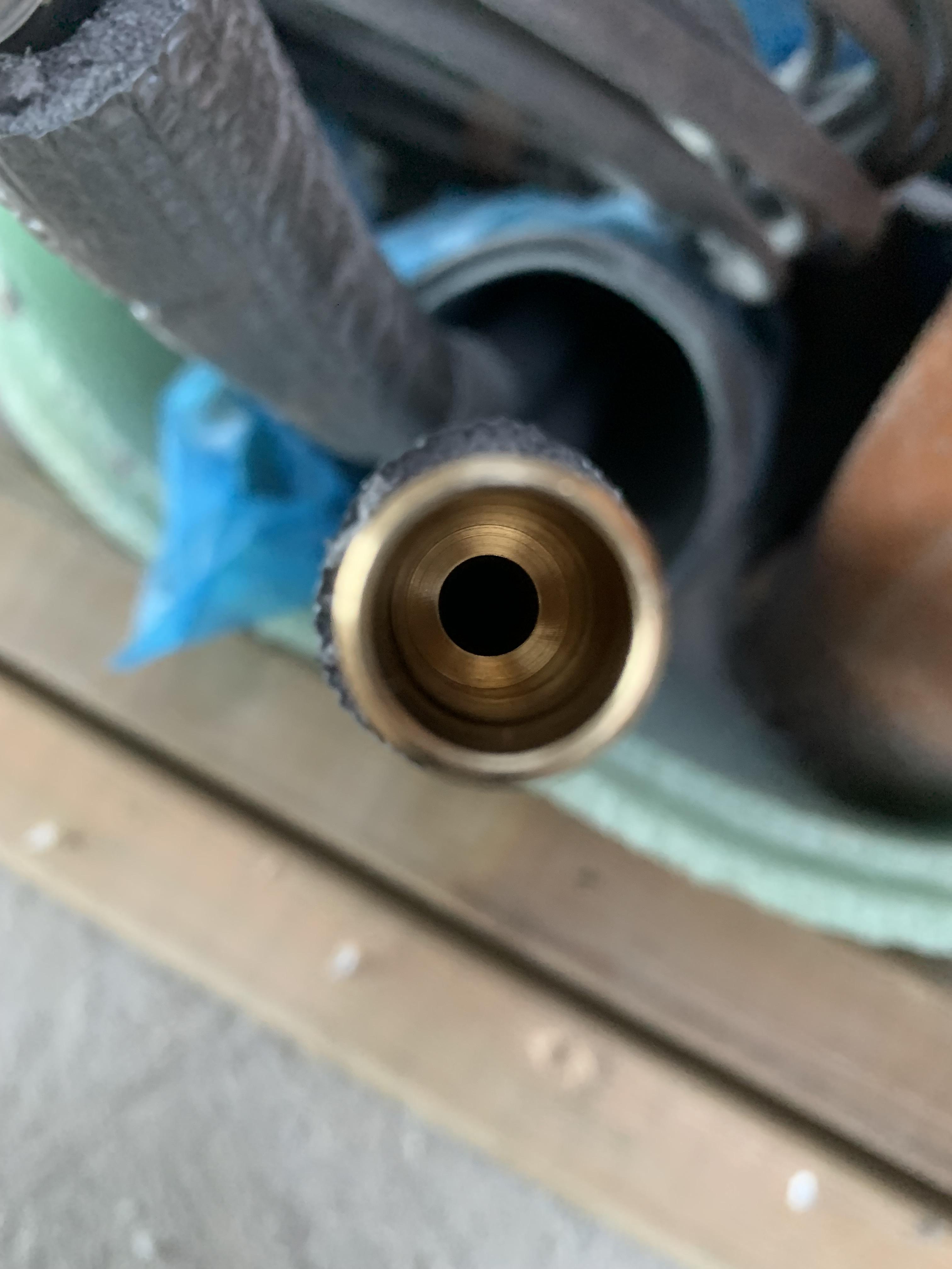

Spinny Posted March 24 Share Posted March 24 Plumber has just left a crimped join end exposed on the plumbing he is doing in my build. Photo attached. Measurements show that the external diameter of the connector is about 14mm and the internal diameter is 12mm (this is a connector on 16mm MLC pipe.) However as can be seen in the photo at the position of the pressed connector the internal bore is severely reduced - down to approximately 6.5mm internal bore. This is making me angry. How can this in any way be equivalent to 15mm copper pipe with an internal bore of around 13.5mm ? It is restricted to 6.5mm at every connection !? How can this be acceptable ? Link to comment Share on other sites More sharing options...
JohnMo Posted March 24 Share Posted March 24 52 minutes ago, Spinny said: This is making me angry. How can this in any way be equivalent to 15mm copper pipe with an internal bore of around 13.5mm ? It is restricted to 6.5mm at every connection !? How can this be acceptable The idea is there are are very few joints, the small diameter for a very short distance, although a pressure loss area in the grand scheme is very small. You would need to get the pressure table for the fitting and pipe and work it all out. Link to comment Share on other sites More sharing options...

Spinny Posted April 29 Author Share Posted April 29 So I have: 1/ Downstairs rads piped with press fit connectors 2/ Upstairs rads piped with copper Two downstairs rads won heat up properly. Impossible to achieve all 4 rads up to temp. Plumber failed to solve by rebalancing twice. On 3rd visit he has tried to con me by turning up the boiler temp to 65 when I wasn’t looking. Upstairs rads now reach 64 and pretty scalding hot. Press fit connectors/pipe clearly restrict flow and are crap. Now a major problem as floors will need to be destructively removed. I also have flow problems on the UVC where the pressure falls from 3bar to 1.4bar when a tap is turned on. This despite supply being 3.5bar and 20l/m. Again supply is linked to cylinder via 25mm MLC pipe and press fit connectors. Again the connectors must be choking off the flow with their restricted bore. Press fit inc MLC pipe is not fit for purpose (perhaps unless oversized). Is there any way to connect this pipe without using press fit restricted bore connectors ? Link to comment Share on other sites More sharing options...

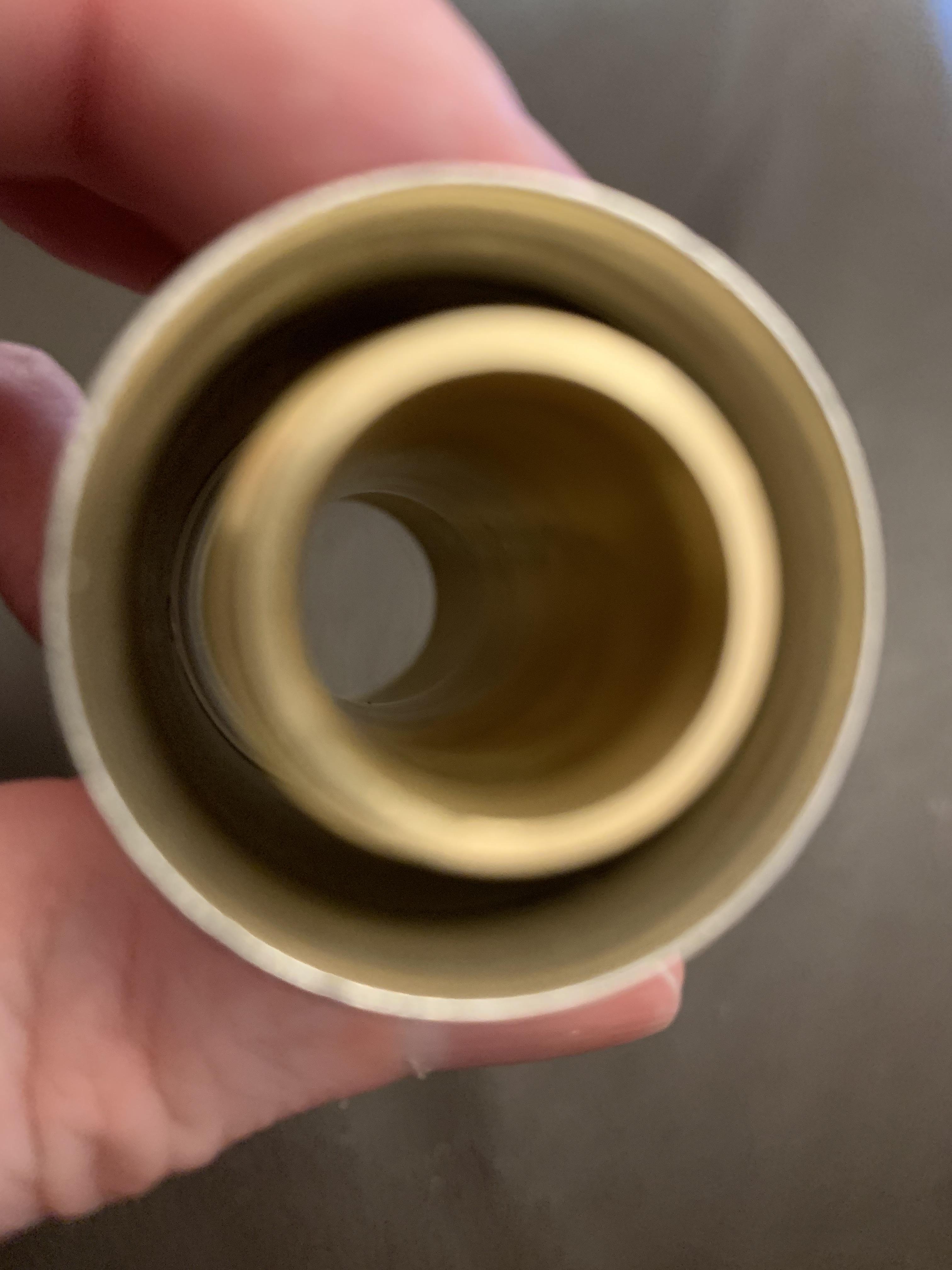

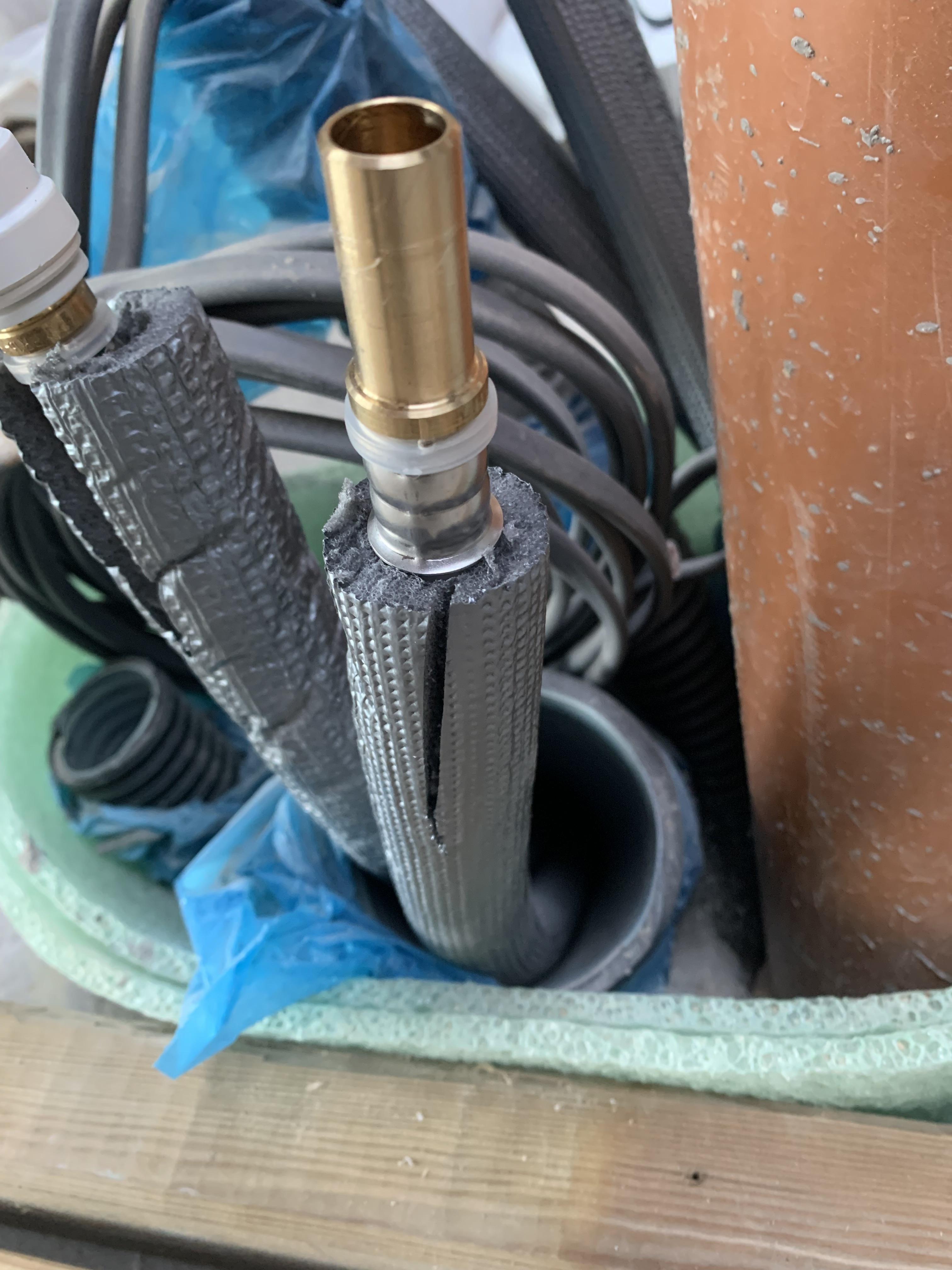

Spinny Posted April 29 Author Share Posted April 29 So went out today and bought one of the 25mm press fittings the plumber has used to terminate his MLC pipe run between mains and cylinder. It provides a tail to fit onto 22mm copper. The ID of 22mm copper pipe is 20.2mm. That is an internal cross sectional area of 320.5 sqmm. The ID of the press fitting is just 14mm ! That is an internal cross sectional area of just 153.9 sqmm. LESS THAN HALF A 22MM COPPER PIPE! Don’t let your plumber fit this crap. Link to comment Share on other sites More sharing options...
Spinny Posted April 30 Author Share Posted April 30 It’s gone quiet. Any plumbers going to comment ? How would I calculate the flow through say 4m of 25mm MLC pipe choked down to 14mm diameter at either end ? Link to comment Share on other sites More sharing options...

JohnMo Posted April 30 Share Posted April 30 4 minutes ago, Spinny said: How would I calculate the flow through say 4m of 25mm MLC pipe choked down to 14mm diameter at either end ? Not a plumber but easy enough. 1. Calculate pipe pressure drop, plenty of online tools for that. Just use the internal dia. and length. Internal dia isn't going to much different from 22mm Hep2O so you could use that as a reference. 2. Basically do the same again for the fitting at each end, but obviously a much shorter length. 3. Add the results together, covert meters of head loss. You will be surprised how little the small bore fittings make. Link to comment Share on other sites More sharing options...
