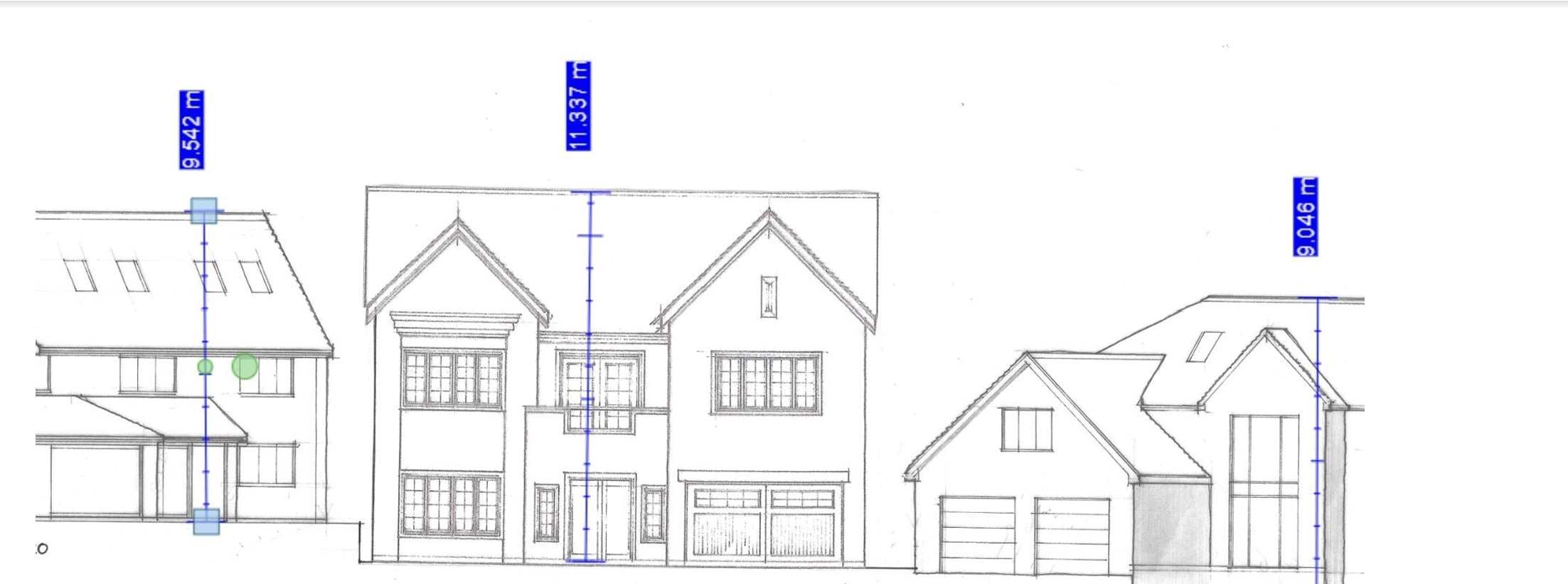

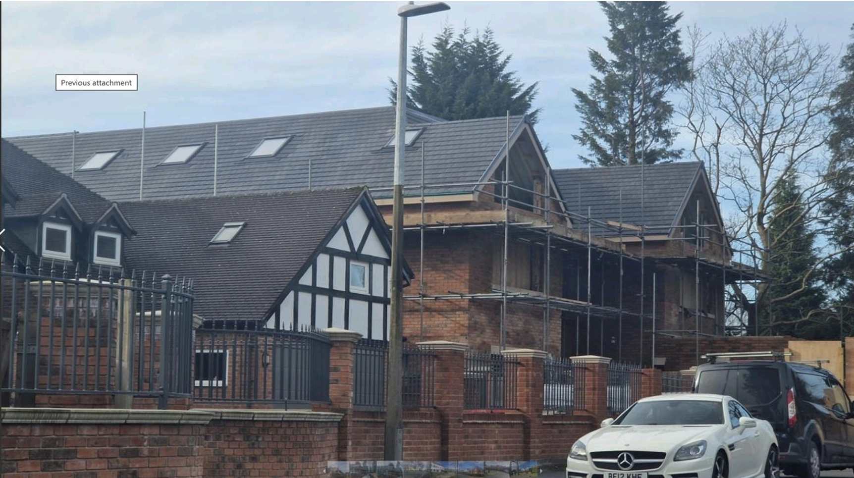

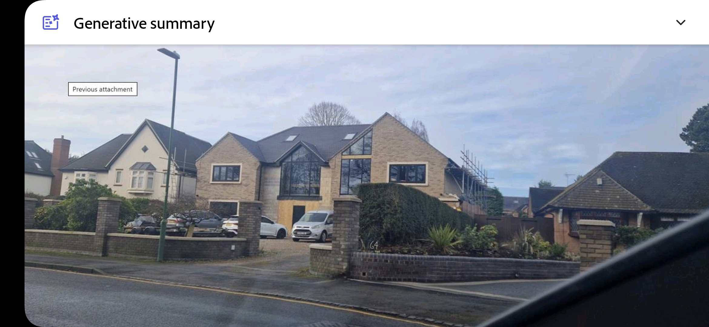

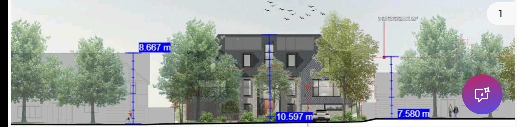

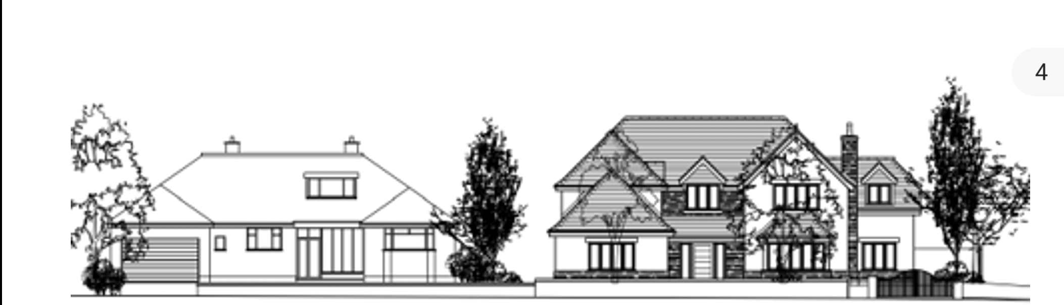

Zak S Posted March 18 Author Posted March 18 7 hours ago, JamesP said: An extension to a bungalow. Mass = Volume. The footprint looks about 50% larger than the original. Your loft space is a second floor. Ridge height relative to neighbouring properties? Your neighbours and planners are correct but carry on, you will get there. There are so many precedents where ridge height for new development are higher than immediate neighbours including one right in front of my house (newly build) by aprox 1m. Other examples are in some cases two meter higher. One of the point raised was that loft makes it three storey. But looking at the precedent on the street these either opposit of 5 houses away please see attached. First image is that of proposed as per my planning application. But the rest are neighbouring. What should be the key amendments?

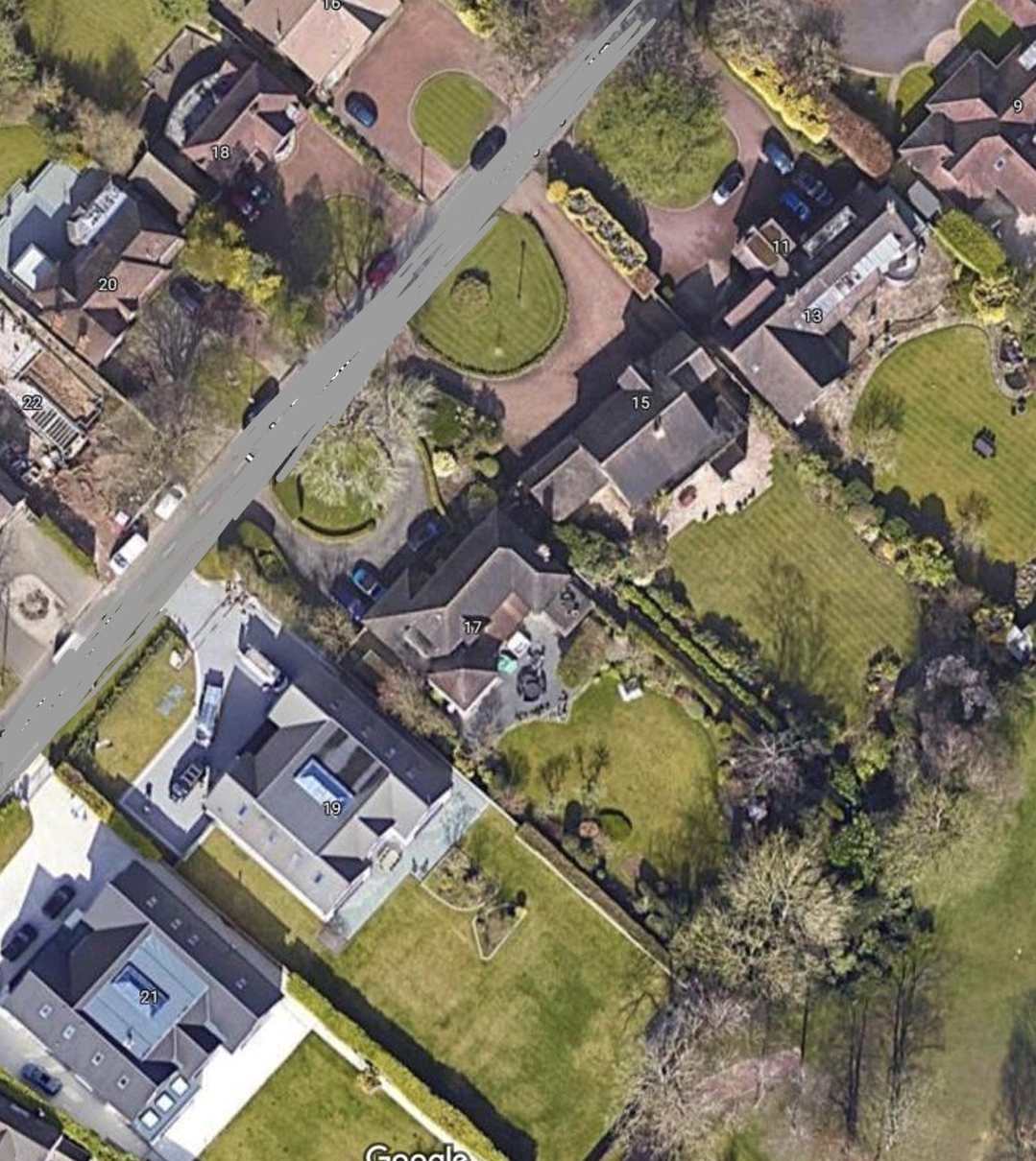

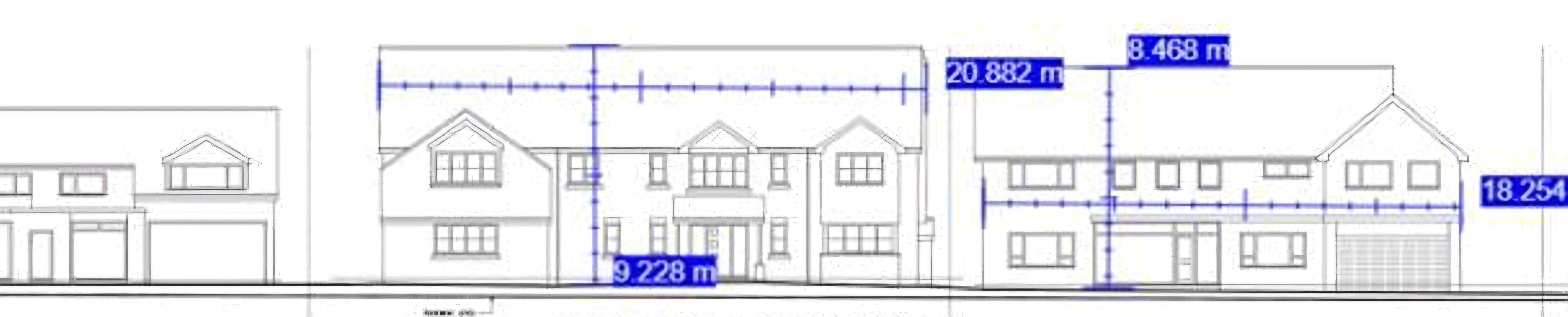

Zak S Posted March 18 Author Posted March 18 (edited) Some other examples in the area which highlight the mass and the design approach v neighbours. My architect thinks that planning officer chickened out due to various objections but to some extent I take it as a positive that we have a opportunity to better the design and material choice. I don't want to be limited to immediate neighbours in terms of Mass and ridge height and need some flexibility there. Otherwise application is decided on the basis of what neighbours had done rather than on its own merit (within reasonable limits) and ignores the precedents in the neighbourhood. First image (the middle property) used to be banglow and they obtained householder permission for building up/extension and loft space so similar to my application Edited March 18 by Zak S 1
Nestor Posted March 18 Posted March 18 Morning @Zak S, Thanks for the reply and images, they really help your application in context to existing properties. I think your architect is correct and knows how to proceed and in time the planners will grant permission. My own application took nearly 6 years without any objections, awkward planning officer and in a National Park.
Iceverge Posted March 18 Posted March 18 There is two real reasons that all the neighbours objected. 1. It's higher and appears more massive than their houses. 2. It's an ugly Frankenstein. with bad proportions and an ungodly mess of materials. You are the guy turning up to the classic car meeting in a Monster truck covered in LEDs and blaring speakers. You need to read the room before you apply again and try to fit in rather than bending the world to fit your will. You could fight it legally but I'm guessing those houses are full of bored spouses who would love a cause to rally behind and have the lawyers and cash to delay you for 10 years. For the millionth time demolish and build fresh. This is a multi million £ house. Incorporate a basement and drop the ridge height to about 8.5m to match the house to the left of yours. Give you architect some more breathing space and see what they come up with. 1
