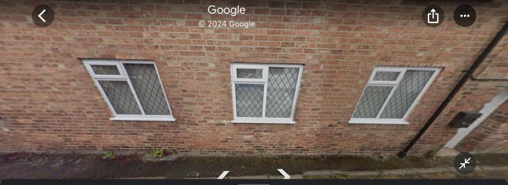

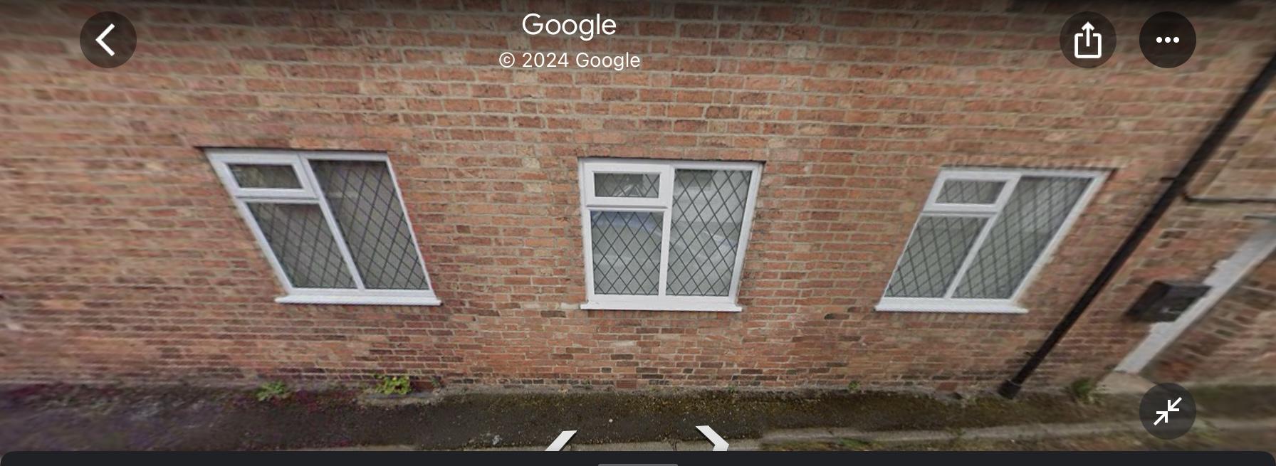

Laurence737 Posted March 21, 2024 Share Posted March 21, 2024 Hi Everyone, we are trying to resolve some damp/efflorescence issues with our 1860’s property. we are getting high damp readings and efflorescence on our external road facing wall, I think the problems stem from the fact that the council put in a small pathway abutting the external wall and laid asphalt between the house and kerb, this has raised the level against the wall and is causing water to sit in the gap between the asphalt and brickwork resulting in the wall being constantly wet. we also have an enclosed gulley that may be adding to the problems. What would be the best solution for this, I imagine cutting a drainage gulley in front of the brickwork? But guess this would have to be a gravel soakaway? As the air brick surrounds would block a dedicated drainage channel? I would also like to remove the enclosed gulley and replace it with an open one that is easier to check for blockages/clean, is this a viable idea? I also think that we have some concrete pointing in the brickwork, would it be worth the time/money to get this removed and repointed? Thanks a lot for any feedback/advice! Link to comment Share on other sites More sharing options...

Redbeard Posted March 21, 2024 Share Posted March 21, 2024 If by 'gravel soakaway' you mean a French drain, they only really work with a perforated pipe at the bottom *and an exit*. A French drain without an exit is arguably a moat. Your text suggests a newly-laid path, but the pic suggests a not-newly-laid path. Can you clarify? How much have they raised the level? Link to comment Share on other sites More sharing options...

Dave Jones Posted March 23, 2024 Share Posted March 23, 2024 hard to tell but it looks like some repointing has happened in cement mortar, this will trap water in and force it through the inside. very common with 9" solid walls which yours almost certainly is from that period. Check its all lime for starters. May have a slate dpc but unlikely, our 1899 has nothing including no footing. Brickwork should resist being soaked and dry out, if water cannot escape through the front due to modern cement it will go through to the inside. Link to comment Share on other sites More sharing options...
SteamyTea Posted March 23, 2024 Share Posted March 23, 2024 Why is the right hand side/edge a lot darker? Link to comment Share on other sites More sharing options...
Conor Posted March 23, 2024 Share Posted March 23, 2024 1 hour ago, SteamyTea said: Why is the right hand side/edge a lot darker? Street view image stitching. Two different exposures. Link to comment Share on other sites More sharing options...
saveasteading Posted March 23, 2024 Share Posted March 23, 2024 Do I see an air brick or two? If so they seem very low and water could be running in. Link to comment Share on other sites More sharing options...
SteamyTea Posted March 23, 2024 Share Posted March 23, 2024 42 minutes ago, Conor said: Street view image stitching Ah yes, looks quite different on my laptop compared to the phone. Link to comment Share on other sites More sharing options...
Laurence737 Posted March 25, 2024 Author Share Posted March 25, 2024 On 23/03/2024 at 18:57, saveasteading said: Do I see an air brick or two? If so they seem very low and water could be running in. yes, it looks like the brick surrounds of the air bricks were put in to keep them exposed when they installed the pavement. Link to comment Share on other sites More sharing options...
Laurence737 Posted March 25, 2024 Author Share Posted March 25, 2024 On 23/03/2024 at 07:42, Dave Jones said: hard to tell but it looks like some repointing has happened in cement mortar, this will trap water in and force it through the inside. very common with 9" solid walls which yours almost certainly is from that period. Check its all lime for starters. May have a slate dpc but unlikely, our 1899 has nothing including no footing. Brickwork should resist being soaked and dry out, if water cannot escape through the front due to modern cement it will go through to the inside. Yes we can’t see any evidence of a DPC on any of the other walls, if I tried to remove the cement mortar and repointed in lime would this be a better solution that trying to fix the ground based problem? and yes it is 9” solid brick Link to comment Share on other sites More sharing options...
