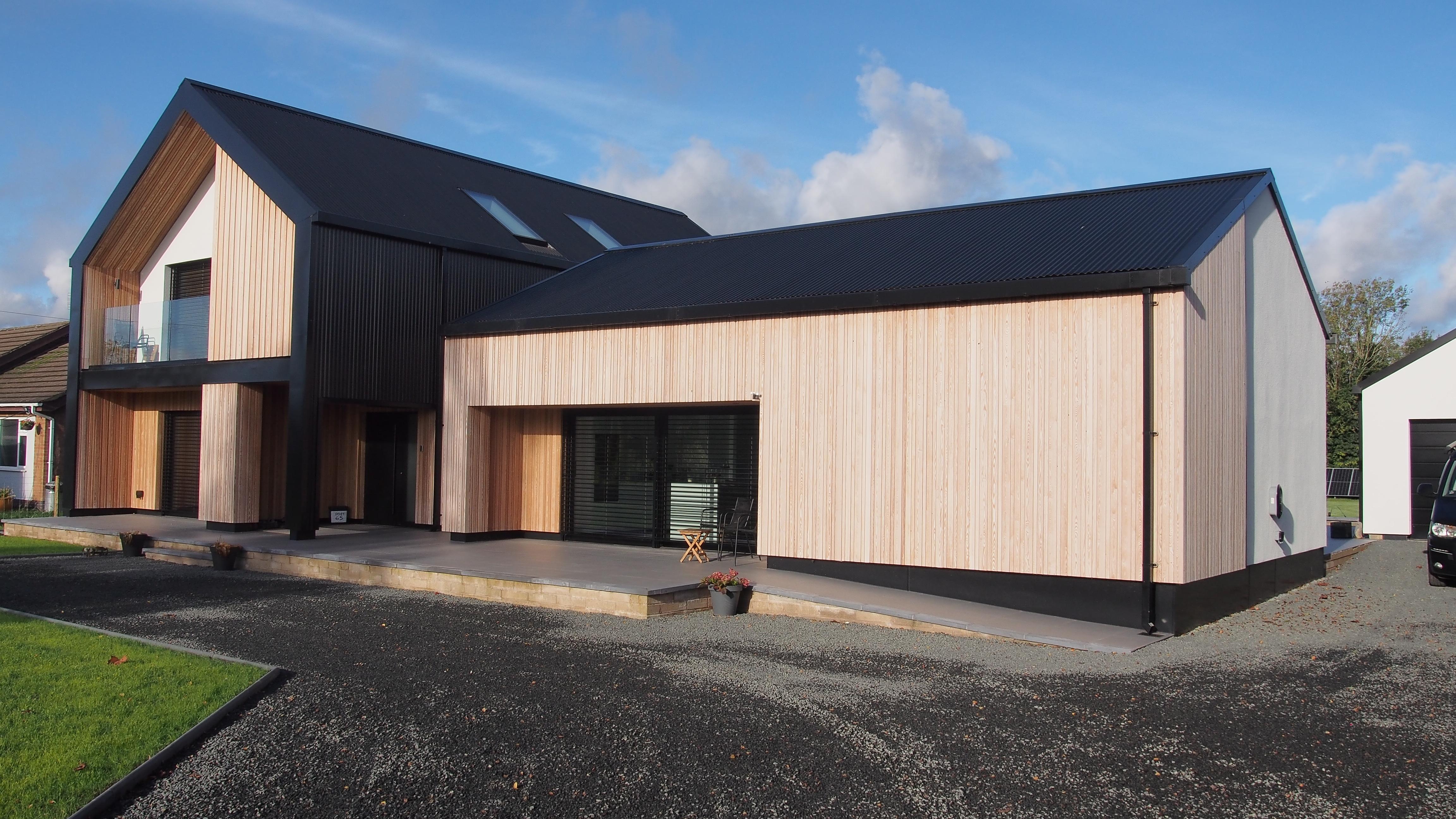

Bramco Posted March 21 Share Posted March 21 13 hours ago, davelank said: A concern is overheating and an option is to have some sort of brise soleil on ground floor windows and overhang for the master bedroom with the gable roof. We will look to have openable windows that allow cross flow of breeze where possible. Overhangs are great - in the summer months, the sun is too high to give much solar gain and in the winter months you get the solar gain. Add external blinds and you can control the solar gain. We've found that with the blinds level, then they start to stop the sunlight at around the now, the spring equinox and start to let it in again at the autumn equinox. See attached image. All the south facing rooms on the front have external blinds. More photos here -> https://lhc.net/projects/ashcroft-creating-a-low-energy-family-home/ Personally, I'd try to future proof by having a master bedroom + en-suite downstairs and forget the lift idea. Link to comment Share on other sites More sharing options...

LnP Posted April 6 Share Posted April 6 On 21/03/2024 at 07:43, Bramco said: Add external blinds and you can control the solar gain. We've found that with the blinds level, then they start to stop the sunlight at around the now, the spring equinox and start to let it in again at the autumn equinox. See attached image. All the south facing rooms on the front have external blinds. More photos here -> https://lhc.net/projects/ashcroft-creating-a-low-energy-family-home/ @Bramco would you mind sharing what blinds you chose, what were the criteria in your selection, what other ones you considered etc? Thanks Link to comment Share on other sites More sharing options...
Bramco Posted April 7 Share Posted April 7 @LnP We used Hallmark blinds -> https://www.hallmarkblinds.co.uk/ . There are other members that have used them as well. I think they are manufactured in eastern Europe, Poland? It's about 3 years ago now that we were looking, so things may have changed a bit but back then, there didn't seem to be many (UK) suppliers. External blinds are common on the continent but here, they seem to be only used on commercial premises. Some of the companies we identified had UK websites but didn't seem to have any suppliers. Our criteria were size, we've got some pretty big apertures we needed to cover and price. I don't think there's a great deal of difference between different makes when it comes down to the slats etc. They all seem to use Somfy for the controllers. Ours are all on sliding doors, so if you want to, you can open the door a bit to get some through breeze in the summer, although the downstairs overhangs on our build mean that in the summer, the sun doesn't shine into the rooms if we have the blinds up. Hope that helps Simon 1 Link to comment Share on other sites More sharing options...
