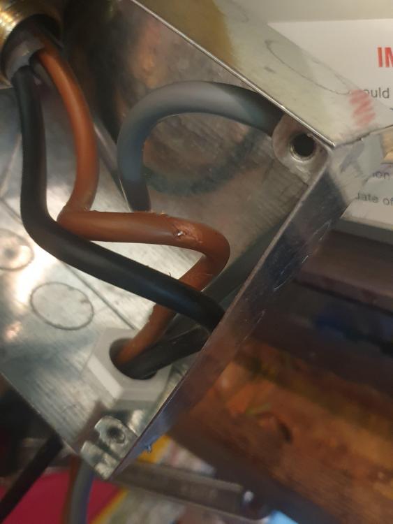

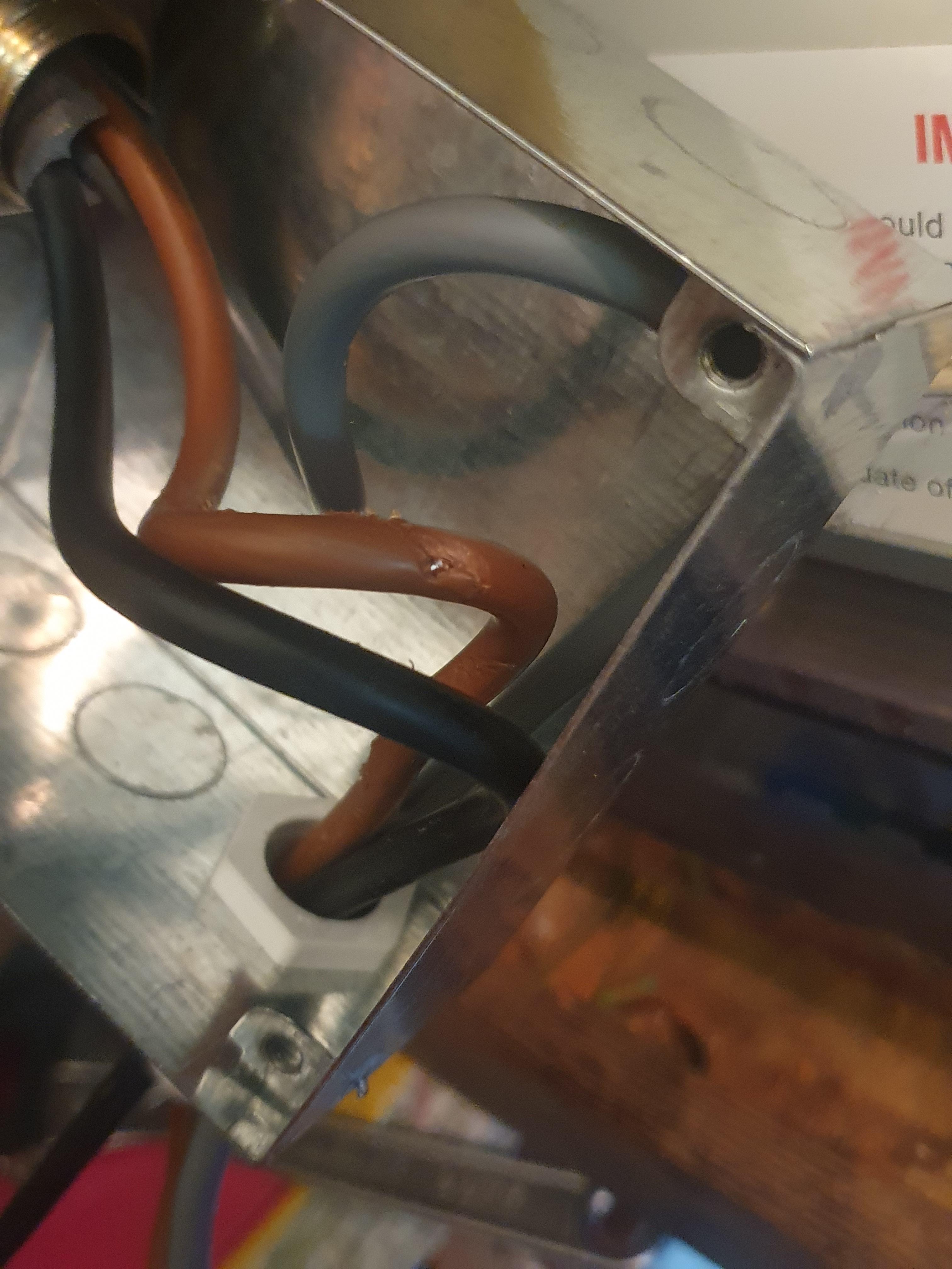

jpadie Posted March 20 Share Posted March 20 hello all annoyingly, after a morning of struggle with getting a long length of 16mm2 three core SWA into a junction box, just at the end in despair I used some grips to help bend a conductor and this removed some of the insulation. Is there an approved way of repairing this (tape or heatshrink) or so I need to splice and mechanically join a new length? second question is whether these conductors need earth and neutral sleeving in the CU and in the junction box (existing CU at one end, new remote CU at the other)? thanks Justin Link to comment Share on other sites More sharing options...
markc Posted March 20 Share Posted March 20 This is one of those what should you do? What would you do questions. Good few wraps of insulting (insulating) tape and you will be ok. As you are using a core for earth then yes tape or sleeve to identify. Link to comment Share on other sites More sharing options...
garrymartin Posted March 20 Share Posted March 20 Heatshrink would be preferred assuming the conductor itself is not damaged. Good-quality PVC tape at a push. https://engx.theiet.org/f/wiring-and-regulations/24396/repairing-insulation You do need to sleeve the conductors with the correct colour sleeving for their function. Link to comment Share on other sites More sharing options...
jpadie Posted March 20 Author Share Posted March 20 thanks both. conductor is not damaged - i've had trouble with tape staying on for more than a year in the past. somehow the adhesive seems to age and then the slightest bump knocks it off or loosens it. maybe the quality of the tape I tend to use? grey core for earth and the black for neutral. I will sleeve both in the CUs. do they need sleeving in the junction box too for reg-compliance? Link to comment Share on other sites More sharing options...
garrymartin Posted March 20 Share Posted March 20 Hence the "good-quality" comment 😉 I use 3M insulation tapes and have never had an issue. Is it a junction box? It doesn't look like you are making any connections in the photo; it appears to be a pass-through of the conductors only. If it is a pass-through, then not required to sleeve them but nothing to stop you from doing it if you so wish. Link to comment Share on other sites More sharing options...

FuerteStu Posted March 20 Share Posted March 20 As a commercial/industrial spark who spends most of his days working on armoured.. Sleeving (identifying) the cores is just part of the job. Many multi core (more than 5) armoured cables are white core only and numbered. It's always grey (blue sleeved) used for neutral. The phrase 'deneutralise the black'. Was just a way of making people remember. Modern apprentices just say "black is cpc, just like the armour". Heat shrink the damage, live and learn. If you need to bend the cores in future, use the handles if the pliers, not the metal ends. 1 Link to comment Share on other sites More sharing options...
