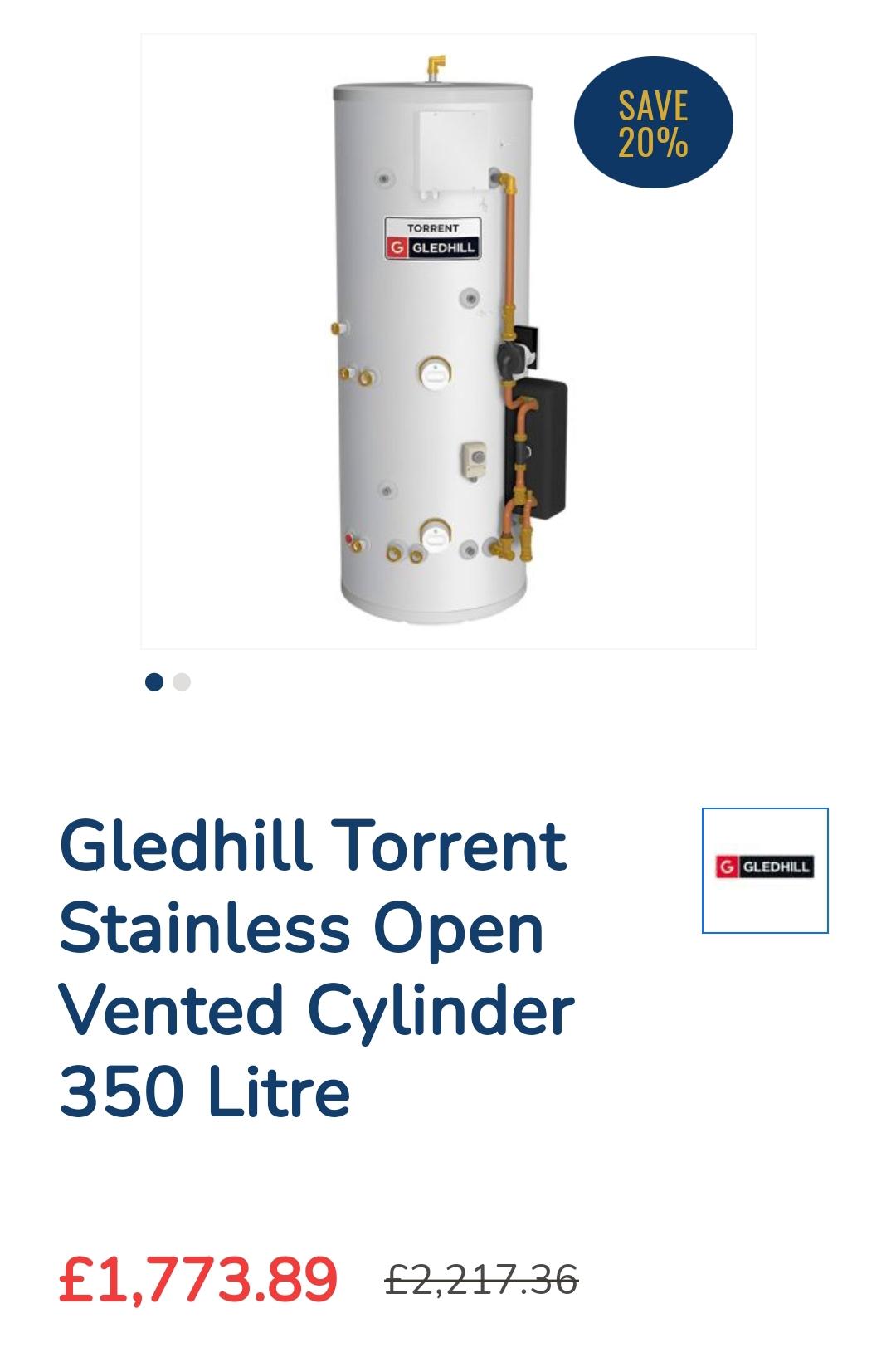

JohnMo Posted May 2 Share Posted May 2 (edited) 1 hour ago, JamesPa said: I am convinced there must be a better solution to ensure the safety of a uvc than the current one, particularly when used with an ashp which is incapable of boiling the water. The discharge pipework is a major hurdle for retrofit situations The alternative has always existed Vented or thermal store, such as a Harlequin - no discharge piping, no G3. Fit for purpose, vented is what most old houses have anyway. 1 hour ago, JamesPa said: use a Willis heater located elsewhere as a backup) then any number of safety features could be added to ensure water reaching the DHW heating coil never goes above say 75C Same as an immersion in cylinder just moved so it doesn't sound as bad - same effect on UVC if it goes wrong. You keep trying to reinvent a wheel which is never going to happen. If don't want G3, use a different technology that doesn't need it. Edited May 2 by JohnMo Link to comment Share on other sites More sharing options...
