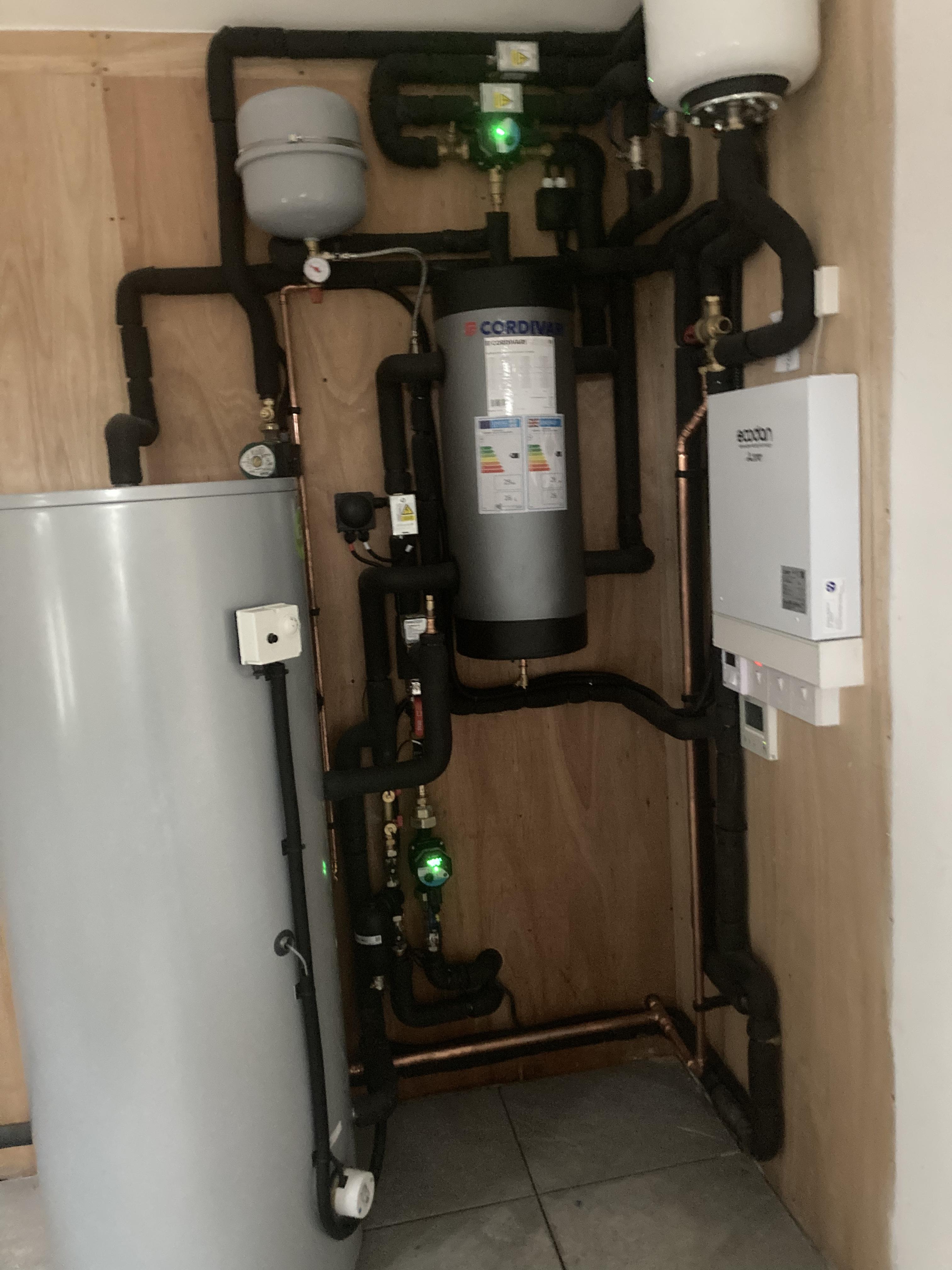

When I compared my boiler and ASHP install. If I had just installed the ASHP and not the boiler, my overall cost delta, would have been an additional £500 for the heat pump. No grants taken.
New build, heating system and plumbing is the same cost, cylinder the same cost. So the only change for me was the cost of the ASHP over the boiler I purchased and some additional outside pipework.
Shop around. You really don't need to pay Vaillant prices.
Hi, I notice on the picture it has a small buffer / low loss header installed.  Is this a specific requirement for Mitsubishi Ecodans?   My preference for our install is open loop no low loss header, underfloor manifold pumps, mixer etc.
Price wise look at other thread, just about to update with brilliant quote / method of obtaining BUS grant etc
