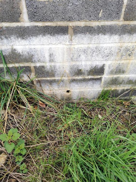

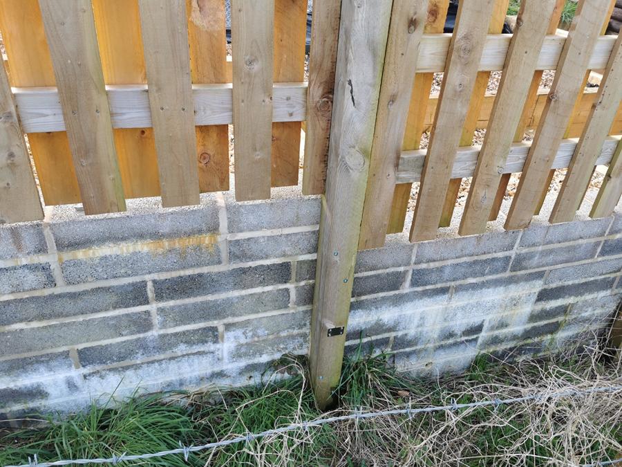

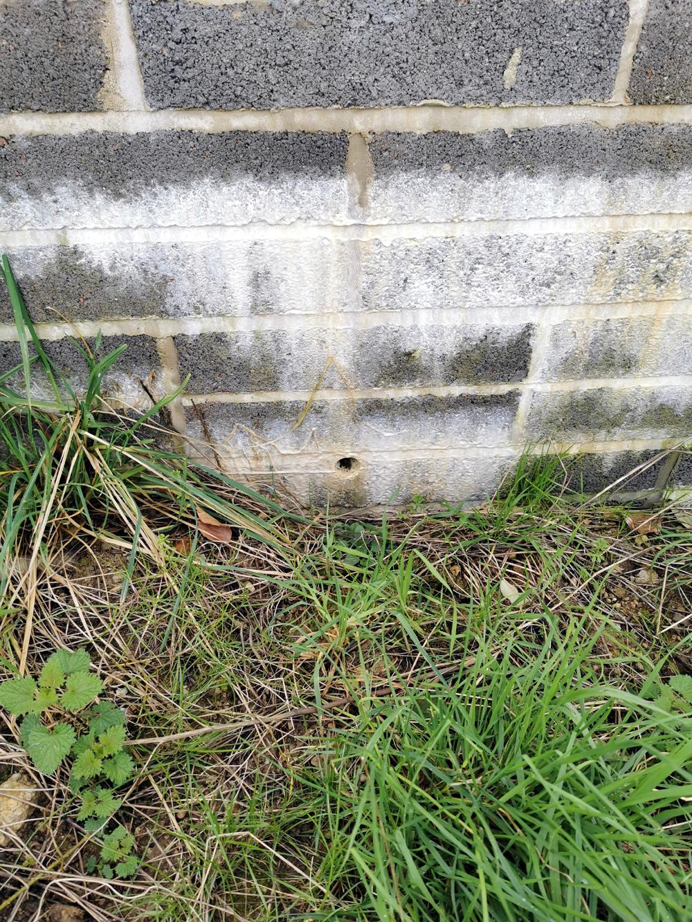

Steve06 Posted March 9, 2024 Posted March 9, 2024 Hi, My name is Steve and thank you for accepting me into this forum. I have a efflorescence question please. We have a retaining rear garden wall that is two years old but has an efflorescence issue. I have two questions please. What is the best way to remove this? How can I stop it returning? Thank you.
nod Posted March 9, 2024 Posted March 9, 2024 Brick acid mixed 3-1 with water Unfortunately You can’t stop it 1 1
Onoff Posted March 9, 2024 Posted March 9, 2024 Brick acid as above. The concrete sealer your side only. Should push the issue next door. 1
Steve06 Posted March 9, 2024 Author Posted March 9, 2024 Thanks guys. Can this 'reaction' weaken the wall, perhaps create cracks... it is a retaining wall? 🥺

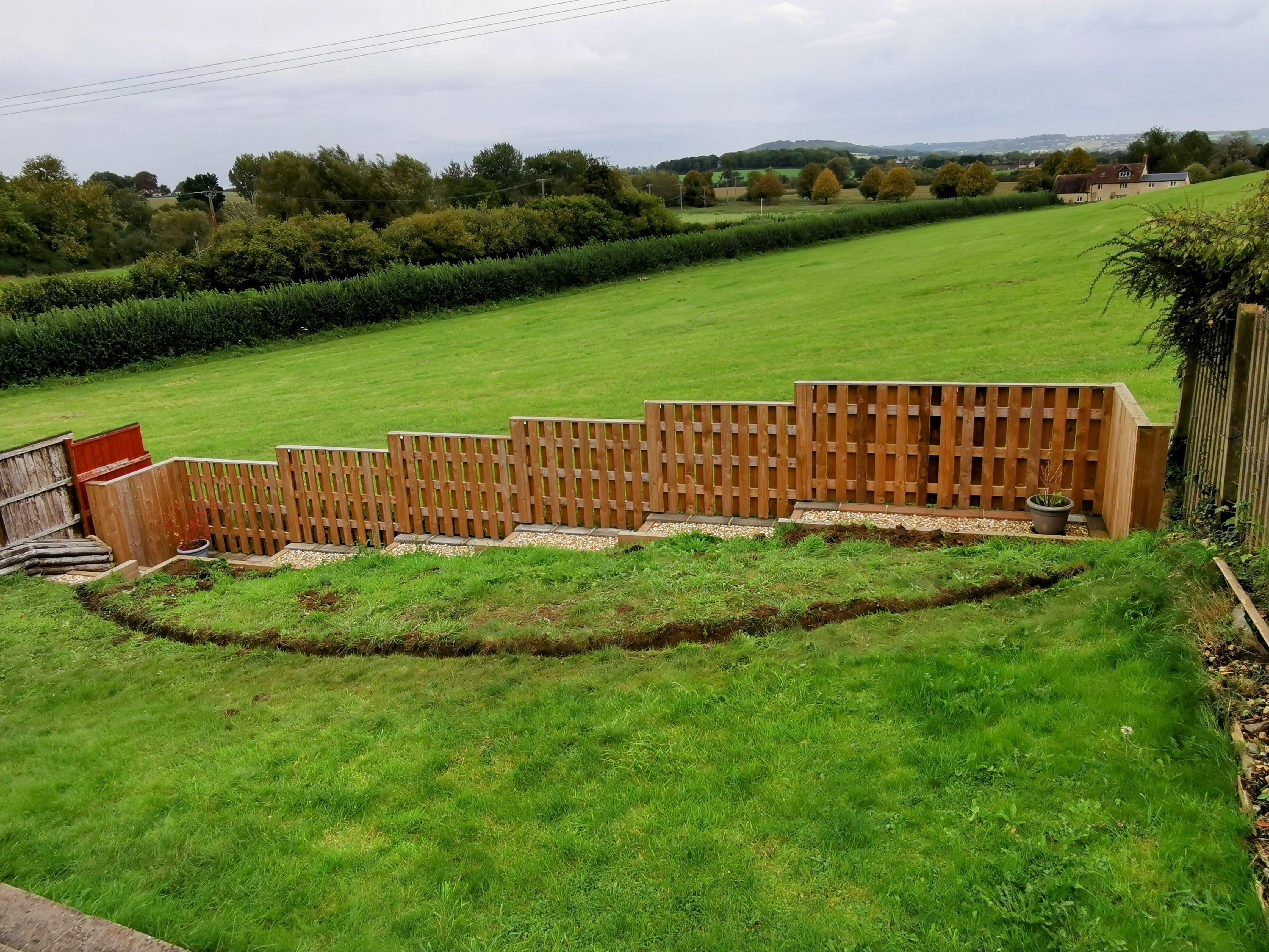

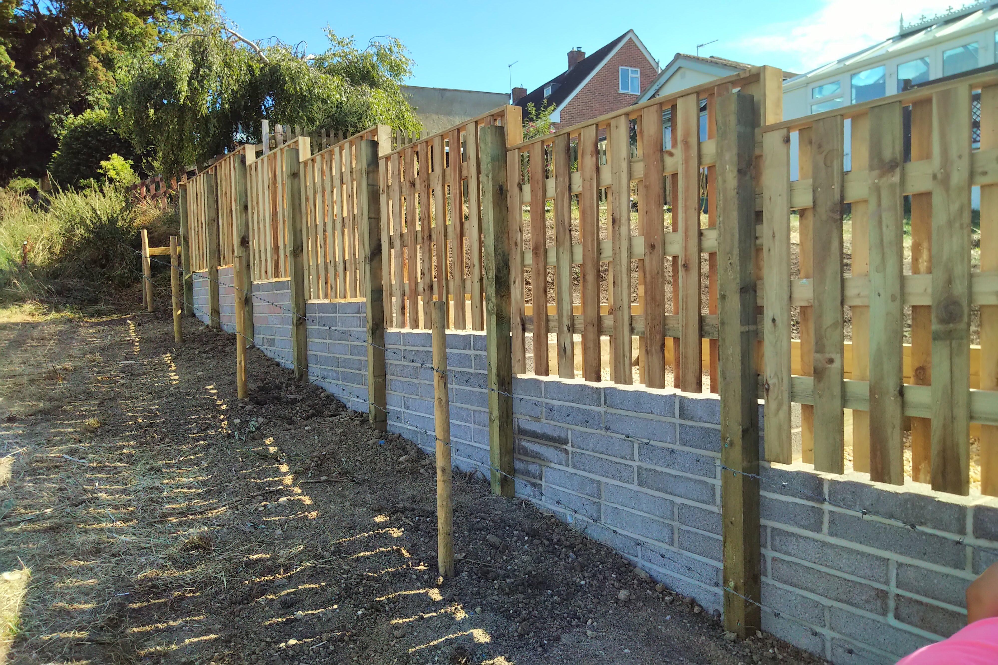

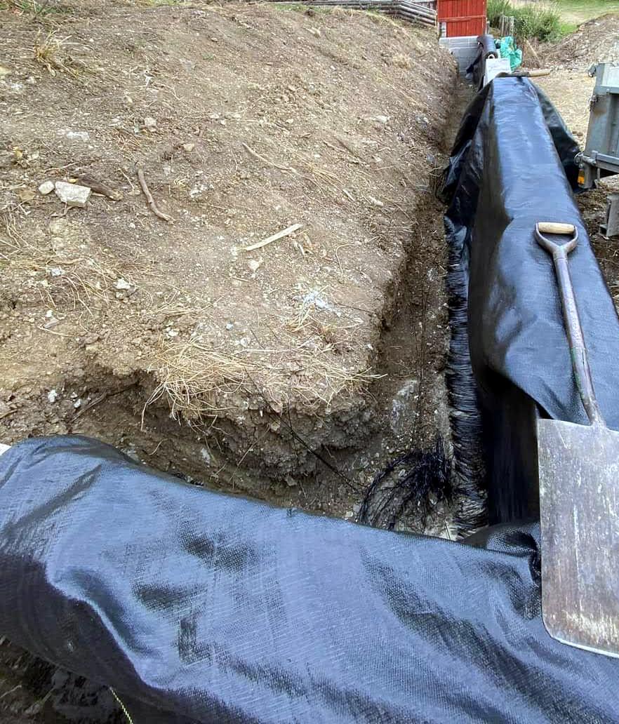

Steve06 Posted March 10, 2024 Author Posted March 10, 2024 Back of fence when built Recent front view from property showing downward garden slope
Tom Posted March 10, 2024 Posted March 10, 2024 If you can't see it from your property why do you want to remove it?
Steve06 Posted March 10, 2024 Author Posted March 10, 2024 I am not concerned with how it looks Tom, I am just trying to establish if I need to treat it because I don't know if it will permanantly damage the strength of the wall, this is a retaining wall!
Canski Posted March 11, 2024 Posted March 11, 2024 13 hours ago, Steve06 said: I am not concerned with how it looks Tom, I am just trying to establish if I need to treat it because I don't know if it will permanantly damage the strength of the wall, this is a retaining wall! There will be no damage caused by efflorescence. If there were most new build housing estates would be a pile of rubble.

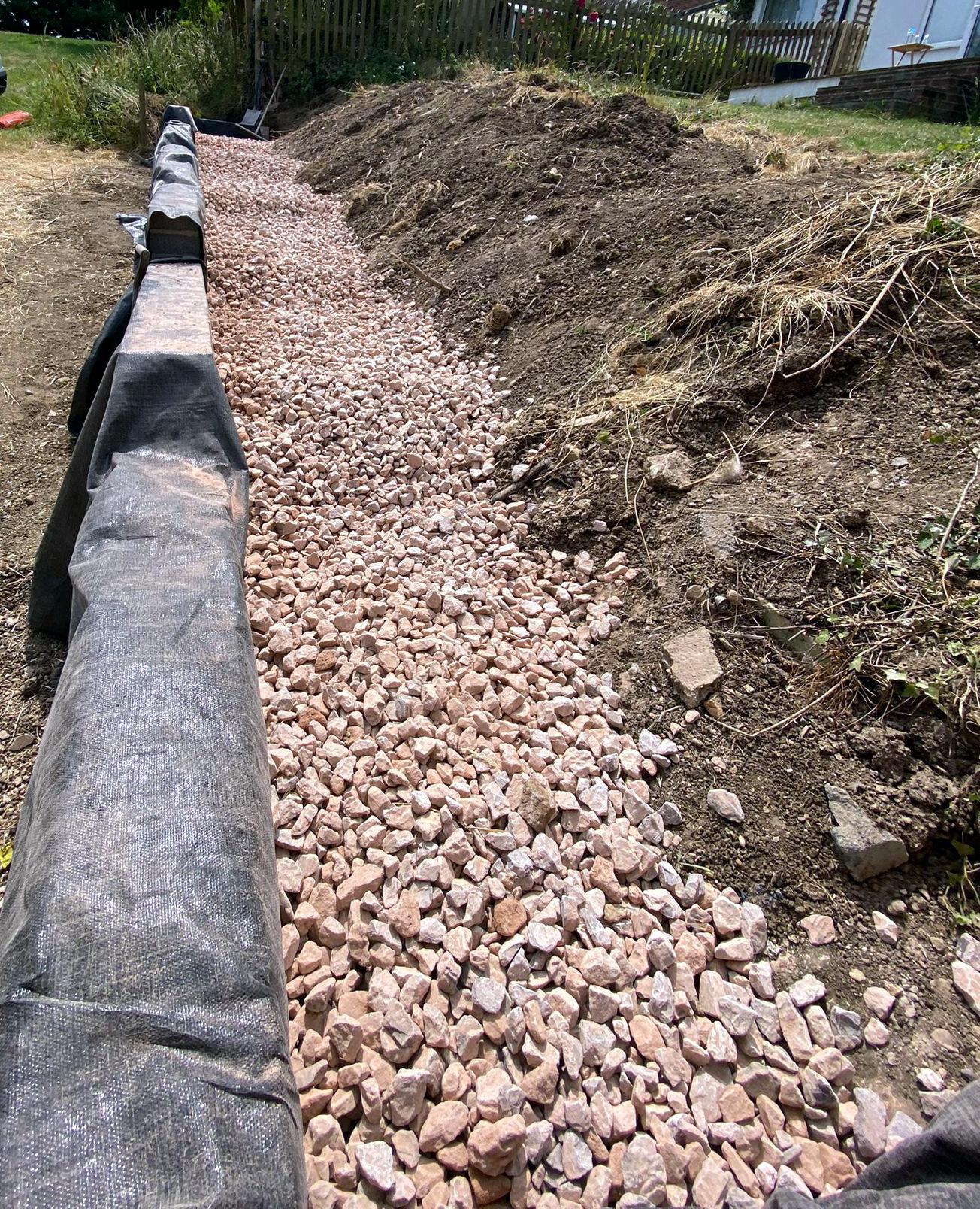

Conor Posted March 11, 2024 Posted March 11, 2024 It'll likely outlive all of us, looks well made. Only issue is the lack of water proofing that's causing the leaching, it won't weaken it. Of it really bothered you, you'd need to dig out the gravel, install a dpm, and fit coping stones to the wall. Hard work. 1

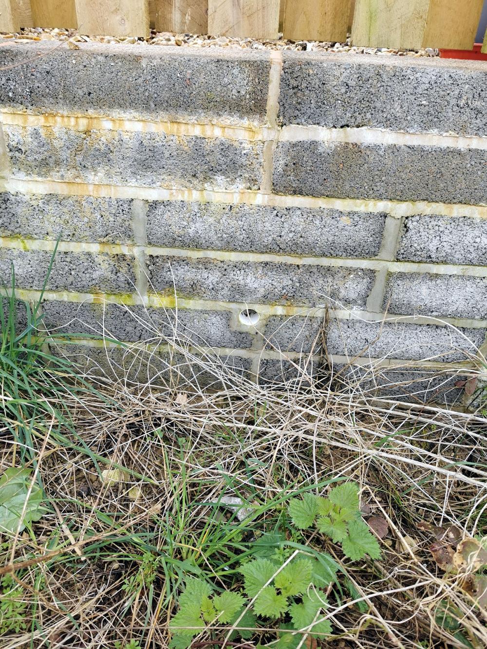

Redbeard Posted March 11, 2024 Posted March 11, 2024 It's not quite an answer to your question, but am I right that there are no weep-holes?
joe90 Posted March 11, 2024 Posted March 11, 2024 2 minutes ago, Redbeard said: It's not quite an answer to your question, but am I right that there are no weep-holes? But there is no cavity 🤷♂️
Redbeard Posted March 11, 2024 Posted March 11, 2024 I mean weep-holes to allow water drainage from the retained land behind to reduce pressure on the wall. 2
saveasteading Posted March 11, 2024 Posted March 11, 2024 On 09/03/2024 at 12:50, nod said: Unfortunately You can’t stop it Eventually the salts in the blocks and mortar will run out. If you add some weep holes it will be drier and leach out more slowly, and it is good practice anyway. Some bits of drain pipe pushed through flush with the garden side and as spouts on the outside. Holes that size are fairly hard work but ok with a good drill and high quality bit. For now, the salts will brush off or wash off and eventually you will prevail. 1 1
saveasteading Posted March 11, 2024 Posted March 11, 2024 To be clear. The outlets are close to the bottom of the wall, above the ground outside, below it inside. I like the fence. 2
Steve06 Posted March 11, 2024 Author Posted March 11, 2024 3 hours ago, Redbeard said: It's not quite an answer to your question, but am I right that there are no weep-holes? There are weepholes thankfully. Ironically one is where the worst of the efflorescence is, I believe the wall was built correctly, I just couldn't understand this! I would like to say a MASSIVE THANK YOU to everyone who has commented, I am so grateful 👋🏻 1
saveasteading Posted March 11, 2024 Posted March 11, 2024 Gratitude makes the world a better place. I'm grateful for it. Ironically, that weep pipe may be causing wetness to concentrate in the ground in that area. No harm though and drying the rest of the wall.
