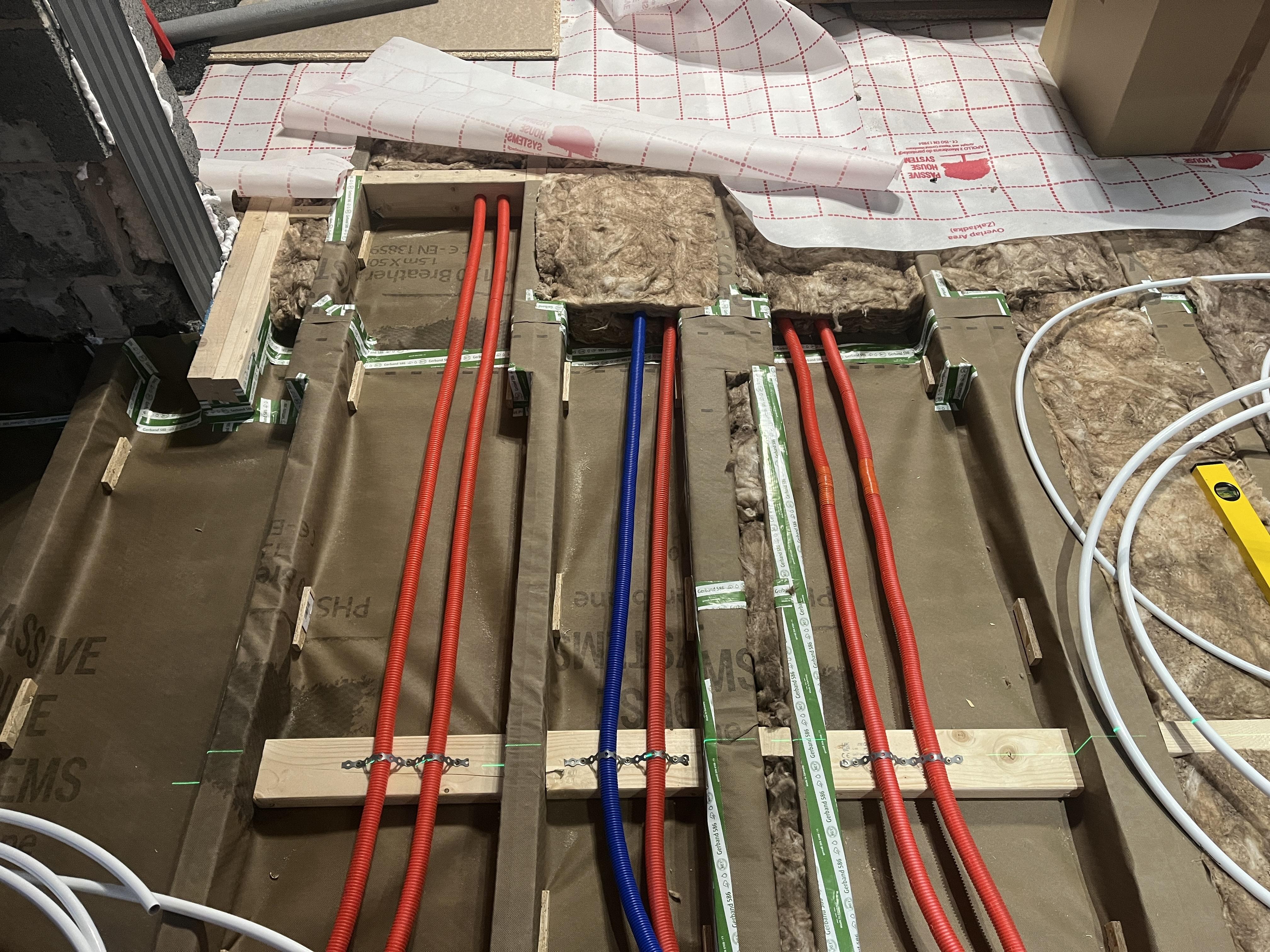

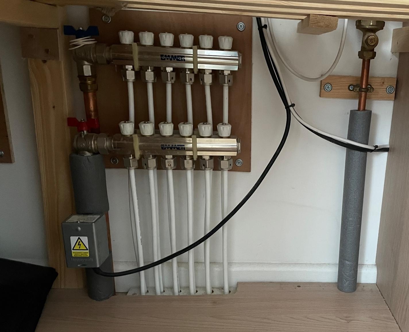

So, in reponse to my unenthusiastic response to usiong copper everywhere and my preferance for manifold plumbing, the plumber has come back and proposed MLCP to run between manifold and wet rooms instead of Hep.  Saying Hep too bendy and needs too many clips.
Never heard of MLCP before today.  From what I can google it looks to be more difficult to knacker on install than Hep.
Plumber says he will be using compression fittings.  Comes in a single roll so no joins.  What's not to like?
MLCP?  Snog, marry, avoid?

I’m currently using a combination of 12mm and 16mm MLCP in a retrofit scenario.
16mm to cold outlets (from manifold)
16mm for rad flow/return (manifold)
12mm for DHW & DRC
so far seems robust and does indeed have little ‘memory’ so holds a shape.
HOWEVER I mistakenly thought it would pull through conduit. More than one sharp 90 and no chance. I’ve actually kinked it twice trying to thread a big loop so give yourself lots of working space to ‘lay it’.
I’ve spent about £150 in fittings which covers approx:
10x 12mm to 3/4 euro ones
10x 12mm to 15mm copper adaptor
30x(ish) 16mm to 3/4 eurocones
40x(ish) 16mm to 15mm copper adaptor
100m of 16mm and 80m of 12mm cost <£100. A steal compared to JG or Hep.
Though despite measuring and thinking I’ll do the whole house with 100m, three rads have eaten the whole reel.
can see me using another 200m on top easy!
Edited by OwenF
  • Thanks 1

MLCP is a good compromise, holds it's shape and doesn't rely so much on the outer layer to form the connection.  I think if I was to go again then I'd go MLCP rather than HEP tbh.  Keeping hep scratch free over the duration of 'My' build has been hard work.

I got pipe and fittings from same shop (PSWtradesuppliers) but have no idea if they’re same brand. Fittings appear unbranded.
Had to go direct to Multipipe for 12mm to 15mm copper adaptors - only place to stock them.
as @joe90 says above, the real benefit of MLCP (or plastic) is minimum or zero intermediate fittings. Mine are uninterrupted lengths of pipe between manifold and rad (or manifold to copper in case of taps)
