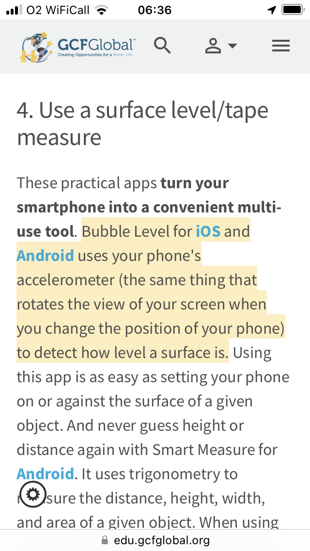

Russdl Posted February 27, 2024 Posted February 27, 2024 iPhones have a level as part of the IOS, I guess Android phones don’t? Looks like ‘bubble level’ may do what you’re after (plus a bit of straight timber strapped to your crossbar to make an instant long-ish level). 1
