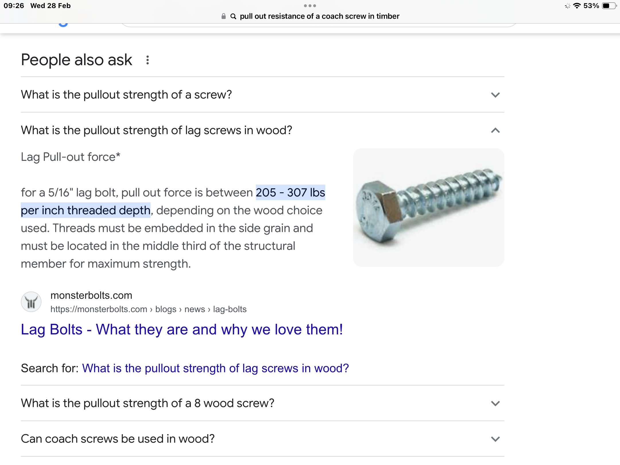

saveasteading Posted February 28 Share Posted February 28 2 minutes ago, Thorfun said: anyone have a calculation as to the pull out resistance As I've said several times, as have others, the pullout isn't a problem but the rotation and aluminium hardness might be. I'm not saying it again and will drop out of the conversation. 3 Link to comment Share on other sites More sharing options...
Thorfun Posted February 28 Author Share Posted February 28 19 minutes ago, saveasteading said: As I've said several times, as have others, the pullout isn't a problem but the rotation and aluminium hardness might be. I'm not saying it again and will drop out of the conversation. oh. sorry for my misunderstanding of the issue here and it's a shame you won't contribute further. i'm now interested in how the threaded bar would differ in rotation and aluminium hardness compared to the coach screws? Link to comment Share on other sites More sharing options...
joe90 Posted February 28 Share Posted February 28 In the past I have actually screwed threaded rod into wood effectively but feel proper designed long screws have been designed for that specifically. 1 Link to comment Share on other sites More sharing options...

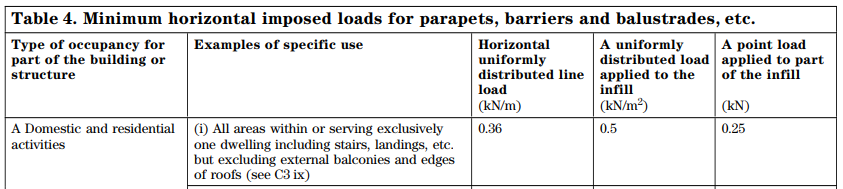

Alan Ambrose Posted February 28 Share Posted February 28 Are you sure your BC won't require SE calcs anyway? BTW this is the thread and post I was thinking about, you'll see Gus has highlighted the zone that will likely fail first - (different style of fixing, but similar problem): Also a few posts down, Gus says "These types of barriers / stairs are designed to resist the prescribed loads in BS 6399 part one and BS 6180 for example". So, there's your loading requirement. 1 Link to comment Share on other sites More sharing options...

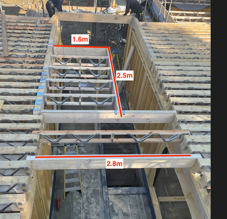

markc Posted February 28 Share Posted February 28 @Thorfun what is the length of run? Turning a corner makes life much easier. With balustrades it’s not just the ultimate strength but also the deflection under load (flex when it’s rocked back and forth) the fixings may well be massively over the top to resist load but floor flex or compression can give unacceptable deflection at the top. This is why you often see vertical glass strips either in front or behind to act as buttresses to reduce movement. Link to comment Share on other sites More sharing options...
Thorfun Posted February 28 Author Share Posted February 28 10 minutes ago, markc said: @Thorfun what is the length of run? Turning a corner makes life much easier. With balustrades it’s not just the ultimate strength but also the deflection under load (flex when it’s rocked back and forth) the fixings may well be massively over the top to resist load but floor flex or compression can give unacceptable deflection at the top. This is why you often see vertical glass strips either in front or behind to act as buttresses to reduce movement. measurements added Link to comment Share on other sites More sharing options...
joe90 Posted February 28 Share Posted February 28 39 minutes ago, Thorfun said: wonder if i could, as was previously suggested, change the underlay under the channel to 5mm ply. Or belt and braces 5mm steel or ally 41 minutes ago, Thorfun said: but the finished flooring is like a 3mm layer of hardwood. the rest is softwood ply. But the crushing effect is on the hardwood layer spread over a greater area by the ply underneath. 2 Link to comment Share on other sites More sharing options...
markc Posted February 28 Share Posted February 28 The L shape is pretty much self supporting (if you join at the corner. And the nearest run, I’m guessing is between walls? So a support/restraint near the top at both ends removes the cantilever load from the bottom. 2 Link to comment Share on other sites More sharing options...
Thorfun Posted February 28 Author Share Posted February 28 36 minutes ago, markc said: The L shape is pretty much self supporting (if you join at the corner. And the nearest run, I’m guessing is between walls? So a support/restraint near the top at both ends removes the cantilever load from the bottom. so, there's no timber up the wall on the nearest run to attach anything to. i could use some heavy duty plasterboard fixings to assist with a glass bracket holding the glass but that would only really help with wobble i guess. i'm aware i can cut out the plasterboard and put timbers but would rather not go through that disruption to the decoration if at all possible. the balustrade is designed to not have the side support afaik. Link to comment Share on other sites More sharing options...
Alan Ambrose Posted February 28 Share Posted February 28 Well if you can somehow subtly determine beforehand, and he/she says yes, then you'll end up paying for the SE anyway. It does all sound a bit formal... https://www.cross-safety.org/sites/default/files/2019-12/structural-safety-glass-balustrades.pdf BTW here are the loads from BS 6399 - they don't seem too onerous, there's some additional detail on fixing etc in :6180 ... 1 Link to comment Share on other sites More sharing options...
