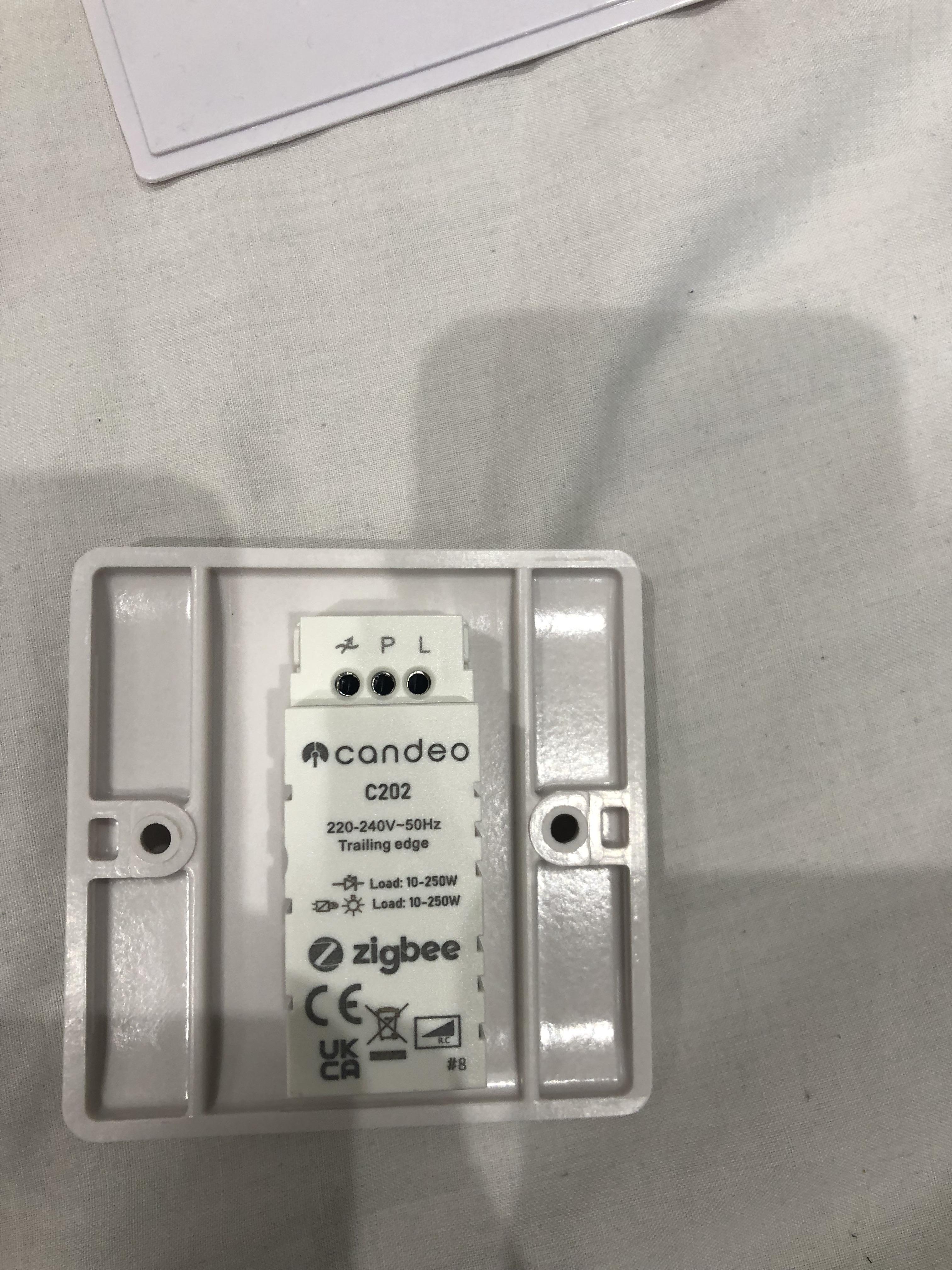

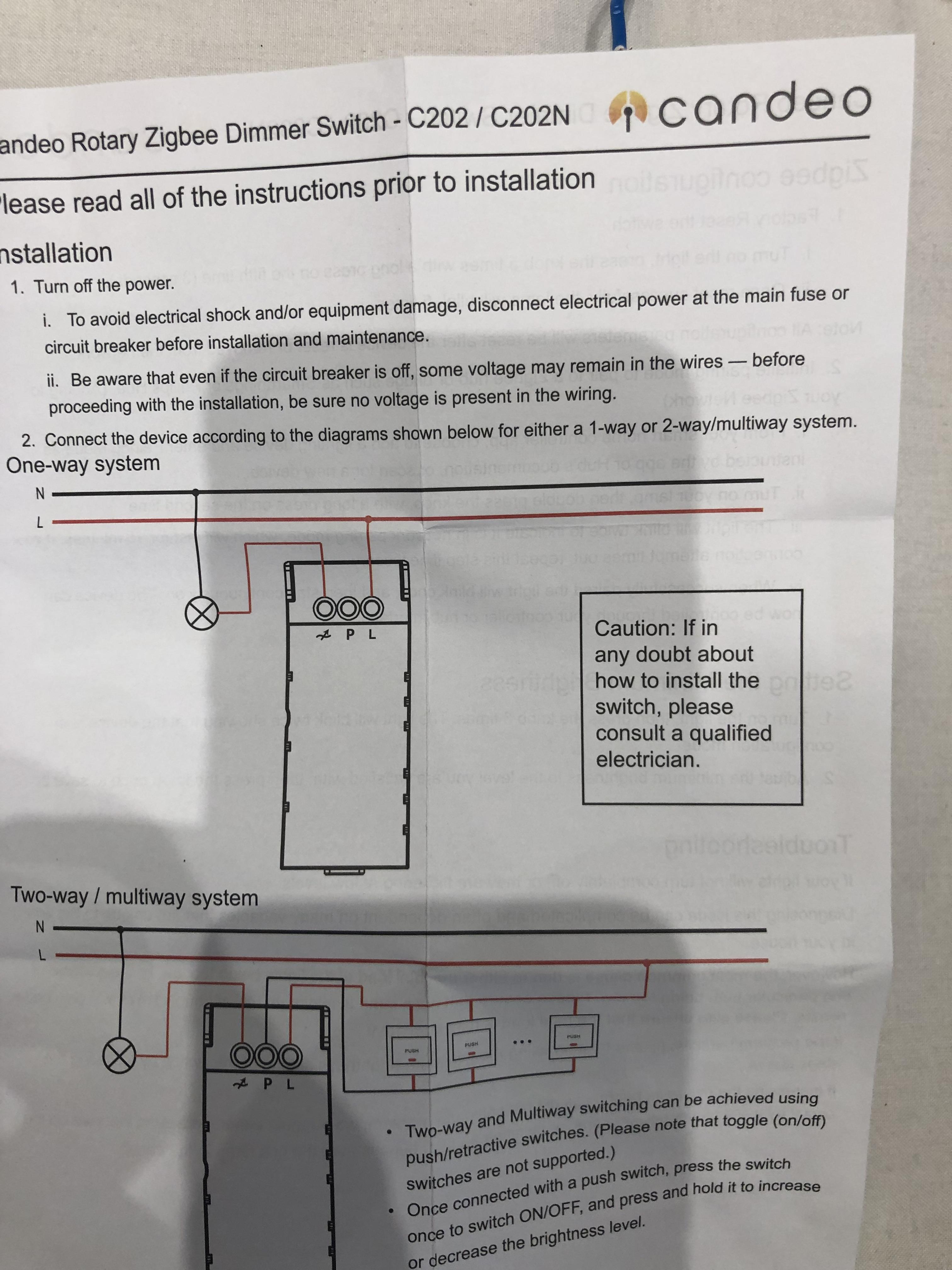

Pocster Posted February 21 Share Posted February 21 These bloody ‘smart’ switches ! So the dumb switch currently installed just has 2 lives . I *assume* this new switch doesn’t need neutral ? ( but diagram suggests it does ) So where do I put the other live ? . In the neutral slot or P ? ( what’s P refer to ? , why’s neutral not got a nice N on it ) Link to comment Share on other sites More sharing options...
Pocster Posted February 21 Author Share Posted February 21 (edited) Right P must be power. So no neutral required , erm.... yeah I'll try that. Live to P and L ThinkI'll wait for advice! Edited February 21 by Pocster Link to comment Share on other sites More sharing options...
ProDave Posted February 21 Share Posted February 21 What do you mean your switch has "2 lives" is it part of 2 way switching? L loop through? Post a picture of your existing switch as wired. That smart switch does not need a N just L in and switched L out. Link to comment Share on other sites More sharing options...
Pocster Posted February 21 Author Share Posted February 21 4 minutes ago, ProDave said: What do you mean your switch has "2 lives" is it part of 2 way switching? L loop through? Post a picture of your existing switch as wired. That smart switch does not need a N just L in and switched L out. Sorry; what I meant is current switch is a simple affair i.e. 2 brown lives that complete in the switch - there is a neutral but it's not used. This new switch has a L but also a P and "squiggle" symbol. So which of those is L out? ; think that's what I'm asking. Link to comment Share on other sites More sharing options...
ProDave Posted February 21 Share Posted February 21 Your new switch L is L in, and squigle is switched L out. P is for interconnecting multiple pushbuttons, I suspect you are not using that function so ignore it. Your challenge now is which of your 2 brown wires is the L in and which is the L out. You will need some kind of tester to determine that, multimeter or some form of voltage tester. 1 Link to comment Share on other sites More sharing options...
Pocster Posted February 21 Author Share Posted February 21 (edited) 7 minutes ago, ProDave said: Your new switch L is L in, and squigle is switched L out. P is for interconnecting multiple pushbuttons, I suspect you are not using that function so ignore it. Your challenge now is which of your 2 brown wires is the L in and which is the L out. You will need some kind of tester to determine that, multimeter or some form of voltage tester. Ok . So squiggle is L out . If I get them round the wrong way ; what will happen ? 🙄. Do I test each L against the neutral to determine which is which ? ( out of my limited knowledge depth here ) . edit: with power off ! Edited February 21 by Pocster Bang ! Link to comment Share on other sites More sharing options...

Pocster Posted February 21 Author Share Posted February 21 (edited) I'm still confused on the no neutral thing (I didn't realise this switch didn't need a neutral ). With no neutral and the switch off it won't be powered and therefore surely can't report or be controlled via Zigbee? But if neutral is connected ( where too? ) then it is 'powered' and so acts like a smart switch correctly? No understand. Switch is neutral free. Destructions show neutral connected to squiggle ( why a squiggle?; what's it meant to represent - not seen that before ). - confusion hate electrics - so dangerous.. I might send it back Edited February 21 by Pocster updating my will Link to comment Share on other sites More sharing options...

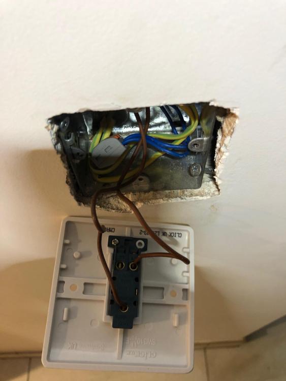

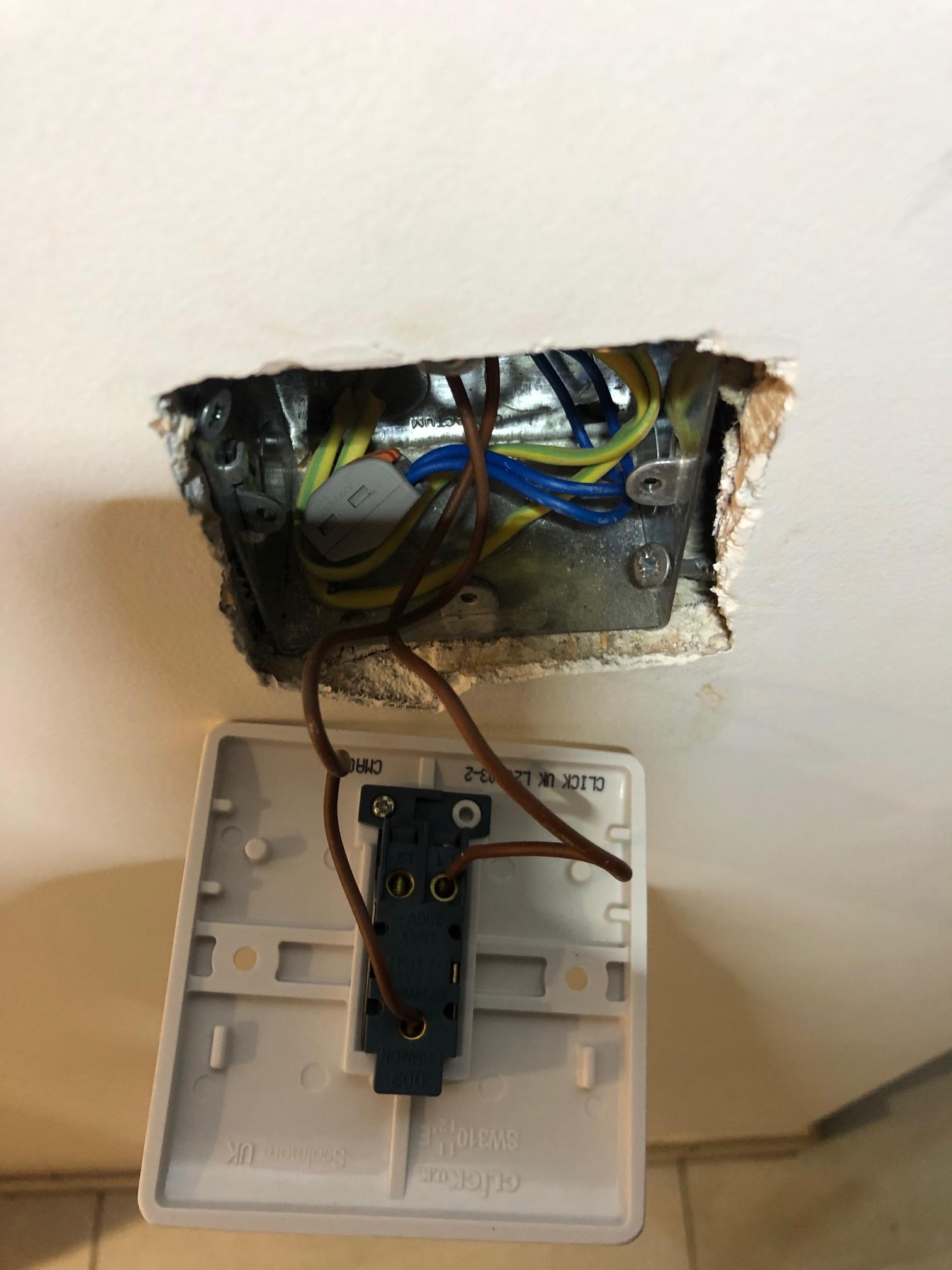

Pocster Posted February 21 Author Share Posted February 21 Current switch as is... Link to comment Share on other sites More sharing options...

joe90 Posted February 21 Share Posted February 21 The live in is the one at the bottom of that picture (com). I am old school, don’t understand smart switches 1 Link to comment Share on other sites More sharing options...
markc Posted February 21 Share Posted February 21 (edited) You need to determine which of the browns is live, with light off test each against neutral or earth .. with a meter or tester, not by shorting! As Joe says, it should be bottom one but not necessarily Edited February 21 by markc 1 Link to comment Share on other sites More sharing options...

ProDave Posted February 21 Share Posted February 21 Don't assume the one in COM is L feed. There is an equal argument for putting L feed into L1 for 1 way switching. The switch probably works by harvesting a tiny amount of power through the L-Sw connection and a tiny current passing through the "off" light. In which case it probably does not know and will probably work either way. But really, it makes me shudder anyone doing ANYTHING on electrics without something to test for live, or more important test for dead. I am old school (and some will flame me) but I have a motto "Never touch anything that my neon screwdriver has not touched first. If you really must use a volt stick instead, then make SURE every use you test your volt stick on a known live wire. The other mantra is "test your tester, test for dead, test your tester again. 3 Link to comment Share on other sites More sharing options...

ProDave Posted February 21 Share Posted February 21 1 minute ago, Pocster said: Ok . I listen to your point - I really do ! How should I test each “ live “ to see which it is . Preferably with circuit off ; or is that not possible ?. Circuit off both L wires out of the switch R1+R2 test. I bet that you stumped. So with circuit off, connect ONE of the brown wires to earth at the switch, go to the consumer unit and measure resistance from the (isolated) circuit L to E If you get a very low reading, then the brown you have joined to E is the feed. Then go and swap over so the other one is connected to E at the switch (and the first one floating) and see what the resistance L to E is at the consumer unit. Whichever one when connected to E gives the very low ohms reading is the feed. 1 Link to comment Share on other sites More sharing options...
