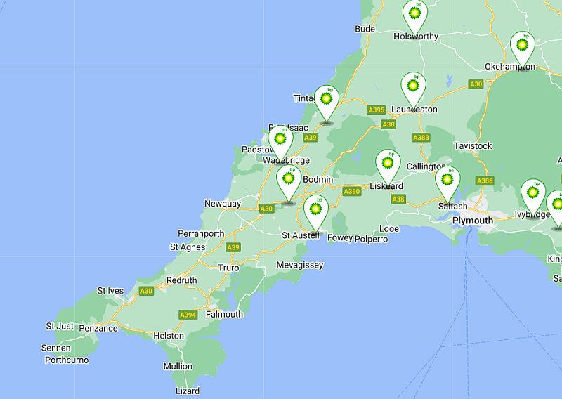

SteamyTea Posted February 22 Share Posted February 22 One of the problems is that car usage is a very individual thing. Most days I drive between 30 and 50 miles, so the car is stationary for 22 hours or so. But take yesterday, I drove 660 miles, so the car was stationary for about 11 hours. Today I may drive 30 miles or so, maybe 60. Ideally I need two very different cars. A small 'city' type car and a larger 'cruiser' (I know very well that I could drive 660 miles in a small car, but some comfort is needed, I used to do the journey in an original Suzuki Swift and a Corsa Automatic, but I am 20 years older now). In some ways what is needed in Urban and semi rural areas is car hire businesses that follow a similar business model that these electric bike high businesses have. The bikes are left in certain places around the town (Harbour Car Park in PZ, top of hill in Mousehole), you register and then just take a bike. At least with a car share scheme you would not get complete (expletive deleted) ignoring all the rules of the road like the you do with the bikes/scooters, but that is another issue. The main thing that people want from a car is instant accesses and ability to do the journey they want, when they want. This is why we own our own cars, the problem is that it is now getting expensive to do so (though still cheaper than 40 years ago). So while V2G seems like a great idea in principle, I don't see it as an effective solution to grid storage, a quick look at the electrical grid usage patterns will show that higher demand times coincide with 'rush hours'. From an energy saving point of view, it is silly to add in and extra 100 kg of battery storage to a vehicle to either supply the grid or be used for that extra long journey. Swapping vehicles is the better method, though fraught with problems (I lost my driving glasses in my own car, and would hate to leave my fags behind for someone else to enjoy). I like to keep things simple, if you need home electrical storage, install just that, if you want an EV as a low mileage run about, buy one, if you need a car that is capable of driving 800 miles in a day, buy one that can do that. Let the energy companies and the DNOs worry about fitting storage, it is a better usage of 'investors' cash than hoping that independent drivers are willing to share their expensive resources. The government could also put a price cap on independent EV charging, some are expecting 85p/kWh, which after charging and delivery looses is £1/kWh, which makes driving a diesel car cheaper, more flexible, and easier. It does make me wonder if we will get people that think their EVs will run better on different suppliers electricity, it still makes me smile when people will only fill up their cars at a Shell or BP garage, but never a Tesco (which is actually an ESSO managed business). I notice that when I open my fuel filler flap there is a note that says 'Ford recommends BP fuel'. I have not seen a BP garage where I live for years, I am sure there is one. Just had a quick look. I have a new term now, 'The BP Line', it is between Wadebridge and St. Awful. Link to comment Share on other sites More sharing options...
