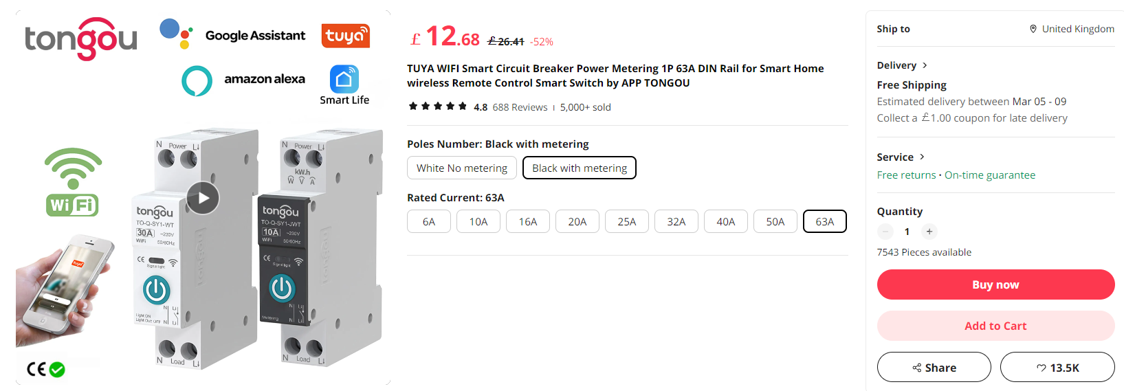

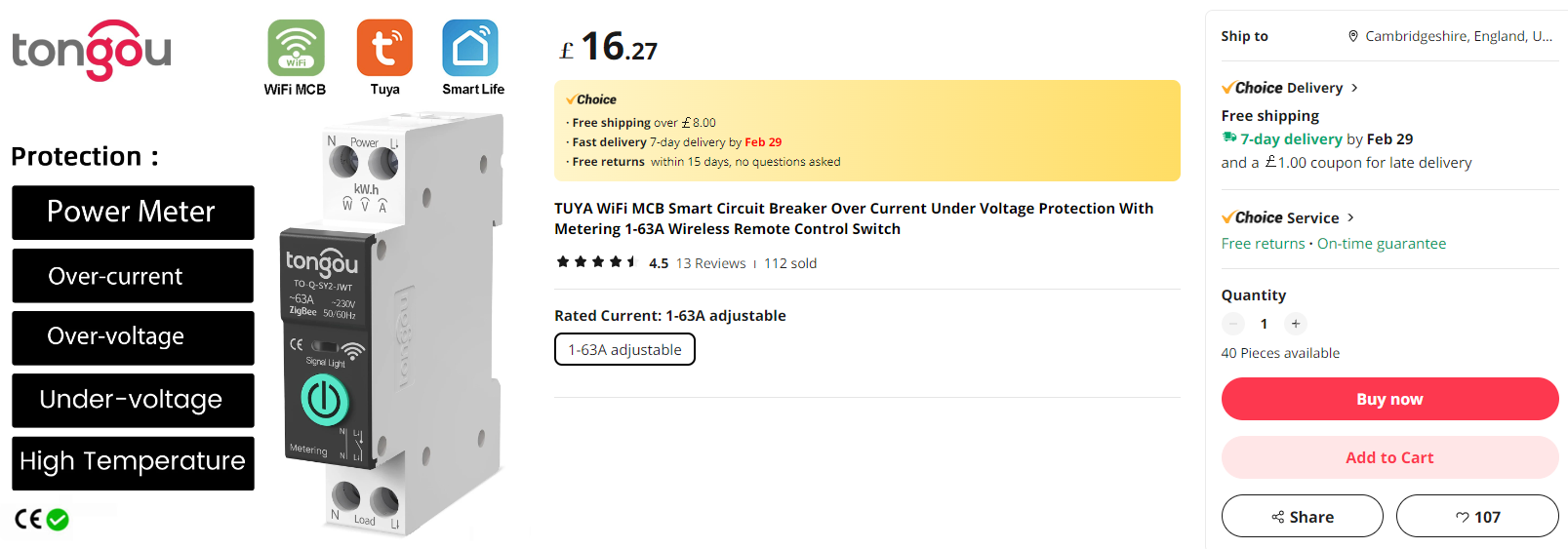

MortarThePoint Posted February 20 Share Posted February 20 (edited) Does it really need to be WiFi or do you just want to be able to check. If the later, my ASHP installation came with one of these: https://www.amazon.co.uk/gp/product/B08X6J865C/ Alternatively, I would love someone braver than me to try out one of these: https://www.aliexpress.com/item/1005004158545611.html https://www.aliexpress.us/item/1005005184859497.html Important to not that the first one says in its text that: "Both models have NO overcurrent protection, can not set current ,voltage in APP." The second offers current limiting, but that looks to be via software so not to be relied upon I'd say. Anyway, you need RCBO rather than just MCB function nowadays. Easy to put downstream of an RCBO. Both claim to be CE marked. Form you own risk assessment 🙂 Available as Zigbee too. Edited February 20 by MortarThePoint Link to comment Share on other sites More sharing options...
Alan Ambrose Posted February 20 Share Posted February 20 How to identify a Conformité Européenne mark vs a China Export mark https://starfishmedical.com/blog/conformite-europeenne-mark-vs-a-china-export-mar Link to comment Share on other sites More sharing options...
MortarThePoint Posted February 20 Share Posted February 20 17 minutes ago, Alan Ambrose said: How to identify a Conformité Européenne mark vs a China Export mark https://starfishmedical.com/blog/conformite-europeenne-mark-vs-a-china-export-mar A fair point, but it is the CE mark not China Export one and they even include their certificate: Link to comment Share on other sites More sharing options...
dpmiller Posted February 20 Share Posted February 20 I'm running our ASHP off one of the Tuya MCBs and it reports nicely to SmartLife. Seems as accurate as the cheapo din-rail meter it replaced, and runs cooler too. 1 Link to comment Share on other sites More sharing options...
