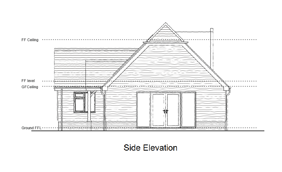

flanagaj Posted February 16 Share Posted February 16 I am trying to work out from the drawing below. Where the floor level would be upstairs and how much head height is available. I think there is enough room to get a bedroom in the loft space, but not sure what size and headroom. Not sure if anyone with any knowledge might be able to provide an idea. Link to comment Share on other sites More sharing options...
ProDave Posted February 16 Share Posted February 16 You would need a more detailed plan that that. And some actual measurements of the dimensions inside the existing loft. The critical think is the staircase. A staircase, and the "landing" must have a headroom of 2 metres. Oddly enough building regs don't stipulate a headroom limit for a bedroom. So think where you could put a staircase that is both practical and meets that headroom requirement. The actual available height will probably be less than you measure in a bare loft, as you will likely need to increase the floor joists size, and insulation will reduce some of the ceiling height. 1 Link to comment Share on other sites More sharing options...
flanagaj Posted February 16 Author Share Posted February 16 2 hours ago, ProDave said: You would need a more detailed plan that that. And some actual measurements of the dimensions inside the existing loft. The critical think is the staircase. A staircase, and the "landing" must have a headroom of 2 metres. Oddly enough building regs don't stipulate a headroom limit for a bedroom. So think where you could put a staircase that is both practical and meets that headroom requirement. The actual available height will probably be less than you measure in a bare loft, as you will likely need to increase the floor joists size, and insulation will reduce some of the ceiling height. This is a new dwelling, and I currently only have the drawings used for the planning application. Stairwell is no problem as the ground floor has been designed so that the stairs enter into the upper floor space in the middle of the floor. Link to comment Share on other sites More sharing options...
Russell griffiths Posted February 17 Share Posted February 17 You can take a very rough punt and say that the top of those doors is 2100 high, you then need 300mm above those to ceiling height 2400 then 300mm for floor thickness, enlarge that drawing up and do a rough scale. looks to me like that room will be a tiny triangle without adding a large dormer. 1 Link to comment Share on other sites More sharing options...
ProDave Posted February 17 Share Posted February 17 10 hours ago, flanagaj said: This is a new dwelling, and I currently only have the drawings used for the planning application. Stairwell is no problem as the ground floor has been designed so that the stairs enter into the upper floor space in the middle of the floor. New by who? Big developer or individual builder? Has it actually been designed from the outset to have rooms in the loft? If so you might be lucky and find it is built with attic trusses. That is quite common up here to build bungalows with attic trusses to make loft conversion much easier. What other drawings are on the council website? Can you access building regs drawings that might show a lot more detail? Link to comment Share on other sites More sharing options...

Mr Punter Posted February 17 Share Posted February 17 (edited) Based on the scale, a 2400 room height and 300mm floor zone as per @Russell griffiths, this is how it would be: Edited February 17 by Mr Punter 2 Link to comment Share on other sites More sharing options...
