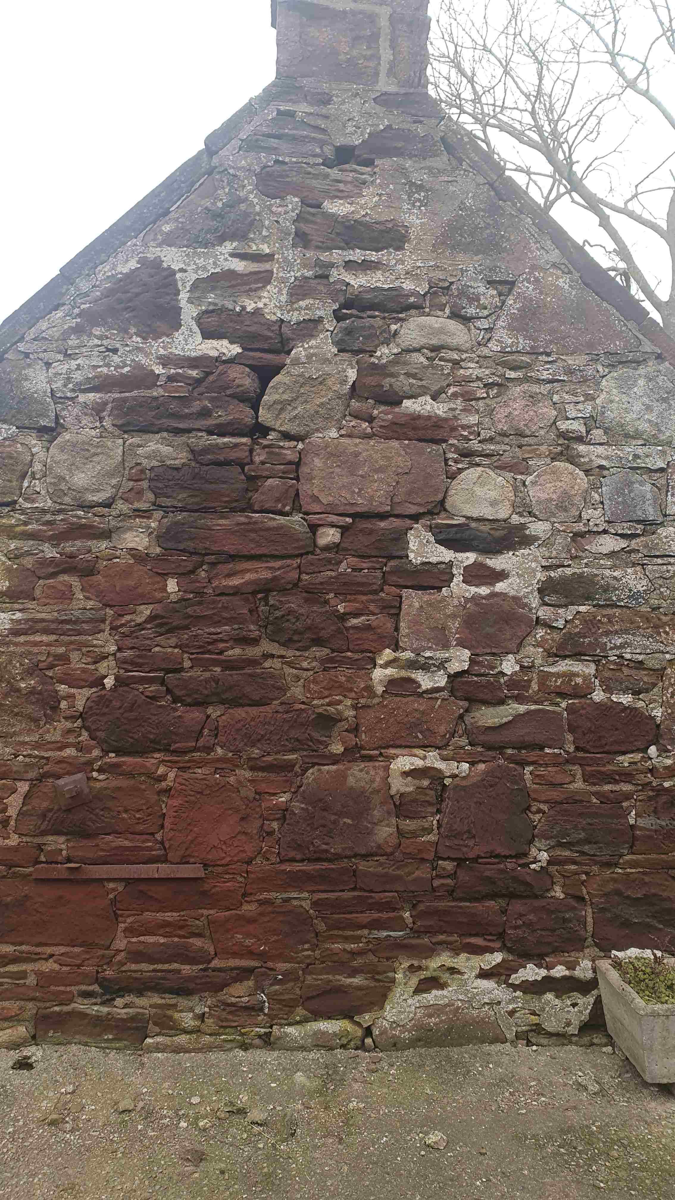

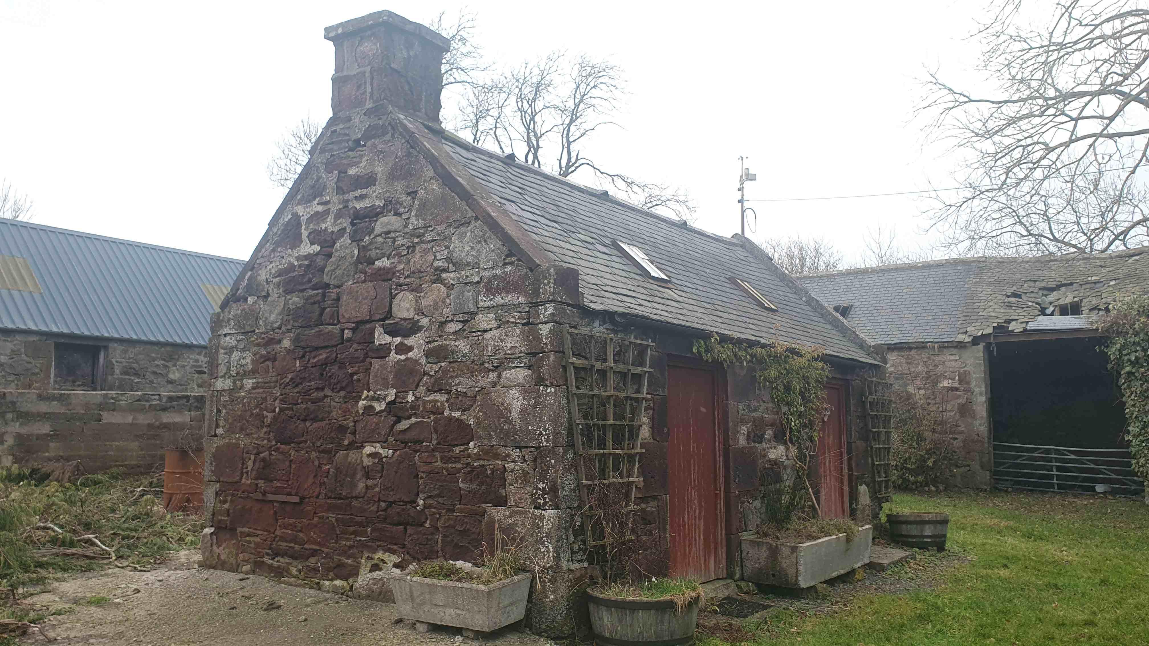

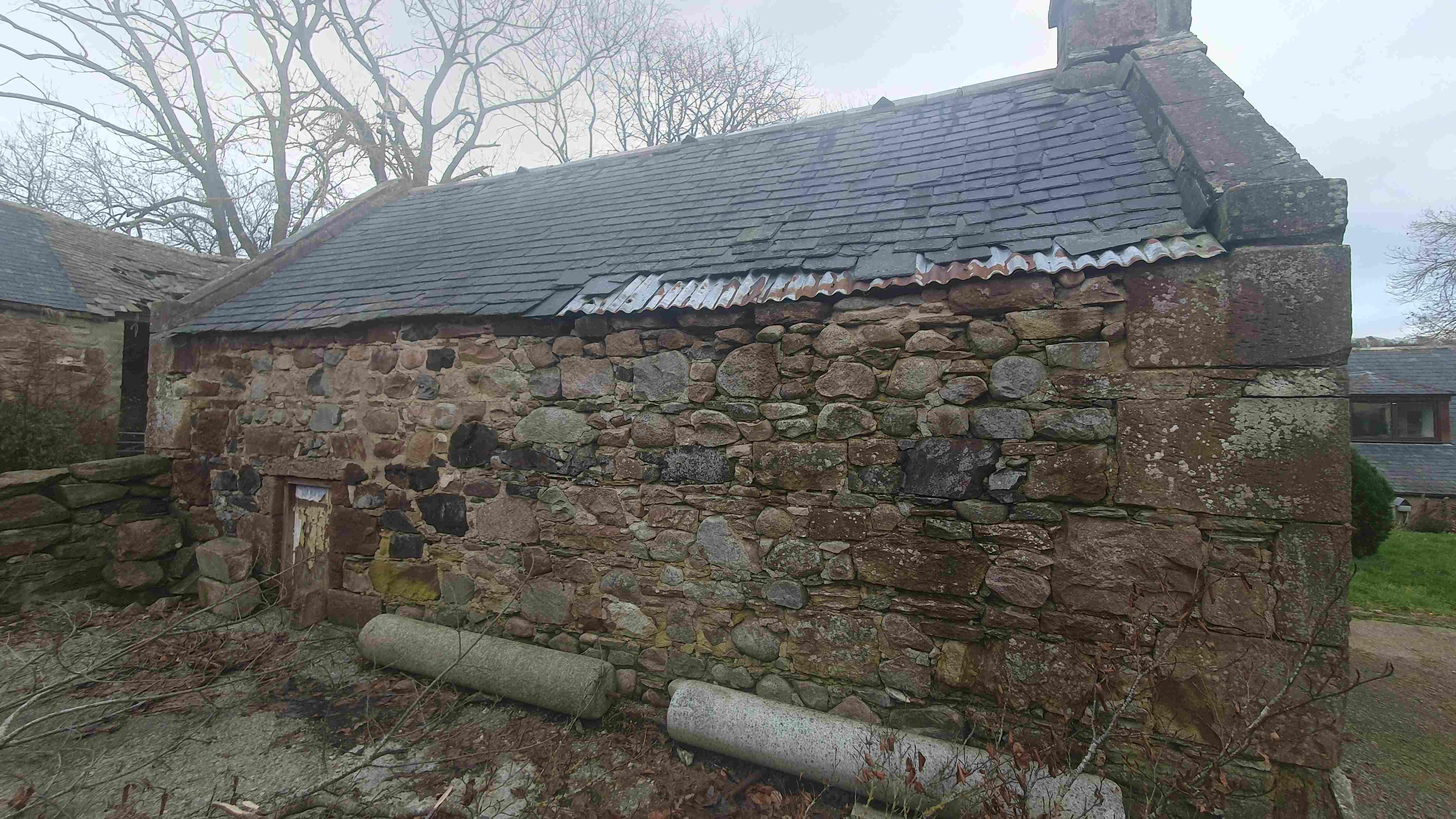

We have recently moved to rural Aberdeenshire, Scotland. Our property has two steadings and a bothy.
You can see the dilapidated end of one of the steadings in the photo. We call this one Mordor as it is the steading from hell which we can't use for fear of death from falling masonry; it's a project for another day and another bank account!
Please see attached photos.
The bothy is the issue for today. The pointing is in a terrible state: a mixture of very eroded hundred-year-old lime mortar and newer sand and cement repairs. The advice from a local roofer/mason is to rake it all out and replace it with lime mortar. The mason's estimate for the work was way beyond my budget, but he guaranteed it for a hundred years!!! I haven't done work like this before but the resources are all there on the internet, so I'll do it this year.

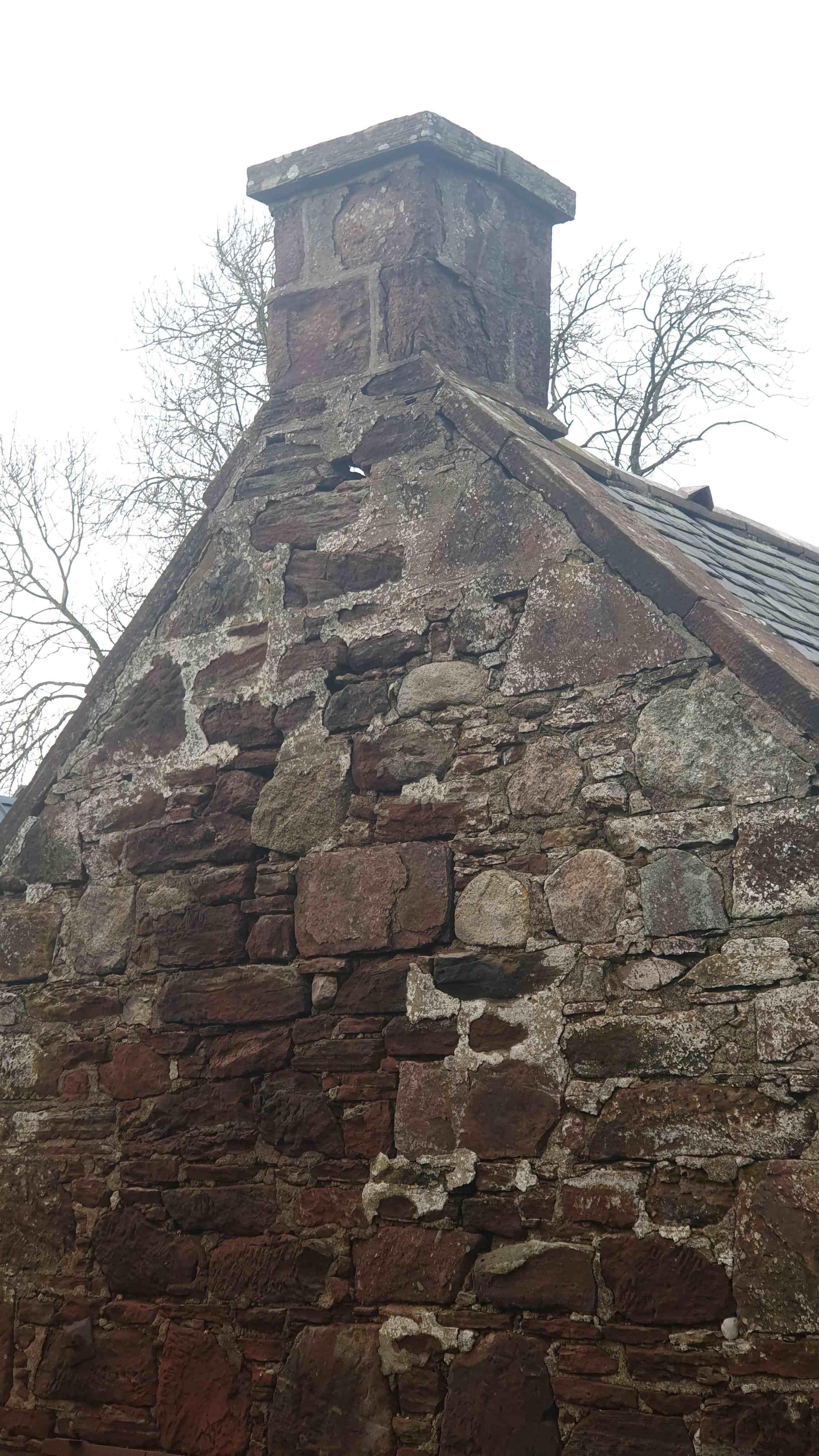

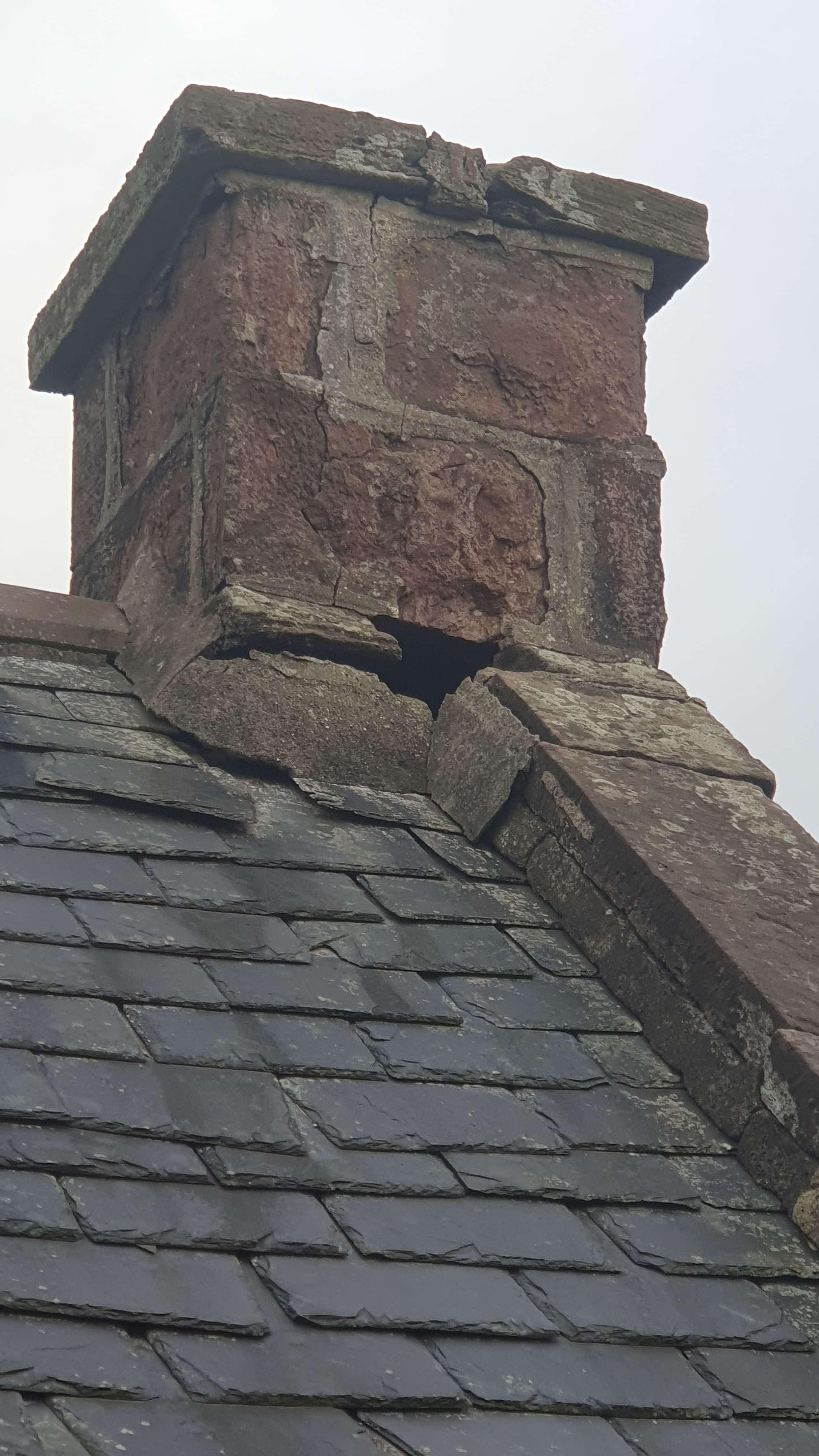

What I'd like advice on, please, is how to repair the chimney stack. Let's assume that I might use it as a chimney sometime in the future.
Crows have nested in the chimney stack and in the end wall of the bothy. They cleverly removed mortar to create access. You can see right through the chimney stack in one of the photos. There are quite large voids to be filled before the outer faces can be pointed. The stack has weathered three severe wind storms in the last twelve months but it won't last forever in its present state. The mason recommended that I collect stones to fill these voids but I don't know how to do the repair with these stones. If I place stones inside the voids, do I just cover them in mortar to secure them and restore the inside shape of the chimney, then build the chimney back out of the hole? How do I finish the outer faces?

Get a wire brush and screwdriver and rake out some of the old mortar at ground level.
Then a bucket of lime mortar, a small trowel and some gloves and have a go at repointing yourself.
It's not rocket science.
By the time you get to the chimney you'll be plenty proficient to make a tidy job of it.
The good thing about lime is it goes off very slowly so big batches can be made without fear of “going off”.
Also when pointing stone I like to wait till it’s fairly stiff (which might take a few days) then wipe with a soft paint brush to give a better finish.

Mine's softish sandstone, so I'll be looking for a softer mortar by the sound of it. Any suggestions?
Just googled this…..Type N Mortar Mix
It is considered to be a general-purpose mix, useful for above grade, exterior, and interior load-bearing installations. It is also the preferred mortar mix for soft stone masonry (such as limestone). Type N is the mortar most often used by homeowners and is the best choice for general application.

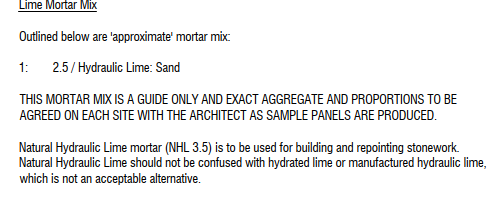

I’d use 3.5 nhl with sharp sand mixed at ratio 1:3.
dont make it too wet. Push it into the joints and don’t worry about leaving excess around the joint. Next day (or when it has dried a bit) compact with tool/bit of wood and clear off any excess. Then use a churn brush (or softer) to do a final brush over.

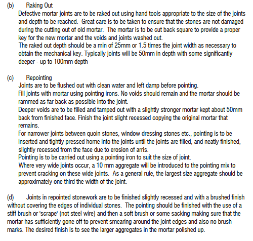

Few snips from drawings - standard regurgitated spec but can be useful
Great, thank you!
The precise technique details are particularly helpful.
That's interesting to read. The addition of stones to large gaps makes sense, as does max 10mm if thy are hard stone.  Wouldn't it be best to use a piece of stone recovered from the building, ie the same strength? or to make up some aggregate from recovered stone?
Originally it probably would have been whatever was dug up locally.
Lime mortar is supposed to be sacrificial and compressible strength properties are not that important, unlike cement mortar which is desired for its compressible strength and hard wearing ability.
That's why I thought that using the same sandstone it could also crush or crack rather than stress the main masonry blocks.
