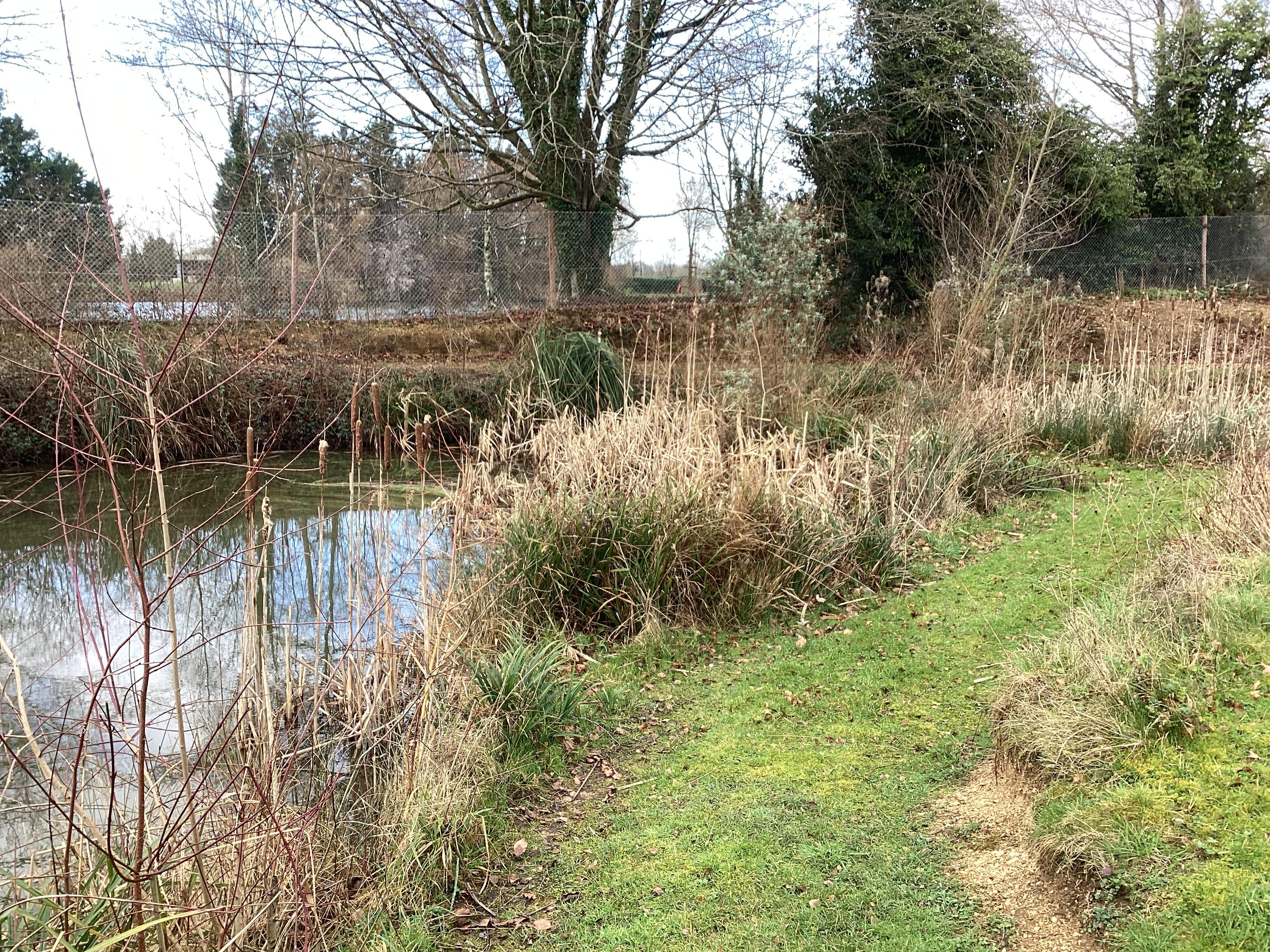

Russell griffiths Posted February 15, 2024 Posted February 15, 2024 Can you put in a pond or reed bed to take stp and rainwater. Mine goes to this, I added rainwater as well to keep it diluted. 1
saveasteading Posted February 15, 2024 Posted February 15, 2024 In case of any temporary problem I think I would have a soakaway before a pond., even if the ground technically can't take it. Or a 'pre-pond' extra pond with reeds and lilies. 10 years ago they were saying you could, but shouldn’t, drink the outfall. That was silly but indicates that it's almost clean. But if somebody left a bath running, the same amount would go into the pond, perhaps not very clean 1 hour ago, LSB said: an overview on installing off mains sewage treatment. Yes. Use a recognised digester system, using air turbulence rather than the mechanical ones. Then to a soakaway or recognised watercourse. In Scotland the outfall rules are stricter. There's lots of previous on the subject. Use Google "buildhub sewage digester" 1

Russell griffiths Posted February 15, 2024 Posted February 15, 2024 1 hour ago, saveasteading said: In case of any temporary problem I think I would have a soakaway before a pond., even if the ground technically can't take it. Or a 'pre-pond' extra pond with reeds and lilies. The pond in my picture is exactly that, a pre pond, before it gets to the pond/lake. I did this just for the chance that someone puts something nasty in the drains it will be evident first in the small pond before it gets to the larger one. 1
LSB Posted February 15, 2024 Author Posted February 15, 2024 2 hours ago, Russell griffiths said: Can you put in a pond or reed bed to take stp and rainwater. Mine goes to this, I added rainwater as well to keep it diluted. we can't feasibly have a pond or reed bed as house is at the top of a slope, so digging something out would be pretty impossible.
