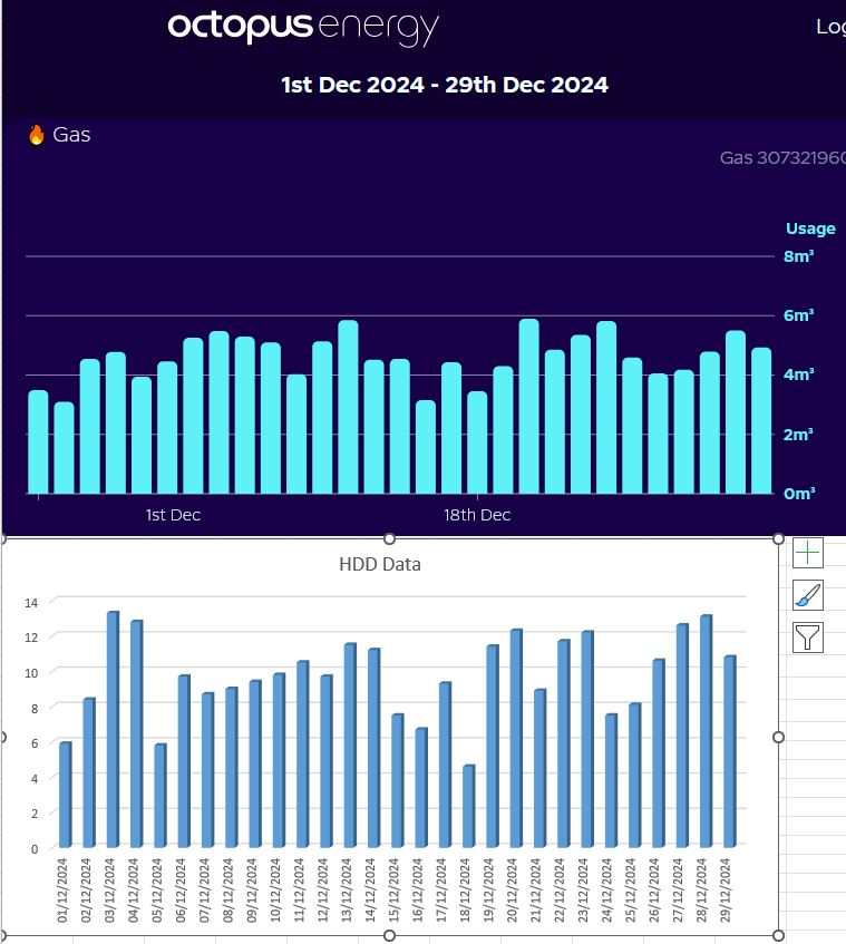

DamonHD Posted December 31, 2024 Posted December 31, 2024 (edited) 24 minutes ago, marshian said: I'm clearly not most people Below is my daily gas usage and below that my HDD data both by day for December Pretty clear to me my heating consumption of gas is driven by the outside temp and there is a close relationship You are indeed not most people. For gas heating, relationship is typically linear above a baseline temperature and baseline (non-heating) consumption, eg per https://www.degreedays.net/ For HP changing CoP with exterior temperature will complicate things, which I haven't entirely worked through in my head yet. Edited December 31, 2024 by DamonHD

marshian Posted December 31, 2024 Posted December 31, 2024 4 minutes ago, DamonHD said: You are indeed not most people. I'll take that as a compliment 😉 Background - for my last 40 years in work I've been a data analyst - it's really bloody hard when you are good at working with data to ignore it in a home environment. Basically if I can't validate something with data then it's a guess or a hunch and I don't do either of those 1

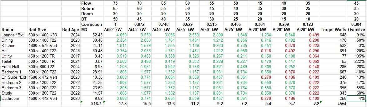

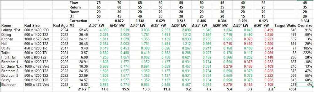

JamesPa Posted December 31, 2024 Posted December 31, 2024 (edited) 13 minutes ago, marshian said: Here's my math for my rad sizing In a nutshell what I had was a calculated heat loss at -2 and a rad kW output at T50 - what I wanted to see was where as I stepped down flow temps was I likely to have a problem with rooms not meeting the target temp (ie the rad was borderline) In truth I think my heat loss parameters for ACH and loft losses were a little pessimistic and so my heat losses for some rooms are a little higher than reality. But it does show clearly that I am likely to have an issue with three or four rooms For reasons to do with the history of my installation mine are similarly all over the place. In reality the downstairs pretty much evens itself out, undersized rads being offset by oversized ones in adjacent rooms, and the bedrooms upstairs are on trvs because they are way oversized and anyway we want them cooker (I will sometimes get round to trying to adjust the bedroom lockshields and ditch the trvs). The bathroom is, in principle, hopelessly undersized (we didn't change the towel rail), but I leave the door open to the hall and that, together with steam from the bath, deals with it. It all seems to work, based on four weeks so far of operation, and with much less fiddling than I had expected. It's a nice simple system, no hydronic separation nonsense, just heat pump connected to emitters and dhw via a diverter. I'm operating a couple of degrees less than the design flow temperature so happy with that too. Edited December 31, 2024 by JamesPa 2
