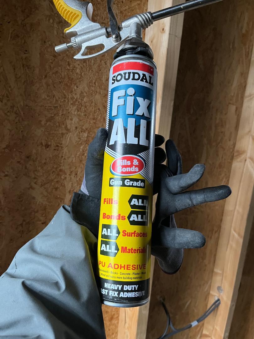

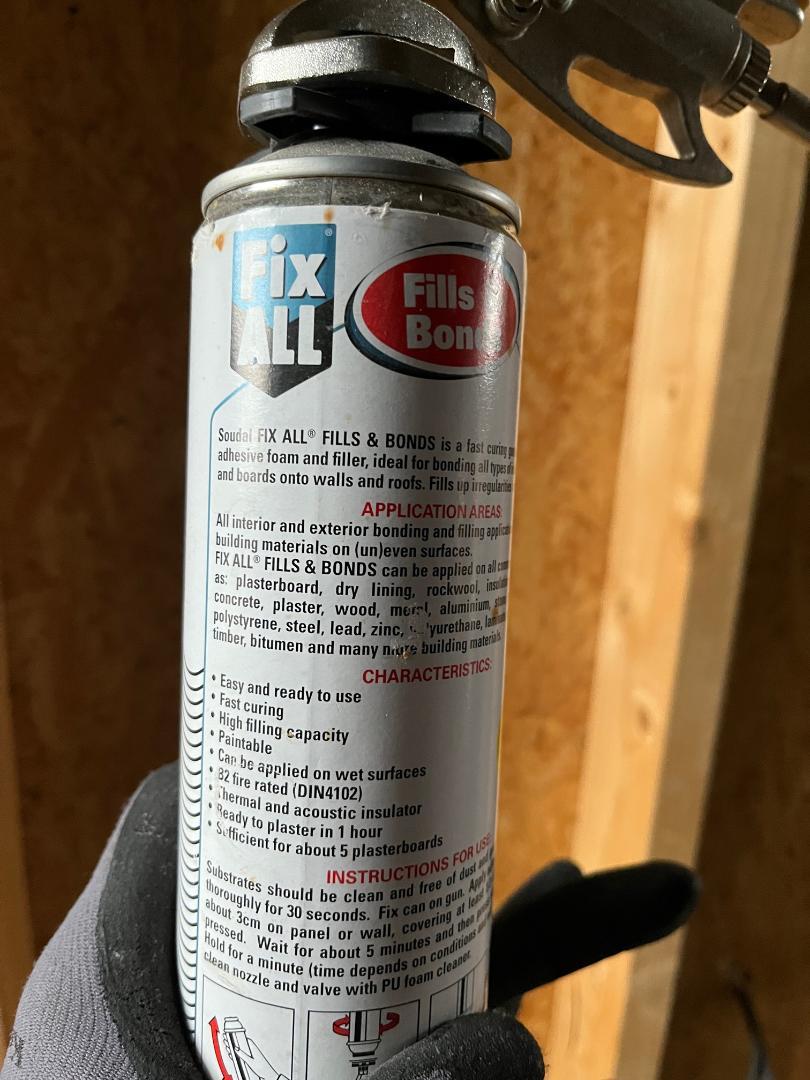

markharro Posted January 29, 2024 Author Share Posted January 29, 2024 Thanks everyone - here is the adhesive I am planning to use - you will see in the small print at the back that it explicitly says that you can use it with polystyrene! In the comment about the Hardie boards - do you mean the backer boards that are normally used internally as tile backer boards? Link to comment Share on other sites More sharing options...
Russell griffiths Posted January 29, 2024 Share Posted January 29, 2024 9 minutes ago, markharro said: Thanks everyone - here is the adhesive I am planning to use - you will see in the small print at the back that it explicitly says that you can use it with polystyrene! In the comment about the Hardie boards - do you mean the backer boards that are normally used internally as tile backer boards? I suggest you do some testing. It sticks eps to eps but try sticking the cement board to the eps, been there tried that. The only method I found has been mentioned, a coat of render then tile adhesive, or just render it. James hardie make a board for exterior use it comes in various sizes and colours. Link to comment Share on other sites More sharing options...

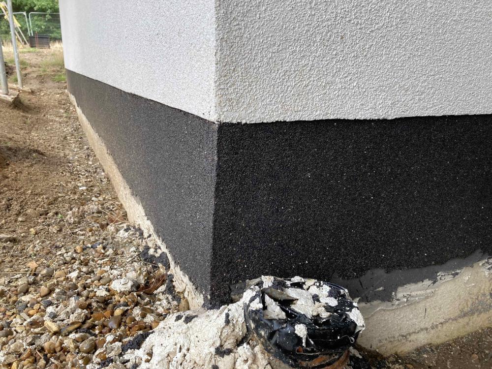

Nick Laslett Posted January 29, 2024 Share Posted January 29, 2024 My original plan was to affix cement board to finish my EPS foundation plinth. But the guys doing the rest of the ICF rendering, recommended this solution, Mosaic render from EWIPro. https://ewistore.co.uk/shop/external-wall-insulation/mosaic-render-ewi-050-25kg/ Link to comment Share on other sites More sharing options...
Russell griffiths Posted January 29, 2024 Share Posted January 29, 2024 snap, used the mosaic render from the ewi store. Link to comment Share on other sites More sharing options...
