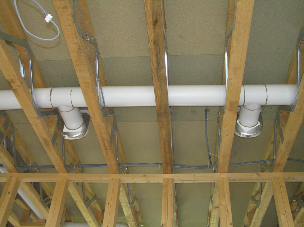

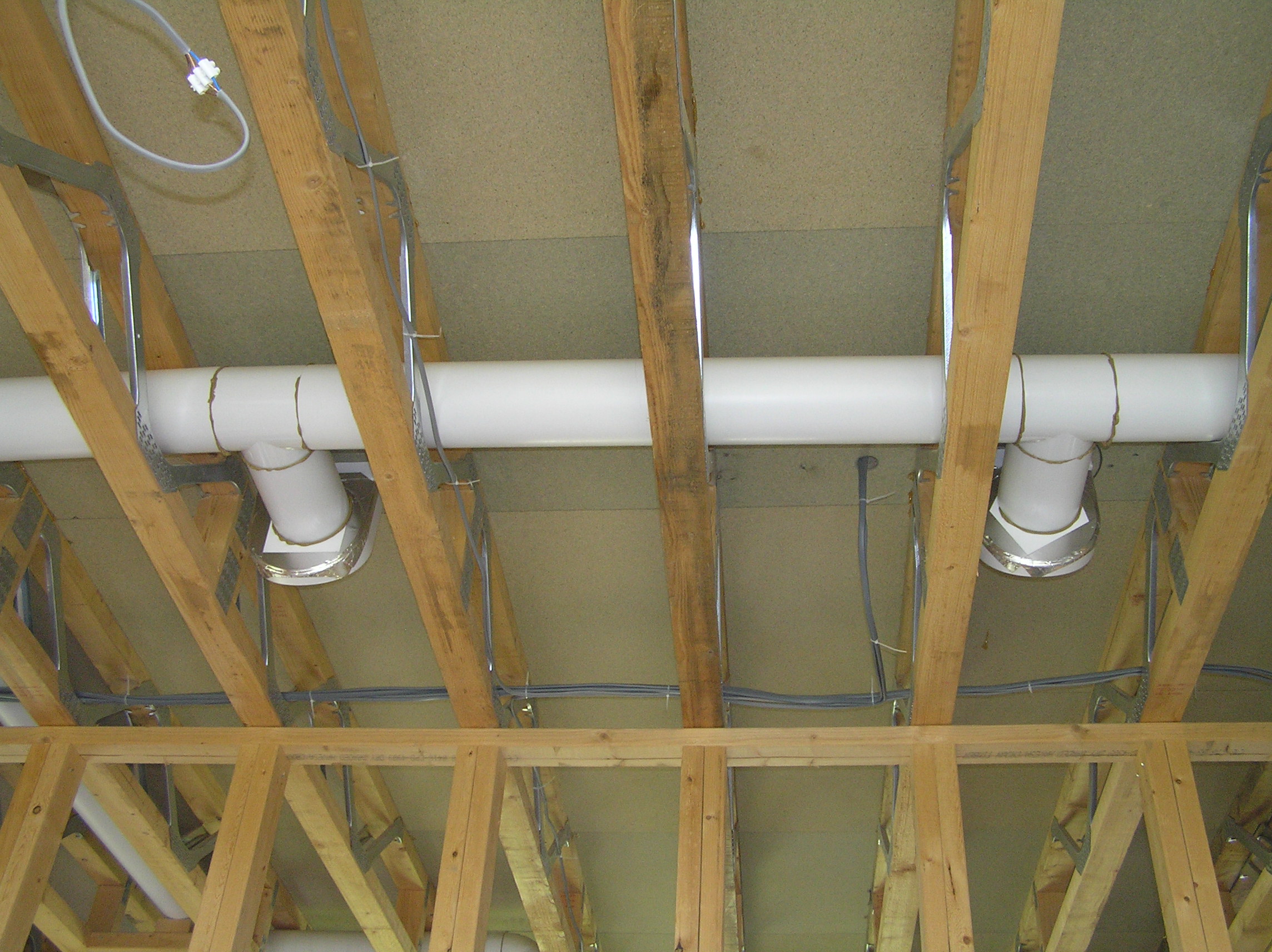

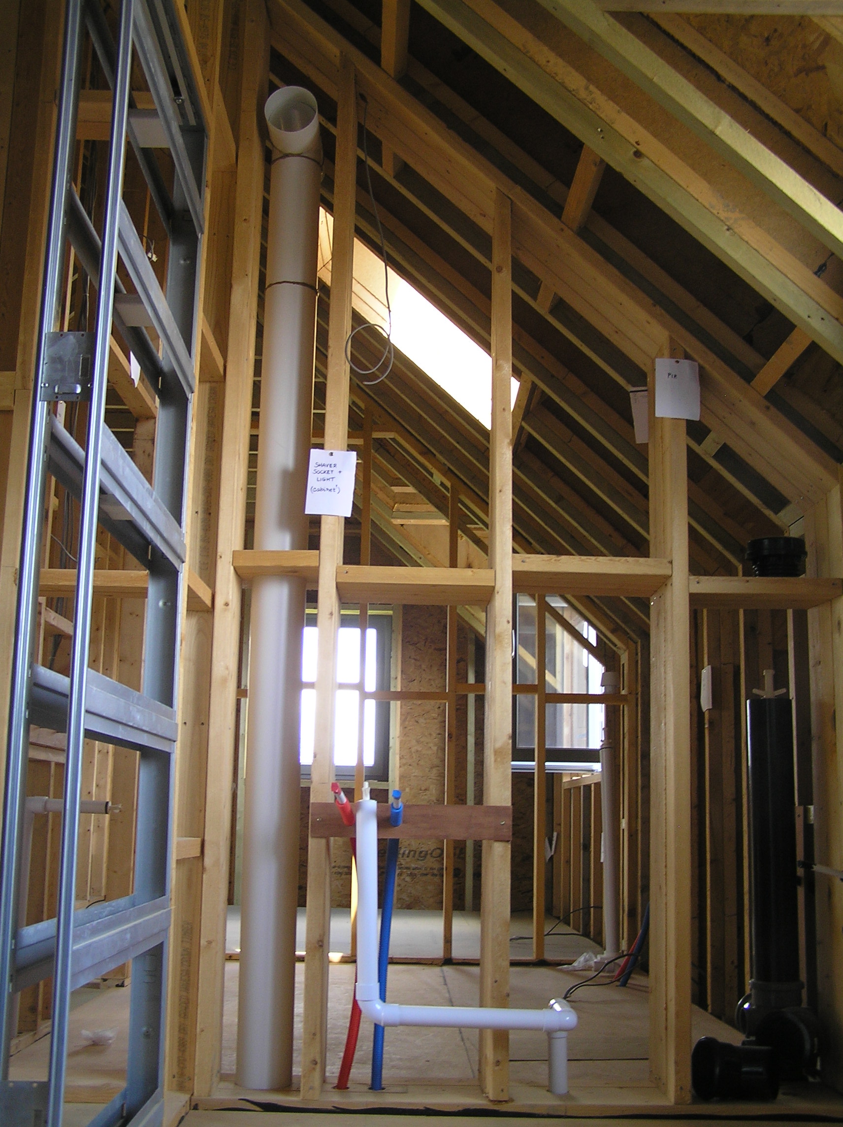

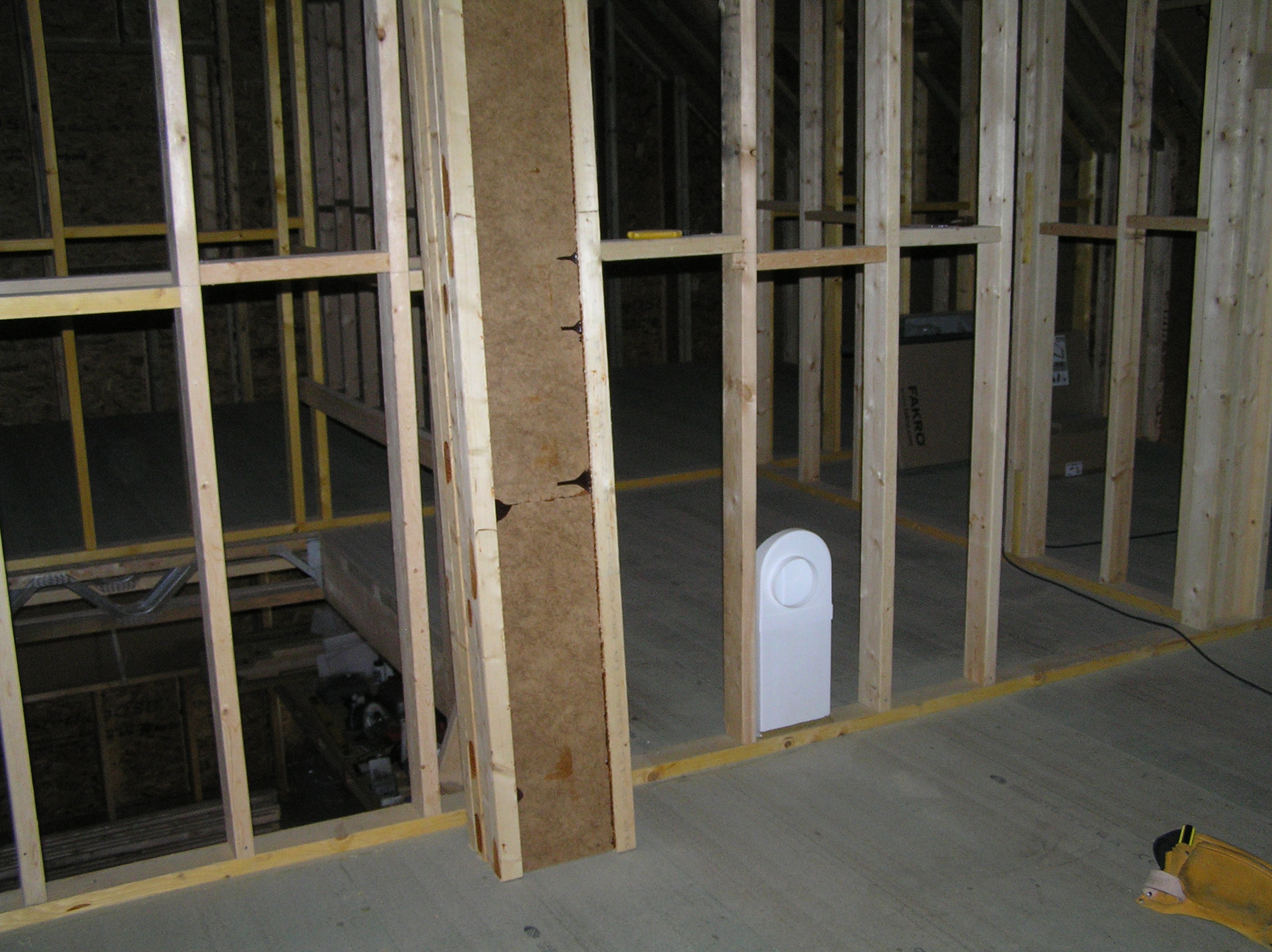

Gone West Posted September 23, 2017 Share Posted September 23, 2017 We also have vaulted ceilings upstairs and had room inlets at around 500mm above the floor. We used 204mm x 60mm ducting for that short length. The extracts in the bathrooms were through an extra wide internal wall between the ensuite and bathroom where we used 125mm round ducting. 1 1 Link to comment Share on other sites More sharing options...
