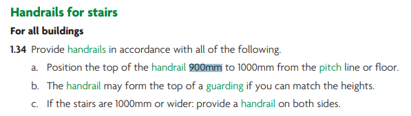

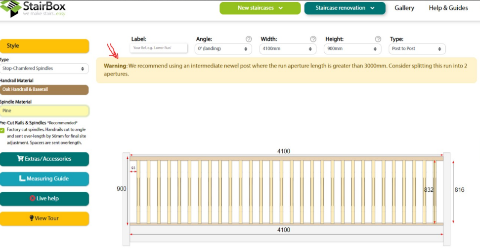

MortarThePoint Posted January 26, 2024 Posted January 26, 2024 Other than height (900mm I think) I can't find any particular guidance on balustrades. It feels like there should be some maximum distance that a balustrade can be before it needs an intermediate newel post, but I can't find a regulation for that. Stairbox suggests 3000mm. Has anyone found a regulation that applies or has any guidance beyond what Stairbox say?
Thorfun Posted January 26, 2024 Posted January 26, 2024 i'm not sure on the regulations but i believe the balustrade needs to resist a certain force and have certification that it does so. maybe Stairbox won't give that certificate if you don't have the extra newel post? 🤷♂️
joe90 Posted January 26, 2024 Posted January 26, 2024 “Domestic & Residential (Single Family Home), Internal Stairs/Landings Etc. In this case, the handrail must be able to withstand a pressure of 0.36kN/m. However, for external balconies and in light office areas that are not prone to overcrowding, this requirement is doubled to 0.74kN/m.
MortarThePoint Posted January 26, 2024 Author Posted January 26, 2024 32 minutes ago, joe90 said: pressure of 0.36kN/m Interesting, so adding that to the Stairbox 3000mm figure suggests each newel has to be able to take 1.08kN.
joe90 Posted January 26, 2024 Posted January 26, 2024 (edited) 28 minutes ago, MortarThePoint said: Interesting, so adding that to the Stairbox 3000mm figure suggests each newel has to be able to take 1.08kN. Really? I would have thought any point along the balustrade must resist 0.36kN/m so the handrail must resist this (snapping) and midpoint that load would be shared, so 0.18kN/m each, but incrementally raised to 0.36 as you get to each end Newel post. 🤷♂️ Edited January 26, 2024 by joe90
ProDave Posted January 26, 2024 Posted January 26, 2024 6 minutes ago, joe90 said: Really? I would have thought any point along the balustrade must resist 0.36kN/m so the handrail must resist this (snapping) and midpoint that load would be shared, so 0.18kN/m each, but incrementally raised to 0.36 as you get to each end Newel post. 🤷♂️ I read the extra post if >3M as suggesting if you don't then the balustrade rail might snap if you apply a .36kN/m load at mid point without the extra post.
joe90 Posted January 26, 2024 Posted January 26, 2024 7 minutes ago, ProDave said: I read the extra post if >3M as suggesting if you don't then the balustrade rail might snap if you apply a .36kN/m load at mid point without the extra post. Point taken but it’s still 0.36 not 1.08 ( >3m long timber handrail is too long IMO)
MortarThePoint Posted January 26, 2024 Author Posted January 26, 2024 I was assuming a UDL of 0.36kN/m so total load of 3m * 0.36kN/m = 1.08kN 1
joe90 Posted January 26, 2024 Posted January 26, 2024 20 minutes ago, MortarThePoint said: I was assuming a UDL of 0.36kN/m so total load of 3m * 0.36kN/m = 1.08kN UDL? 1
markc Posted January 26, 2024 Posted January 26, 2024 54 minutes ago, joe90 said: UDL? Uniform/uniformly distributed load 2
joe90 Posted January 26, 2024 Posted January 26, 2024 I guess stair suppliers/manufacturers test theirs to make sure they conform. It would be difficult to DIY and prove conformity (glad I bought a kit 🤷♂️)
