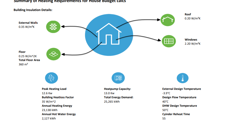

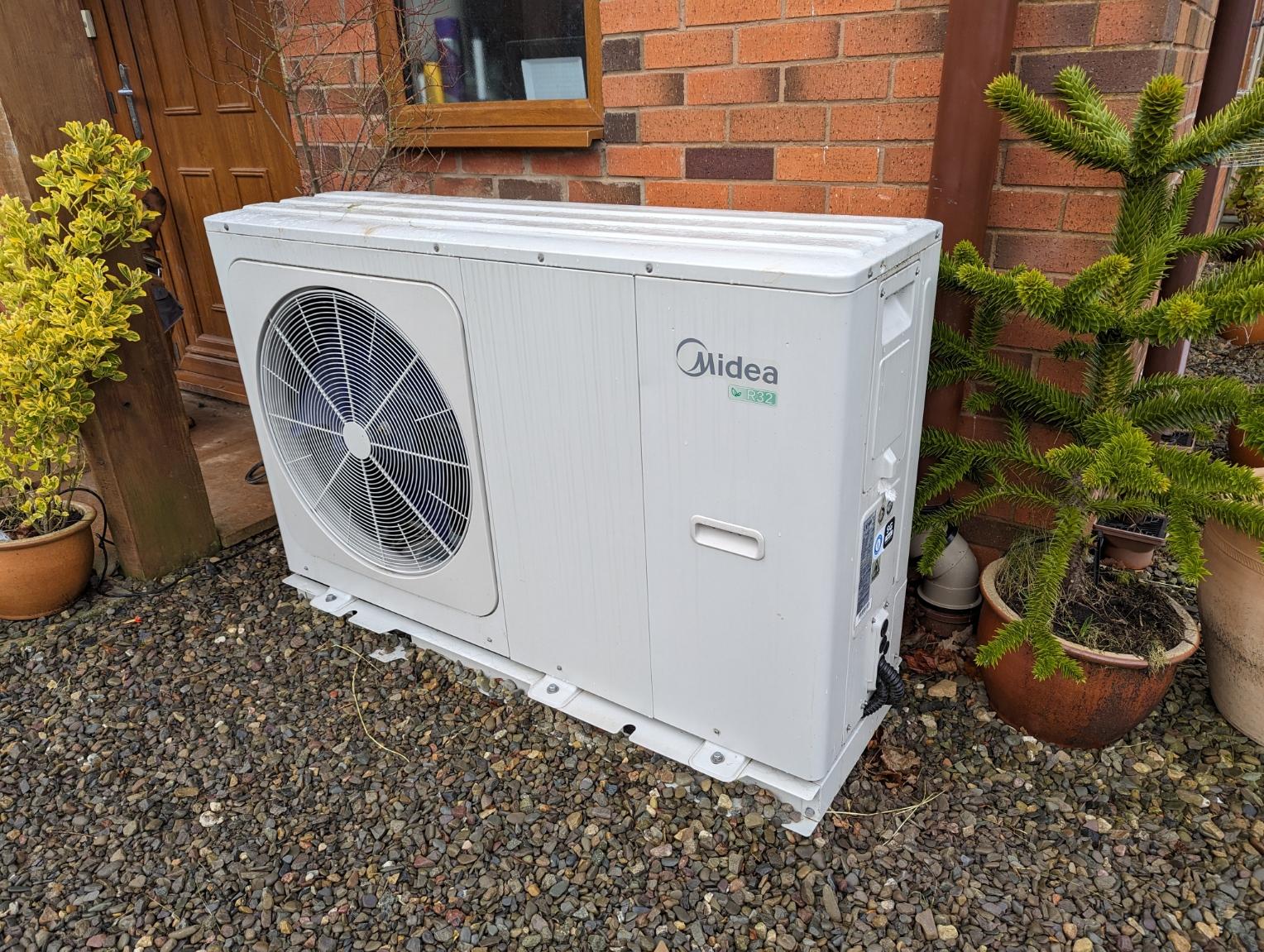

M0rtimer Posted January 26 Share Posted January 26 (edited) Hi, I am a complete novice/idiot when it comes to home diy/build issues. We had an ASHP installed 11 months ago and it has proven totally unsuitable for our property. It struggles to mainatin temperature during cold spells, is on constantltly so that the electric usage is huge and only heats the water to 45C which is not enough for the 4 in the house when we want baths/showers in the evening. Rather than this being a sysytem to improve our lives, we are having to change our lifestyles to fit with the machine. Any thoughts? I may put it all on the for sale page!! Midea R32 with Tempest tank Edited January 26 by M0rtimer Link to comment Share on other sites More sharing options...

ProDave Posted January 26 Share Posted January 26 So total energy demand 25,265kWh per year, which currently at about 28.5p per kWh is an astonishing £7200 per year. What were you paying previously? I bet it is nothing like that. I would have ran a mile from that. How much are you actually using per month? And remember this will be in addition to your normal usage. Link to comment Share on other sites More sharing options...
M0rtimer Posted January 26 Author Share Posted January 26 8 minutes ago, ProDave said: So total energy demand 25,265kWh per year, which currently at about 28.5p per kWh is an astonishing £7200 per year. What were you paying previously? I bet it is nothing like that. I would have ran a mile from that. How much are you actually using per month? And remember this will be in addition to your normal usage. The meter also covers a farm building with units so not all the house, but yes, the bill was indeed around £7,000 per annum. The ASHP is just for the house itself. It is such a disater, I am tempted to remove and sell used? Link to comment Share on other sites More sharing options...
BadgerBadger Posted January 26 Share Posted January 26 1 hour ago, ProDave said: So total energy demand 25,265kWh per year, which currently at about 28.5p per kWh is an astonishing £7200 per year. What were you paying previously? I bet it is nothing like that. I would have ran a mile from that. How much are you actually using per month? And remember this will be in addition to your normal usage. Haven't checked the sums on total heat loss, but if that's the total figure for losses then the ashp consumption should be ~one third of that if we roughly assume a COP of 3. Link to comment Share on other sites More sharing options...

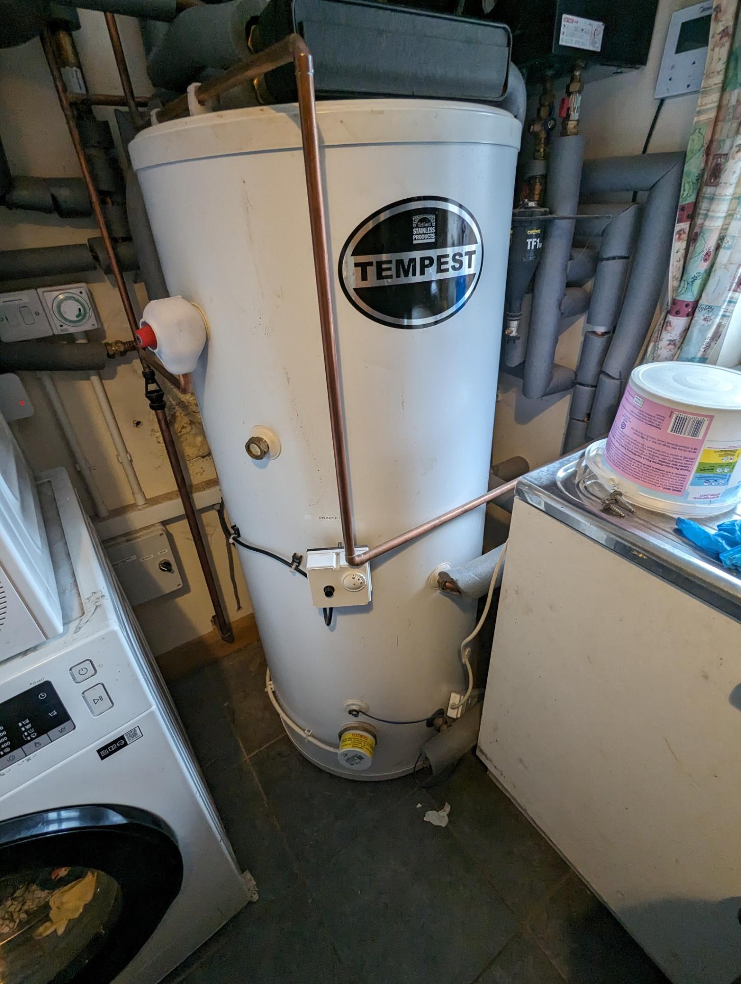

Andehh Posted January 26 Share Posted January 26 (edited) What research did you do into ASHP and it's applicability to you? How did you come across the need for one? Are you on mains gas? DHW is an instant odd one, ours currently heats ours to 50degs, and can do nearly 55 degrees. Yours should be able to do the same. Do you have UFH? Did you over size the radiators? Your heat loss is pretty average for a newish buildin the last 10/20 years and isn't the worst I've seen, but it won't be cheaper to run then other sources of heating... I wouldn't expect it to be ruinous to run though. How warm do you like the house? Also, what's your actual usage of the ASHP? "powering external units" clouds the information you're providing. Edited January 26 by Andehh Link to comment Share on other sites More sharing options...
M0rtimer Posted January 26 Author Share Posted January 26 I hope this helps if I answer each point - but I am dim on some of it! What research did you do into ASHP and it's applicability to you? - I spoke to a couple of registered companies, one just 3 miles from me was highly recommended. How did you come across the need for one? Are you on mains gas? - Oil boiler which was at the end and needed replacing and thought I would do might bit for the planet. We have also fitted solar panels. DHW is an instant odd one, ours currently heats ours to 50degs, and can do nearly 55 degrees. Yours should be able to do the same. - The company said best efficiency was betwen 40 and 45. It will do higher but is then working harder. Do you have UFH? Did you over size the radiators? - UFH on graoundfloor 30ft x 90ft and then radiator in 7 first floor rooms. Your heat loss is pretty average for a newish buildin the last 10/20 years and isn't the worst I've seen, but it won't be cheaper to run then other sources of heating... I wouldn't expect it to be ruinous to run though. - I agree our biggest issue is heat loss. The ASHP then struggles to hold the temperature and heat the hot water. How warm do you like the house? goundfloor 20C. Small annex with elderly mother 22C and upper floor bedrooms 21C Also, what's your actual usage of the ASHP? "powering external units" clouds the information you're providing. The electric usage from 10th january - 1st October was 6056kwh. Link to comment Share on other sites More sharing options...

M0rtimer Posted January 27 Author Share Posted January 27 Thank you all, this is comforting. The ASHP is using the 6000kwh over the 10 months. The rest is farm/business units which is why it reaches the £7200. I think you are suggesting that I can turn up the water temperature on both the underfloor and the hot water system and monitor effect and usage. I think one issue has been if the hot water is low, then when you have a bath or shower little to no cold is dded and so with 4 in the house, there is not enough hot water for all getting ready for an evening out. With the old boiler system at 65C, there was hot water that you then topped up with cold, so plenty in the tank for all. As I said at the start, it seems like we are having to change our lifestyle for the ASHP. Your comments are all amazingly helpful though and much appreciated. One final one might be how much would it be worth if I took it out and went back to a boiler. Cost to install £12,000 Link to comment Share on other sites More sharing options...

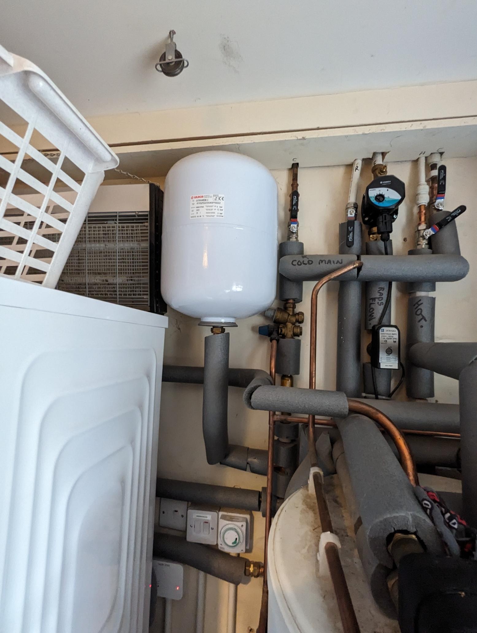

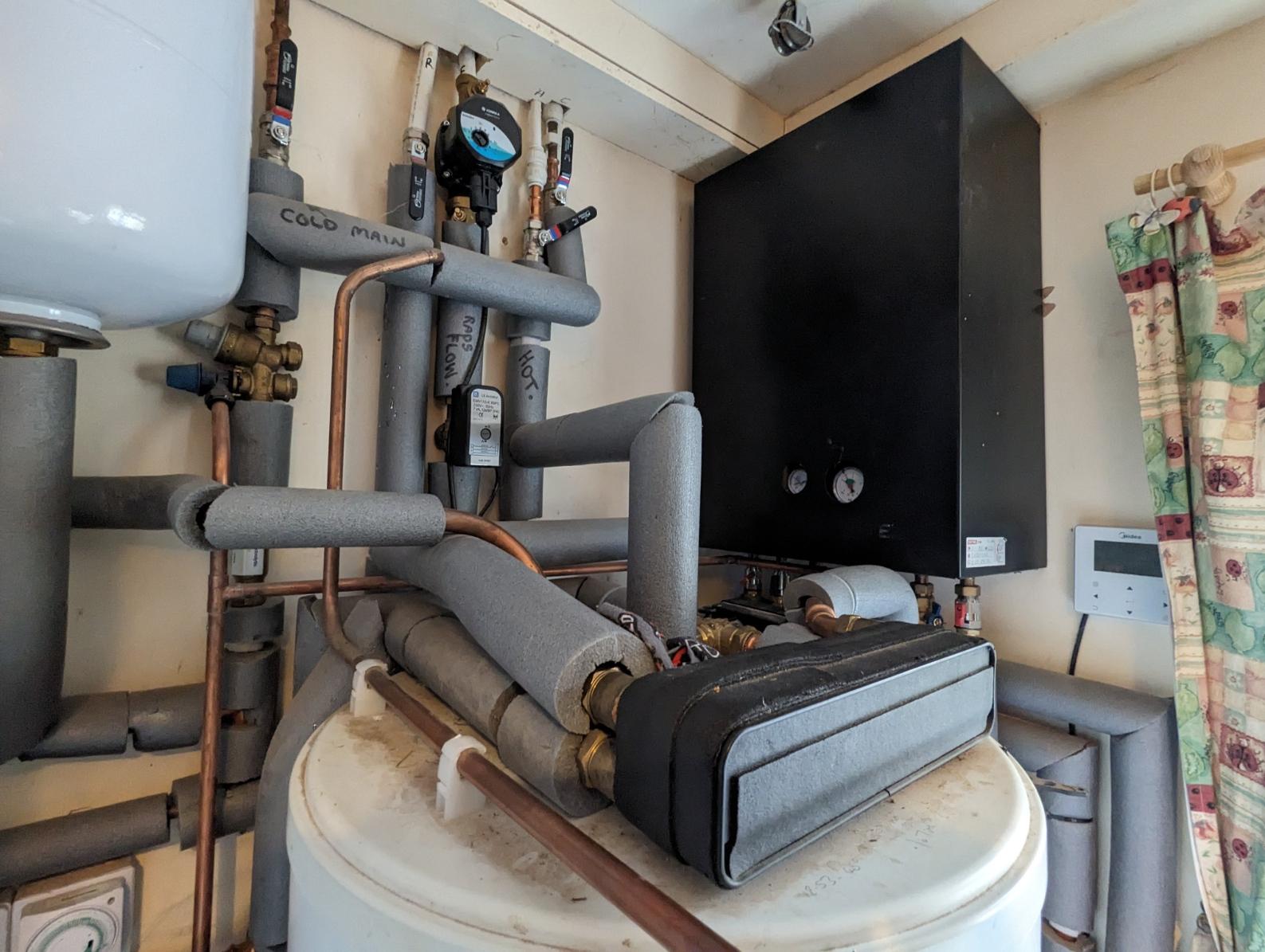

HughF Posted January 27 Share Posted January 27 Midea, supplied by and plumbed according to freedom heatpumps instructions, which include the use of a plate heat exchanger. a couple of days replumbing this will make it much more efficient at heating the house… 1 Link to comment Share on other sites More sharing options...
HughF Posted January 27 Share Posted January 27 It’ll make about a grand on eBay, second hand…. You’d be better off spending the money on having it plumbed direct, ditch the plate heat exchanger and get the weather comp adjusted. 1 Link to comment Share on other sites More sharing options...
M0rtimer Posted January 27 Author Share Posted January 27 22 minutes ago, HughF said: It’ll make about a grand on eBay, second hand…. You’d be better off spending the money on having it plumbed direct, ditch the plate heat exchanger and get the weather comp adjusted. Thank you, very useful information. The system is a bit odd as we have it plumbed so that we can run a boiler as well if necessary. (Back up) I think that may be why there is a heat exchange, but if you can supply more information I can certainly ask the questions. Link to comment Share on other sites More sharing options...
sharpener Posted January 27 Share Posted January 27 (edited) Yes, a heat exchanger will introduce a temp drop between primary and secondary side you do not want. Also do you have a buffer tank, they are another cause of inefficiency. If you are making changes fit a dedicated meter for the HP so you can disentangle its consumption from the rest of the house, farm, units and whatnot. Then you will be able to see properly the effect of any improvements. Edited January 27 by sharpener Link to comment Share on other sites More sharing options...
HughF Posted January 27 Share Posted January 27 4 minutes ago, M0rtimer said: Thank you, very useful information. The system is a bit odd as we have it plumbed so that we can run a boiler as well if necessary. (Back up) I think that may be why there is a heat exchange, but if you can supply more information I can certainly ask the questions. Bivalent systems are usually plumbed up with non return valves. The plate will be there to ensure warranty compliance with freedom heat pumps who supply midea here in the Uk. Sounds like your system is working though. 6000kWh/annum isn’t much. £1800/year on backstop rate. Link to comment Share on other sites More sharing options...

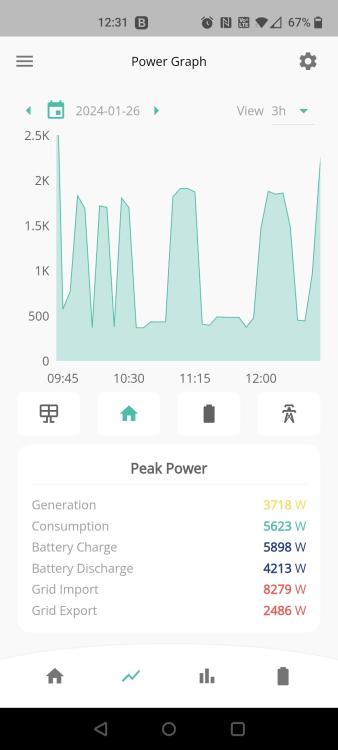

SteamyTea Posted January 27 Share Posted January 27 54 minutes ago, M0rtimer said: The rest is farm/business units which is why it reaches the £7200. Can you fit a sub meter for that supply, then at least you know what is going where. And while the power is off, fit one to monitor just the heat pump. Link to comment Share on other sites More sharing options...
JohnMo Posted January 27 Share Posted January 27 (edited) I found from my install of an ASHP, little changes can make a dig difference to how much electricity you use. There are several ways to have the circulation pump run, for example. Recently changed mine from continuous to intermittent as decided by the internal temperature controller. Thought it may save some energy - but just the opposite An image of the electric consumption but shows the ASHP starting and stopping. The left three peaks are letting the heat pump control the circulation pump, the other wider spaced peaks are circulation pump on all the time. First three peaks is the ASHP short cycling, plenty of electric going in not much heat coming out. The other two peaks show longer run times, but also long off times. It was 8 degs at the time and heat pump running very low loads. The main take away from the above, is you need to take the time to understand how your heat pump is running to get the best out of it. (Most heat from least electricity). Have also found leaving to run all the time let's you lower flow temperatures so you use less electricity. Edited January 27 by JohnMo 1 Link to comment Share on other sites More sharing options...
HughF Posted January 27 Share Posted January 27 31 minutes ago, sharpener said: Yes, a heat exchanger will introduce a temp drop between primary and secondary side you do not want. Also do you have a buffer tank, they are another cause of inefficiency. If you are making changes fit a dedicated meter for the HP so you can disentangle its consumption from the rest of the house, farm, units and whatnot. Then you will be able to see properly the effect of any improvements. Midea wont be installed with a buffer. Plate or LLH depending on the year of install. Link to comment Share on other sites More sharing options...
Beelbeebub Posted January 27 Share Posted January 27 My 2bobs worth.... Is your HP set to weather compensated? You don't mention it. That will help. Not keeping you warm in the cold periods: you may need to up the flow temp for the cold periods. Weather compensation will ensure that the flow temp is lower during the milder periods. The plate heat exchanger won't help. It means your HP will need to run a few degrees hotter than it migbt otherwise. You mention it was installed to allow a boiler to also be used (it may also be to allow glycol to be used in the HP side) Is it possible to get the system replumbed so you run the HP direct and the boiler is connected via the heat exchanger? Given you have an (oil?) boiler backup - you could use that for the few very cold periods when you estimate it's cheaper to run or the HP struggles. Running the boiler a few times a year will help keep it working well and you mihbt as well use it of you've paid for it.!😁 Link to comment Share on other sites More sharing options...
HughF Posted January 27 Share Posted January 27 (edited) 3 minutes ago, Beelbeebub said: My 2bobs worth.... Is your HP set to weather compensated? You don't mention it. That will help. Not keeping you warm in the cold periods: you may need to up the flow temp for the cold periods. Weather compensation will ensure that the flow temp is lower during the milder periods. The plate heat exchanger won't help. It means your HP will need to run a few degrees hotter than it migbt otherwise. You mention it was installed to allow a boiler to also be used (it may also be to allow glycol to be used in the HP side) Is it possible to get the system replumbed so you run the HP direct and the boiler is connected via the heat exchanger? Given you have an (oil?) boiler backup - you could use that for the few very cold periods when you estimate it's cheaper to run or the HP struggles. Running the boiler a few times a year will help keep it working well and you mihbt as well use it of you've paid for it.!😁 Midea WC setup is part of the install process. It should have been setup. 55@-2, 37@15 are the defaults. Graham Hendra’s ‘Lizzie’ curve, named after his wife who complained the rads were always cold. Edited January 27 by HughF 1 Link to comment Share on other sites More sharing options...
