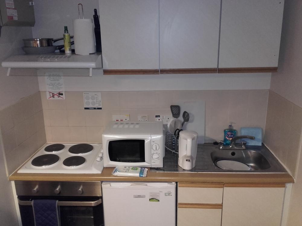

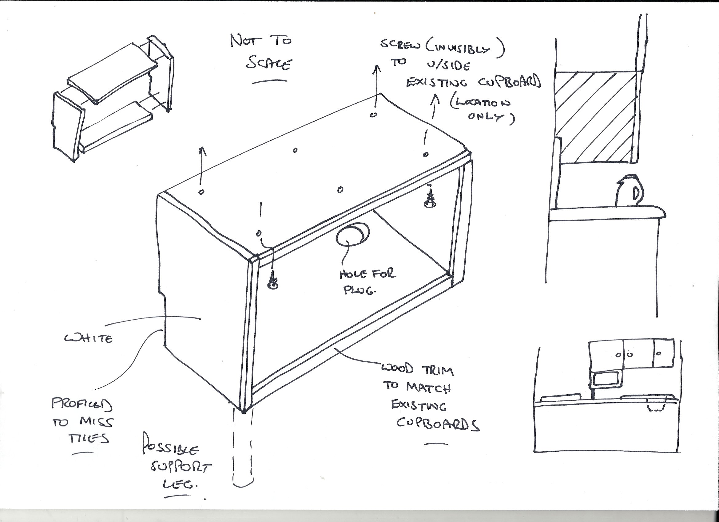

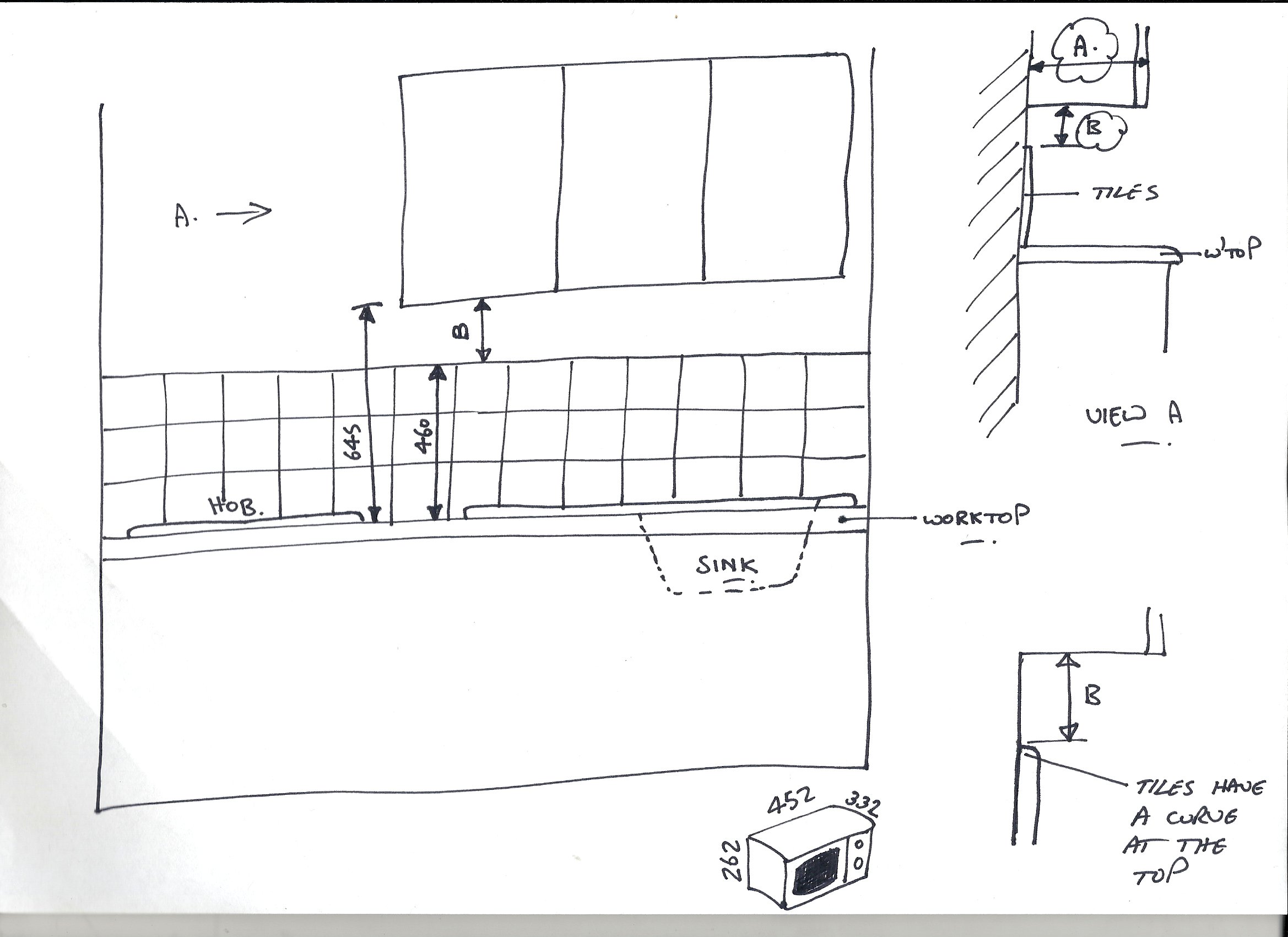

Evening, what's the thoughts on clearance all round on an enclosed shelf for raising a 700W microwave up in the air to give more worktop space? Thinking to construct from white painted flooring grade chipboard  with stained wood trim. Bit hesitant about drilling the wall as rented student accommodation etc.

Looking good, what about the ventilation on top of microwave,
I don't suppose the microwave could go *in* the wall unit? If you took a door off?
Hence the question about how much clearance is wise to leave all round!

Is this a private uni rental or onsite de facto uni digs? If the latter, they may have their SOPs etc when it comes to kitchen alterations etc. Not sure if they have regular 'inspections'? But yes, having the m/w on a shelf rather than partly on that draining board would be a whole lot safer, free up space etc.
You can also get these mesh shelves - more air circulation: http://www.shop-equip.com/wire-wall-shelf.htm.
Probably also worth putting up a notice on the m/w "I need ventilation - Do not place chopping boards etc on top of me".
Every wall in the flat has signs of being previously drilled for brackets or whatever and has been very badly filled and not painted over. I'm going to re-mastic all the worktop edges etc. Just looks tatty and is a breeding ground for germs. The temptation is to balance the kettle or toaster on the microwave. I really don't want anything toppling into the sink.
Anything I do will be ideally easily removeable and tbh will only add to the useability and safety of the place. Again, ideally, I'd drill the wall above where the sockets are but want to try and avoid that for various reasons (noise, hitting something). Thus the "shelf" will likely be on a leg (s). Tbh was even considering a line of Sika bond to the wall backing it up though that's a bit permanent. Maybe one leg, Sika on the back and a few screws to the u/side of the cupboard. Do it and argue the toss later on the grounds of safety.
