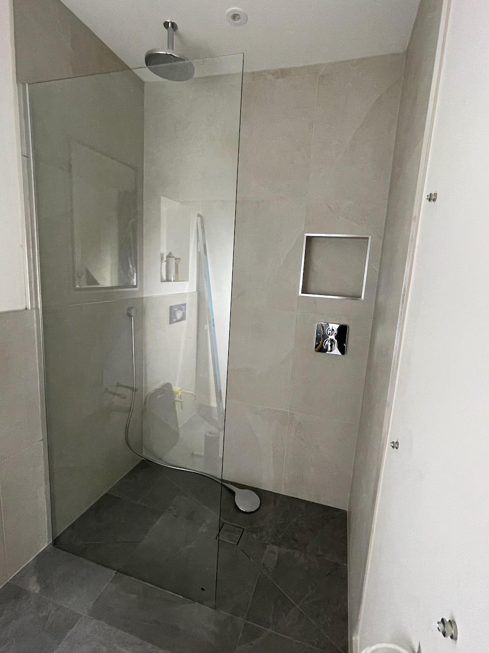

Thorfun Posted January 15 Share Posted January 15 just another perspective here, we cut out the caber deck and fitted shower formers so that the tiles went directly onto the former and everything is level with the rest of the bathroom. we love the sleek look of it. might be something worth considering? unless you specifically want to step up in to a shower that is. 😉 1 Link to comment Share on other sites More sharing options...
crispy_wafer Posted January 15 Author Share Posted January 15 Shower tray is 35mm, add tiles and adhesive, so there'll be about 20mm +- a bit step. I don't feel confident with me DIY'ing a former on my 1st floor too much internet reading has frightened the bejesus out of me, so I'm not going to give it any head space. Yours looks spot on though @Thorfun! Link to comment Share on other sites More sharing options...
Thorfun Posted January 15 Share Posted January 15 4 minutes ago, crispy_wafer said: Shower tray is 35mm, add tiles and adhesive, so there'll be about 20mm +- a bit step. I don't feel confident with me DIY'ing a former on my 1st floor too much internet reading has frightened the bejesus out of me, so I'm not going to give it any head space. Yours looks spot on though @Thorfun! if you've already bought the tray then it's a no brainer. fitting the former wasn't hard at all. i bought the Impey Aqua-Dec former which was incredibly easy to fit and is cuttable to trim to size. i put 6mm ply on top of the posi-joists and then the former on top of that and screwed it down. then the tiler came along and put 6mm Jackoboard down so everything was level. 1 Link to comment Share on other sites More sharing options...
jayc89 Posted January 15 Share Posted January 15 21 minutes ago, Thorfun said: just another perspective here, we cut out the caber deck and fitted shower formers so that the tiles went directly onto the former and everything is level with the rest of the bathroom. we love the sleek look of it. might be something worth considering? unless you specifically want to step up in to a shower that is. 😉 What's the dimensions of that shower area? Looks well! Link to comment Share on other sites More sharing options...
Thorfun Posted January 15 Share Posted January 15 31 minutes ago, jayc89 said: What's the dimensions of that shower area? Looks well! ended up just a smidge over 1400mm long and 760mm wide after tiles and shower screen. 1 Link to comment Share on other sites More sharing options...

crispy_wafer Posted January 15 Author Share Posted January 15 1 hour ago, Thorfun said: if you've already bought the tray then it's a no brainer. fitting the former wasn't hard at all. i bought the Impey Aqua-Dec former which was incredibly easy to fit and is cuttable to trim to size. i put 6mm ply on top of the posi-joists and then the former on top of that and screwed it down. then the tiler came along and put 6mm Jackoboard down so everything was level. Spot on, Thankyou. 1 Link to comment Share on other sites More sharing options...
