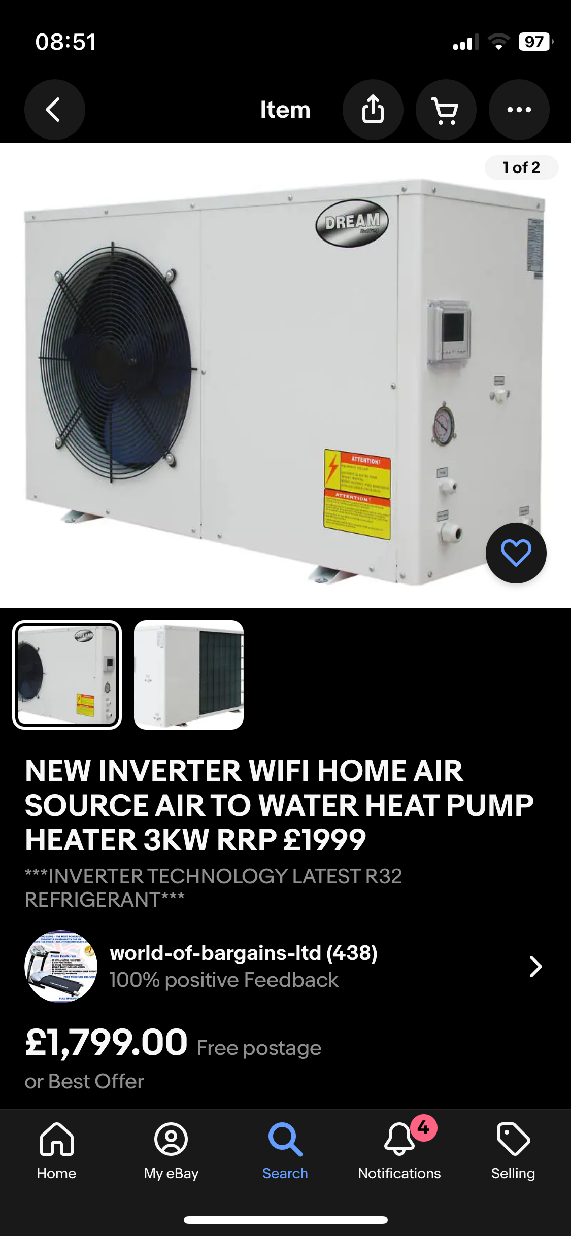

Dream do a 3.5kW unit for under £1k
Single flow temp for DHW and heating, fixed duty, so you will need a buffer most likely.

Not for ufh, just set a fixed temp and pump the water round the slab…. Let it defrost from the slab…

You could, but not very good for DHW. It only outputs a single flow temp, DHW flow and CH flow temp is done at same flow temp. It really pool pump with a couple of additional features, but not much.
Even the inverter one is a single flow temp for DHW and CH, it just modulates it's load not the temperature.
The dream units are interesting, mainly for their low price.
They claim a toshiba scroll compressor (so good brand and good tech).
I note they are r410a, which is an obsolete tech, I wonder if they are getting them cheap in some sort of "fire sale".
The fixed output temp indicates they have cut costs by having the most basic control electronics for the HP. It's possible they don't even have a reversing valve for defrost.

The dream units have been on eBay for the past 4 years. Last time I looked they wasn’t inverter driven so probably cost a fortune to run.

If you heat a buffer at a fixed temp say 30/35 and have another means of heating DHW and/or use the buffer to preheat water going to the DHW cylinder, shouldn't be be too bad to run.  Just how things used to be a decade ago (or more).
They are basic heat pump, and they are cheap. The inverter ones are R32 and internet connected (smart) but the functionality is no different to the basic unit, apart from modulation.

Yep, it seemed an ideal solution. Buy the smallest one (3.5kW) and just pump it straight to the loops with a fixed flow temp.
R32, inverter driven…. Still not a bargain, but it’s a start.

The dream units look interesting but for the price still a expensive especially given I can't see any proper way to control them using a thermostat to call for heat without starting to rig 3rd party control systems etc.
