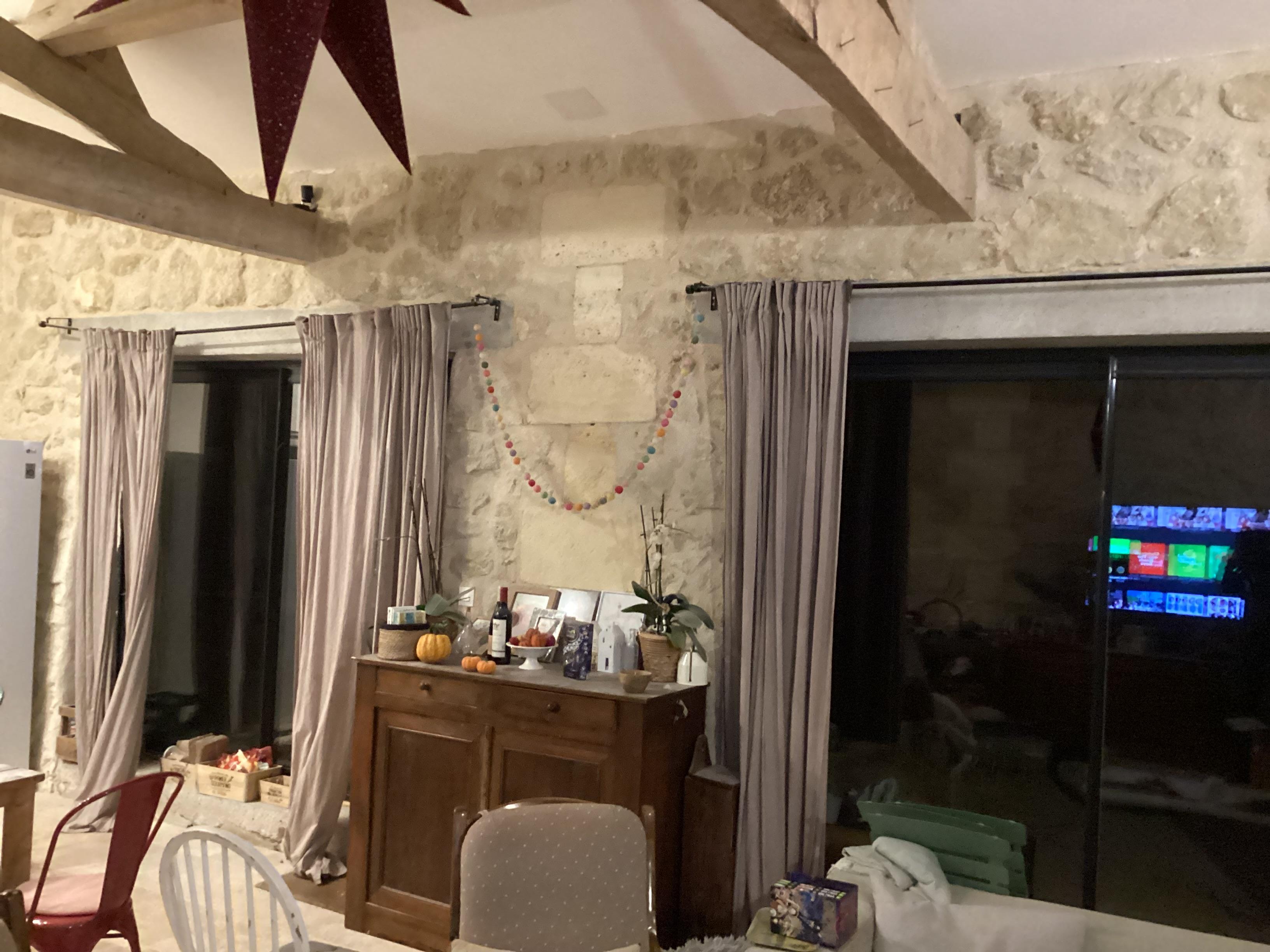

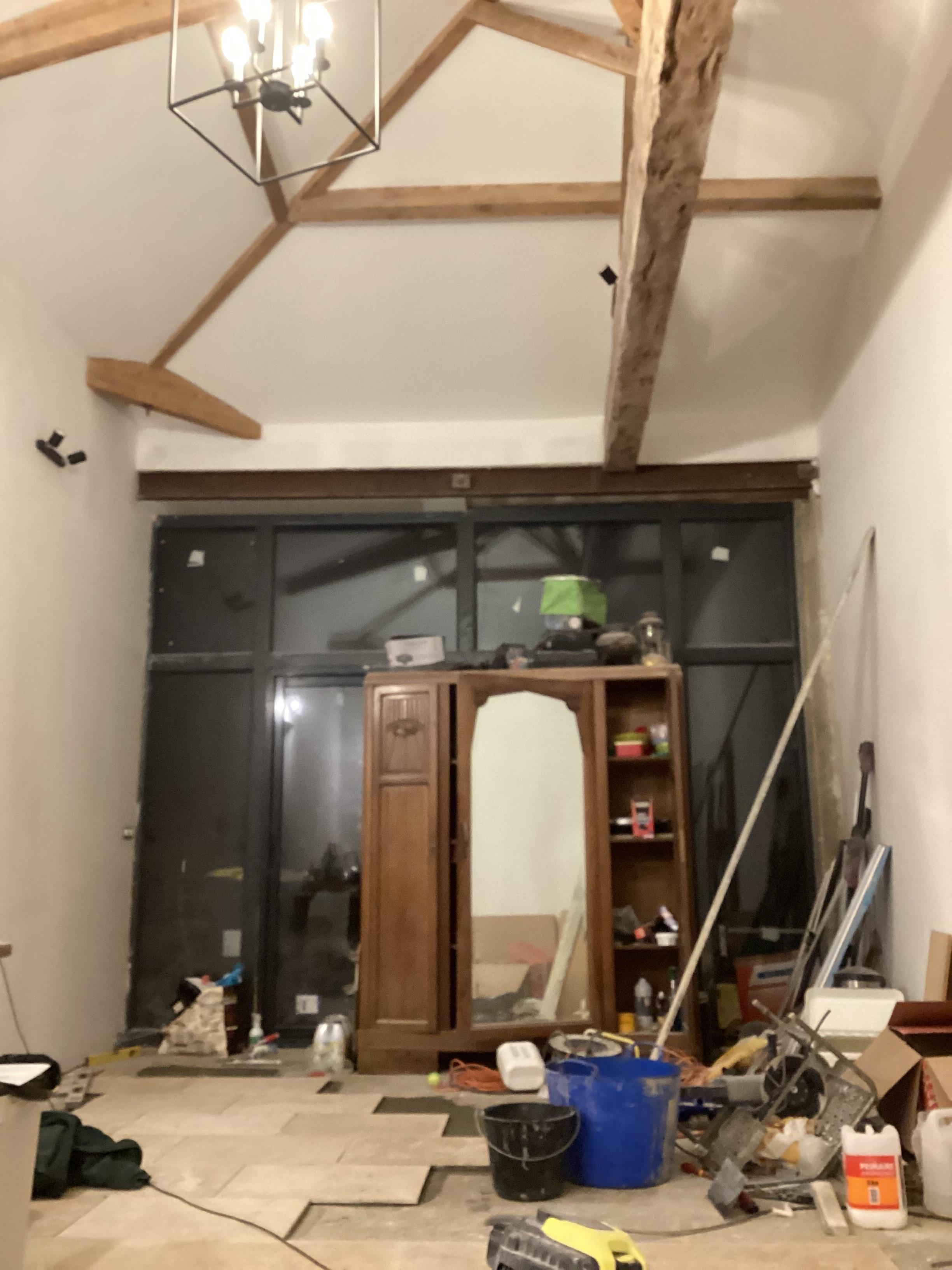

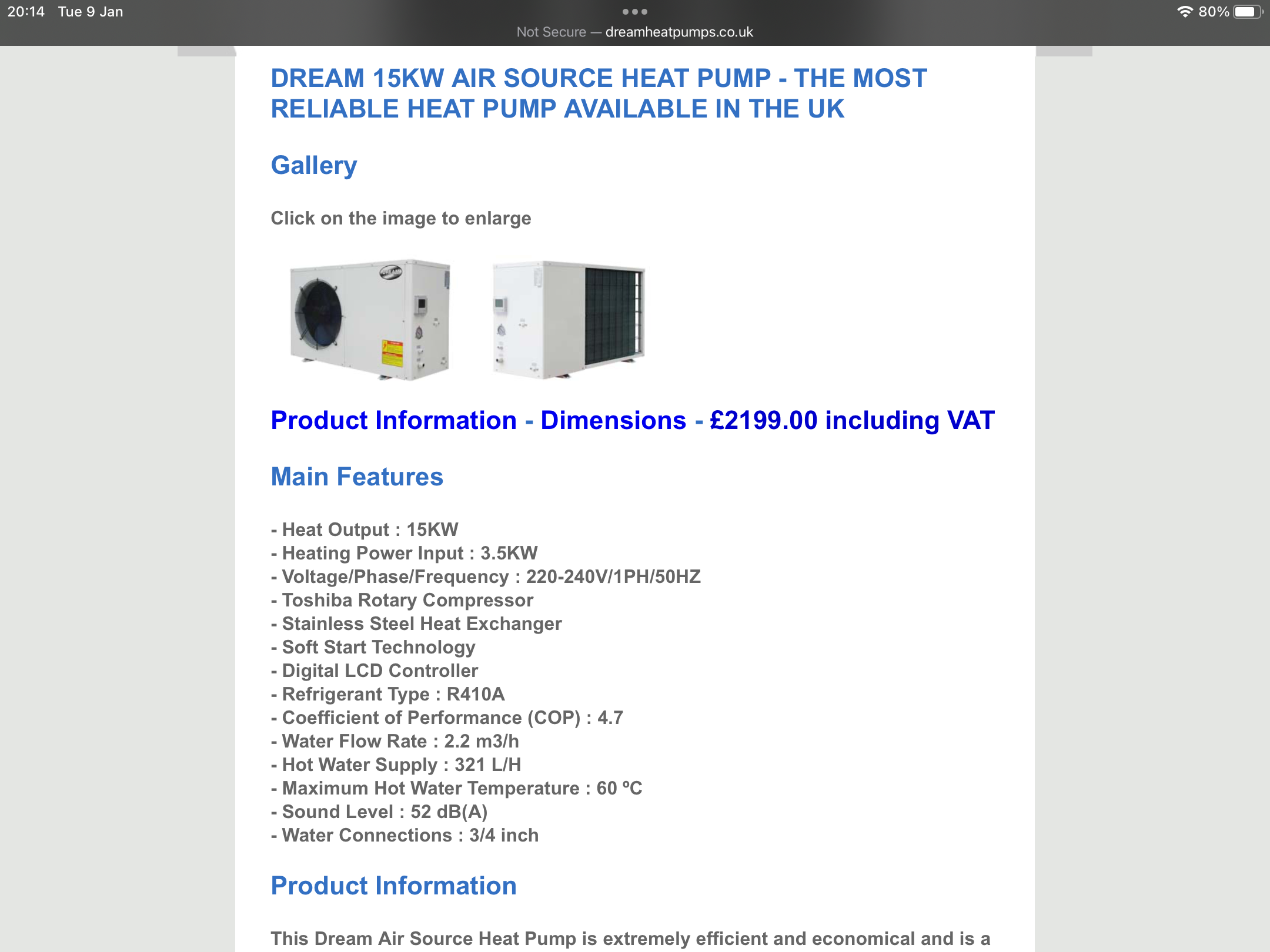

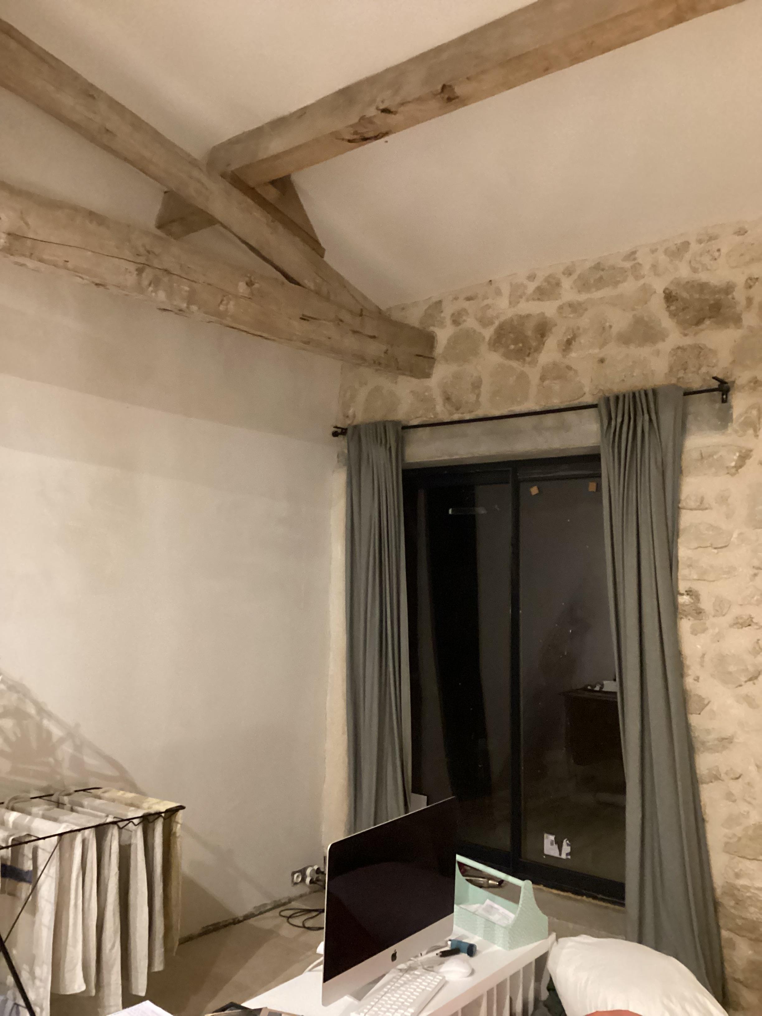

I have been renovating an old barn in France, 125sqm. The kitchen sitting room and 1 of the bedrooms have large ceilings. The walls in sitting room and bedroom have been pointed, so no insulation on them. My sons bedroom is really well insulated everywhere as is the bathroom and en-suite. We have large window doors throughout the house. I will attach some pictures. I bought my heat heat pump from a website in the uk Dream heat pumps, as it was reasonably priced. Unfortunately I don’t have a never ending pit of money and couldn’t afford an expensive heat pump. I will also add a picture of the specs of the heat pump taken from the website.

Thanks for the replies, I really appreciate it. My partner was in touch with an underfloor heating and heat pump specialist yesterday who explained everything. Basically we have had shit advice from the start. He confirmed that our pump is way oversized, he advised on the exact pump to get and where to find it for the best price. Pretty gutted but at least we know now and can get it sorted soon. Looks like the kitchen will have to wait!
