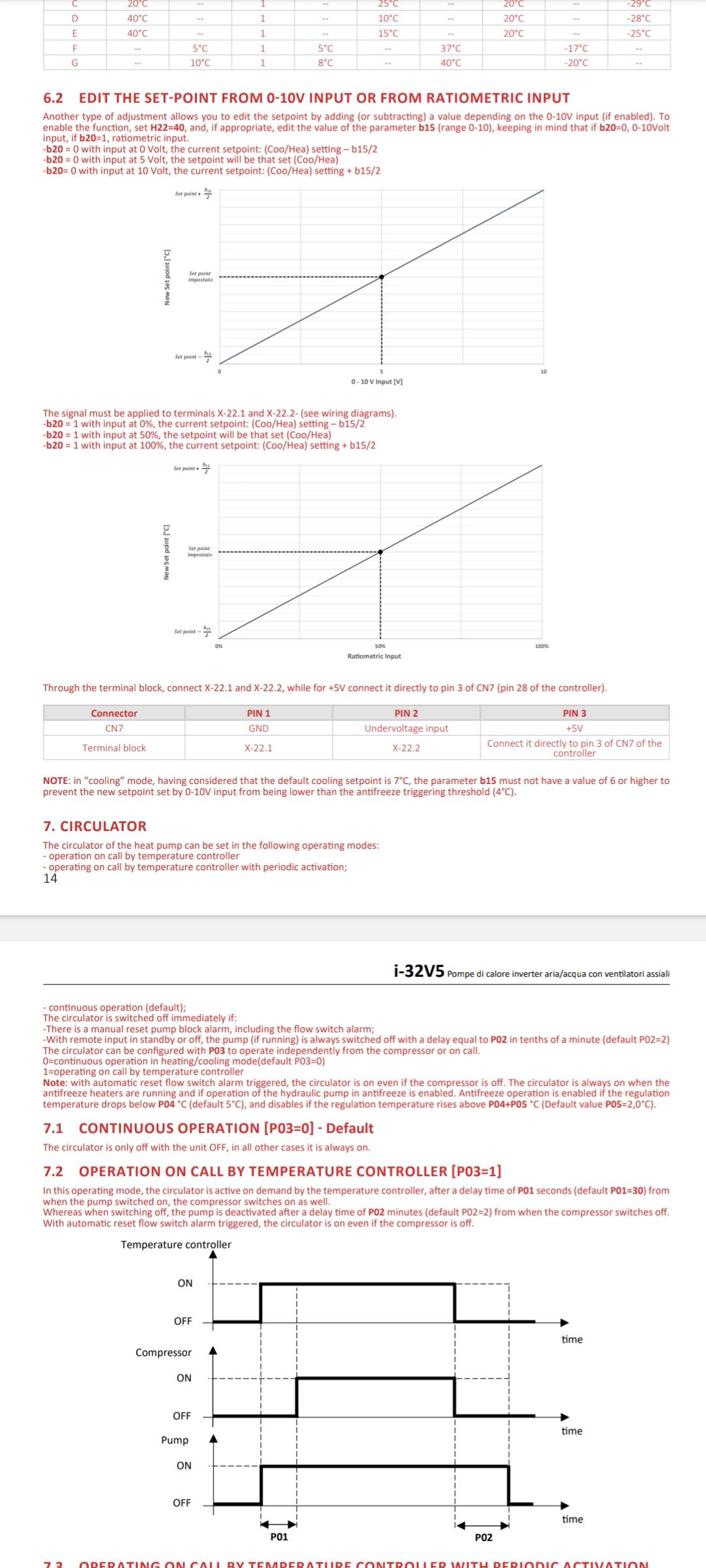

JohnMo Posted January 7, 2024 Share Posted January 7, 2024 7 hours ago, Brendan_w said: enable advanced weather compensation Does your heat pump accept a 0-10v input. An aircon type thermostat can output a 0-10v output, this up to reduce flow temp as required. May not work with UFH due to reaction time, but ok for radiators. This is a screenshot from my manual for a different heat pump Link to comment Share on other sites More sharing options...
HughF Posted January 7, 2024 Share Posted January 7, 2024 Good luck getting a heat pump to respond to changes to flow temp that quickly - you’d want to integrate the changes over a time period otherwise it will be hunting all over the place. The compressor response curves/finer points of the PID might not be adjustable in the Chofu. Link to comment Share on other sites More sharing options...

JohnMo Posted January 7, 2024 Share Posted January 7, 2024 3 minutes ago, HughF said: Good luck getting a heat pump to respond to changes to flow temp that quickly Those at the bottom are graphs referring to operation of circulation pump on-off cycles Just section 6.2 applied, not section 7. Link to comment Share on other sites More sharing options...
HughF Posted January 7, 2024 Share Posted January 7, 2024 Just now, JohnMo said: Those at the bottom are graphs referring to operation of circulation pump on-off cycles Just section 6.2 applied, not section 7. Sorry, my post was targeted to the OP. 1 Link to comment Share on other sites More sharing options...
