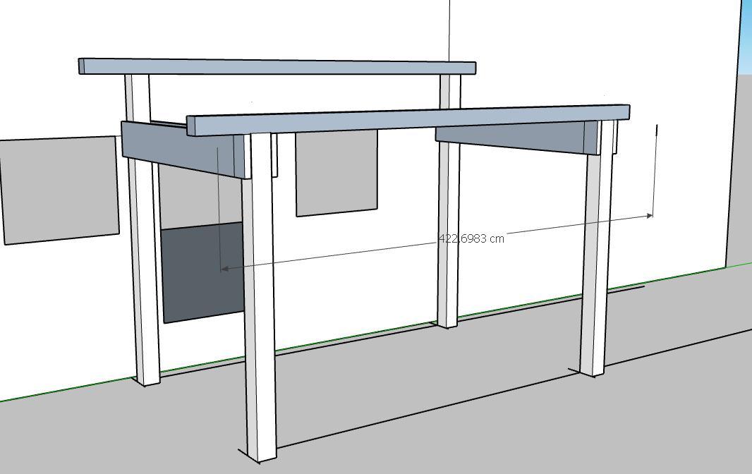

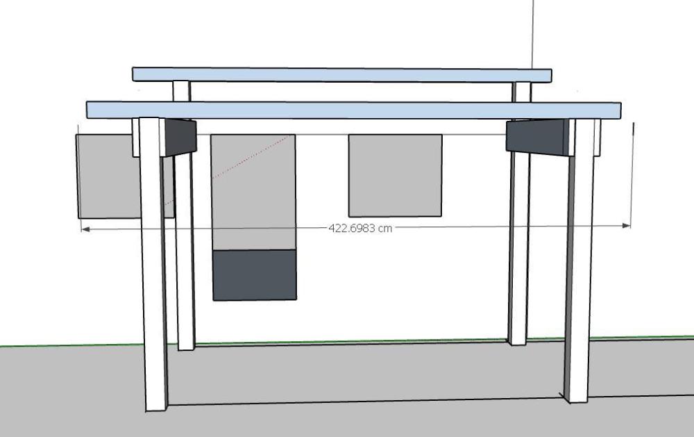

Onoff Posted May 10 Share Posted May 10 43 minutes ago, JohnBishop said: I use both, the stainless steel will go central over the expansion gap, the other one will go to the other side. The remaining 2 will be the ones that submerge to the concrete. So you got two of each? Link to comment Share on other sites More sharing options...

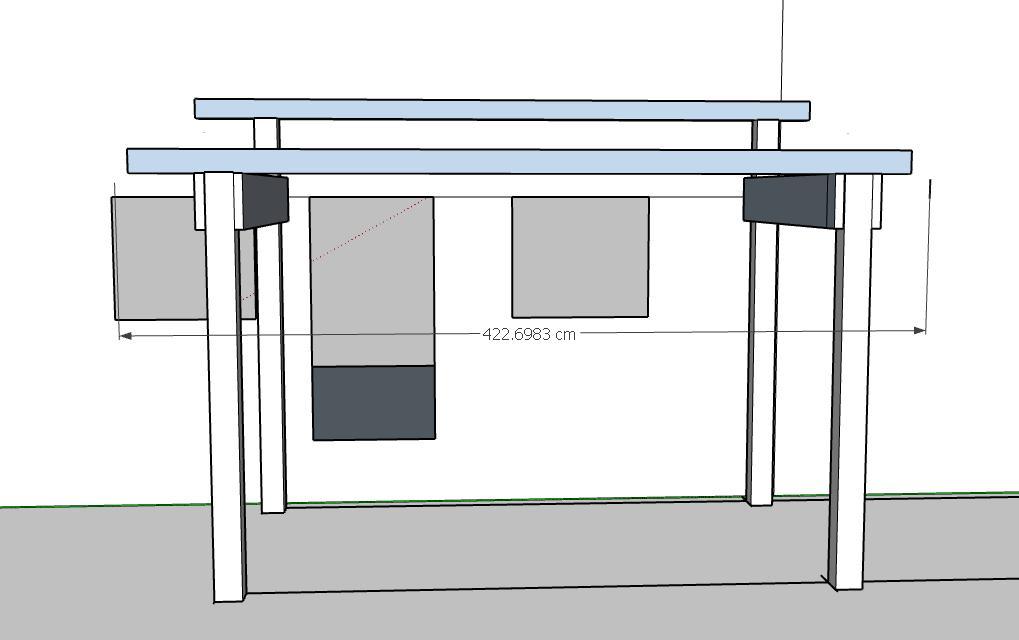

JohnBishop Posted May 11 Author Share Posted May 11 4 hours ago, Onoff said: So you got two of each? Have a look. I also made the crossbeams horizontal. It just does not make sense to make it at an angle, difficult to do and impractical. Link to comment Share on other sites More sharing options...

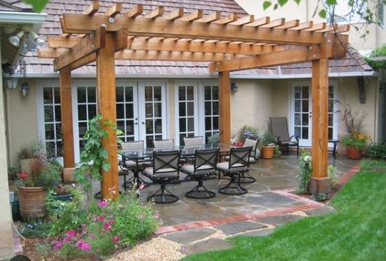

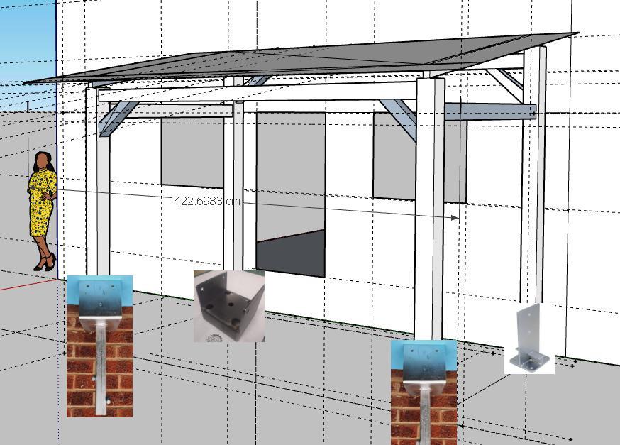

Onoff Posted May 11 Share Posted May 11 Cut through housings in your roof joists at the appropriate angle to fit over the front and rear goalposts. Just Google "pergola designs" and then Images for ideas. Link to comment Share on other sites More sharing options...
JohnBishop Posted May 11 Author Share Posted May 11 (edited) 3 hours ago, Onoff said: Cut through housings in your roof joists at the appropriate angle to fit over the front and rear goalposts. Just Google "pergola designs" and then Images for ideas. Do you mean not to bother with mortis and tendon just use 2x12 for girders and 2x10 for rafters? This would actually level everything. Edited May 11 by JohnBishop Link to comment Share on other sites More sharing options...
JohnBishop Posted May 11 Author Share Posted May 11 (edited) I can see in most cases they use girders even on both sides but it looks ugly if you ask me. In one case I can see the girder is inside posts with a sufficient cut I reckon to conceal it In this case the crossbeams go on top of the posts so I reckon this is still mortis and tendom but inserted from the top not from the side what makes more sense. It looks like I have over-engineered mine. I have to decide if I want to go the crossbeam on top or girders way. The girders way seems the simplest. Edited May 11 by JohnBishop Link to comment Share on other sites More sharing options...
Onoff Posted May 12 Share Posted May 12 Found at random: https://www.idealhome.co.uk/diy/building-a-pergola-things-to-consider Link to comment Share on other sites More sharing options...
JohnBishop Posted May 15 Author Share Posted May 15 I have updated my design. I just wonder if these 2x12 girders and 2x10 rafters are not an overkill.... Link to comment Share on other sites More sharing options...

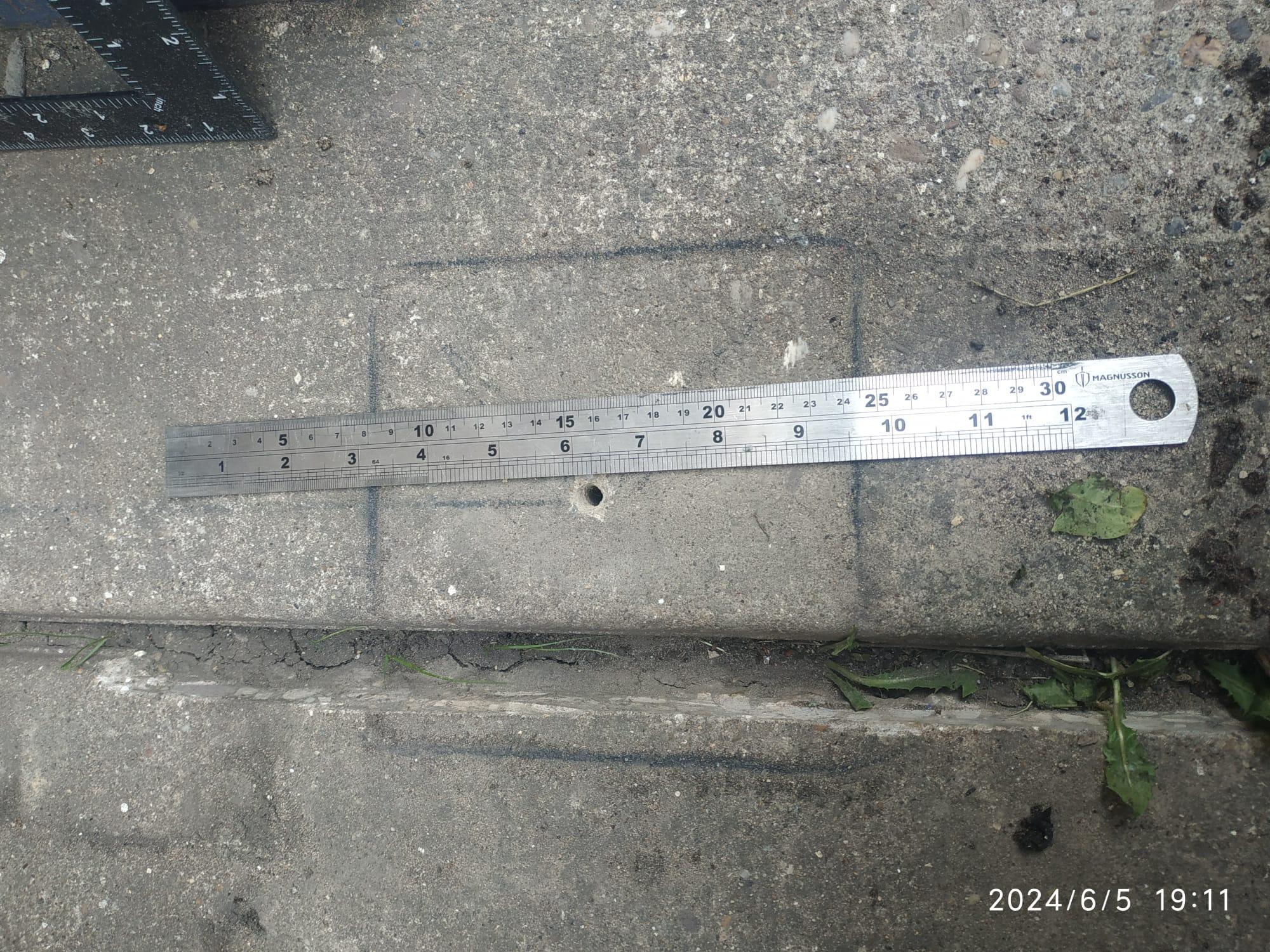

JohnBishop Posted May 28 Author Share Posted May 28 I have drilled some holes and it looks like the concrete is only 4 inches = 10cm deep and from PDFs you attached (thank you) the anchor length is 13cm minimum for M10 M10 studs 130/170/190mm M12 studs 160/190/220/260mm I think in this case I have to cut the concrete out and see if I can make twice as deep footings like 40cm deep or something. Link to comment Share on other sites More sharing options...

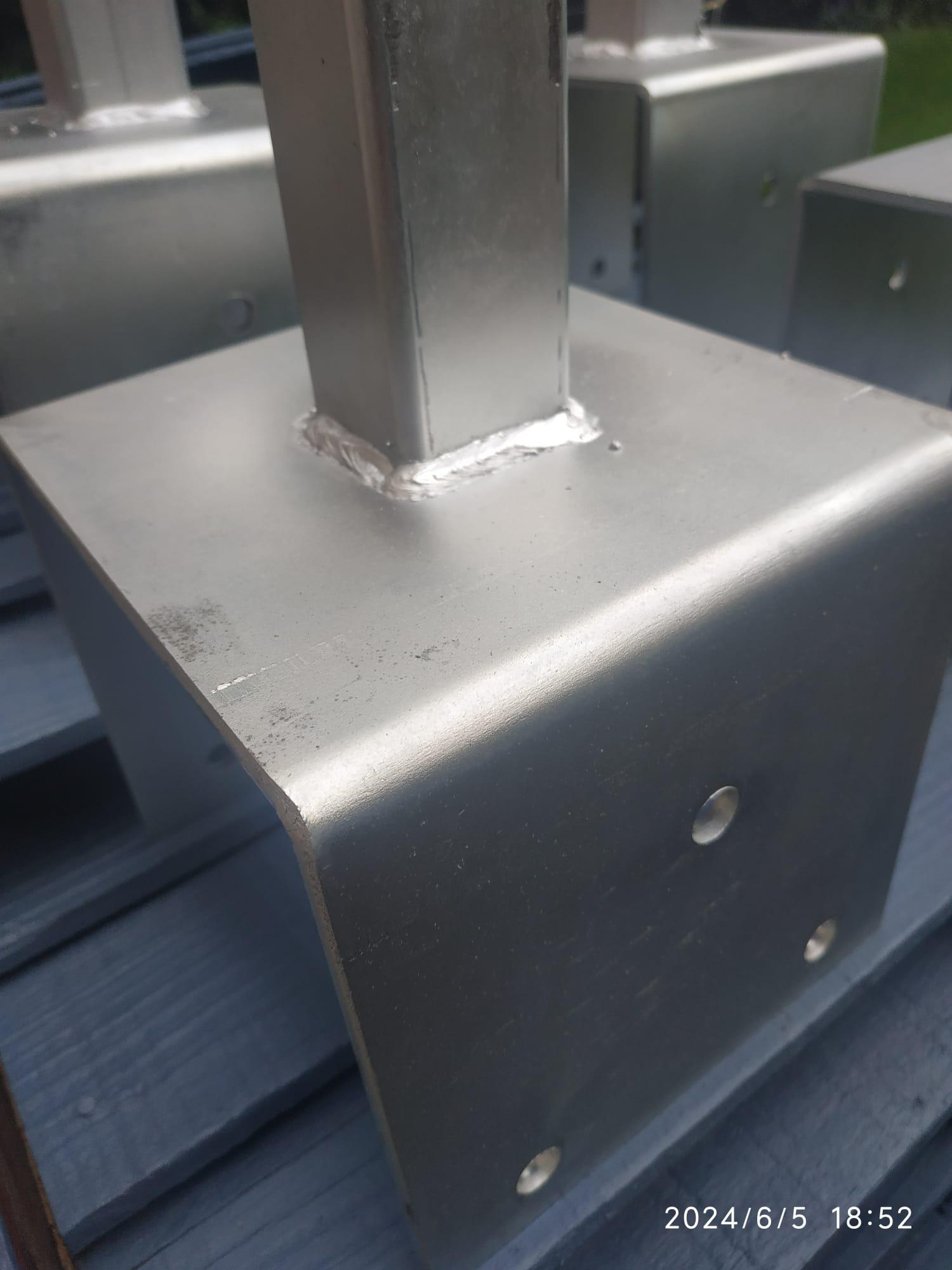

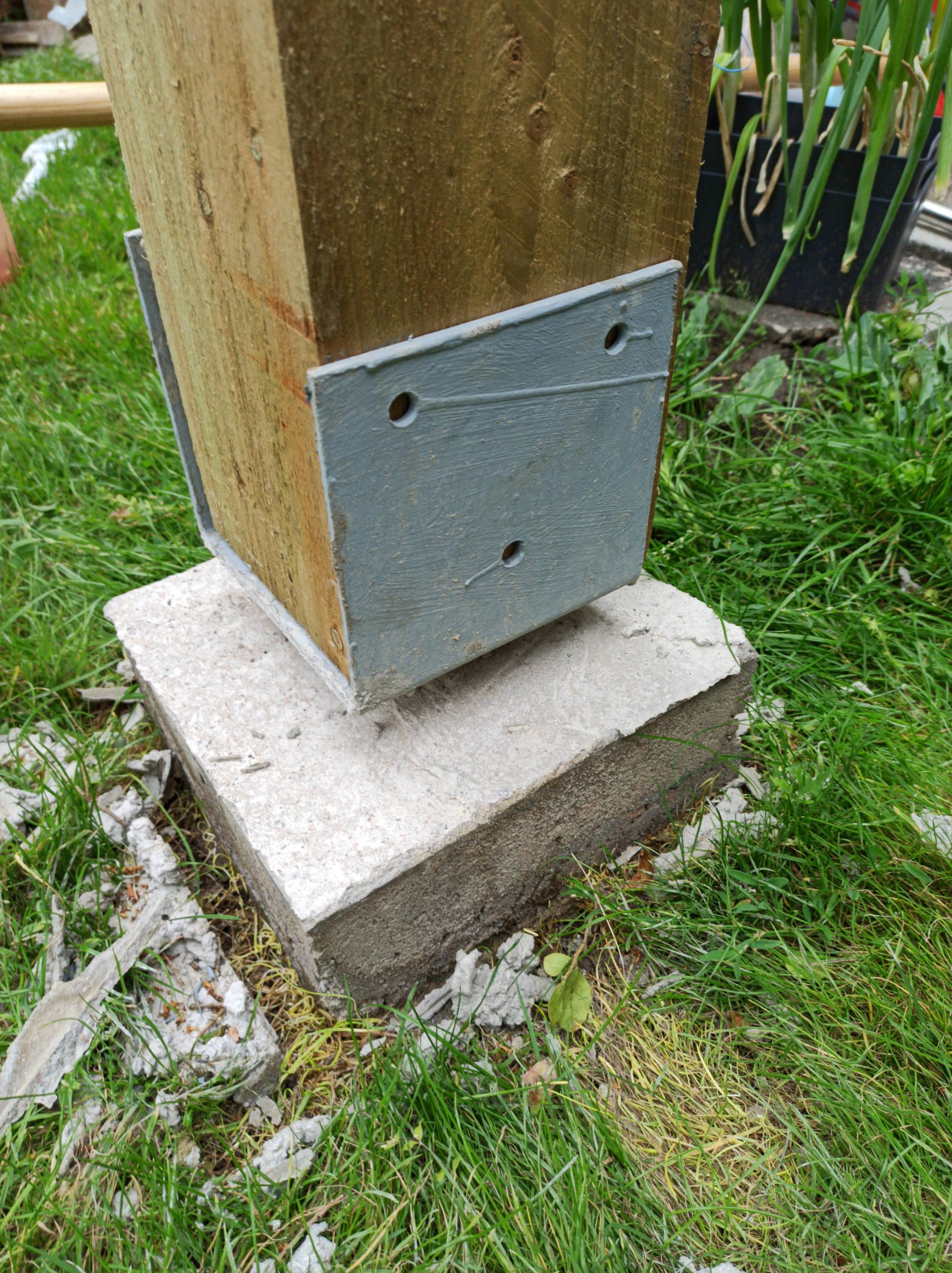

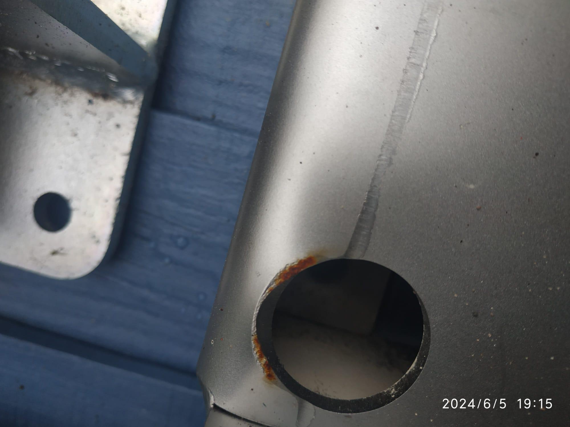

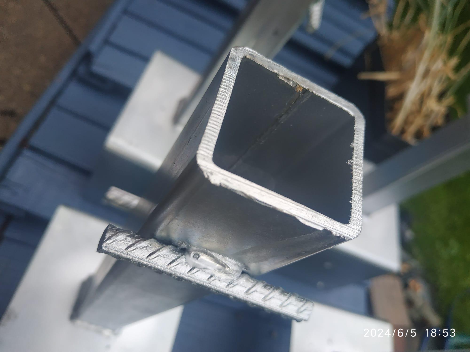

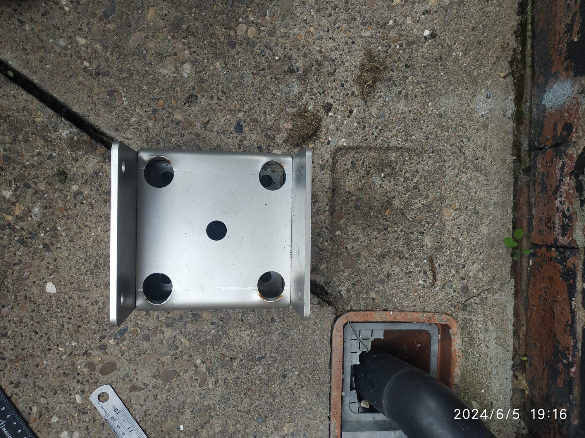

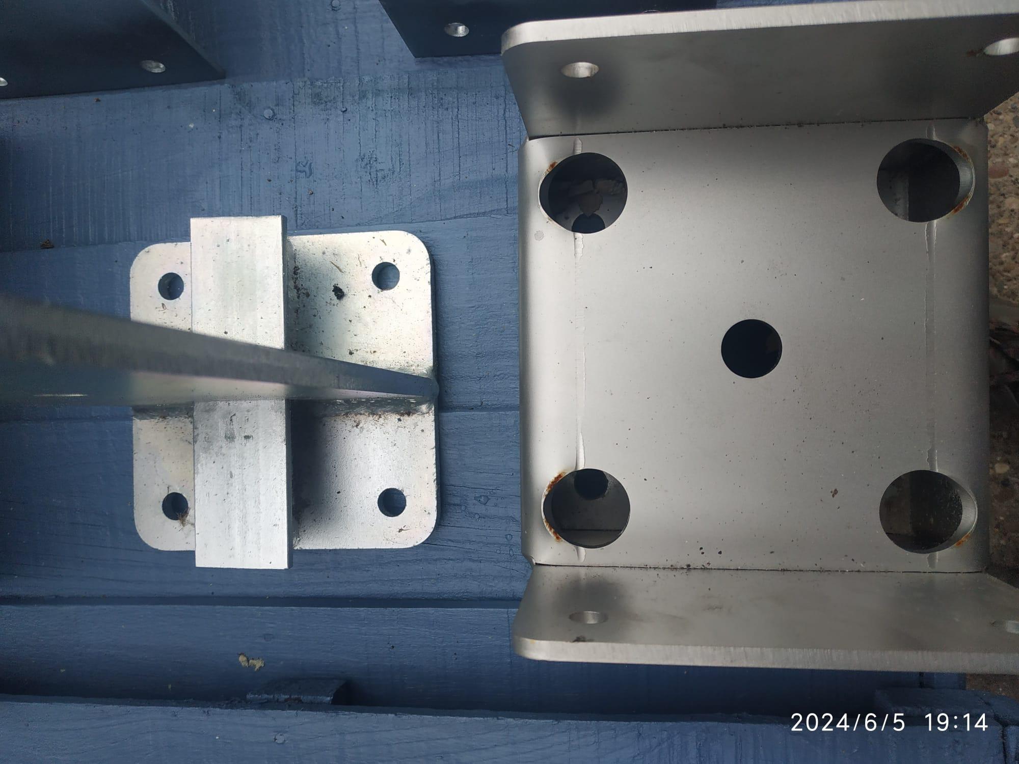

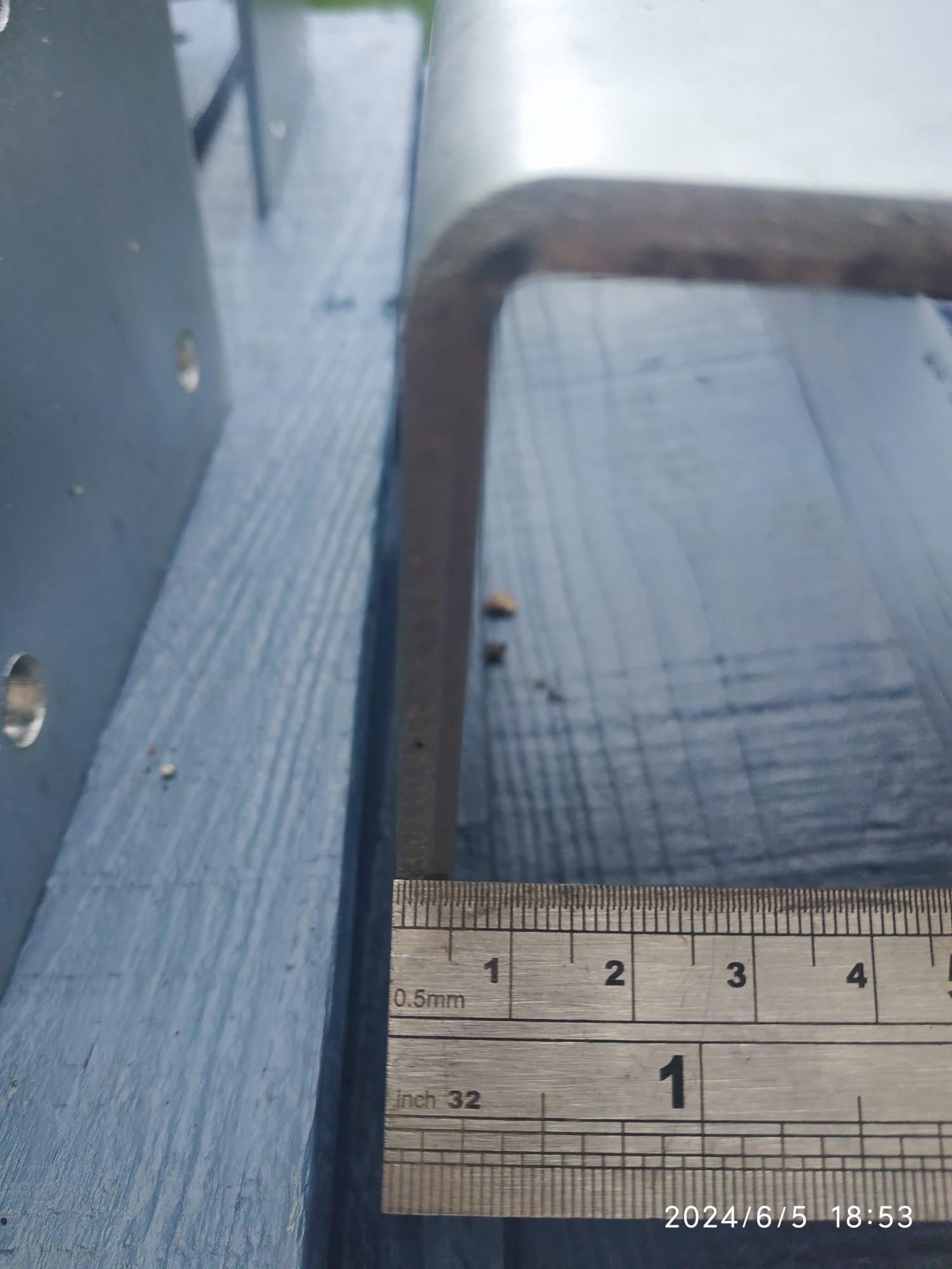

JohnBishop Posted June 5 Author Share Posted June 5 Ok, a small update. I got 4 of these new bases. Since I will have to remove the existing concrete and pouring new concrete bases I am going to do all 4 of the in the same way. What do think about these? These are 5mm galvanised on the big piece however the 40x40mm foot it looks like is only 3mm thick steel. Is this enough? The old ones after good few weeks exposure to elements. It looks like the most expensive, stainless steel one developed some rust! Now in terms of concrete bases themselves. How wide and deep these concrete bases should be? 30x30cm and 1.5 feet deep? They will go 24cm away from the wall. Unfortunately it looks like they all end up on the existing expansion gaps. Please advise Link to comment Share on other sites More sharing options...
JohnBishop Posted Tuesday at 12:43 Author Share Posted Tuesday at 12:43 Please can someone advise re bolts for this base? I have a drill block to drill holes in straight line but do you think I will be able to arrive at the right spot on the other end? Or should I just not to bother and use shorter screws? Thanks Link to comment Share on other sites More sharing options...
Mr Punter Posted Tuesday at 13:00 Share Posted Tuesday at 13:00 I would use 50mm galvanised coach screws with a galv washer. 1 Link to comment Share on other sites More sharing options...
JohnBishop Posted Tuesday at 13:24 Author Share Posted Tuesday at 13:24 13 minutes ago, Mr Punter said: I would use 50mm galvanised coach screws with a galv washer. so your saying no to bother with long ones that go across the timber. I go for the thickest M? that can fit into that hole. For the girders that are 7x2 and 6x6 posts I will use carriage bolts I reckon M12 220mm+ long. Link to comment Share on other sites More sharing options...
JohnBishop Posted Tuesday at 13:38 Author Share Posted Tuesday at 13:38 37 minutes ago, Mr Punter said: I would use 50mm galvanised coach screws with a galv washer. for coach screws do I use the same drill bit size or smaller? 1 Link to comment Share on other sites More sharing options...
Onoff Posted Tuesday at 13:45 Share Posted Tuesday at 13:45 Drill in from each side. As long as you're near enough the second hole will pick up on the first. Stick a little bubble level atop your drill if you're that worried & line the drill up left to right with a square on the floor or similar. Put studding through. Affix with a flat round washer, then spring washer then full nut. Ideally stainless. Leave/cut the studs so 3 threads projecting beyond the nut. M12 is 1.75mm pitch so 5mm is fine. Cap with a plastic nut cover. 1 Link to comment Share on other sites More sharing options...
Mr Punter Posted Tuesday at 13:46 Share Posted Tuesday at 13:46 8 minutes ago, JohnBishop said: for coach screws do I use the same drill bit size or smaller? Half the diameter. Link to comment Share on other sites More sharing options...

JohnBishop Posted Tuesday at 14:36 Author Share Posted Tuesday at 14:36 (edited) I checked and the holes in those bases are M10 so I go for M10 stainless steel rods and M10 nuts and washers. How about the support for the 7x2 girders. Do you think M12 is enough or should I go for M14? I want two threaded rods to support each girder at every point of contact which makes it 2 girders on each side of the post, 4 rods, 8 nuts in total. There won't be much weight on the roof itself just polycarbonate sheets on top of 8x 5x2 however I do fantasise about a one man/2 people swing. Do you sell these plastic caps? Can I order some from you? Actually I don't see M14, Direct Channel only sells M10,12,16,20... Edited Tuesday at 14:49 by JohnBishop Link to comment Share on other sites More sharing options...
Onoff Posted Tuesday at 15:04 Share Posted Tuesday at 15:04 (edited) M14 is like a non standard standard generally and a pita tba. Stay with M12. How many caps do you need & what colour? Edit: 8 is it? Edited Tuesday at 15:05 by Onoff Link to comment Share on other sites More sharing options...
