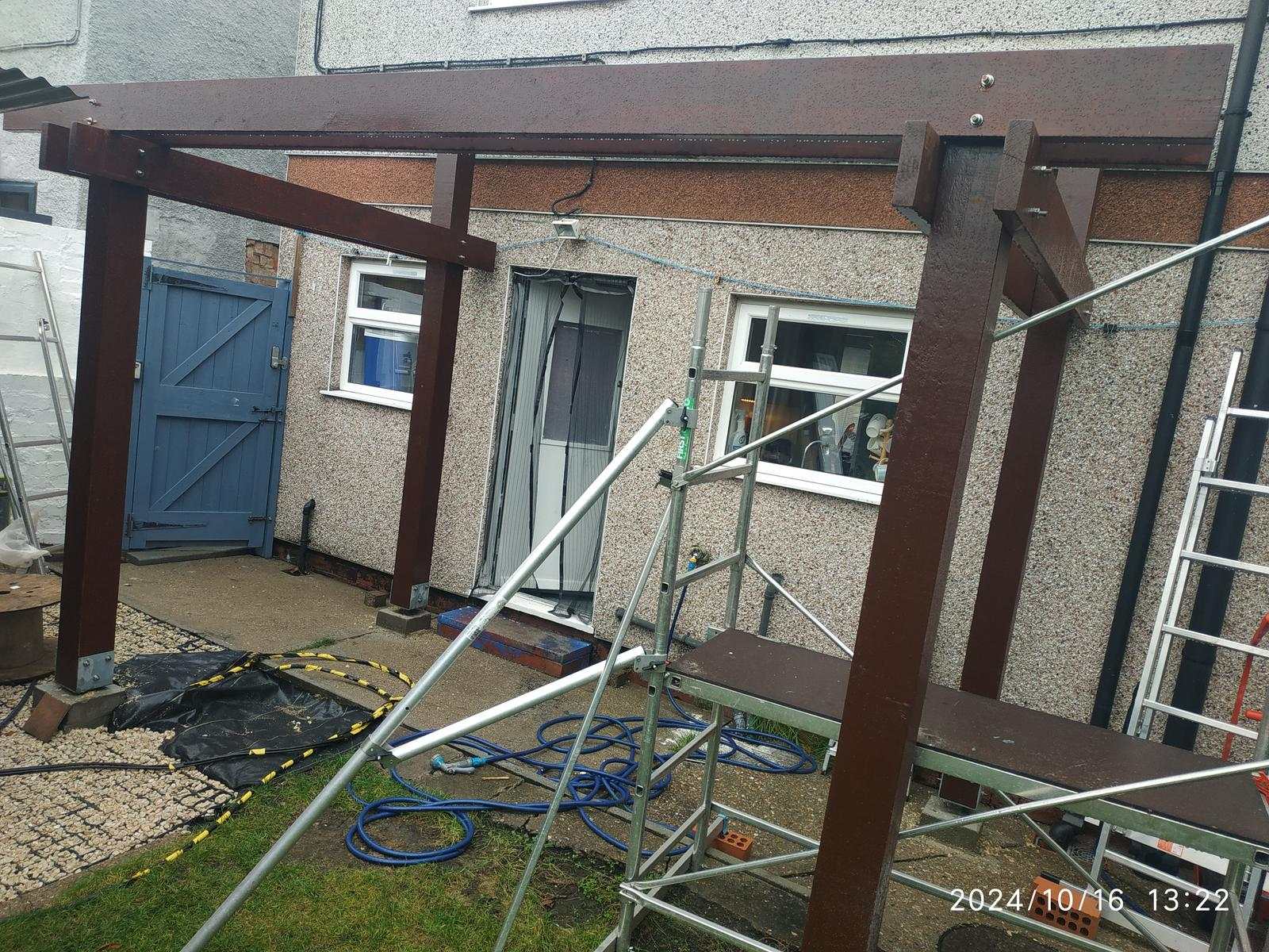

JohnBishop Posted October 14, 2024 Author Posted October 14, 2024 3 minutes ago, markc said: Pulling a post into square before fixings will help it to stay put, but without bracing a “table” structure will sway and pulling one leg into plumb generally results is it pulling another leg half way so the stresses balance. how is this bracing achieved in such circumstances? I reckon I need an anchor of some sort.
markc Posted October 14, 2024 Posted October 14, 2024 5 hours ago, JohnBishop said: how is this bracing achieved in such circumstances? I reckon I need an anchor of some sort. Hi, do you have any pics of the structure, loads of ways of adding bracing to prevent racking of a table. If one edge of the roof is fixed to a wall you can add diagonal braces in the roof - timber, metal or tensioned wires to hold the other edge rigid at the top. Side braces or if you are wanting to keep the structure clutter free then you are looking at holding it be the joints between posts and top members. Loads of options and no real right or wrong.

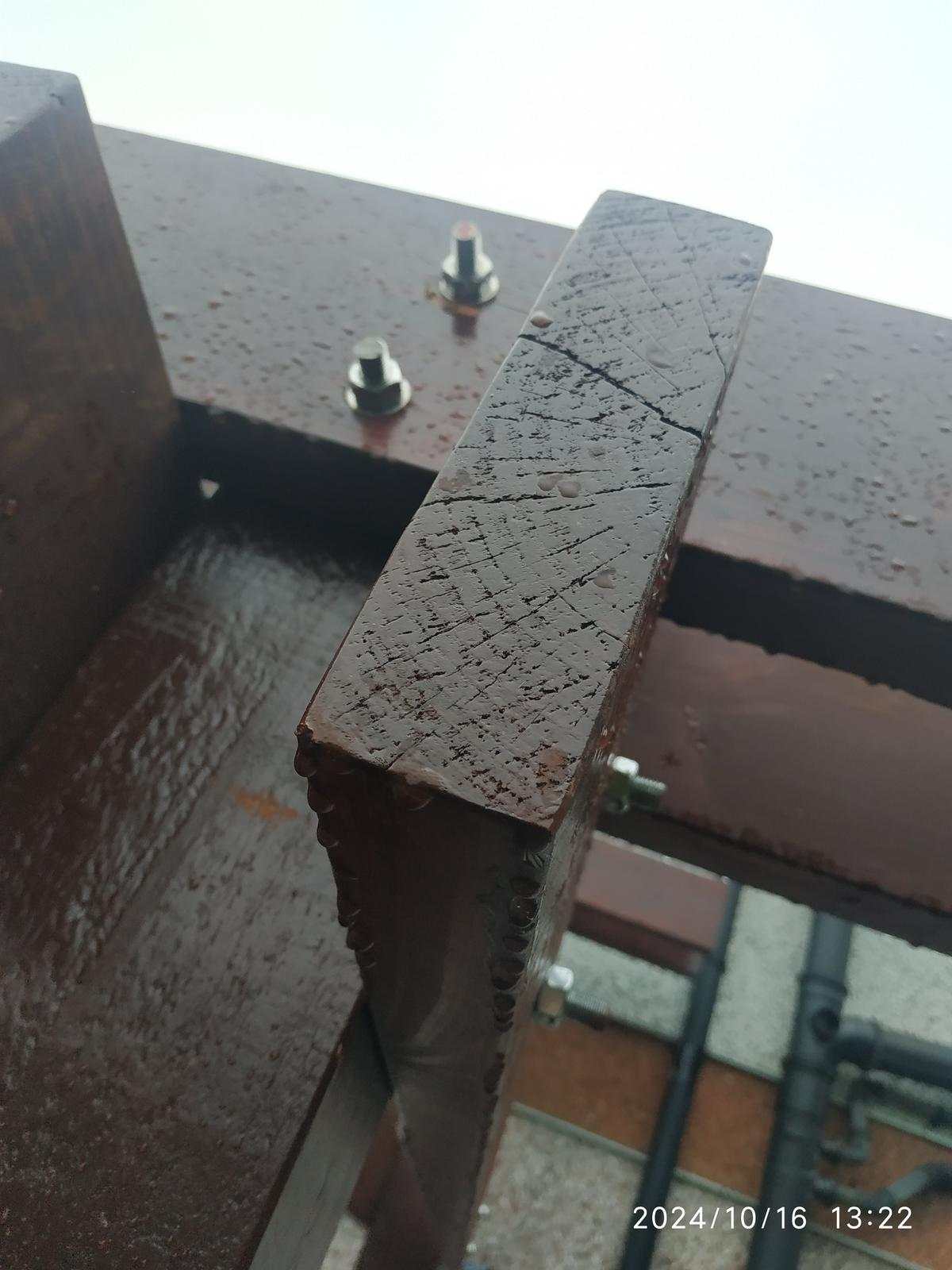

JohnBishop Posted October 16, 2024 Author Posted October 16, 2024 On 14/10/2024 at 15:42, markc said: Hi, do you have any pics of the structure, loads of ways of adding bracing to prevent racking of a table. If one edge of the roof is fixed to a wall you can add diagonal braces in the roof - timber, metal or tensioned wires to hold the other edge rigid at the top. Side braces or if you are wanting to keep the structure clutter free then you are looking at holding it be the joints between posts and top members. Loads of options and no real right or wrong. I already screwed everything together. I could not wait before the beautiful weather today I send some pictures later today. On the bases I used M10 everywhere else M12 1
Onoff Posted October 16, 2024 Posted October 16, 2024 Look at the photos throughout this thread. "Bracing" is generally achieved by the little diagonals at the top. Either let in to the horizontal / vertical members with a joint detail (mortice & tenon, through housing etc) and / or screwed / bolted through. I'd use dog tooth washers btw if "clamping" braces on.

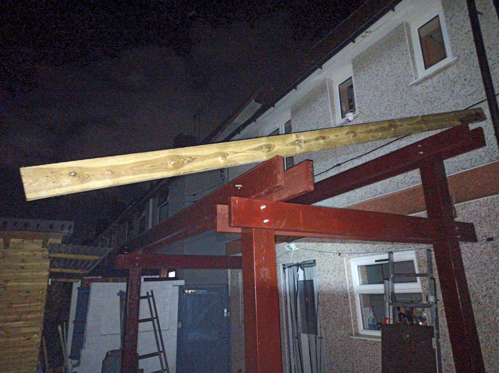

JohnBishop Posted October 16, 2024 Author Posted October 16, 2024 Please have a look. This is what I built so far. This is very strong. I mean I could put up a roof and then think about bracing as this is quite strong. I don't put tiles but polycarbonate sheets. 1
JohnBishop Posted October 16, 2024 Author Posted October 16, 2024 I think the only problem I can see so far is those wires going exactly where the rafters will end. I think I have to move them or something or carve out the wood.

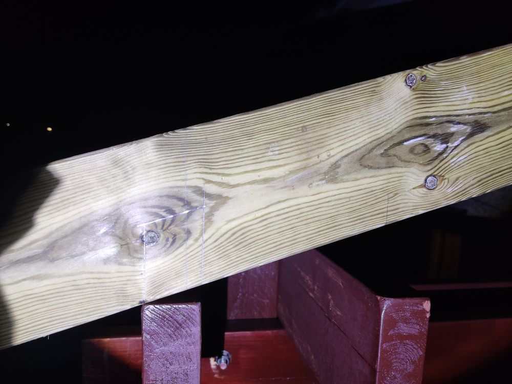

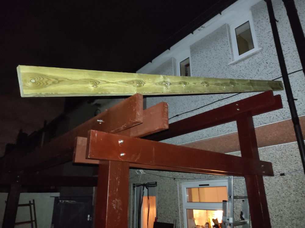

JohnBishop Posted October 22, 2024 Author Posted October 22, 2024 I think the spacing between rafters will be 60cm. This EZ Glaze looks cool but it's quite expensive unless I can find something similar but cheaper. How far should the overhang reach do you think? Half-way? Of course on the right side I want to cut it parallel to the wall. Do you think on the left side should I cut it square? I think on both ends I should incise these weeping groves right so the timer lasts longer, no?
JohnBishop Posted October 23, 2024 Author Posted October 23, 2024 I wanted the timber to rest on the 2nd one but it looks like the cut is going to be too deep, isn't it? What would you recommend doing? Should I introduce a wedge to bridge the gap?

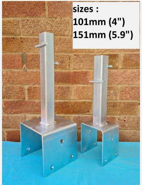

JohnBishop Posted June 18 Author Posted June 18 (edited) I have completed my patio project, now I proceed with pergola. This structure has to be stronger than the patio because I want to put 4 large solar panels on top. Same 6x6 posts but the question is about bases. Like we did this comparison previously: https://forum.buildhub.org.uk/topic/36582-patio-roof/#findComment-556352 I like these bases you can submerge into the concrete however this 5mm thickness does not give me confidence. I am confident with the timber, 6x6 posts and other bits like 2x7, rafters 2x8 to carry the load. Have you come across something similar but thicker e.g. 6-8mm thick steel? Edited June 18 by JohnBishop

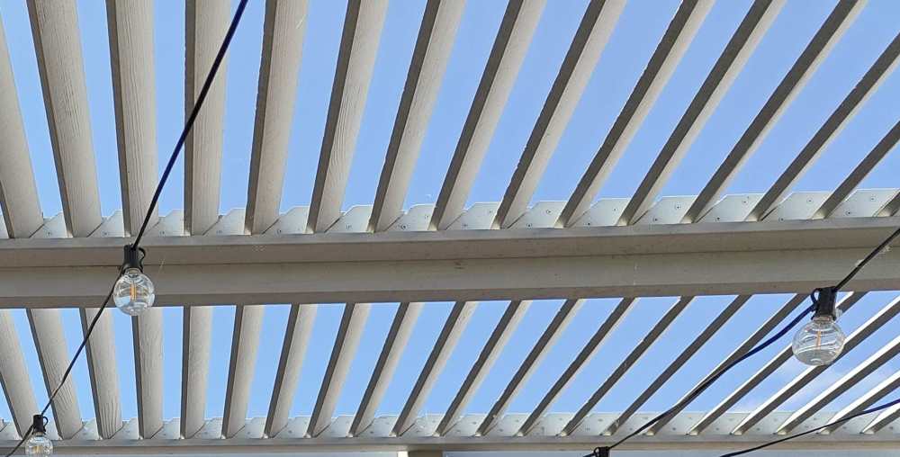

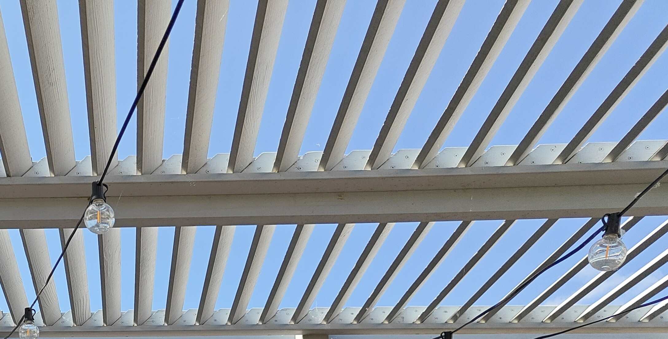

JohnMo Posted June 18 Posted June 18 12 minutes ago, JohnBishop said: What is the weight of those 2 panels The datasheet says 26kg each, but they are also 150mm shorter than the datasheet, so suspect near to 25kg each. Have used bifacial so they are black both sides. Will be using a Ecoflow Stream Ultra battery inverter, each 500W panel goes back to the battery and you can hook up 4 panels individually via 4x MPPT in the unit. Comes with a 2kWh battery also. 17 minutes ago, JohnBishop said: Did you wrap your roof with bitumen felt? Apart from panels the rest will be open with timber strips angled at 45 degs every 50 to 75mm (yet to be determined), a bit like this 1
JohnBishop Posted June 25 Author Posted June 25 So do you guys think these 5mm thick steel post bases 150mm are sufficient for a pergola + 4 solar panels (approx. 100kg)? https://www.ebay.co.uk/itm/324527521877 This is what I used on my patio but pergola is going to be a bit heavier due to the fact I put a roof (laminate boards and panels),
JohnBishop Posted Monday at 20:18 Author Posted Monday at 20:18 I went for the above post bases. On the patio I used 4x2 rafters. Will 5x2 rafters be enough for the pergola to support the 4 panels? I like the way you achieve some shade. I was going to felt it but now I don't know if this is going to be too much shade?
