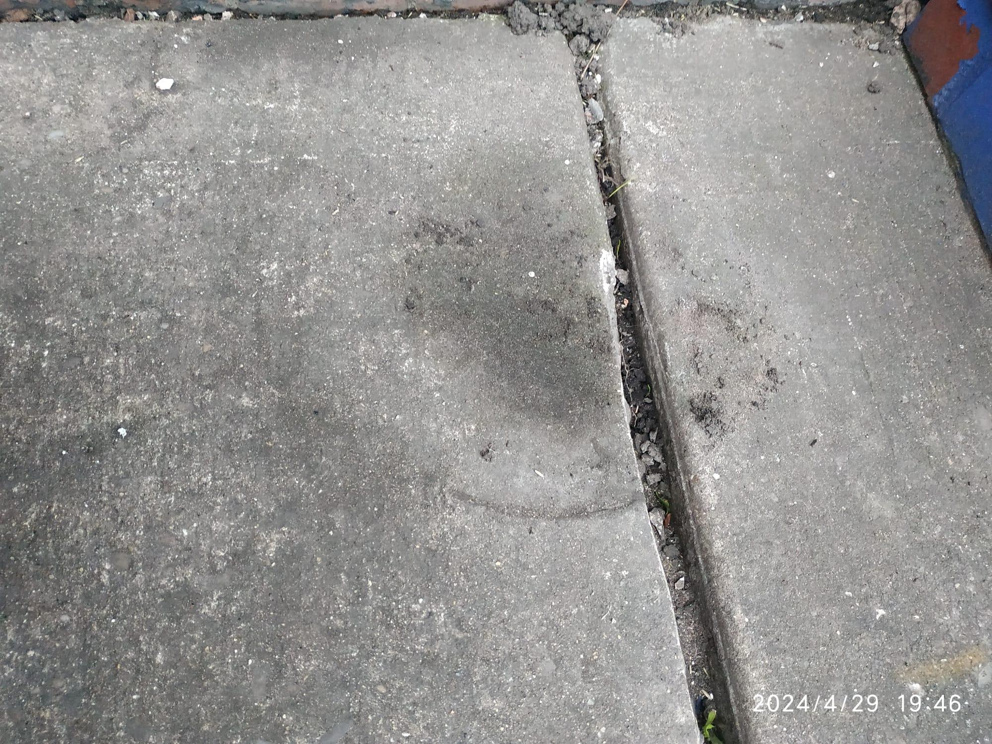

JohnBishop Posted April 29, 2024 Author Posted April 29, 2024 (edited) This is the concrete. Not sure how thick it is. I reckon 3 inches? Edited April 29, 2024 by JohnBishop
JohnBishop Posted May 1, 2024 Author Posted May 1, 2024 I dug into the concrete expansion gap and in two places I was not able to hit the soil but it looks like more concrete. The gap is between 3-4 inches deep but how thick is the concrete below the gap I don't know? I cannot check around it as there is kerb all around it.

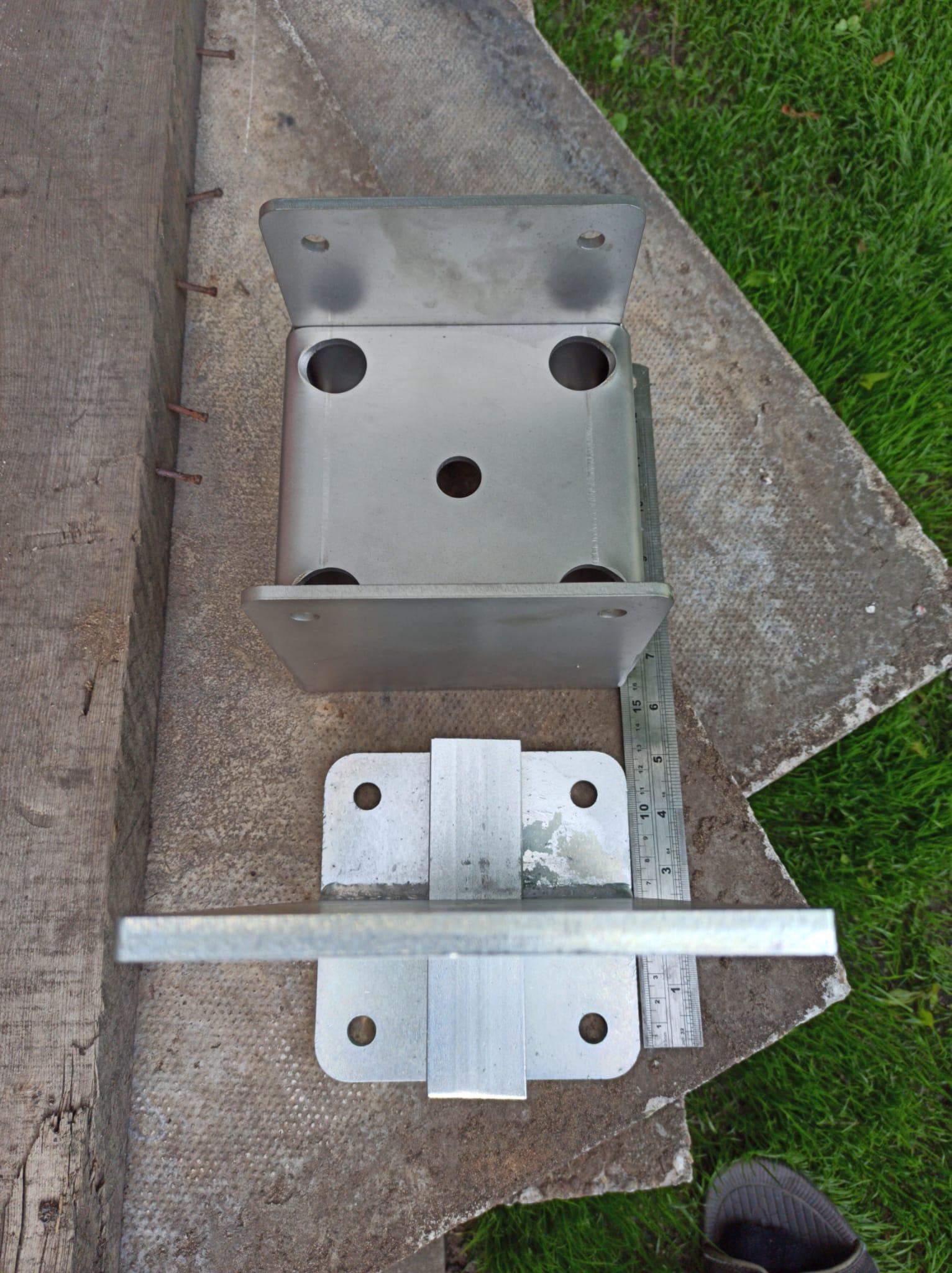

Onoff Posted May 2, 2024 Posted May 2, 2024 Only you can decide on this at the end of the day but let just propose you use these at the back where the existing slab is. https://www.ebay.co.uk/itm/175719585849 It has x4 14mm fixing holes in the base. That dictates you'll use 12mm studs, (stainless of course). You reckon the slab is 3 to 4" deep. Look at the table, page 3 of the Rawlplug PDF as a rough guide for minimum substrate thickness, embedded depth etc. This one takes 10mm fixing bolts: https://www.amazon.co.uk/Heavy-Galvanised-Concealed-Support-Bracket/dp/B08FQV9XYW? Tbh unless you pay a structural engineer to calculate all this it's best guess / a chance you take. 1
JohnBishop Posted May 7, 2024 Author Posted May 7, 2024 (edited) I ordered each of these to see by myself. I have to double check the thickness because for M12 - 3 inches thickness is minimum. I just need to get myself a SDS drill to make a probe hole. I talked to a lad who worked in the pit and he said that many years ago they used resin to make permanent anchors. Thank you again. Edited May 7, 2024 by JohnBishop

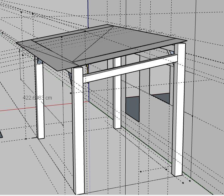

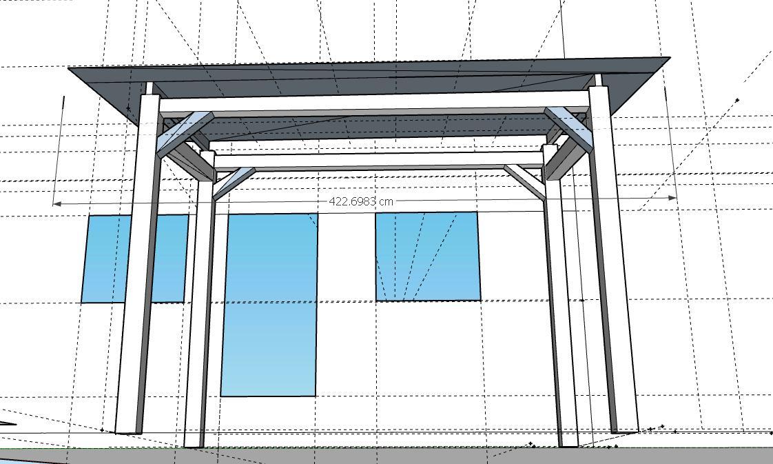

JohnBishop Posted May 10, 2024 Author Posted May 10, 2024 (edited) This is how it's going to look. Of course the roof itself is going to sit on a number of 2x4 Not sure if the short crossbeams should be at an angle like on the picture or horizontal? Edited May 10, 2024 by JohnBishop

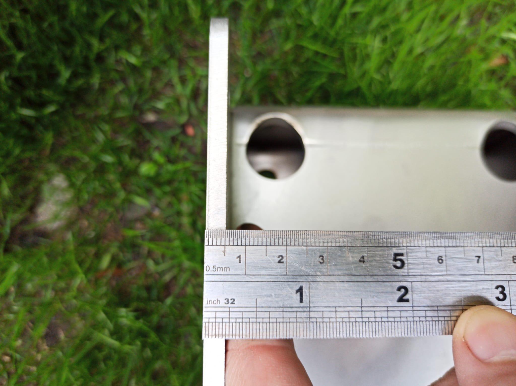

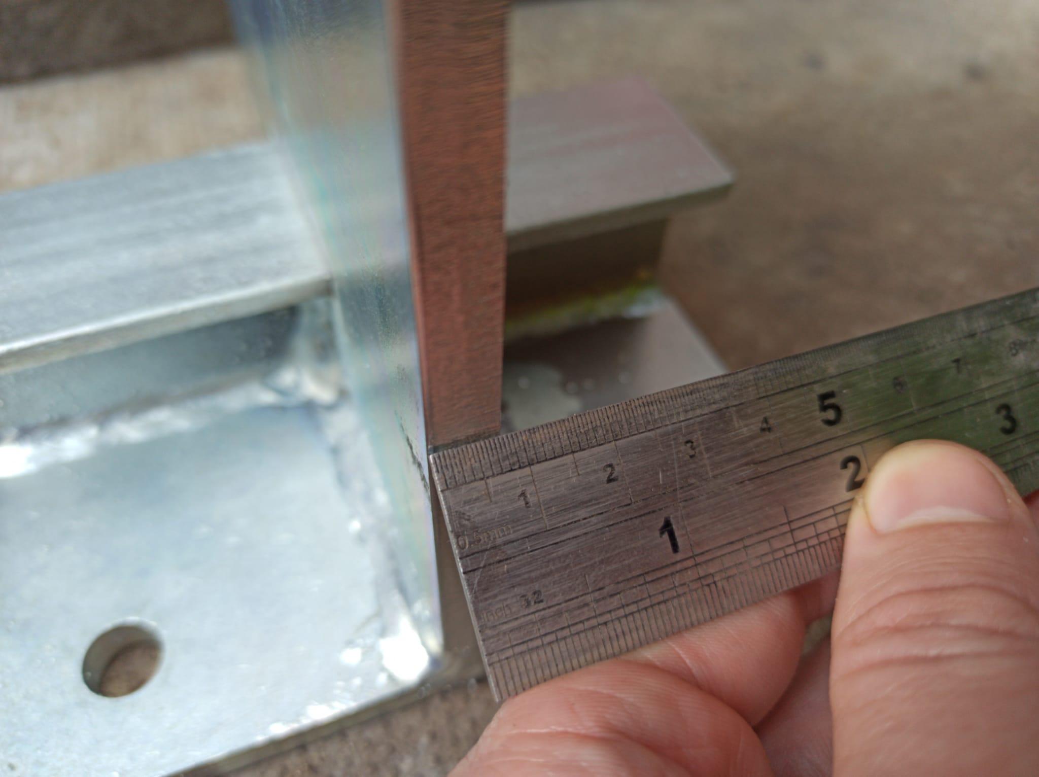

JohnBishop Posted May 10, 2024 Author Posted May 10, 2024 (edited) I also got these two bases I have to choose from. The nice looking one is stainless steel but 5mm for £43.50 The ugly looking one is galvanised steel but 8mm for £36.50 I like the ugly one only because it would allow for the post to be a bit off the ground. The stainless steel one has a much wider span between the holes what would suit me a bit better Edited May 10, 2024 by JohnBishop
JohnBishop Posted May 10, 2024 Author Posted May 10, 2024 2 hours ago, Onoff said: Get a local fabricator to make exactly what you want? I use both, the stainless steel will go central over the expansion gap, the other one will go to the other side. The remaining 2 will be the ones that submerge to the concrete.
