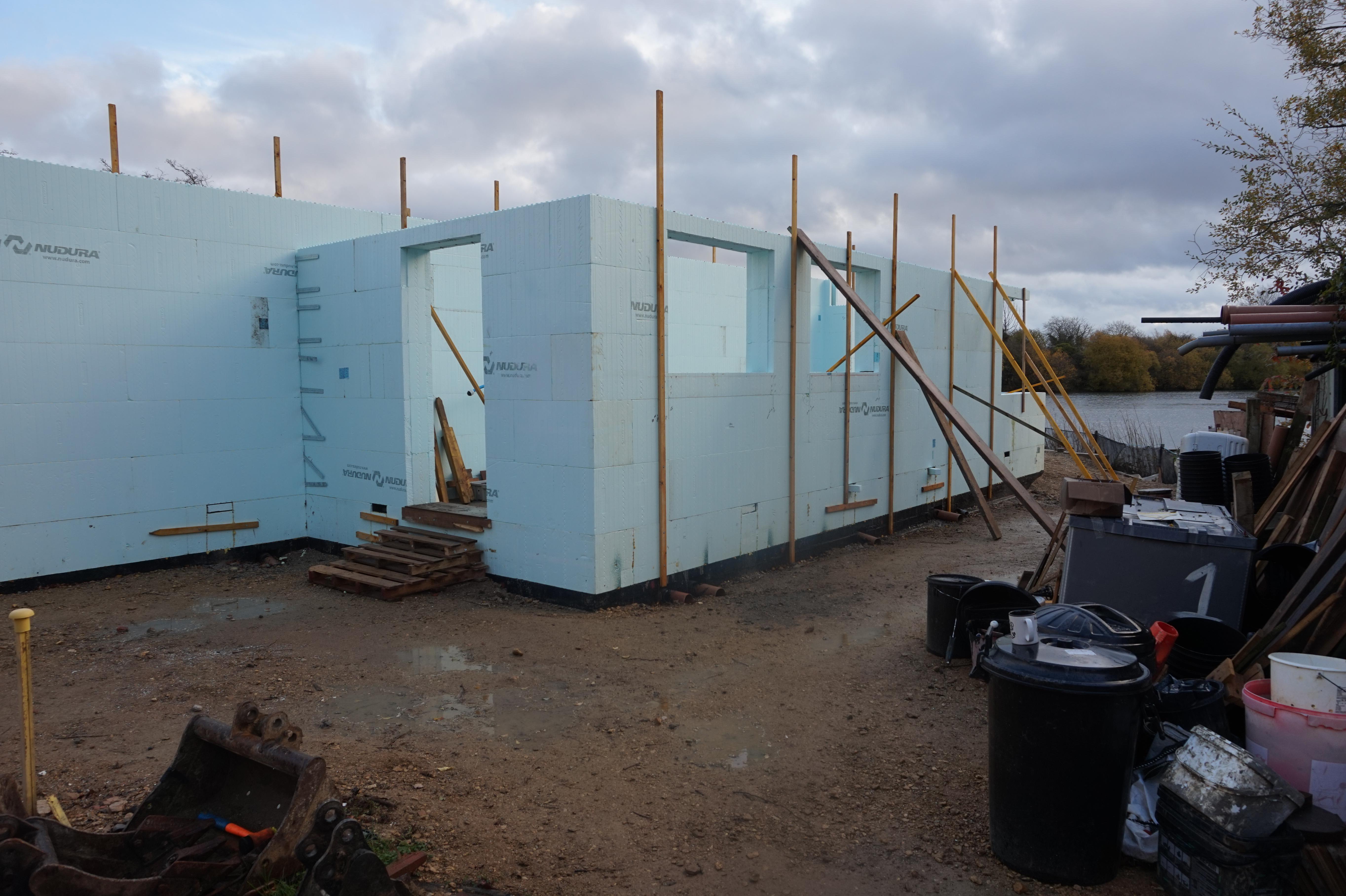

We have been progressing well with the Nudura but this wind is causing havoc.
We haven't got scaffold or alignment system yet as we weren't that high but getting blocks up to the near joist level and the wind is just blowing it over or off the DPC block.
Would the scaffold/alignment really combat the wind?
Any tips? I thought about bracing it vertically to the concrete filled DPC level to strengthen it

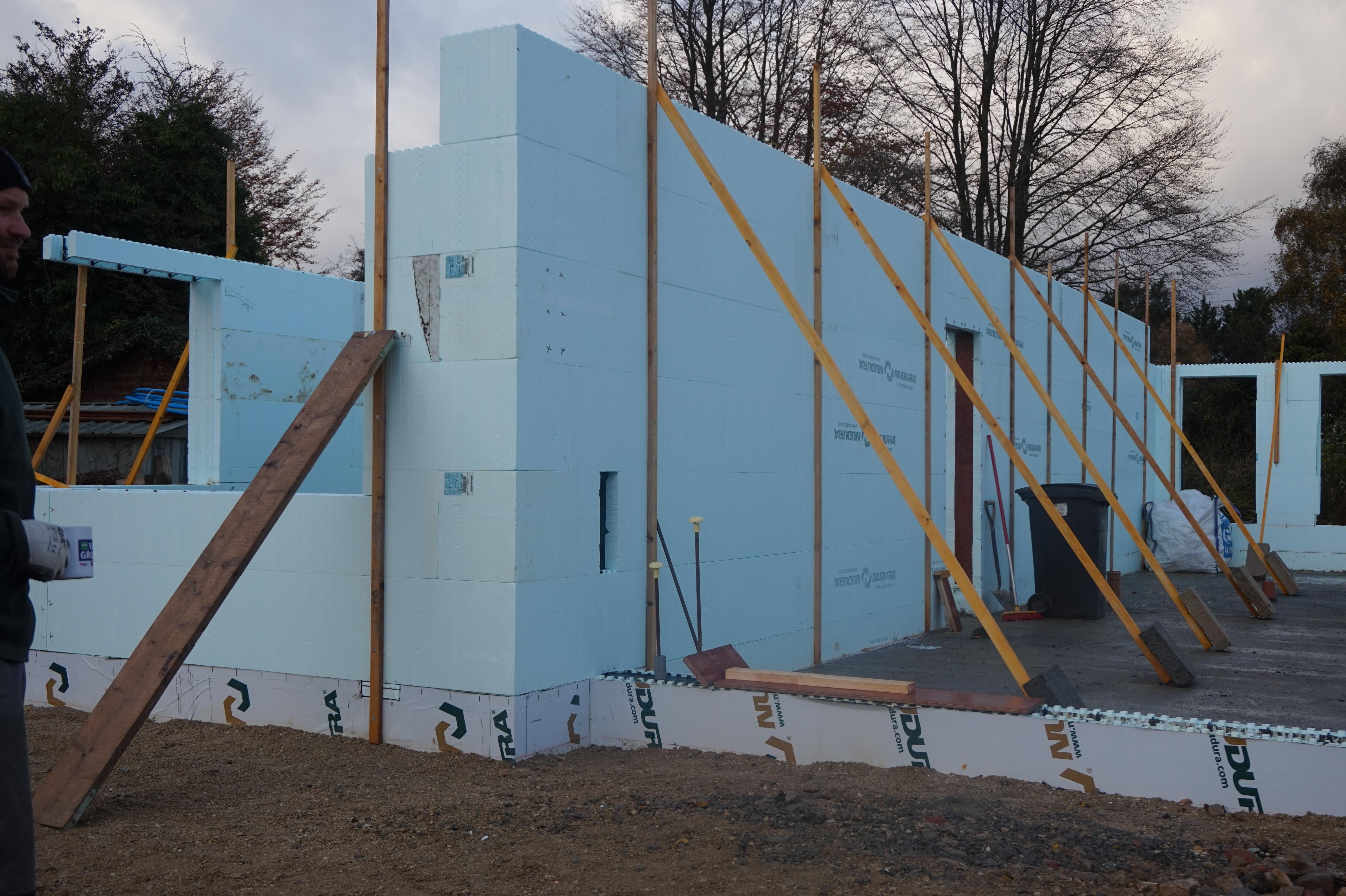

I didn’t get the braces on site until I had the whole structure up to 2.7m we had some bad wind and only lost a block or two.
Start at the corners and leave some gaps out in the middle to let the wind through.
You will need loads of scaffolding boards for when the braces come, I don’t think many bracing systems hire out with boards, so you might as well get 20 boards now and a bundle of batten and get it propped, ready for the bracing system. 4000F5EA-E500-4E29-98DE-9A4E79C16E7F.thumb.jpeg.4d991c196e7ef5e81bd174ca915a34c5.jpeg35FD215E-B50E-4F19-B701-C6726C303E5E.thumb.jpeg.0857b3c881e96db12e30c94da3bc9c4a.jpeg35FD215E-B50E-4F19-B701-C6726C303E5E.thumb.jpeg.0857b3c881e96db12e30c94da3bc9c4a.jpeg

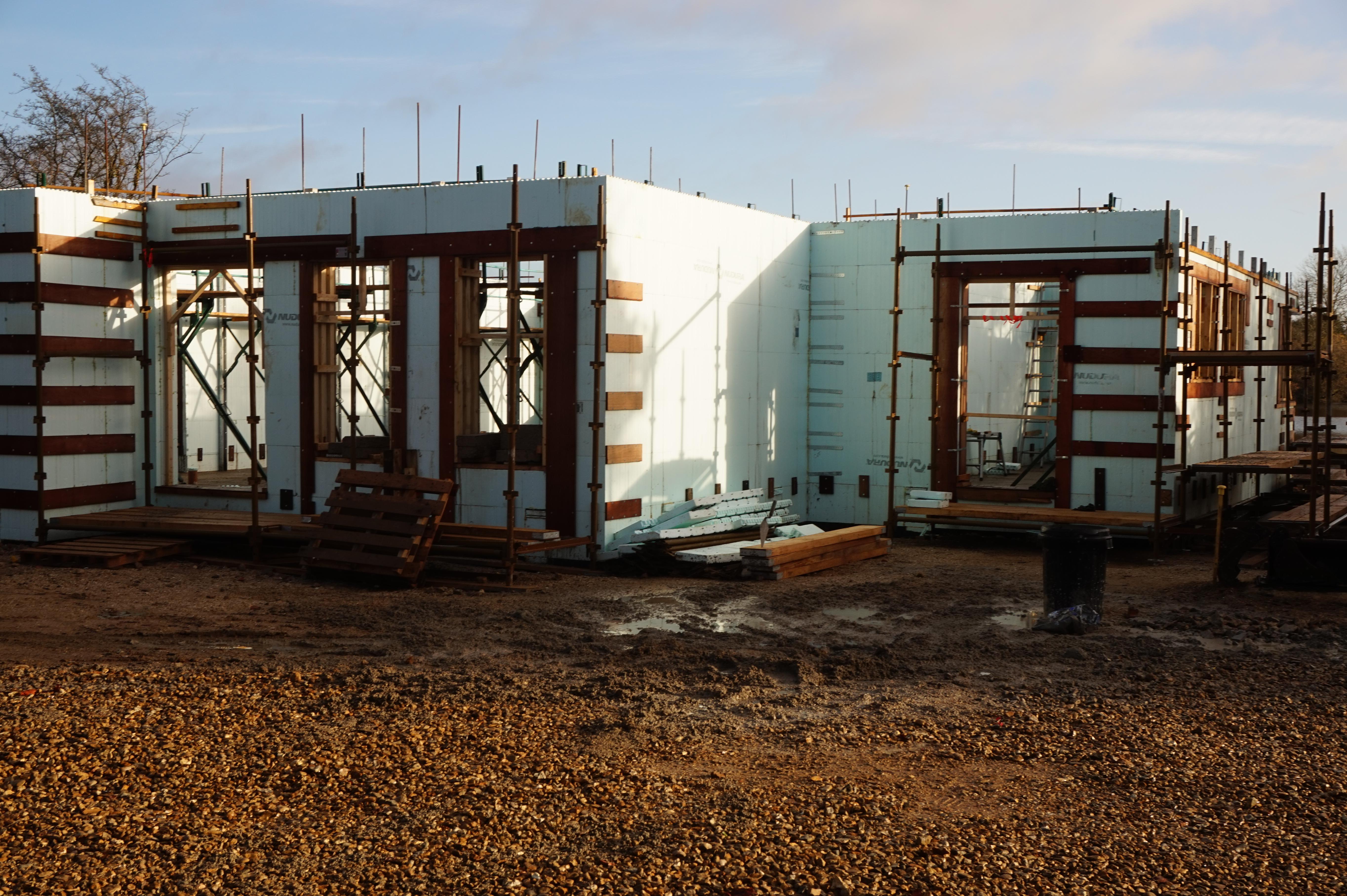

Our ICF build (Durisol) I did 6 blocks high and then concrete filled.
Brace as you go either with timber or alignment system.  Broken blocks might only reveal any damage when you come to pour.  Bridge between your rising walls and your ground floor.  Fix down as well as laterally. Close off your cavities rather than cutting holes in corners.

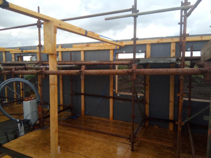

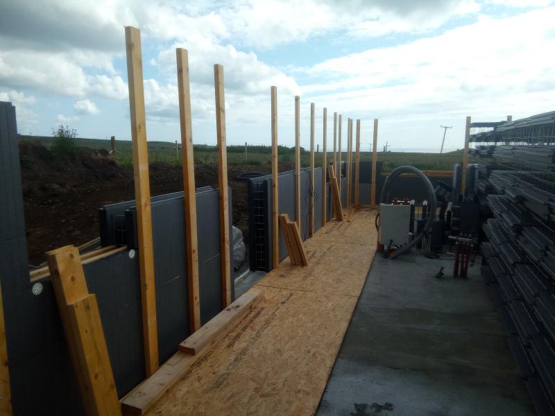

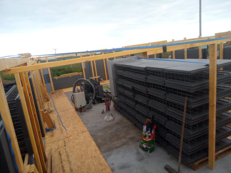

I built ICF (Poly Steel), in the Highlands, and wind needed thinking about from the start. We had to strap our block pallets to each other to stop them blowing away.
I used scaffolding on the inside, and timber bracing as I went. IMG_20231224_131053.jpg.7a7c28fd6dfff1a7c902a1925532b9ab.jpgIMG_20231224_131039.jpg.c749356da65047c287de61f6e1b5178c.jpgIMG_20231224_131142.jpg.ca398433b876cac9e300fda539c70200.jpg

The wind defences are going in! Been longing to do this all week.
Thanks all for your help
