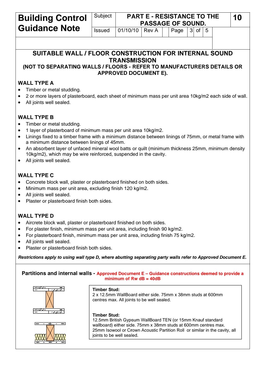

andreas Posted December 19, 2023 Share Posted December 19, 2023 (edited) I have been told that as I am pulling up all flooring, I have to add insulation. I know that running a cable through insulation means that you have to derate it. I have done the maths on all the lighting circuits, even derating the cables 50%, and assuming a worst case scenario of max lamp wattage per fitting possible with worst power factor, the lighting circuit has a massive safety margin, max current would be half the derated capacity. What I don't understand is the power circuit - how do you work that out? In theory in pretty much every house I've been in, it's possible to overload the *cable's* current capacity if you were stupid enough to plug a 2kw heater into every outlet. I don't want to have to replace all the perfectly good power circuits that are in place just because I want to take the floor up and have to add insulation as a result. Best way to work around it? Edited December 19, 2023 by andreas Link to comment Share on other sites More sharing options...

JohnMo Posted December 19, 2023 Share Posted December 19, 2023 When you insulate between floors you don't full fill, you part fill with maybe 50mm of insulation. It's there to the drum effect. Who is saying you have to add accoustic insulation? Link to comment Share on other sites More sharing options...
andreas Posted December 19, 2023 Author Share Posted December 19, 2023 1 minute ago, JohnMo said: When you insulate between floors you don't full fill, you part fill with maybe 50mm of insulation. It's there to the drum effect. Who is saying you have to add accoustic insulation? BC said "more" insulation between floors needed, though waiting for clarification on how much, and it needs full insulation below ground floor. BC isn't that helpful. Ground floor cabling was all obviously done on a budget that involved saving every possible mm of cable so they'd be too short to reroute. I am just trying to understand better how they calculate power circuits now with all the insulation required everywhere. Link to comment Share on other sites More sharing options...

saveasteading Posted December 19, 2023 Share Posted December 19, 2023 3 hours ago, andreas said: 3 hours ago, JohnMo said: When you insulate between floors you don't full fill, you part fill with maybe 50mm of insulation. It's there to the drum effect. Who is saying you have to add accoustic insulation? Expand BC said "more" insulation between floors needed I didn't know this! It seems that the easy options are 1. Single layer plasterboard ceiling and 100mm mineral wool on it. 2. Double layer plasterboard no insulation. Floor chipboard has to be a certain density, as does the pb. Link to comment Share on other sites More sharing options...
Mr Punter Posted December 19, 2023 Share Posted December 19, 2023 I don't think this is one to lose sleep over. As long as the cables are not buried in the middle of insulation you are unlikely to have an issue with them overheating. They can be better (cooler) clipped to joists. Unless BC have requested derating it or you have used cable smaller than 2.5mm2 I would just ignore this. There is no requirement to fit thermal insulation other than on the bottom floor and none to fit acoustic insulation in an existing house. Link to comment Share on other sites More sharing options...
saveasteading Posted December 19, 2023 Share Posted December 19, 2023 8 minutes ago, Mr Punter said: I don't think this is one to lose sleep over. As long as the cables are not buried in the middle of insulation you are unlikely to have an issue with them overheating. They can be better (cooler) clipped to joists. Unless BC have requested derating it or you have used cable smaller than 2.5mm2 I would just ignore this. There is no requirement to fit thermal insulation other than on the bottom floor and none to fit acoustic insulation in an existing house I thought that until this discussion. Link to comment Share on other sites More sharing options...
Mr Punter Posted December 19, 2023 Share Posted December 19, 2023 6 minutes ago, saveasteading said: I thought that until this discussion. I understood that part E only applies to new build, change of use and conversions. I think that @andreas is working on an existing house. 1 Link to comment Share on other sites More sharing options...

saveasteading Posted December 20, 2023 Share Posted December 20, 2023 17 hours ago, Mr Punter said: E only applies to new build, change of use and conversions. That seems to be right. Link to comment Share on other sites More sharing options...
