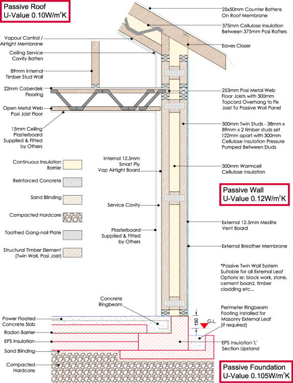

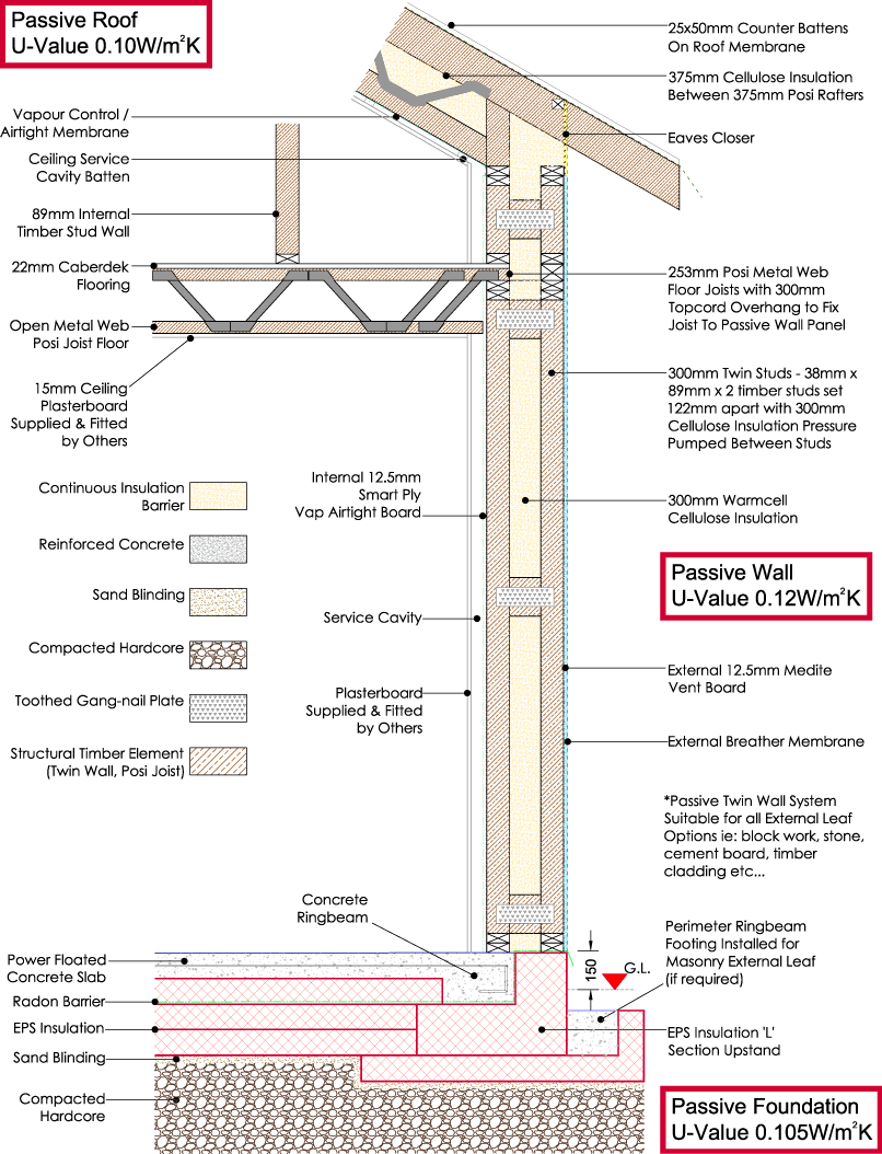

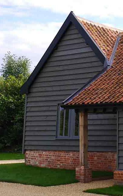

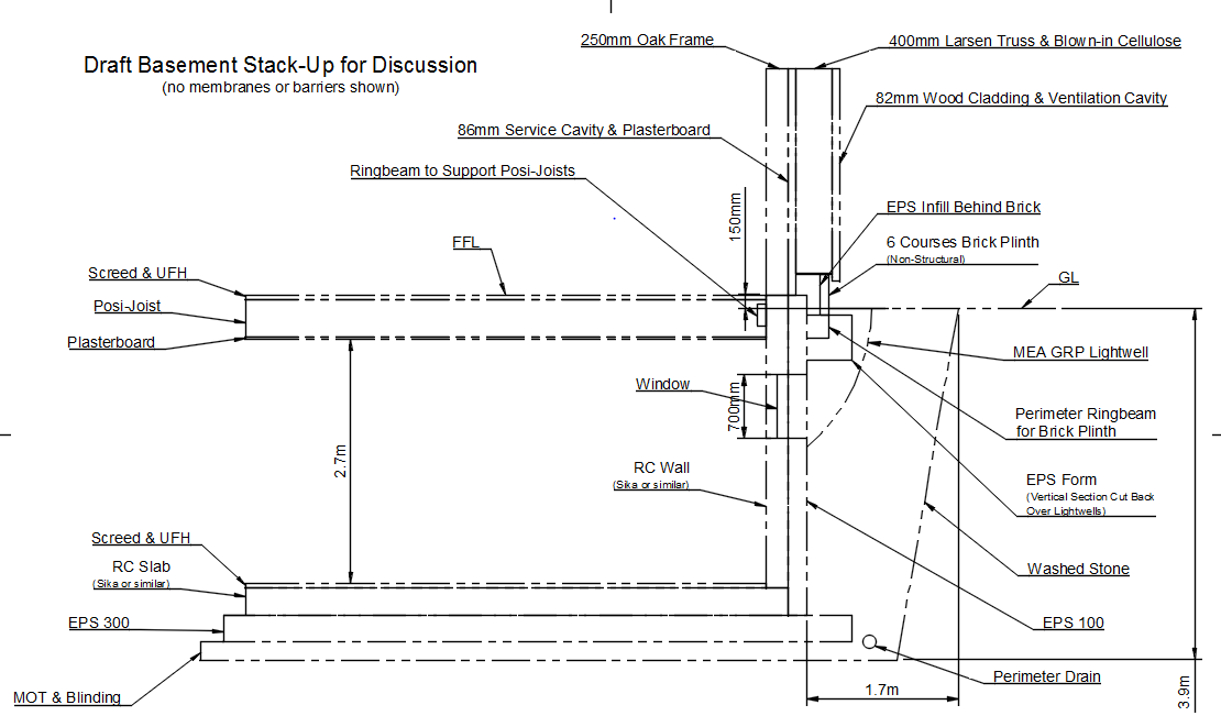

Alan Ambrose Posted December 12, 2023 Share Posted December 12, 2023 Hi, I'm looking at my basement detail - particularly the part where the basement wall joins the house walls. I'd like to have both a traditional brick plinth (e.g. 1st image) and some lightwells into the basement - although the detailing to accomplish both looks a little troubling (3rd image below). I can see that if I lost one or the other (so that the support for the plinth didn't obscure the lightwells) life would be easy . I've based my current thinking (3rd image) re the support for the brick plinth largely on this MBC detailing (2nd image) - where they cast a fairly non-structural ringbeam to support the brick plinth into some EPS channel which is itself laid on MOT. I will have an SE design the RC basement and an oak frame co design/make/erect the frame - but I may need to do my own thing on the insulation and cladding and also the interface between the topsides and the basement. Anyone have any thoughts? Ta, Alan Link to comment Share on other sites More sharing options...

Russell griffiths Posted December 14, 2023 Share Posted December 14, 2023 @Alan Ambrose ive only looked at this for 30 seconds but something doesn’t look correct on drawing 3. What part of the structure is actually load bearing, as you have the Larson truss sitting on the non structural plinth wall, if the Larson truss is structural then doesn’t that have to go down to the basement wall, or floor slab, so is the oak just for show ? a large oak frame was put up by my neighbour recently and his kit came clad in sips panels, oak was the structural element and the panels did the insulation side of things. I was very impressed with the fit and finish, it was a high end build. It looks ok to me that you have two houses there one inside the other. Is the oak the structure or is it the larson and the oak is for show. Link to comment Share on other sites More sharing options...
saveasteading Posted December 14, 2023 Share Posted December 14, 2023 18 minutes ago, Russell griffiths said: @Alan Ambrose ive only looked at this for 30 seconds but something doesn’t look correct on drawing 3. What part of the structure is actually load bearing Likewise. It didn't make sense to me, so I assumed this was more a specification/ guidance than showing real life detailing. 1 Link to comment Share on other sites More sharing options...
Alan Ambrose Posted December 14, 2023 Author Share Posted December 14, 2023 >>> as you have the Larson truss sitting on the non structural plinth wall This is structural oak frame with the cladding hanging off it, like your neighbour's. You'll see that the oak frame bears directly on the basement wall. My understanding is that's what all new oak frame houses are like now. You're right also - there should be a bigger gap between the truss and the plinth just to make it clear that the plinth is not load bearing. >>> I assumed this was more a specification/ guidance than showing real life detailing. This is a design sketch with the objective of making sure the main design blocks hang together and that the design decisions re plinth and lightwells can be firmed up. I have detailed stack-ups for the wall etc and, as it says, there are no membranes shown there. At this point, the detail is not that relevant though - I'm keen to see whether I can have the plinth and the lightwells. Obviously, I could omit both and make the structure simpler - but I would really like them if there's a way Link to comment Share on other sites More sharing options...
