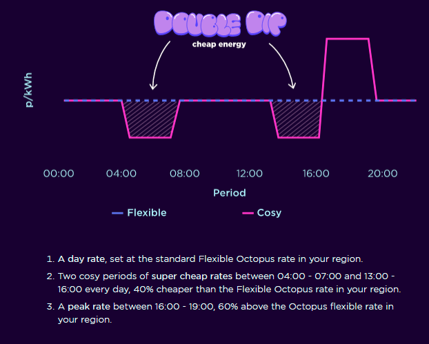

ReedRichards Posted December 24, 2023 Share Posted December 24, 2023 5 hours ago, Ronny said: There is no tariff available as far as i know which is suitable for a heat pump I've never worked out why Octopus think "Octopus Cosy" is suitable for a heat pump. Presumably you think it is vaguely suitable, @Ronny? Link to comment Share on other sites More sharing options...
HughF Posted December 24, 2023 Share Posted December 24, 2023 Completely unsuitable for us…. The thing just runs 24/7 at the moment on weather comp… Link to comment Share on other sites More sharing options...
JohnMo Posted December 24, 2023 Share Posted December 24, 2023 1 hour ago, ReedRichards said: I've never worked out why Octopus think "Octopus Cosy" is suitable for a heat pump. Should be called Octopus 'battery' really, that's the only real use I see with it, having an ASHP is just a bonus. Link to comment Share on other sites More sharing options...
Ronny Posted December 25, 2023 Share Posted December 25, 2023 15 hours ago, ReedRichards said: I've never worked out why Octopus think "Octopus Cosy" is suitable for a heat pump. Presumably you think it is vaguely suitable, @Ronny? It is only suitable if you have batteries to carry you through the expensive times. The advantage is having "cheap" power in the afternoon as well as during the night. Lets face it there is no "good" tariffs available from any supplier as far as i can see. Link to comment Share on other sites More sharing options...

HughF Posted December 25, 2023 Share Posted December 25, 2023 5 hours ago, Ronny said: It is only suitable if you have batteries to carry you through the expensive times. The advantage is having "cheap" power in the afternoon as well as during the night. Lets face it there is no "good" tariffs available from any supplier as far as i can see. Octopus tracker seems the best option out there, from what I can see. Link to comment Share on other sites More sharing options...
