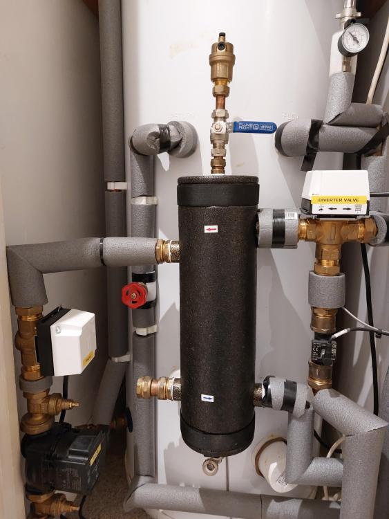

HughF Posted January 15 Share Posted January 15 4 hours ago, sharpener said: With a plain simple underfloor heating system they should be able to install the Grant 10kW to run efficiently. I see it is not the new one with R290 refrigerant which would be a be a shade more efficient, perhaps that is not yet available in the 10kW size. Except, they probably wont... It'll end up as a system with a buffer/header, with another pump on the manifold, mixing down from 50 degrees... Link to comment Share on other sites More sharing options...
sharpener Posted January 15 Share Posted January 15 5 hours ago, Andy T said: I'm thinking of asking the installer in advance how they intend to install the unit as this seems to be a large part of whether the unit will be efficient or not.... 54 minutes ago, HughF said: Except, they probably wont... It'll end up as a system with a buffer/header, with another pump on the manifold, mixing down from 50 degrees... Get them to draw a diagram of the system they propose and explain what all the components are for. Not so you can find out for yourself, but so you can tell if they know themselves. Link to comment Share on other sites More sharing options...

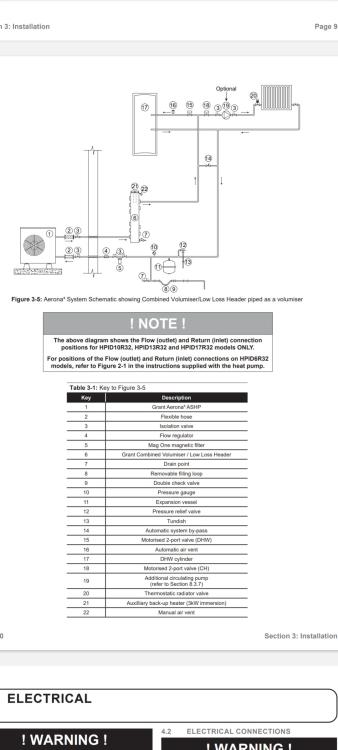

JohnMo Posted January 15 Share Posted January 15 The Grant unit can be installed in two ways a buffer/low loss header configuration, buffer gives hydraulic separation between heat and UFH - you do not want this configuration. The other is a system volumiser - a buffer is installed in the supply piping only. This is ok. Ideally you want, UFH as a single zone, no buffer, no mixer and no additional pumps, just run on weather compensation. Heat pumps have a minimum system volume as long as your system configuration complies no need for a buffer. But installers want to install in buffers Link to comment Share on other sites More sharing options...
PhilT Posted January 15 Share Posted January 15 1 hour ago, JohnMo said: Ideally you want, UFH as a single zone, no buffer, no mixer and no additional pumps, just run on weather compensation. Heat pumps have a minimum system volume as long as your system configuration complies no need for a buffer. So in summary the Grant 10kW R32 model would be ideal because it has a built in (unlike similar offerings) "HE Pump" which would be powerful enough to serve a simple single circuit UFH zone in a 160sqm single floor bungalow, without the need for a secondary circuit/pump/LLH/buffer Link to comment Share on other sites More sharing options...
Beelbeebub Posted January 15 Share Posted January 15 The grant volumiser is pretty small, something like 15l. It also does double duty as a backup heater that can either take over from the HP if there is some sort of problem or supplement it in extreme weather. Link to comment Share on other sites More sharing options...
