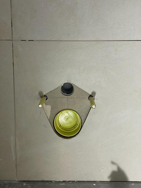

sorry for the delay. here's what my tiler did for ours.
Pretty smart and better than the butchery I was about to attempt. Presumably just measured the 4 corners and joined the dots? I'll give it a whirl.

it's all done with the angle grinder! i am very impressed. he is a very good tiler though so i shouldn't be surprised.
Well I still can't fathom how you can do that with a conventional diamond disk. Certainly, if I did it it would end up being a bit of a mess :).
I'm always impressed with a contractor who can do that good a job and I can't even guess how.

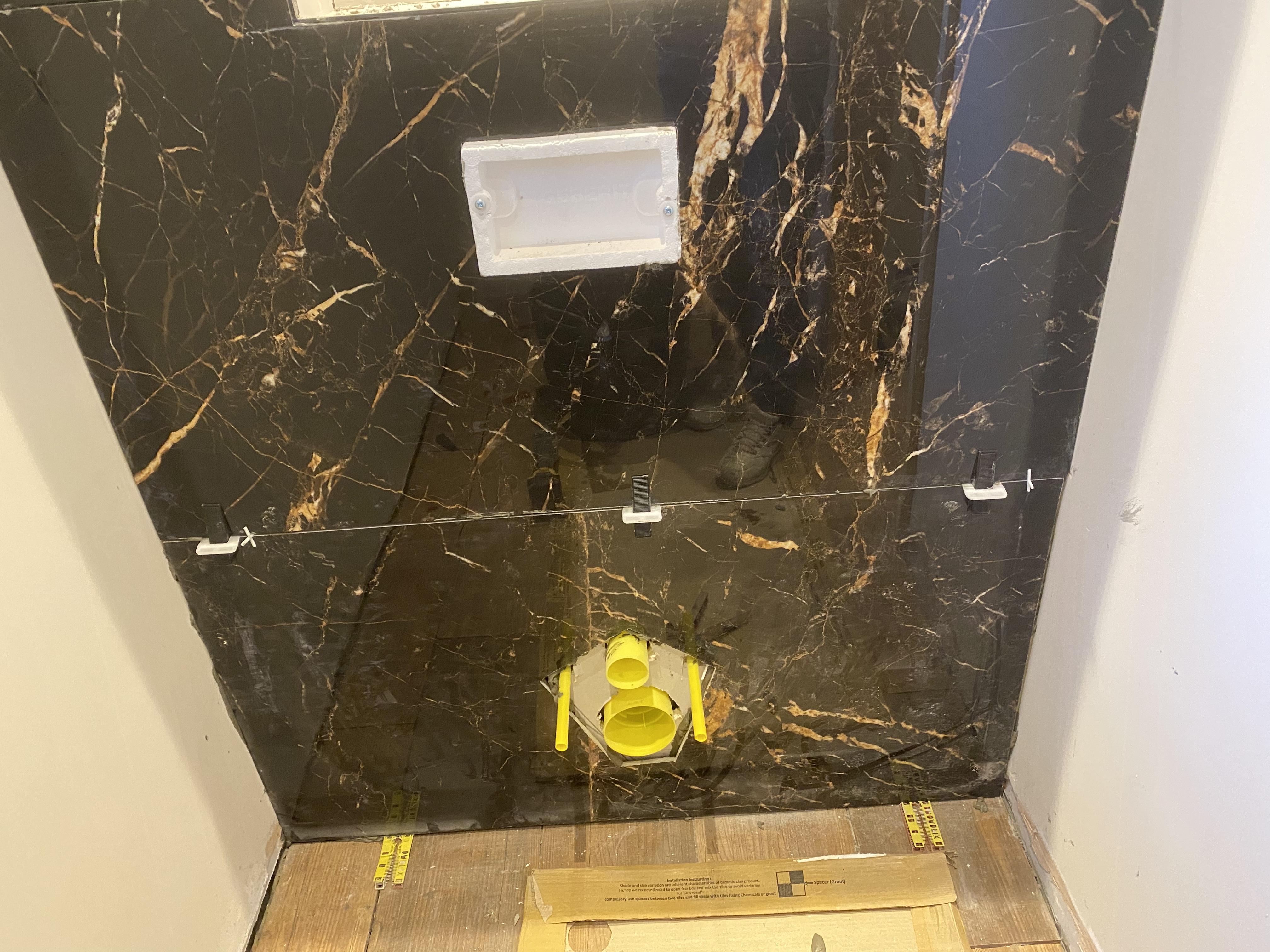

I haven't tried yet, but I'd transcribe the protrusions onto the back of the tile, using the tiling protectors as templates to get the circles the correct diameter, just like you would when boarding the frame in. Then use a straight end to draw a diamond encasing those outlines. Cut along the diamond lines.
Sounds pretty simple in theory, I'll let you know how I get on tomorrow :)

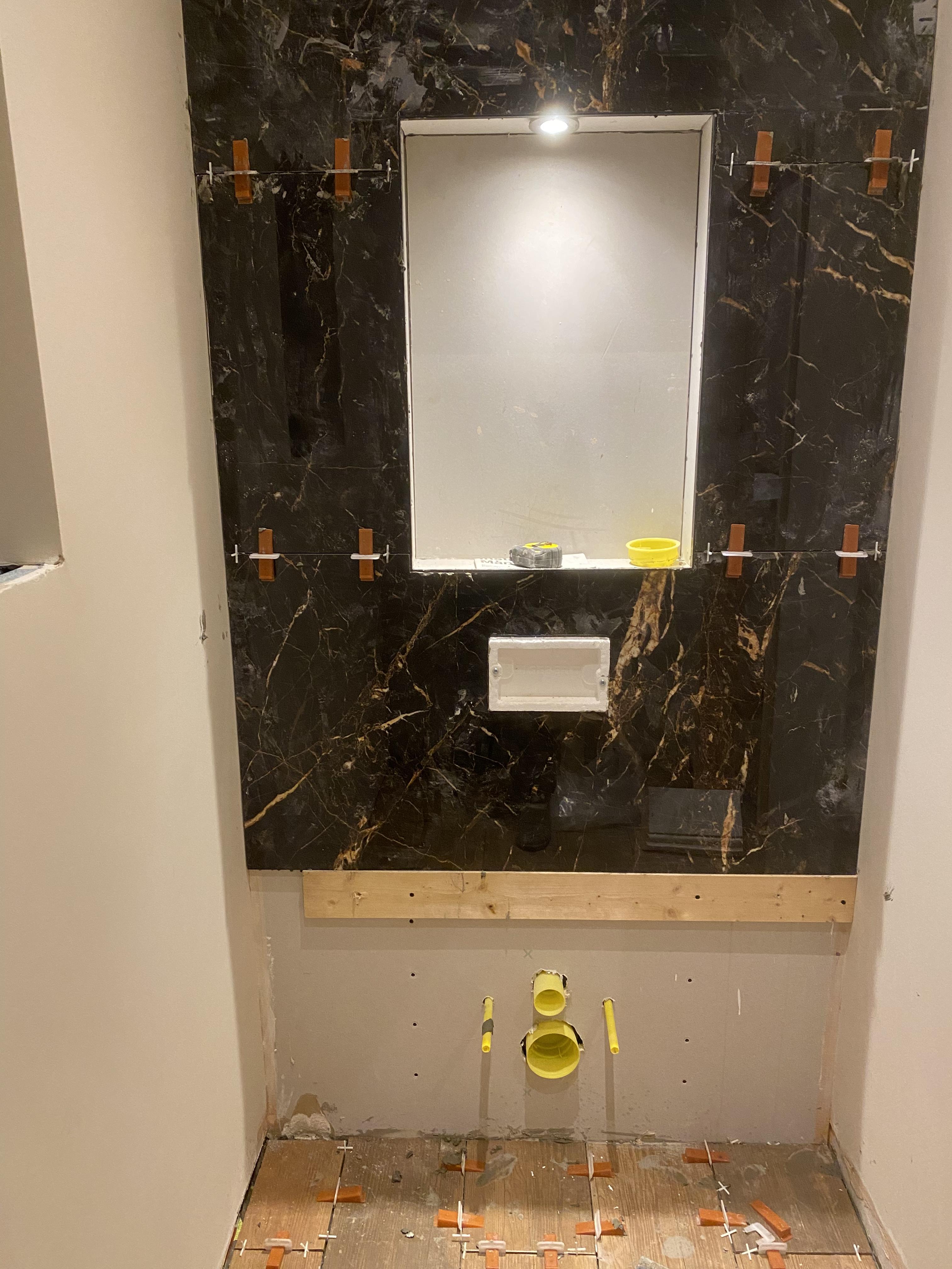

Running behind as ever, but today’s the day.
I plan to;
- make sure the pan fits (I.e the rods are in the right holes
- draw a diamond on the plasterboard using the protrusions as a guide
- take the measurements of the 4x diamond points and transfer them to my tile
- connect the dots and turn the grinder on.
wish me luck…

It’s on.
