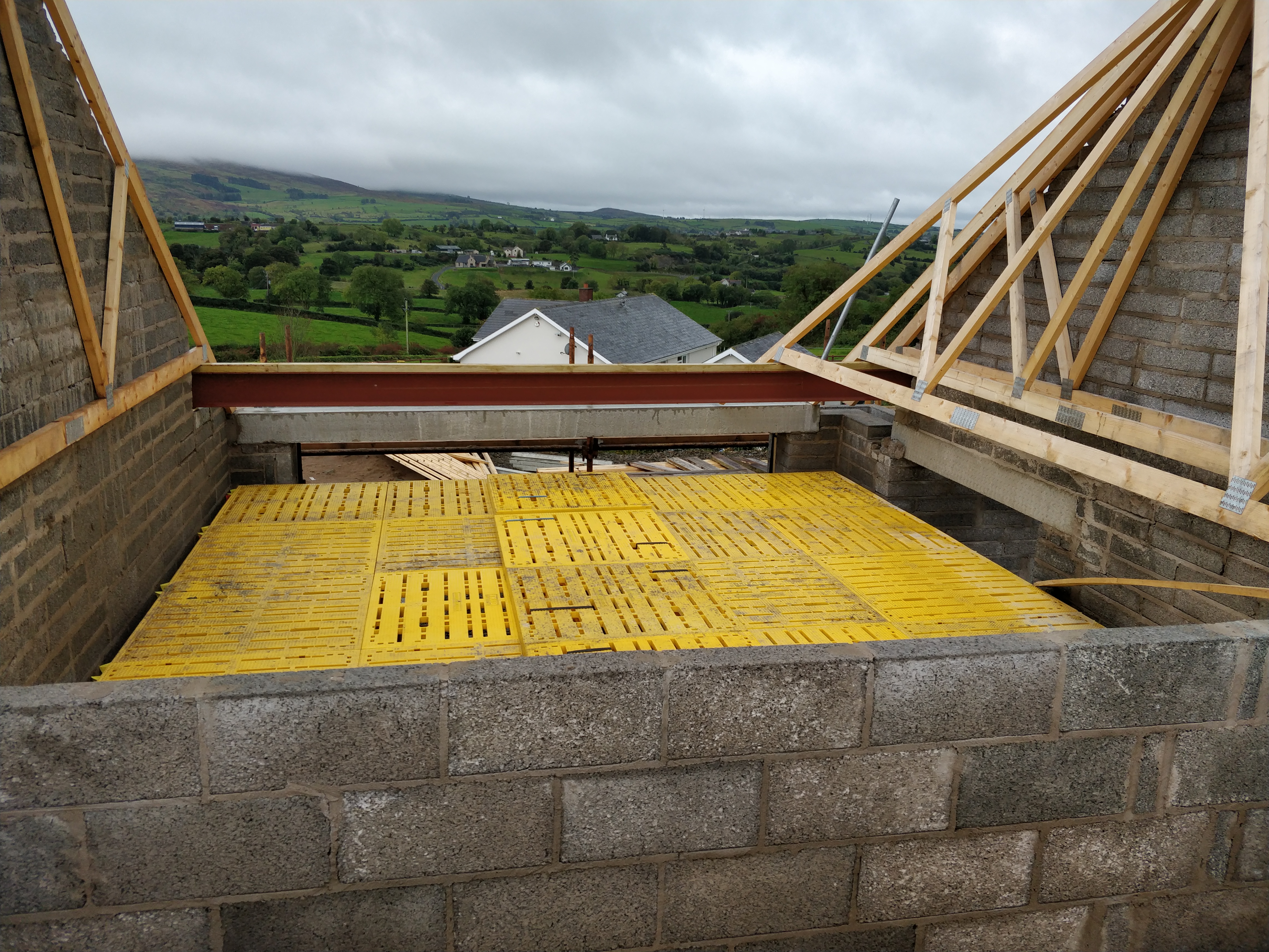

vfrdave Posted September 5, 2017 Posted September 5, 2017 Has anyone provided any means of internal fall protection on their build, specifically during the roofing phase? I had an unwanted visitor by way of the health and safety inspector and he now wants me to provide fall protection. Air bags or bean bags was suggested but neither seem readily available in NI. Trestle planks and plywood it might have to be.

vfrdave Posted September 5, 2017 Author Posted September 5, 2017 @Alphonsox falling from roof trusses to the floor single story building. Unfortunately work has been stopped by prohibition notice until he is satisfied, so can't continue with roof in the meantime.
Construction Channel Posted September 5, 2017 Posted September 5, 2017 what kind of area do you need to cover? how long do you need them for? (just for the trusses or the entire time anyone is working on the roof) can you claim they will only work in stages? (only cover half the floor at a time) could you consider harnesses? I remember when we got called upon by HSE, had to spend a month wearing hi-vis and buy an accident book..... we got off lightly
Guest Alphonsox Posted September 5, 2017 Posted September 5, 2017 That has got to be unlucky, there's a lot of places around us where HSE isn't even an afterthought. How about boarding out the loft as a solution ? That should limit the drop to a couple of meters, would that work ?

Mr Punter Posted September 6, 2017 Posted September 6, 2017 The TF firm on the current project used Trad Deck. PITA to install, especially if there are smaller rooms and corridors.
vfrdave Posted October 16, 2017 Author Posted October 16, 2017 Trad deck is what I have ended up using not too bad to install did it on my own.
vfrdave Posted October 16, 2017 Author Posted October 16, 2017 They were at 1630 nearly scared to go and look now.
