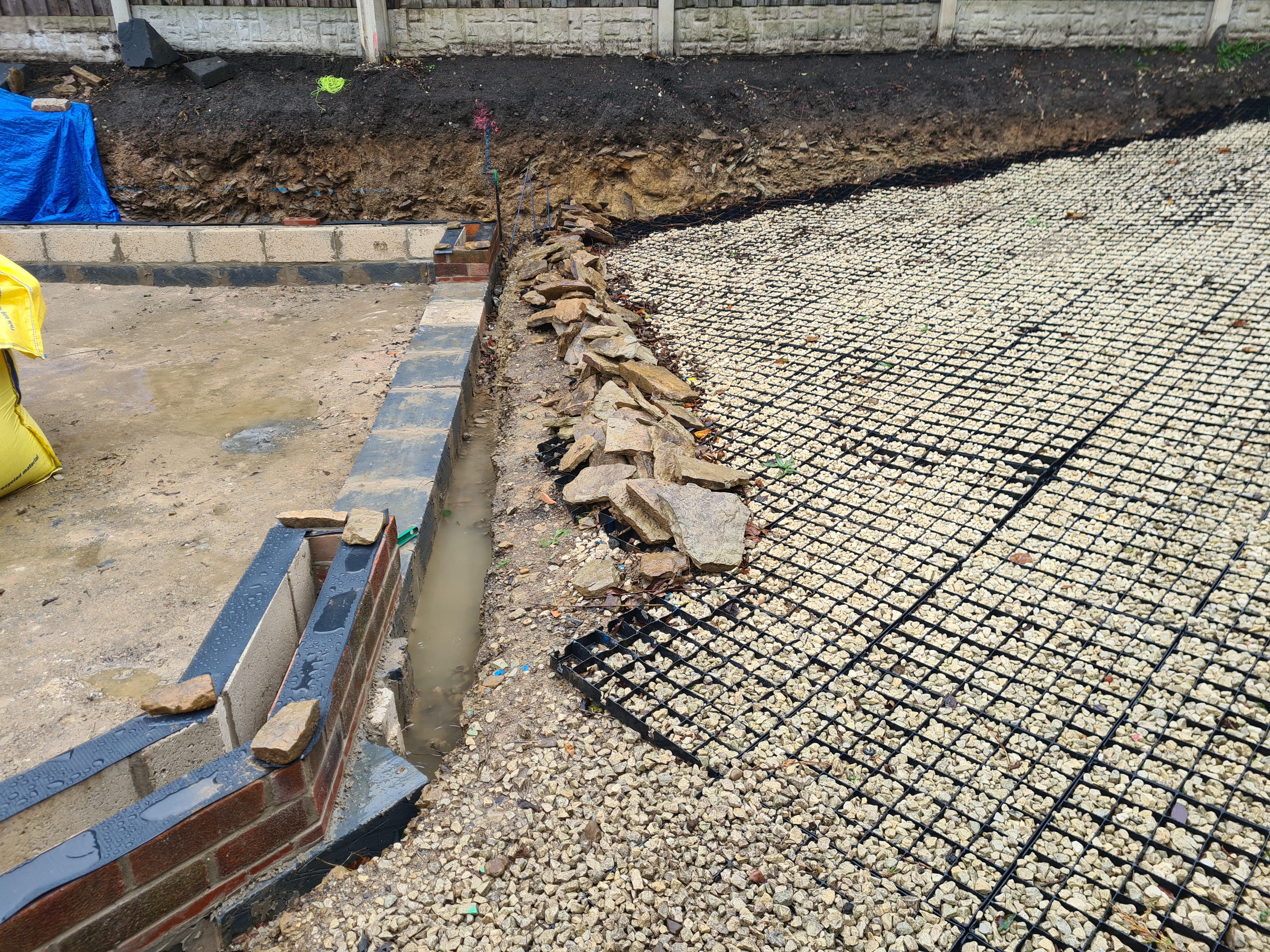

syne Posted October 24, 2023 Author Posted October 24, 2023 (edited) This is how it is at the moment Please forgive the brickwork. Edited October 24, 2023 by syne 1
saveasteading Posted October 24, 2023 Posted October 24, 2023 That looks good. The rain should disappear through the gravel. Nicely sized jaggy gravel too. Make sure it is just above the grids or the plastic will chip off.

syne Posted October 24, 2023 Author Posted October 24, 2023 (edited) The grids are temporary, how permeable is resin bound? It used to be concrete and angled toward the street. But it's now 1200mm lower and directly under the blockwork is a single sheet of rock that spans the whole site. The trench blocks were put in just in case some future person wants a strange diamond shaped garage conversion. Not me ill hasten to add! Edited October 24, 2023 by syne
saveasteading Posted October 24, 2023 Posted October 24, 2023 26 minutes ago, syne said: The grids are temporary They don't need to be, unless you got pedestrian grade. I've put in hundreds of m2. They wear and chip over years but are good for cars. And they solve your water concern. And they satisfy building regs for paved drives. Not a fan of resin bound except they can look nice on patios. Whatever surface, the strength depends on what is under it.
syne Posted October 24, 2023 Author Posted October 24, 2023 It was lovely and smooth and neat when they went in, took the weight of cars and vans fine. Then the grab lorries and the concrete mixer have made it look like an old mattress.
saveasteading Posted October 24, 2023 Posted October 24, 2023 17 minutes ago, syne said: look like an old mattress. A good job it wasn't expensive resin then as it would be wrecked. To get it level, hook under the grid where it is low and jiggle it gently up to level. A nail bar or claw hammer etc. Gravel will migrate under it, so needs to be replaced. Repeat for 10 years. About the drainage, are you aware of the porosity or soakaway rules for new drives? Currently you have satisfied them.
syne Posted October 24, 2023 Author Posted October 24, 2023 The grids are getting taken up, and put down again once the conc slab is poured and the blocks have been dropped off. Bit in a years time (hopefully just a year) when the driveway is all landscaped I want something more permanent and decorative. Not sure what yet there's a thousand other design decisions in front of the drive. 🤔
