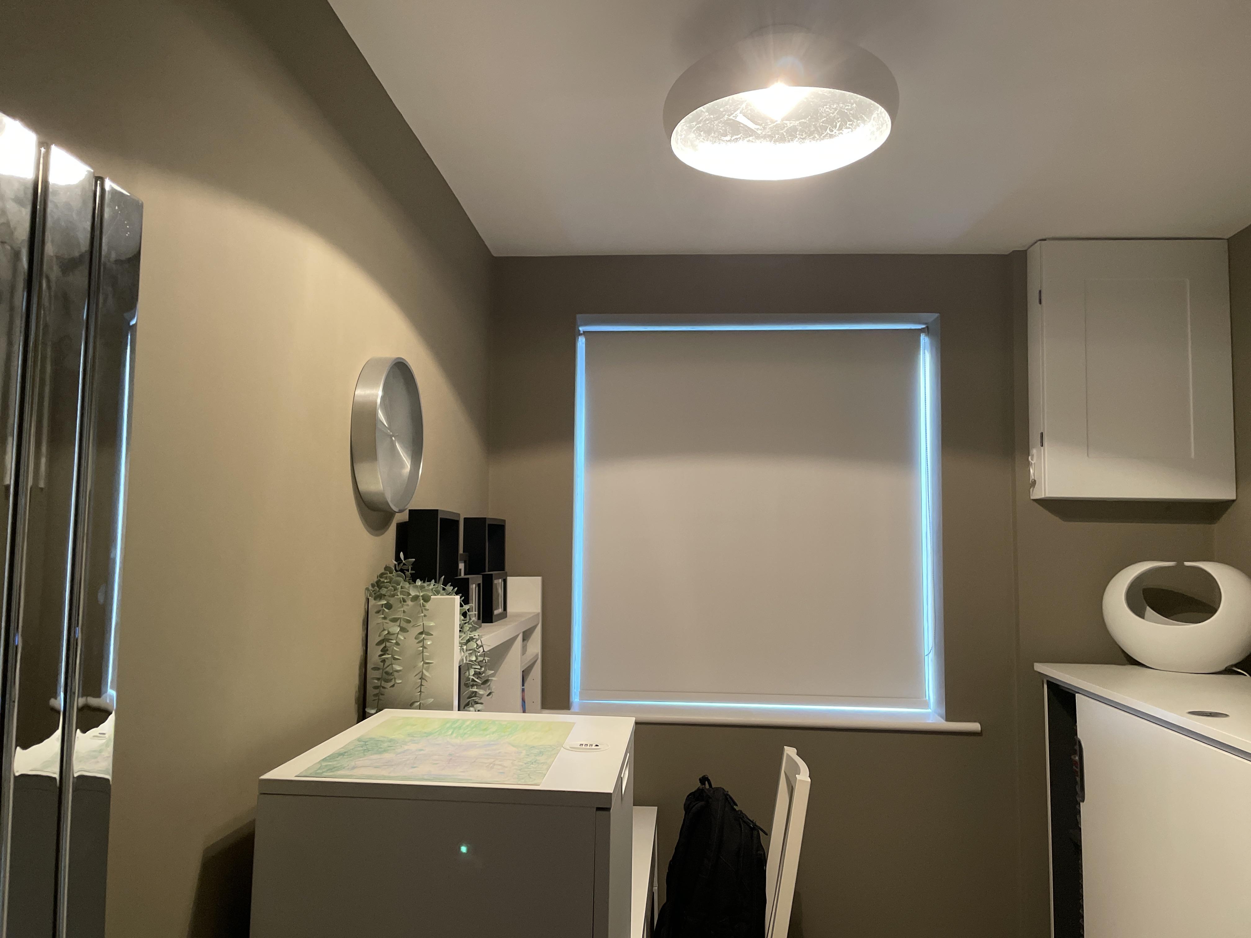

Loz100 Posted October 19, 2023 Author Share Posted October 19, 2023 When we extended our property years ago our architect listed an additional room on our ground floor as a gym. It is actually used as a home office for my husband but the council have advised that it was stipulated as a gym at planning and therefore is not entitled to the same minimum distancing as a habitable room. I am beside myself as my husband can spend 10 hrs a day in there and the want to build a bungalow 2m from our window. Link to comment Share on other sites More sharing options...

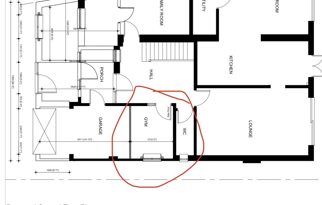

JohnMo Posted October 19, 2023 Share Posted October 19, 2023 To argue the case you would possibly need to know why it's stated as a gym and not something else. For example do you have heating in the gym, is the floor and walls treated the same as the rest of the house? The issues you have is the drawing as presented,m, shows the external wall to built to the same spec as the garage, so not insulated. So it's more like a sub division of the garage, and not within the insulated envelope, like a normal internal room. To be classed as habitable room the walls and floor and ceiling or roof would all need to comply with building regs. Unfortunately as presented they look more like a garage not an internal room. Link to comment Share on other sites More sharing options...

Loz100 Posted October 19, 2023 Author Share Posted October 19, 2023 Hi Thank you for your reply. The room is insulated and heated. It is like any other room in our house. carpeted, plastered lighting etc etc It is has been used as my husbands office since covid lock down as he had to work from home & is often in there for 10 hours a day. The council however are stating that a gym which is one of the rooms former uses is not entitled to the same rights as a study and it would have to be listed as a study at the time of planning consent. A hobby room is offered the same rights as a study so I cannot see the reasoning behind this. It meets all building regulations for a study and has always been used for many hours a day even when it was a gym. I thought that was part of the definition of a habitable room so now I am just confused. I appreciate you taking time out of your day to assist me. Many thanks Link to comment Share on other sites More sharing options...
JohnMo Posted October 19, 2023 Share Posted October 19, 2023 As far as planning is concerned the room is designated the same as the garage. Have read up on here, it may point you in the right direction and you may be able to apply for something retrospectively https://www.fmb.org.uk/find-a-builder/ultimate-guides-to-home-renovation/garage-conversions-the-ultimate-guide.html#:~:text=Search-,Do I need planning permission%3F,to make a planning application. Link to comment Share on other sites More sharing options...
nod Posted October 19, 2023 Share Posted October 19, 2023 At the worst you could apply to convert your “Gym” into an office John M hit The nail on the head Your first route would be to look at the fabric of the room Is it more like a habitable room than a garage Heating plaster etc 1 Link to comment Share on other sites More sharing options...
saveasteading Posted October 19, 2023 Share Posted October 19, 2023 40 minutes ago, Loz100 said: The room is insulated.. like any other room in our house. Are you sure? The drawing shows a space taken out of a garage, or at least to thd said construction, so like a store. Whatever it was intended for, the architect has shown it as a thinner wall than the house, to the same construction as the garage. The use of the word gym in the planning application may even have been deliberate, to minimise construction and cost. Can you check the outer wall thickness and construction? Easiest done at the window. 1 Link to comment Share on other sites More sharing options...

saveasteading Posted October 19, 2023 Share Posted October 19, 2023 9 minutes ago, Loz100 said: The internal windowsill depth is 200mm The builder knew And how does that compare with the main house? 200mm is unlikely to be indulated to full house construction. The builder is not relevant unfortunately. Telling the planners one thing and doing something else is more a problem than an answer. Link to comment Share on other sites More sharing options...

Loz100 Posted October 19, 2023 Author Share Posted October 19, 2023 The original bedroom window sills are 180mm deep and the new bedroom windows are 230mm deep. It is a bungalow so overlooking is not a concern but the lack of light and oppressive feel are more of a concern. This is not a landing or bathroom window but a room where my husband can spend 10 hours a day. 🥹 When we extended our property years ago our architect listed an additional room on our ground floor as a gym. It is actually used as a home office for my husband but the council have advised that it was stipulated as a gym at planning and therefore is not entitled to the same minimum distancing as a habitable room. I am beside myself as my husband can spend 10 hrs a day in there and the want to build a bungalow 2m from our window. Link to comment Share on other sites More sharing options...

torre Posted October 19, 2023 Share Posted October 19, 2023 If you'd specified this as a habitable room from the outset, the planners would probably have raised overlooking concerns and asked you to amend the plans accordingly. It does sound like at least some of your architect, builder, and self already had another use in mind, so one has to wonder why this wasn't specified as a habitable room? Look at it from your neighbour's perspective - when you applied for planning did they expect someone looking out over their property from a meter away for 10 hours a day? We all grumble about planners and hope to be treated fairly and that's what this sounds like - the planners let you build a metre from your neighbour and now they may allow your neighbour to do the same. Imagine if your neighbour had built the same extension first? I don't think you'd want to have your own plans refused. Link to comment Share on other sites More sharing options...

Mr Punter Posted October 19, 2023 Share Posted October 19, 2023 Planners are often not keen to allow windows in habitable rooms at the side of a property for just the reason that it may prevent future development of the neighbouring land. I suspect that is why the room is labeled as "gym" rather than "study". Link to comment Share on other sites More sharing options...
