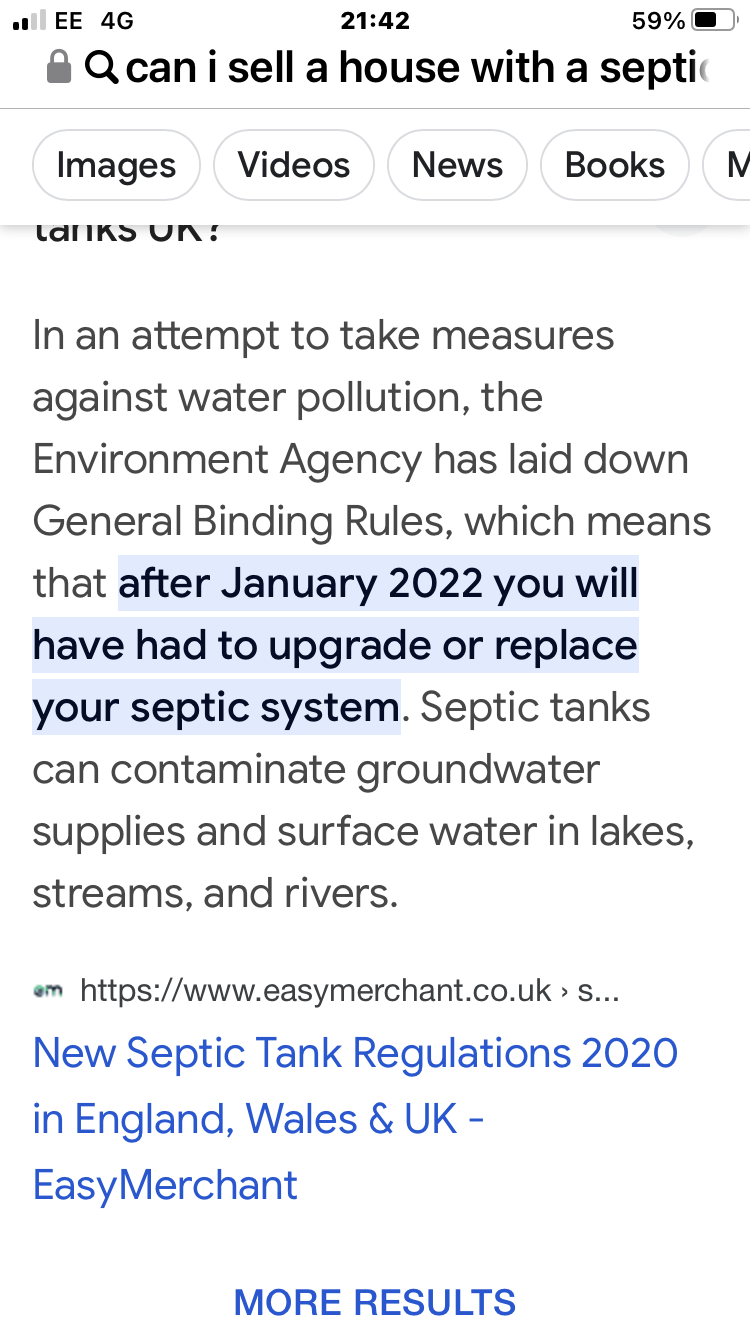

flanagaj Posted October 18, 2023 Author Share Posted October 18, 2023 I am not sure that is 100% correct. I have not seen anything on the DEFRA literature that states that you need to do this. It would be great if this was the case, but not convinced. I am sure it only relates to systems that drain into a water course and not those that use a drainage field which is away from a water course. Link to comment Share on other sites More sharing options...
ProDave Posted October 18, 2023 Share Posted October 18, 2023 You only have to upgrade a septic tank if it discharges to a water course. But in Scotland, SEPA have admitted they are not enforcing it. Link to comment Share on other sites More sharing options...
IanR Posted October 18, 2023 Share Posted October 18, 2023 (edited) In England, if the septic tank has not been altered since 2015, and assuming there is no EA Permit, then the only additional rule you must now meet is that it must discharge to a correctly sized (to BS 6297:2007) drainage field. It can not discharge to a water course. If you are selling a property with a septic tank you must inform the buyer, in writing, all details about the system (General Binding rules sets that out) Since it's a criminal act to run a private sewage system and not meet the General Binding Rules, then when a property is sold that has a system that doesn't meet them, the parties should agree who will upgrade the system and make it a condition of sale. 2 hours ago, flanagaj said: We are purchasing a property that has a shared septic tank which is shared by two neighbouring properties. The property is unregistered, and in the old title deeds dated 1920 it clearly makes reference to the two properties having to pay a 1/3 share towards the maintenance of the septic tank. But when I downloaded the title deeds of said neighbouring properties from the land registry, it just states the following. Do you or your neighbour have a copy of the "Conveyance of land lying to the north of the land in this title known as Mertesse dated 11 January 1971 ". They appear to have brought forward the reserved rights to the current title deed, but not necessarily the condition (covering 1/3 of costs). That 1971 Conveyance should have been sent to the Land Registry when your neighbours property was first Registered. Edited October 18, 2023 by IanR Link to comment Share on other sites More sharing options...
nod Posted October 18, 2023 Share Posted October 18, 2023 13 minutes ago, ProDave said: You only have to upgrade a septic tank if it discharges to a water course. But in Scotland, SEPA have admitted they are not enforcing it. 50 minutes ago, flanagaj said: I am not sure that is 100% correct. I have not seen anything on the DEFRA literature that states that you need to do this. It would be great if this was the case, but not convinced. I am sure it only relates to systems that drain into a water course and not those that use a drainage field which is away from a water course. As Dave says it may be regional how each LA enforce it But in Lancashire If the discharge isn’t clean water The tank has to go Point of sale seems to be the only practical way of enforcing this Personally I would buy a house with a shared septic tank or treatment plant Our first build had a tank that needed relocating Our solicitor was horrified when I suggested installing a large TP between us both I installed a TP for us and a new septic tank for them Which will have to be replaced if they ever move house Link to comment Share on other sites More sharing options...
