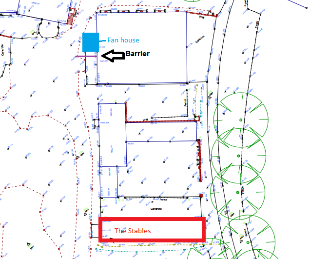

Moonshine Posted December 18, 2019 Share Posted December 18, 2019 (edited) o.k @readiescards on the assumption that you have to have the fan room doors open to get ventilation to the fan room, here are my suggestions. These are also given on the basis that rooms affected by the noise of the stables are the ones furthest to the side with the fan. I would carry out these suggestions in stages to see the affect, as some are more involves with cost implications, in order. 1) Put an acoustic barrier as close to the fan room as possible, such as below, and can be built off the barn entrance upright steel. The height and extent of the barrier should be as much as possible, but given the noise source it should be as high as possible, but a minimum of 3m. In terms of the construction, because of the amount of low frequency sound it is kicking out the barrier needs to be pretty dense. So i would recommend a mass barrier such as an interlocking timber screen, e.g.https://www.jacksons-security.co.uk/acoustic-security-barriers/reflective-acoustic-barrier. With that barrier in place there should be a 1-1.2m gap to the fan room which would likely be enough to give antiquate ventilation 2) if you want to control noise from within the fan room breaking out, the barrier will help a bit, but if the barrier isn't working as well as you want it to and its the noise from the fan room itself rather than the fan extract. i would make up some acoustic absorbers to reduce the ambient noise levels in the fan room before it breaks out. As its an agricultural setting you can get away with an agricultural solution. Make up wooden frames which are min 80-100mm deep, and say 1m by 600m frames, and within the frames, put 100mm (or deeper) mineral wool / porous insulation (24 kg/m3), and hold in place with chicken wire each side of the frame. The number of absorbers will depend on the space available, but the more the better. If the frames are located with a cavity / space behind them onto the wall (e.g. 50 - 100mm) this will improve the low frequency performance of them. This will quieten up the noise within the fan room and break out from this space, but won't do much for the noise direct from the fan extract. 3) if that is not good enough, you may need to look to put a silencer on that extract (?) fan, where the ducting from the fan is taken up, over the roof and discharged away from the stables. You are probably looking at a rectangular silencer of 1.2 - 2.4m in length, and ideally place directly on the extract (?) of the fan. The silencer can be put on top of the roof, but you may need to account for this when you put in the acoustic barrier so that anything on the roof is shielded by the barrier. Edited December 18, 2019 by Moonshine 1 Link to comment Share on other sites More sharing options...

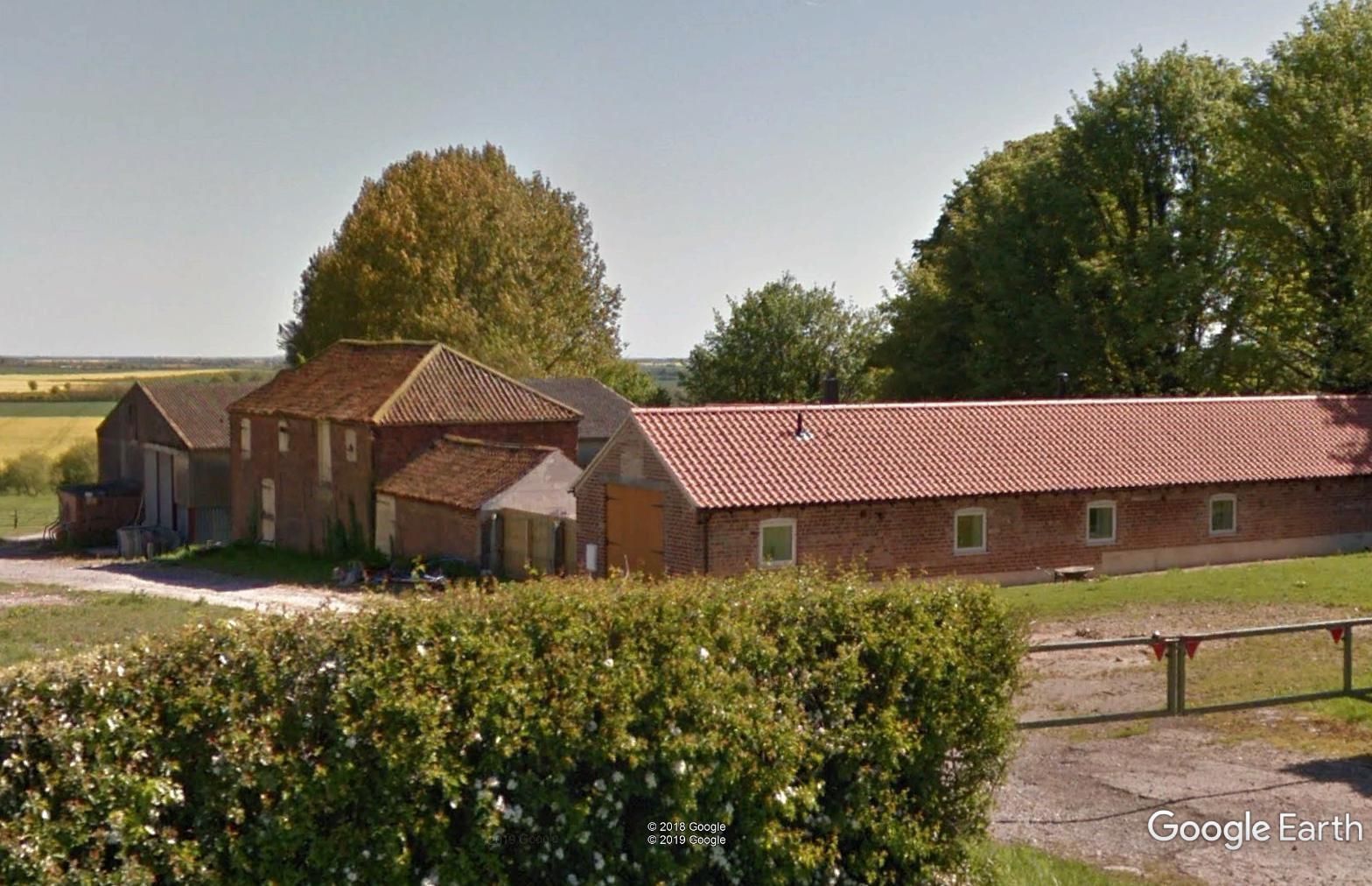

readiescards Posted December 18, 2019 Author Share Posted December 18, 2019 Pictures as requested. I should have said it is an intake fan - not extract. A prod with a big stick suggests the fan is very slightly out of balance so I'll try to get that addressed. The majority of the noise comes from the fan house - rather than the boom box grain store in my opinion. I can't get an Audacity recording until the weather improves - don't want to push fog into the grain heap. 5 hours ago, Ferdinand said: Can you install one or more split aircon or similar units in the relevant rooms to remove the need to open the windows? Well we 'sell' the location as being quiet and peaceful so really want holiday cottage guests to be able to sit outside and enjoy the peace, so preferring to kill the noise rather than shut it away but ta for suggestion. 2 hours ago, Moonshine said: With that barrier in place there should be a 1-1.2m gap to the fan room which would likely be enough to give antiquate ventilation If that is all that is needed then an assocutice wall might just be squeezable though it would need to be no more than 6" thick otherwise it would compromise the barn doors. I'll contact the Jackson fencing people - thanks for details. The noise in the fan room is horrendous but if reducing that limits the noise to The Stables then building a small frame around the motor is certainly viable - subject to motor heat issues. Really appreciate all the responses and ideas. Thanks Paul Link to comment Share on other sites More sharing options...
Moonshine Posted December 18, 2019 Share Posted December 18, 2019 18 minutes ago, readiescards said: If that is all that is needed then an assocutice wall might just be squeezable though it would need to be no more than 6" thick otherwise it would compromise the barn doors. I'll contact the Jackson fencing people - thanks for details. FYI Jackson are only one supplier, all you really need is suitably dense/thick (e.g. 30-35mm) tongue and grove boards that are treated for external use. 1 Link to comment Share on other sites More sharing options...
