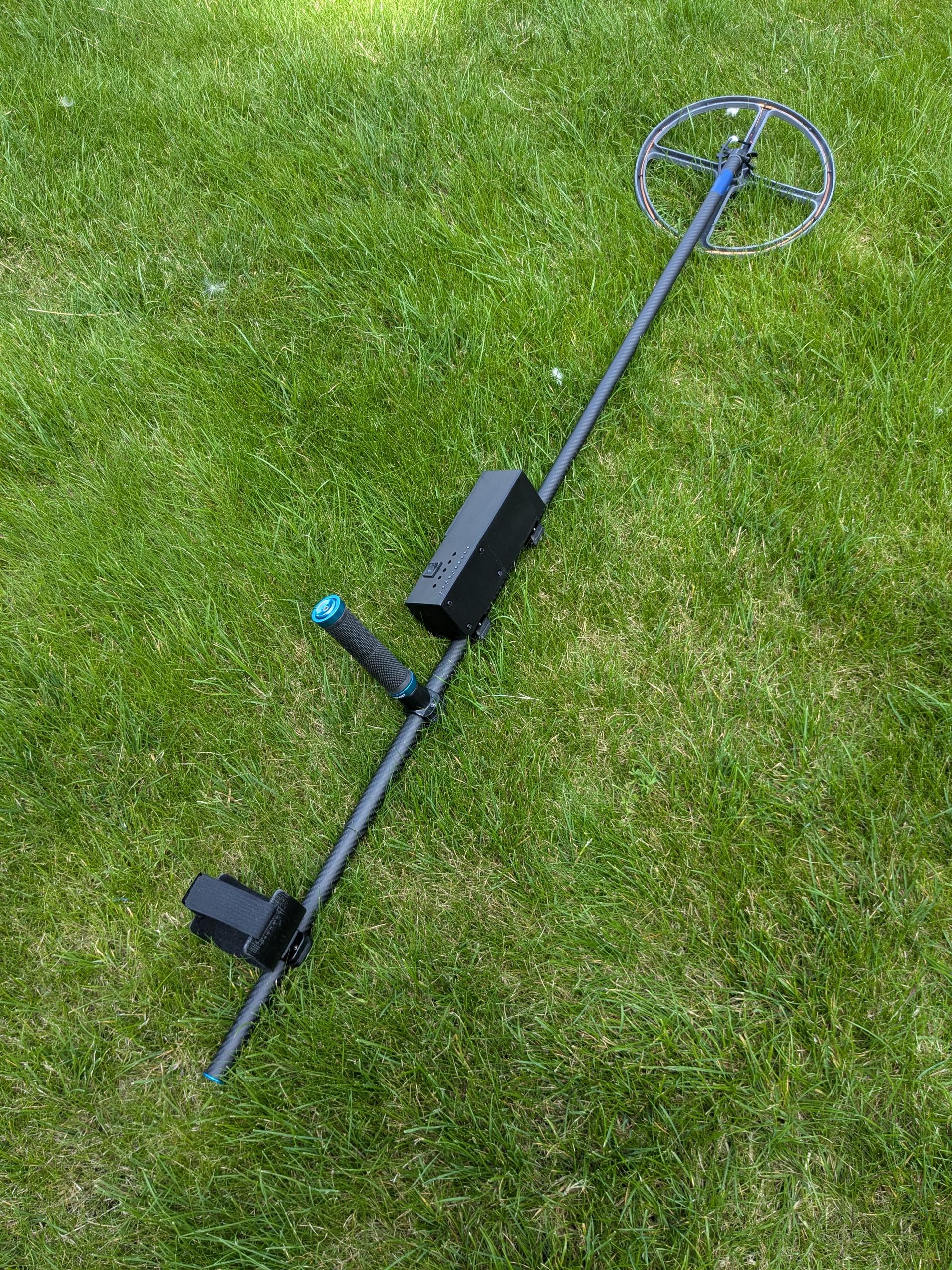

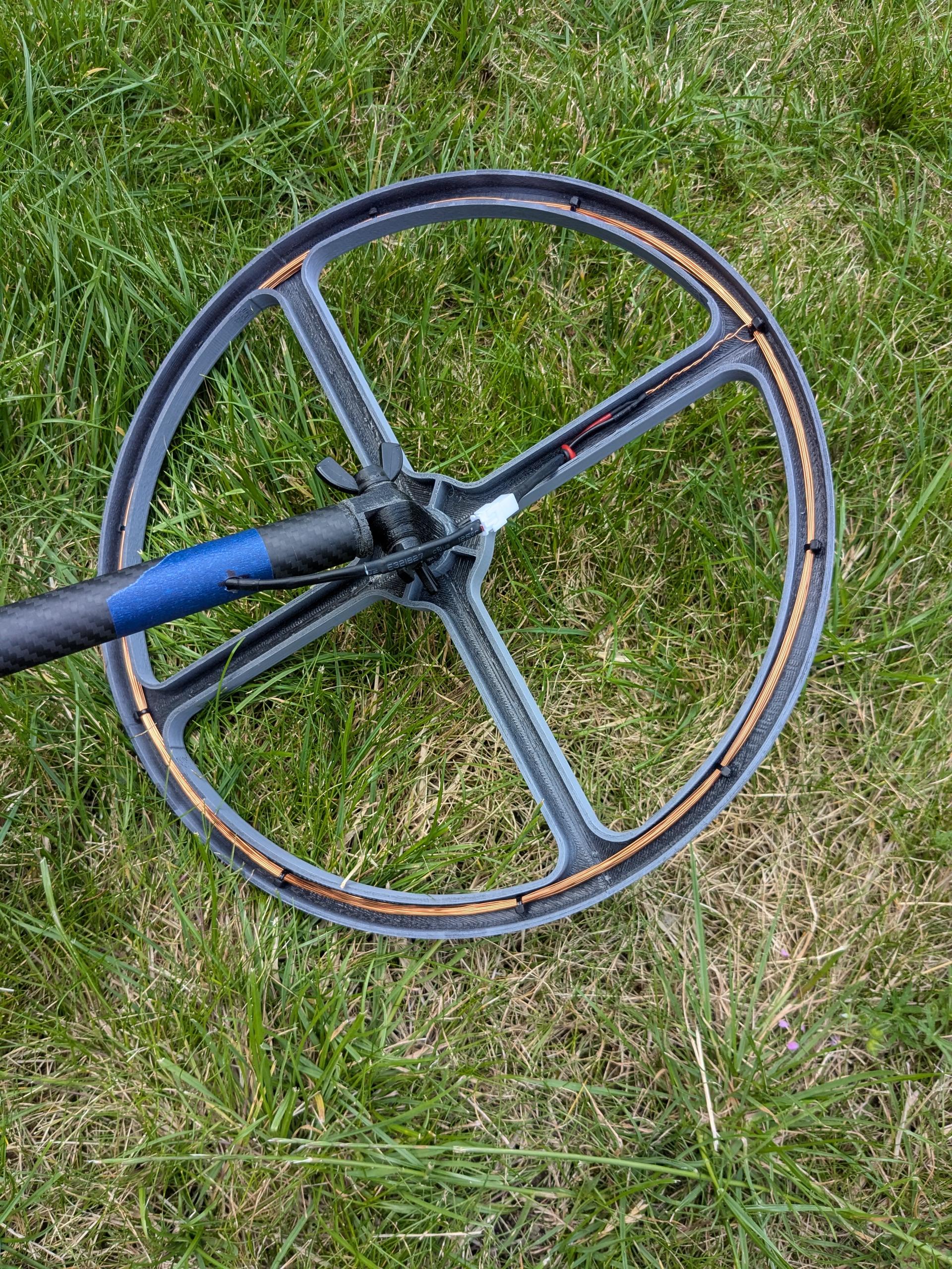

Metal Detector work in progress...
Carbon tube and 3D printed parts including coil frame. Still printing some parts.

The easiest filament to print is PLA. Works for most things but it has a low(ish) melting point so its not suitable for things that will be left in cars on very hot days or in the engine compartment! They are unlikely to melt but can warp if they get hot while under load. That said I used it to print my metal detector above so its a very usable filament.

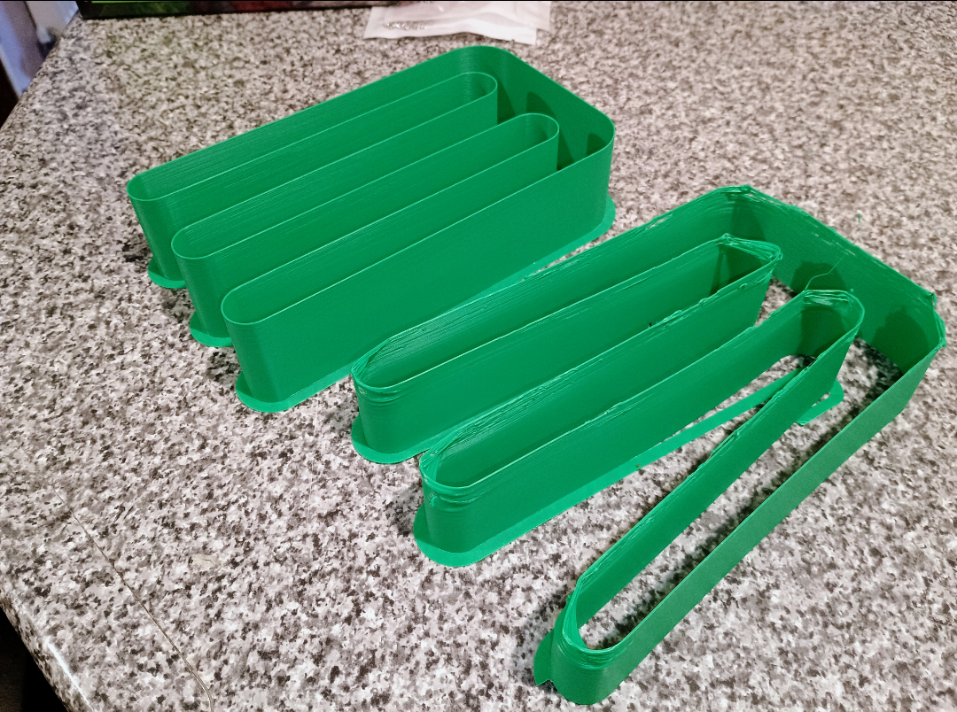

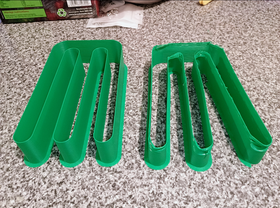

My lad changed the stock 0.4mm nozzle on the X1C Bambu to a "Hardended Steel vs E3D 0.4mm High Flow ObXidian" (one of his Chrimbo pressies):
Did a couple of "torture" test prints. They go from 15 mm³/s at the bed to 35 mm³/s. New nozzle on the left, stock one on the right. The stock print didn't adhere well and basically fell over:
Printed in Bambu Lab PLA Basic Green.
It really puts some volume down and smoothly too!

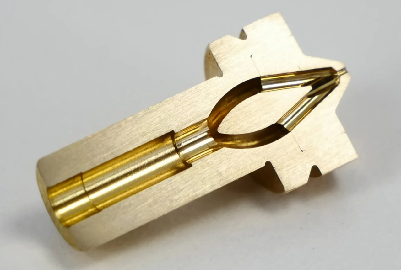

A cut away of the new nozzle shows how the molten filament gets "pooled" then extruded through 2 (maybe 3?) channels to massively up the flow rate by something like 60%.

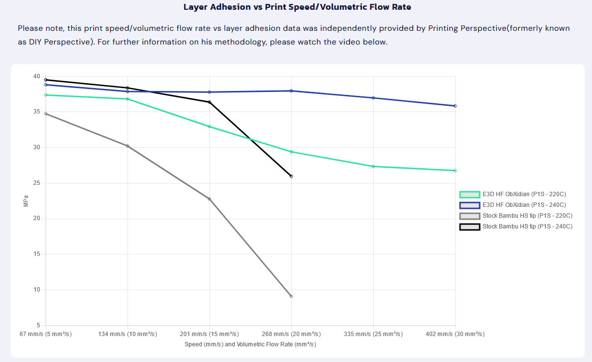

With the new hot end, as the volumetric flow increases  the strength remains more of a constant:
