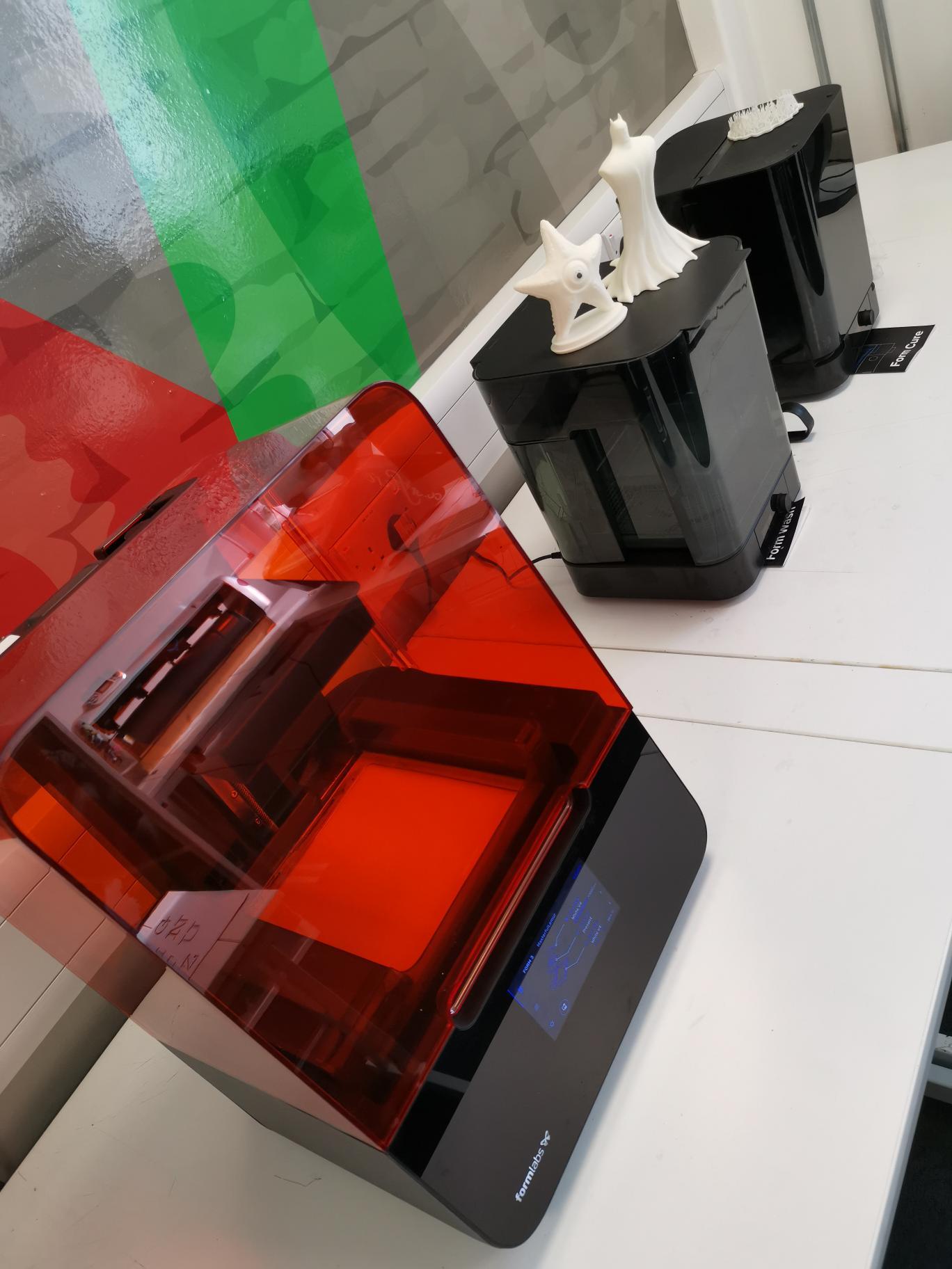

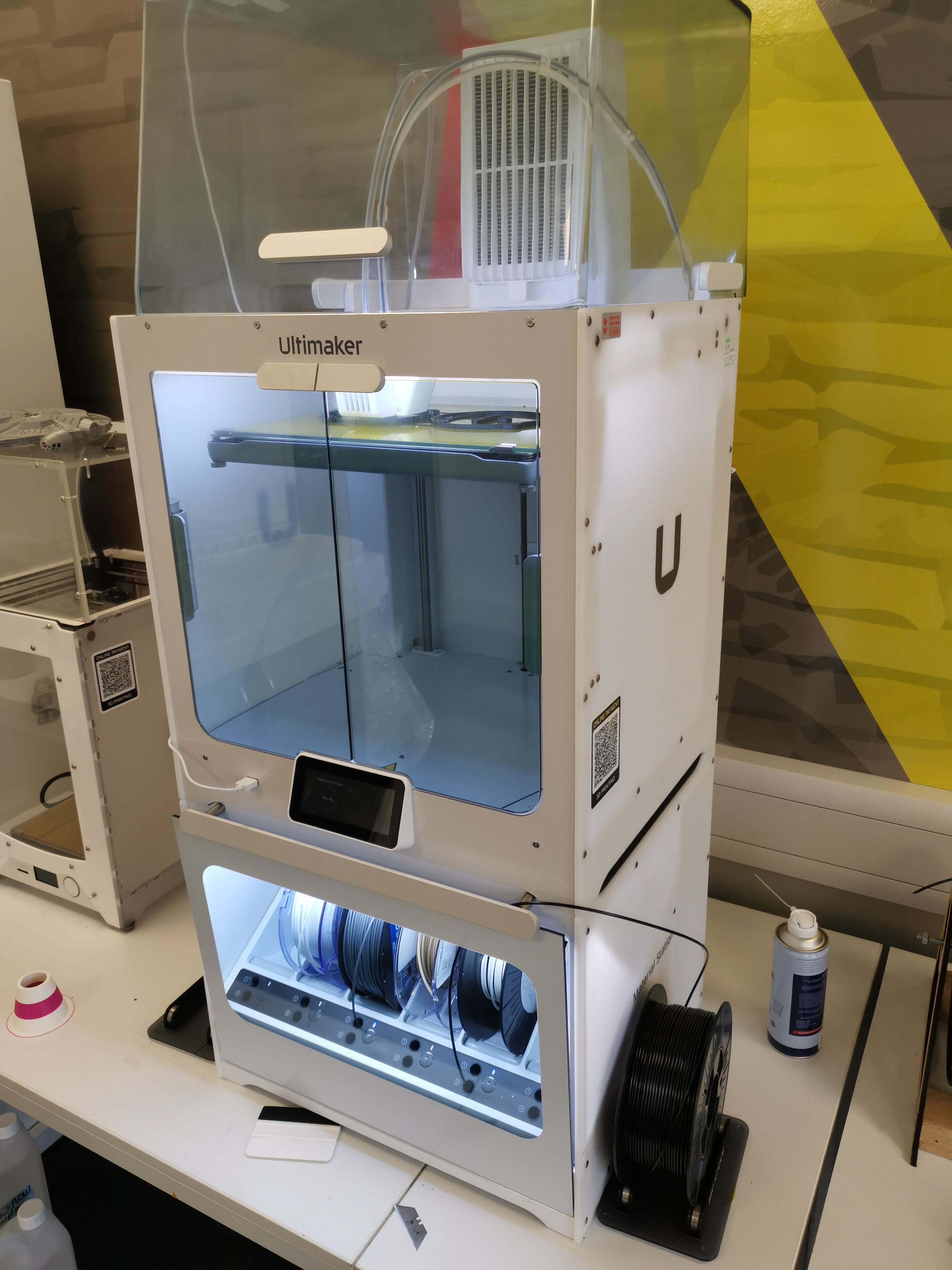

Yeah we had one, a Z-Corp. Garbage to be fair. The resin printer is the highest resolution but the Ultimaker is the work horse.

ABS or ASA is probably best externally. ABS nicely colour fast too. Saying that we've done some PLA, in shaded areas, some primed and painted, some not that's all been fine. ABS then is notorious for warping hence an enclosure with fume control / extraction is essential. We've not been able to successfully print ABS yet but must tweak the enclosure / extraction and try again. Hugely susceptible to draughts. I know lads and it's all they use for printing. ASA is a bit more forgiving warping wise but again needs extraction.
Fume control can be either by direct venting to outside or through say charcoal etc filters.
You get adhesion promoters of various forms. With Anycubic they have a special dimpled bed that is magic for PLA. It adheres when printing like sh!t to a blanket. When the bed cools the part just releases.
PLA loves printing in the cold, we often leave the window open. ABS needs a warm cabinet.
You can add a borosilicate glass plate atop your print bed. On that you can paint ABS slurry, Kapton tape, blue masking tape, hairspray, 3D-Lac, Pritt Stick etc etc.
