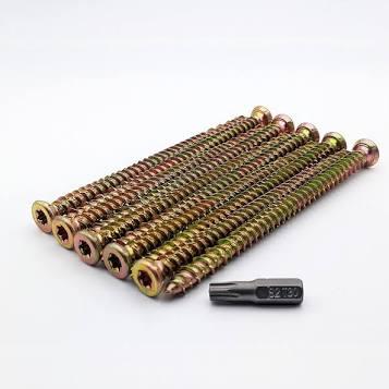

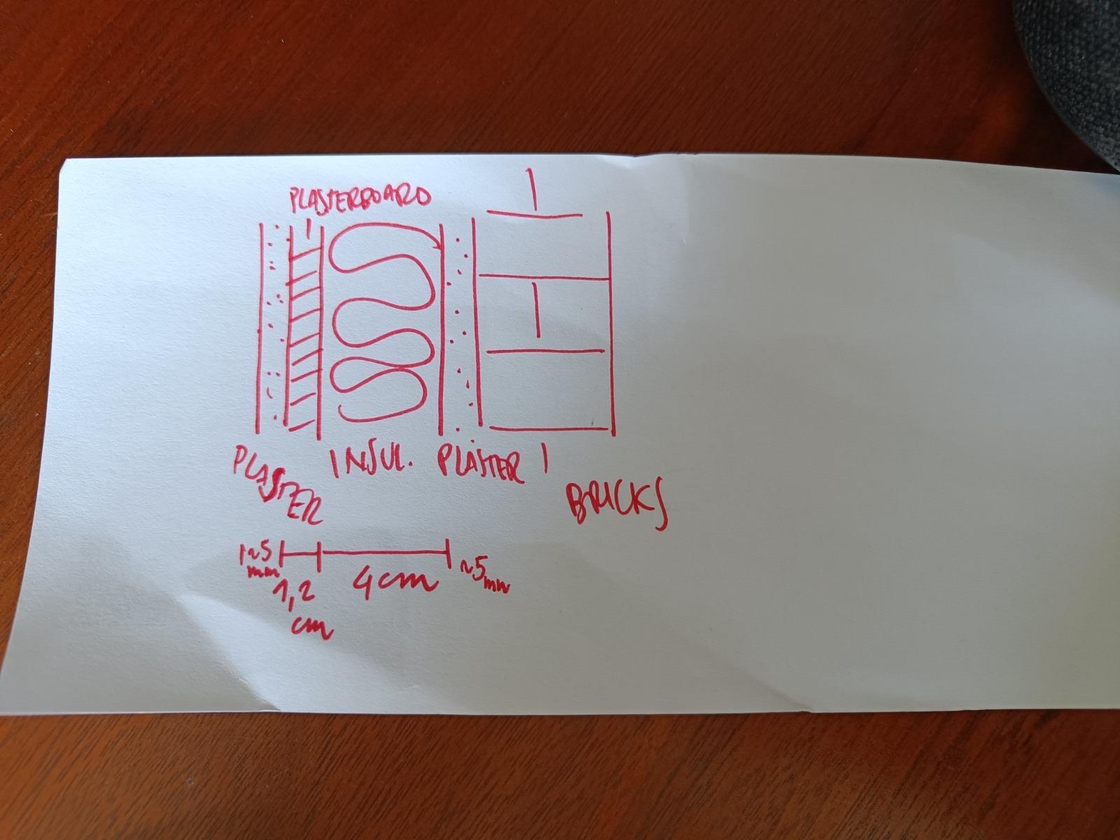

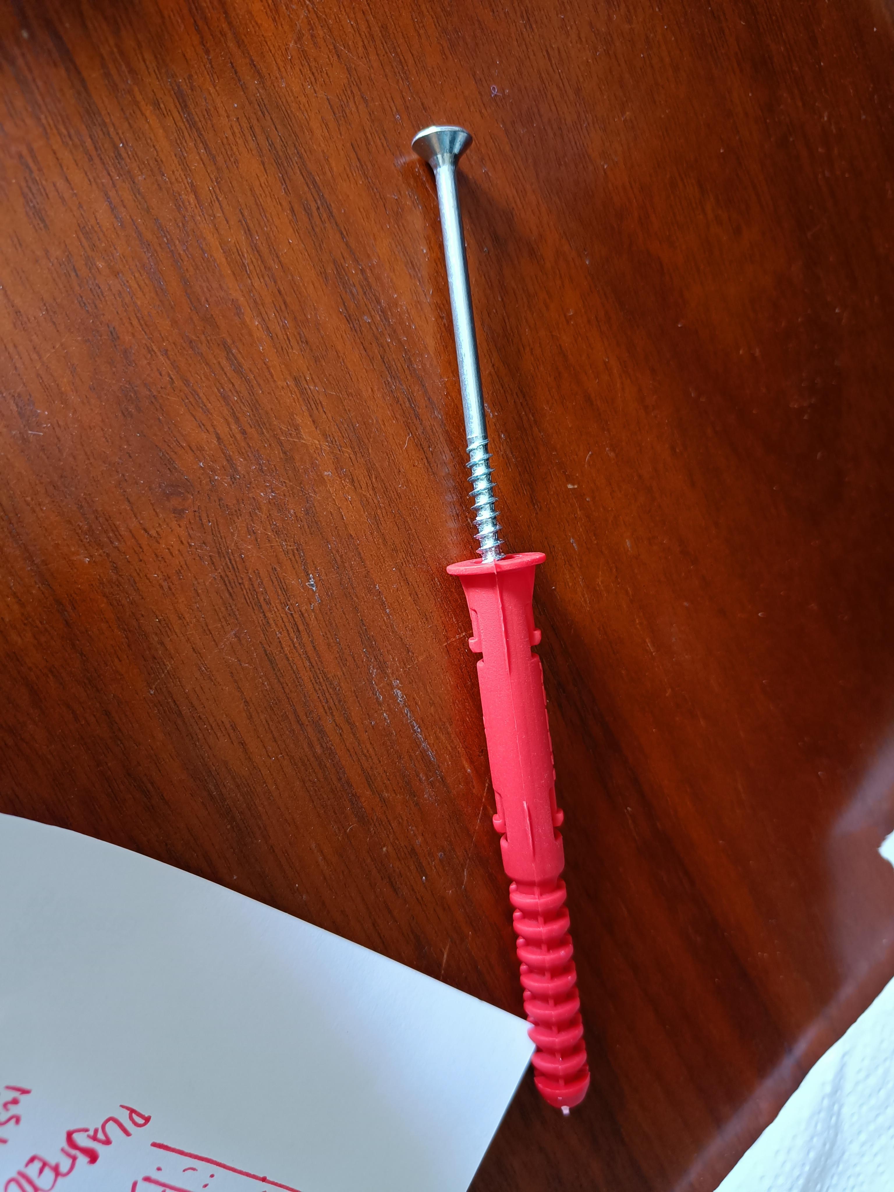

Mattso Posted October 6, 2023 Posted October 6, 2023 Hello. After plenty of resaerch I decided to go for Corefix 120 screws to attach 8 screws for 4 radiator brackets. The wall is, from inside to outside: plaster -> plasterboard -> 40mm celotex PIR -> old plaster -> External brick wall. Made the appropriate holes with the recommended dirll bit of 10mm diameter. When attaching the screws and gently screwing them into the core & plug, some bite. Others just end up spinning while the plug stays in place. So the screw just chews into the plug and when i pull the whole the screw away from the wall, the entire plug and bracket just comes away from the wall. So the plug is not doing what it should. I had the suspicion that the plug was too short, so I also cut the head of the plug off and pushed the plug & core 30-50mm inside the hole. Was hoping more of the plug would be in the brick. The result was equally unsuccessful. The only other idea I have is to use a smaller drill bit to make a smaller hole in the brick, in order to squeeze the plug and force the screw to bit. Other than that I have no clue how I will get this radiator installed in the wall. Any suggestions are welcome, short of questioning the use of internal insulation 🙂 Below is an image of the schematic of the wall. Thank you

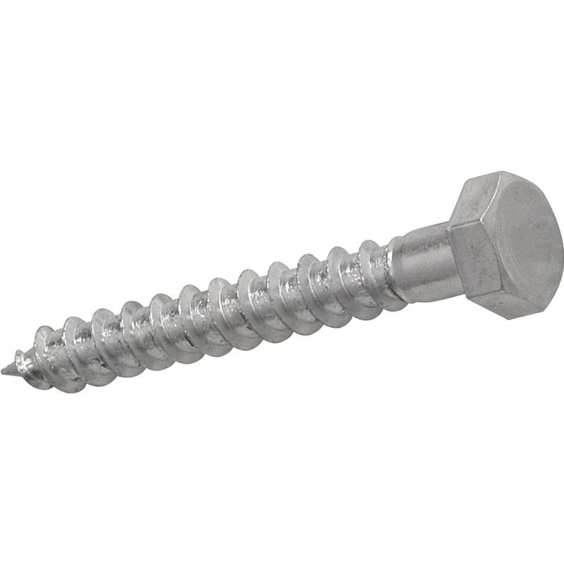

MikeGrahamT21 Posted October 6, 2023 Posted October 6, 2023 (edited) I would say they aren’t long enough, the top layer 40mm+pb +plaster will be near on 55mm, your old plaster will be likely 20mm overall if it’s traditional wet plaster, maybe more depending how many layers is on, and then you need min 40mm in the brick. get yourself some long coach bolts, smaller plug on the end (length wise) and first hammer it in til it goes no further, followed by tighten up Edited October 6, 2023 by MikeGrahamT21
Bonner Posted October 6, 2023 Posted October 6, 2023 Tend to agree with @MikeGrahamT21 but you could try a 9mm drill into the brick (10mm clearance hole to get the plug through the plaster). It can be a matter of feeling the resistance of materials as you drill

MikeGrahamT21 Posted October 7, 2023 Posted October 7, 2023 Why go to all that expense? Just get some cheap long coach bolts and job done

TonyT Posted October 7, 2023 Posted October 7, 2023 3 hours ago, MikeGrahamT21 said: Why go to all that expense? Just get some cheap long coach bolts and job done How’s that going to work? a coach bolt has a thread for a nut ? not really an expense when you consider what would happen if it fell off, damaged the radiator/floor/leaked/ needed a call out.. I’ve used these for 30 plus years and find them great, only literally with the setting tool! Kit in Aldi/Lidl for the tool and a selection of toggles
MikeGrahamT21 Posted October 7, 2023 Posted October 7, 2023 it’s what they usually provide you with to install a radiator Be no more than £5, job done. All my radiators are installed with these into brick, solid as a rock

FuerteStu Posted October 7, 2023 Posted October 7, 2023 Rather than coach bolts, which have a tendency to shred their grip in masonry, because of the constant thread with no expulsion of debris.. What about masonry screws, normally used for frame fixings.

Mattso Posted October 7, 2023 Author Posted October 7, 2023 Thanks for all the replies, appreciate the input. Only now managed to catch up on the various suggestions. In terms of expense, I'm not too fussed. The cost of fixing the wall, water leak on the floor and broken copper pipes far outweighs the initial cost. Thought splashing out on the Corefix screws was the answer but it wasn't meant to be as straightforward as that. So the first 3 layers of my 1950s wall are plaster on insulated plasterboard (PB + 40mm PR bonded at factory). Beyond that, it's wet plaster, but as mentioned by another poster, it could be 3mm or it could be as much as 20mm. Toggle clips are designed for hollow walls and dot and dab, so I don't know if the toggles will expand the way they should. So to summarise, the options I'd consider are: -9mm drill bit into bricks using 120 Corefix (possibly too short but I could cut off the top and push them into the hole by a few cm) -fill the hole in the brick with resin or quick set concrete, push the corefix plug in, wait for it to set and screw the screw in as intended. -masonry screws, but would have to be at least 100mm long if not longer and might cut into the PB + Insulation under weight -Coach screws maybe. Ideally I'd use the 5 different 10mm holes I've already made into the wall. So they'd have to be 10mm x 100mm min in dimensions. Cheers.
