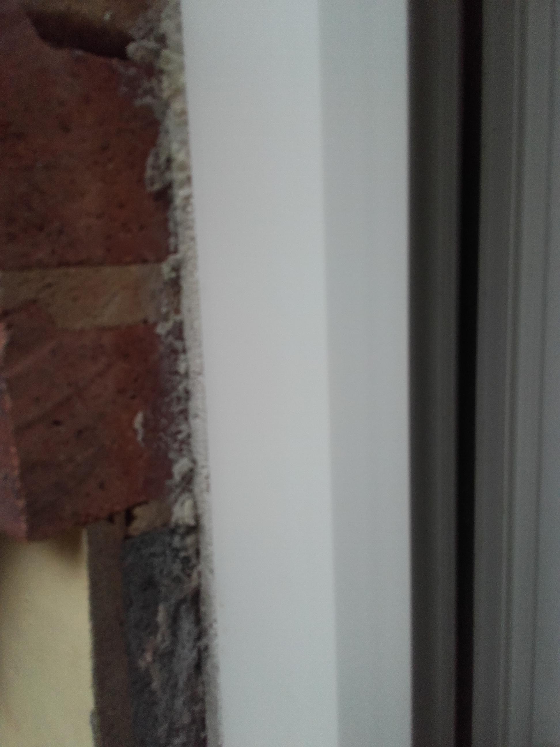

What did you use to pack? I've got these plastic shims or 50x50x3 galv washers:
20170903_102823
These are the hinges. Seems you have to unscrew the pin, take the hinge (door?) off and screw / unscrew the middle bit.
20170903_111204
Might need to do that as it's a bit close here:
20170903_111134
Decided against lowering the door.
Going to need some making good!
20170903_111224

Posted
there's not much room for adjustment between door and frame generally- anything more than a tiny adjustment at the hinge end and the door will either bind in the frame or miss the seals (or latch keepers!), in my experience.
If door and frame matched previously, leave the hinges alone  and just shim and pack the frame til all is well.
Posted
48 minutes ago, Onoff said:
20170903_111204
Standard way to sort that is to use a frame extender on the hinge side - makes it so the door can properly open past 90 degrees and also allows where a door is against a wall that there is no issue with the handle hitting the wall when it's open fully

Posted
Sorted in the end. Had to drill through the galvanised internal frame to get fixings in!
