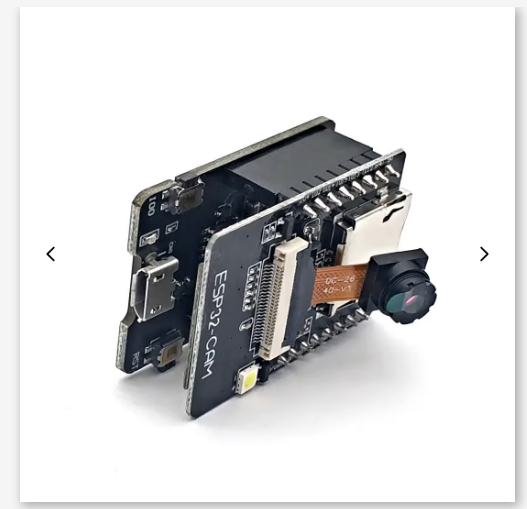

SteamyTea Posted October 1, 2023 Posted October 1, 2023 2 minutes ago, Onoff said: Reference HIVE we bought the camera system to keep an eye on Dad in his last few months. BG are switching the service off, at least the camera side in 2025. Bloody disgusting tbh. Not cheap kit to buy and soon to be landfill I guess. My sister wanted to set up something similar at my Mother's house. Mother said 'No', well she did after about an hour of stumbling over her words. It is hopeless to decide as the services can be withdrawn at any time.
MikeSharp01 Posted October 1, 2023 Posted October 1, 2023 (edited) 26 minutes ago, SteamyTea said: It is hopeless to decide as the services can be withdrawn at any time. QED see my point above. Why not go another way, install a £10 device like this one https://kunkune.co.uk/shop/esp32-esp8266/esp32-cam-dev-board-ov2640-camera-2-4g-antenna/ and then tunnel it out of your router so you can watch it anywhere - audio options are myriad. PS To make this approach secure you will probably want to use a reverse proxy (Nginx is available on RPi for instance) and DDNS to keep track of your IP address unless you have a fixed IP address in your package. Edited October 1, 2023 by MikeSharp01 Added securing cheap cameras
